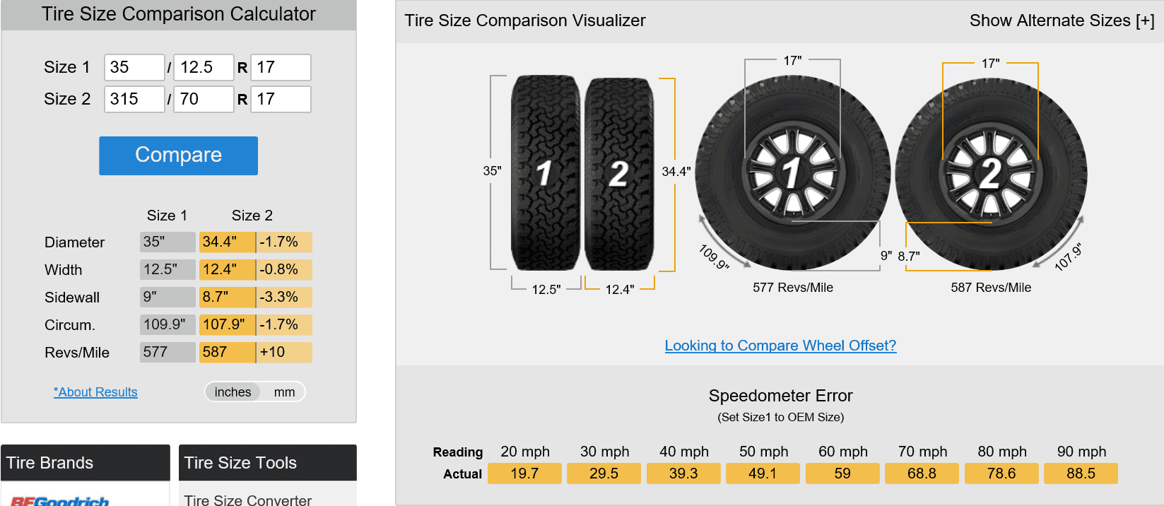

They’re very similar. The 35” tire is measured in inches and the 315 tire is metric. But the 35” is the height of the tire and the 315 is the width…tires are just confusing!! Use this calculator to see the difference.
https://tiresize.com/comparison/
Check the load rating of the two tires. The 35 may be heavier than the 315...

Jeep Gladiator 35X12.50R17LT vs LT315/70R17 upload_2019-5-22_21-10-42

Instead of using a tire calculator, it might be helpful to go to the mnfr website or tirerack to see the actual dimensional sizes of each specific tires. For example, a 35x12.50r17 BFG ko2 is actually something like 34.6in tall. Others measure larger than 35. Just something to be aware of!
