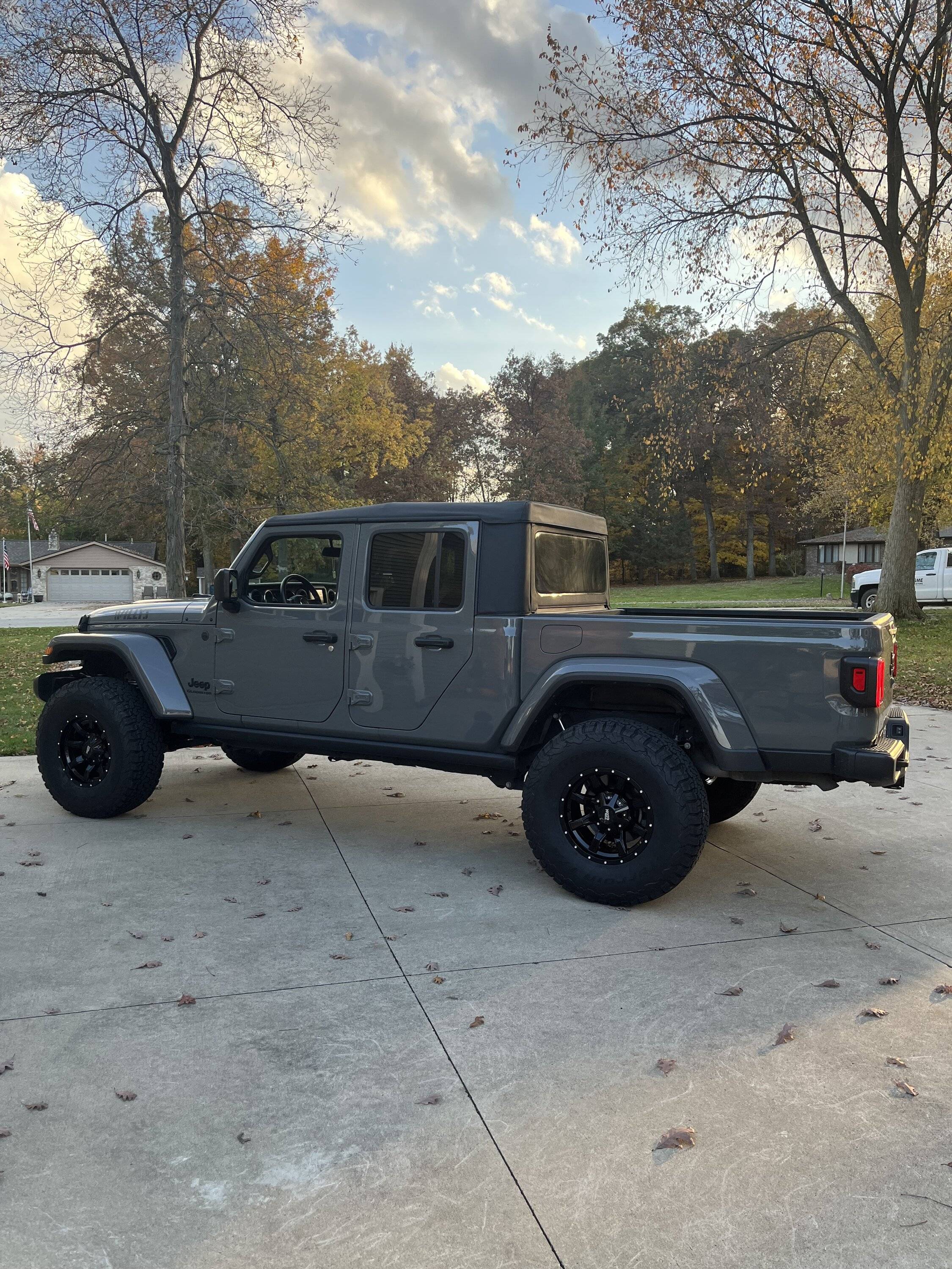

I have 37 12.5 17s BFGs. At 30 psi on a 8.5 wide wheel they measure 35 and 3/4 inches tall. I have a 3.5 inch lift so no rubbing issues at all. I was a little disappointed at the size of the BFGs because my local 4x4 shop told me they would be 36.5 inches tall.
Great looking rig! Thanks for sharing!

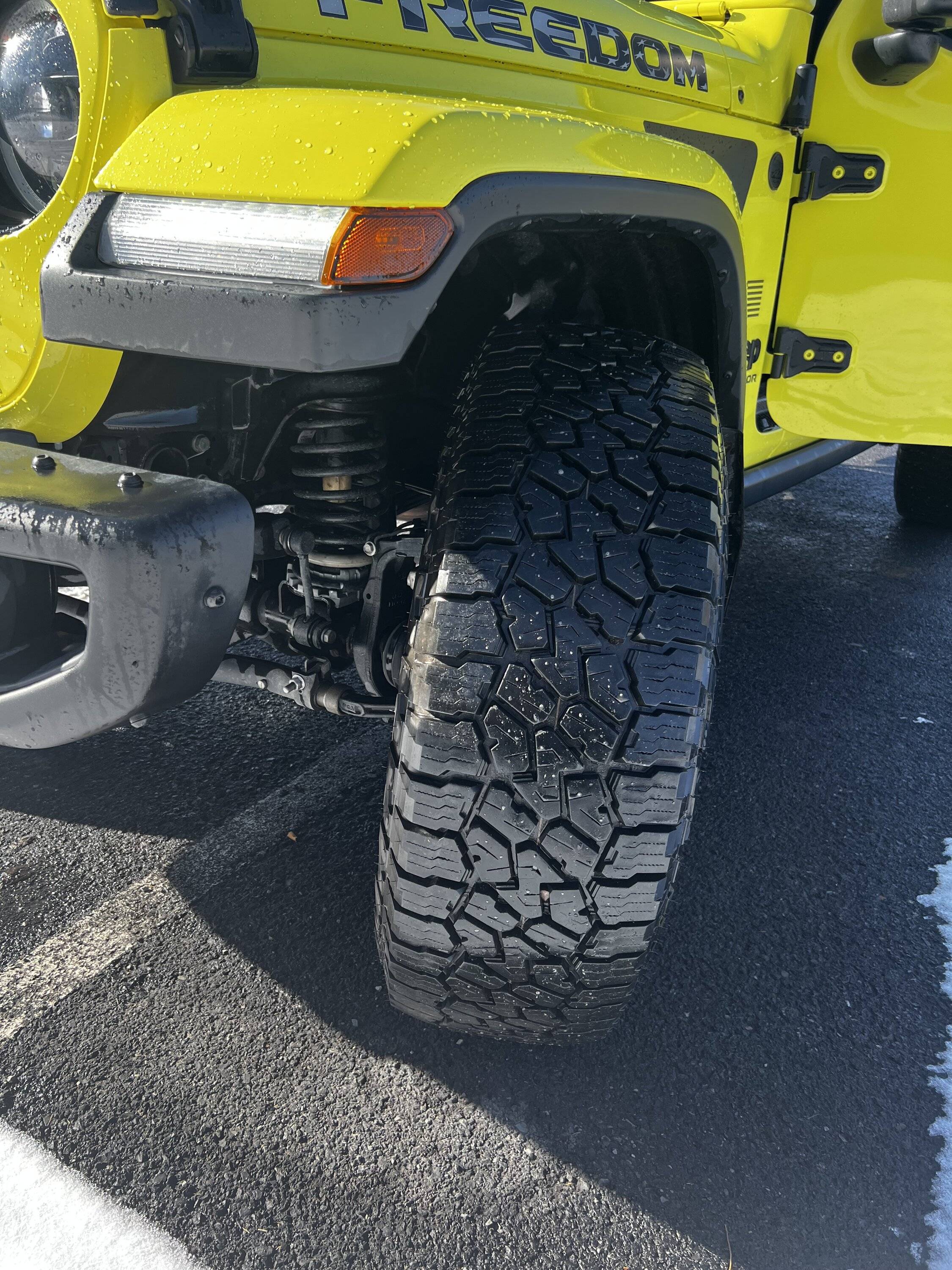

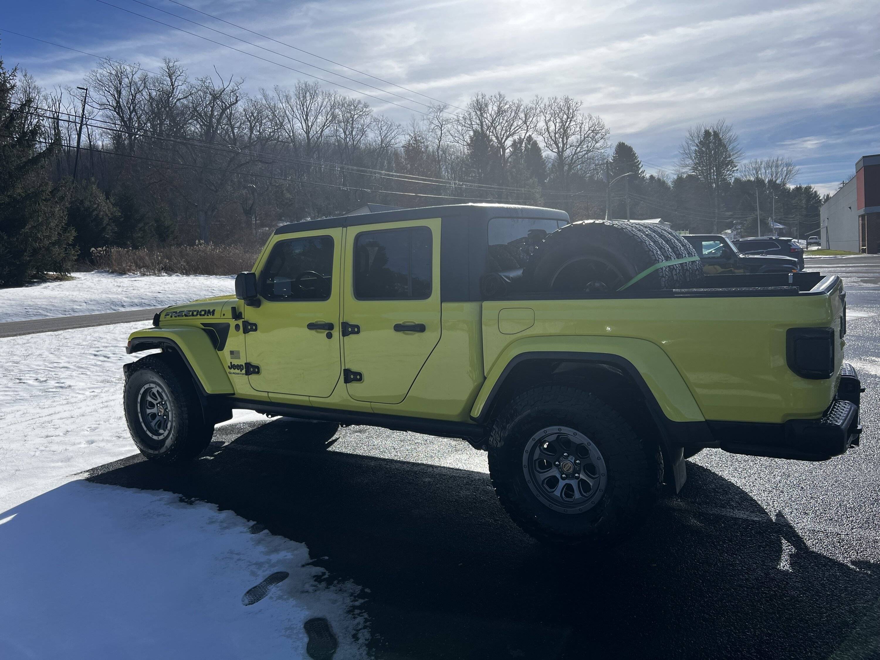

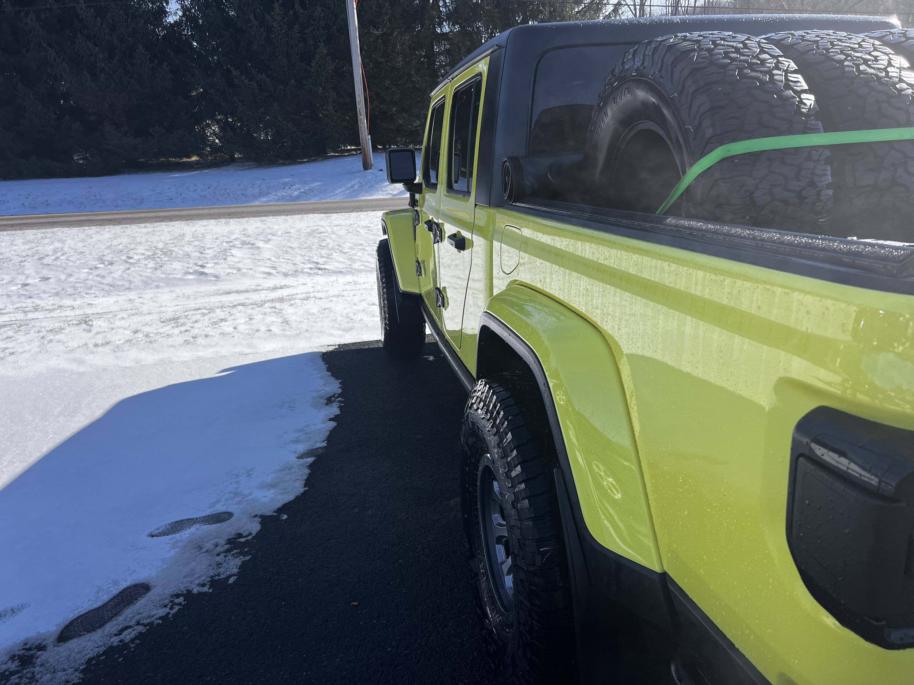

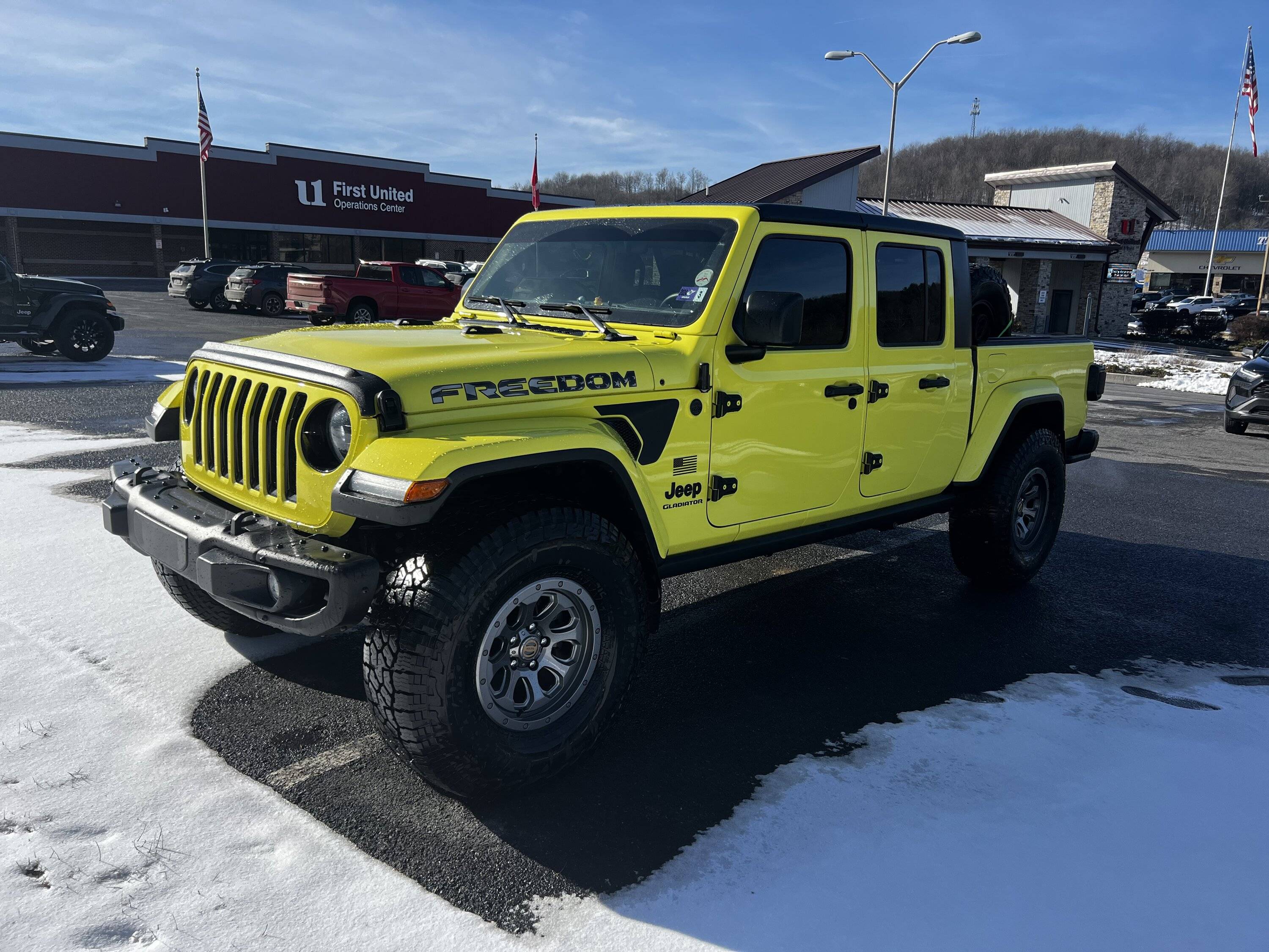

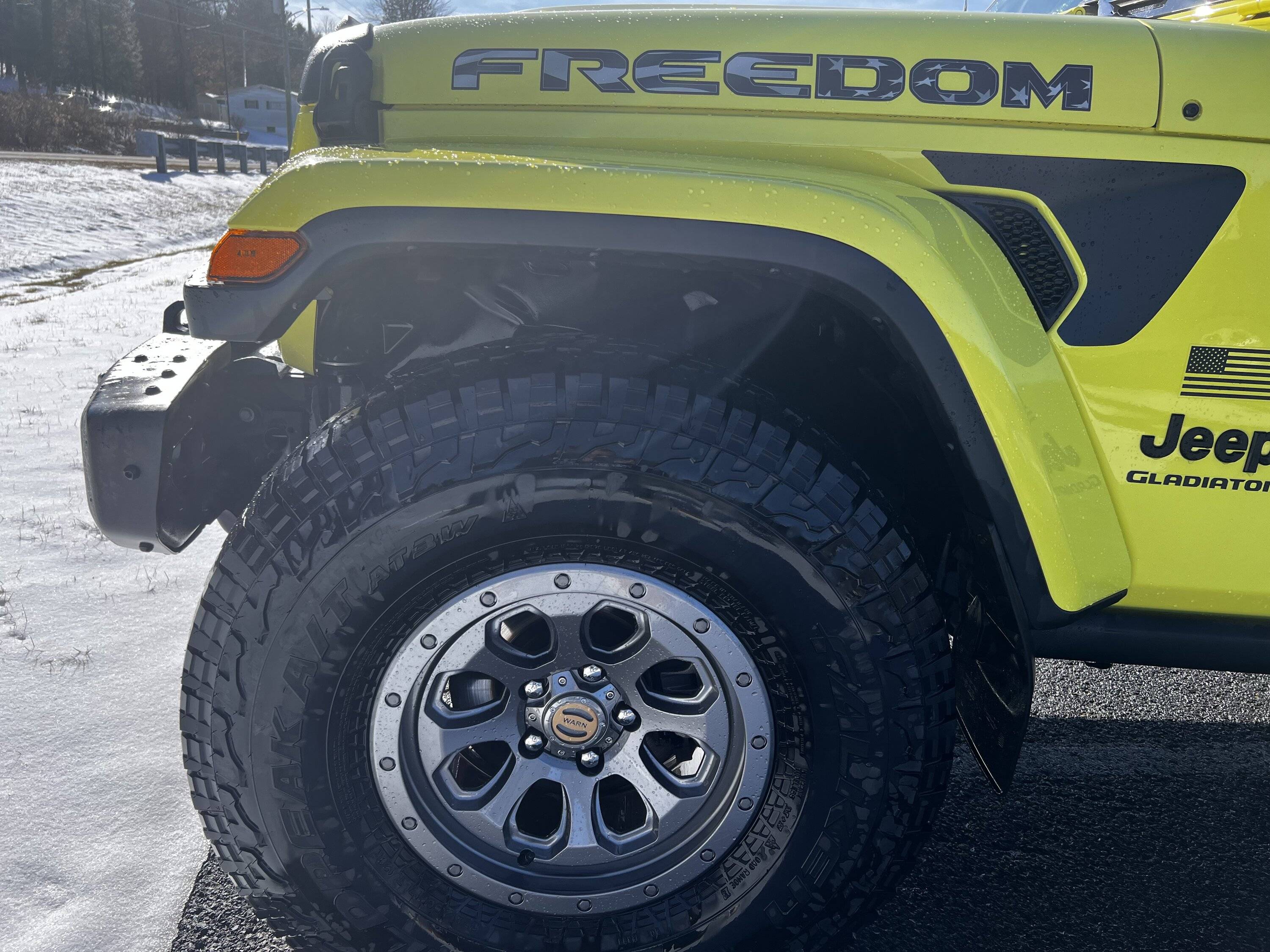

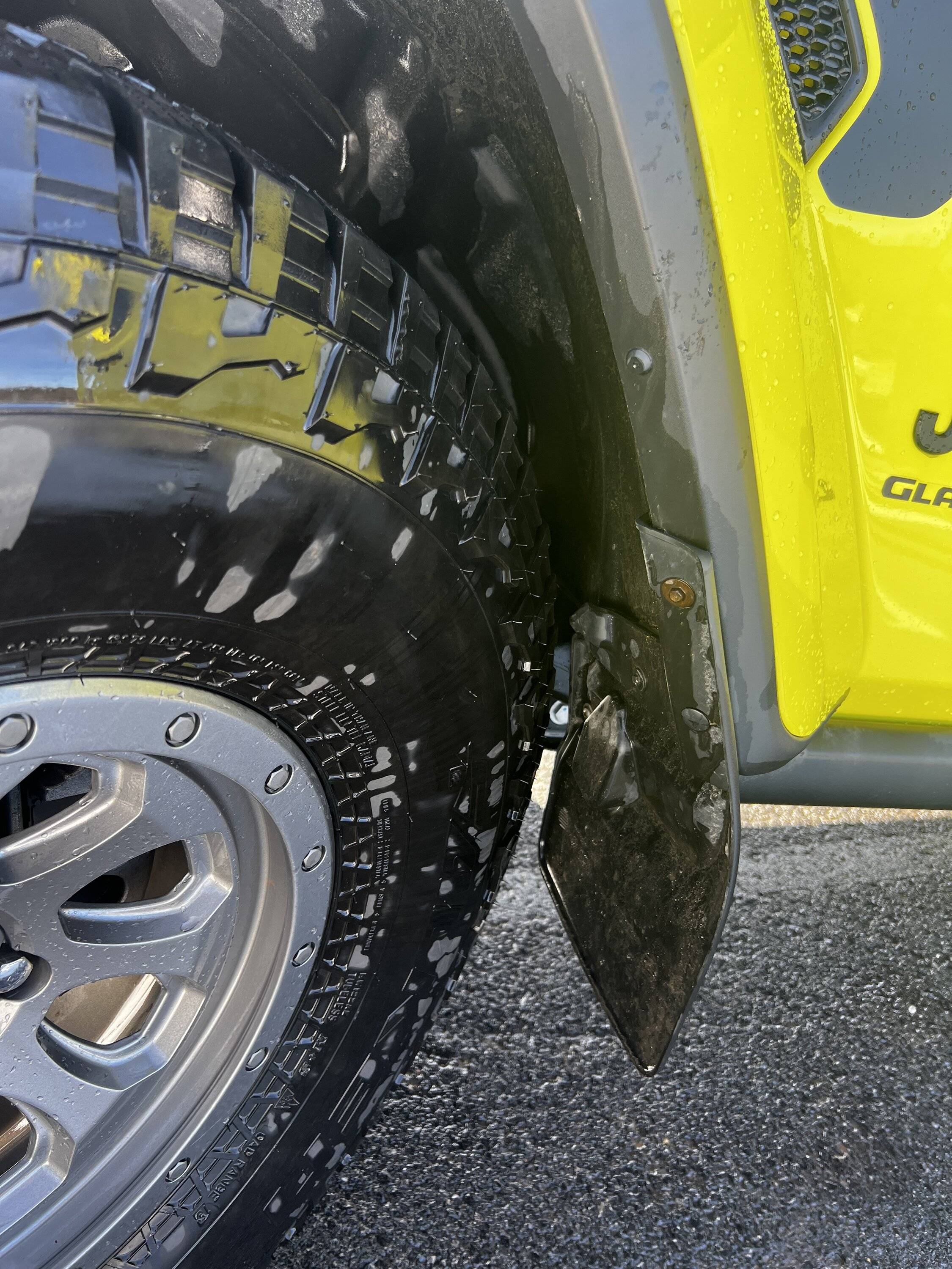

Went to my tire shop and got a test fit and they fit just fine. About .5 inch from rub at full turn, doesn’t even rub my mudflaps. I will add a 2 or 2.5 lift before any serious off roading but I like the look for now. On another note the 4.88’s I bought for it will only fit a rubicon and not my sport freedom edition so they will up for sale. Yukon 4.88 gears with master install kits. Brand new never opened. Part number from Yukon is YGK068.

A lot of people use the 2" Mopar lift with 37's.
I have a stock Mojave which I believe is only a 1” lift over yours and I run Nitto 37’s. I do get a little rub on extremely tight turns so I’m thinking 2” would work if you don’t want your truck standing too tall?

Yeah, that is what I am going to go for a 2 in most likely Mopar. I currently have the terra flex 1.5 front and daystar 3/4 rear spacers on there.
