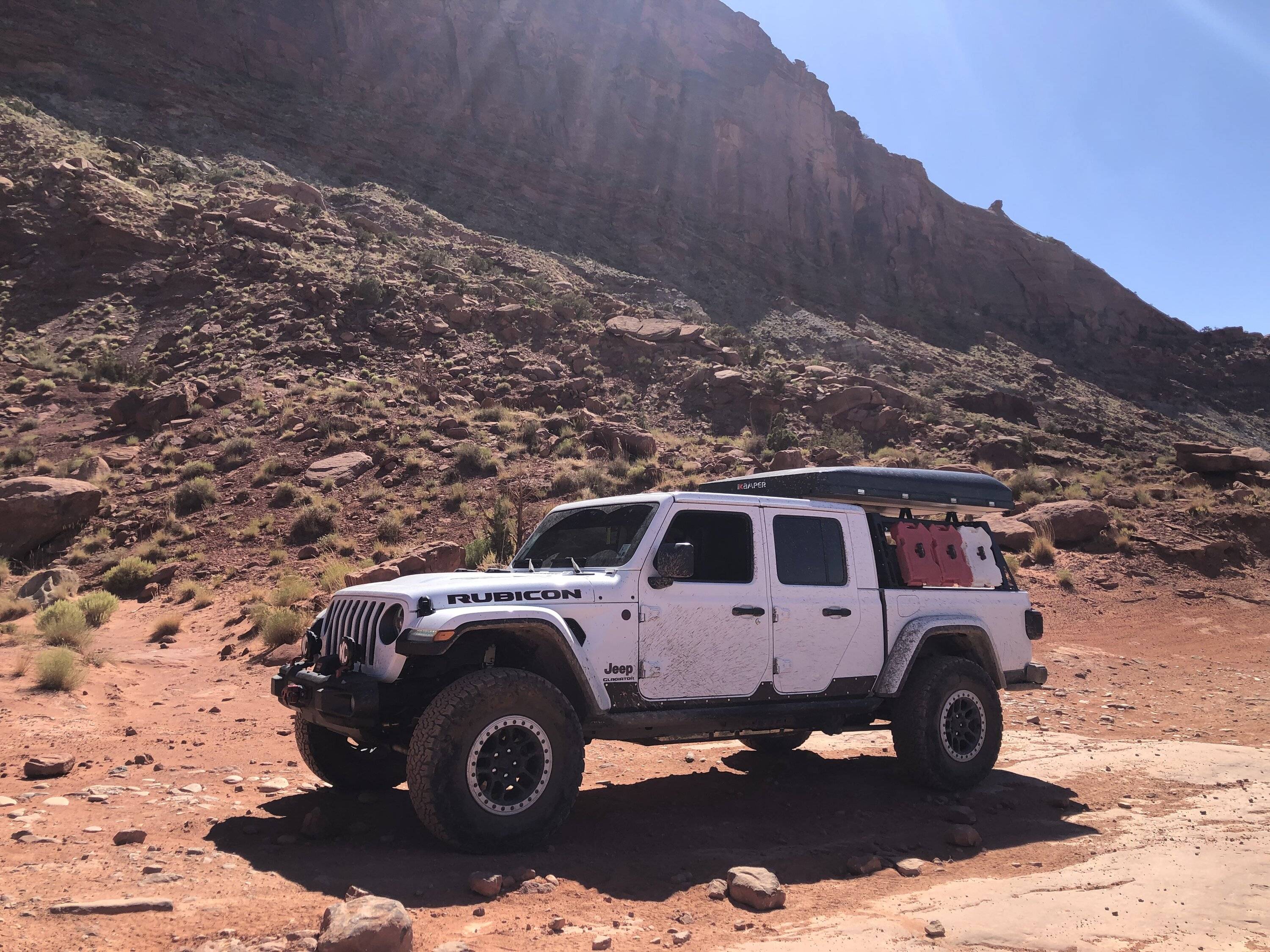

Jeep Gladiator 37’s. I’m about to pull the trigger IMG_7178

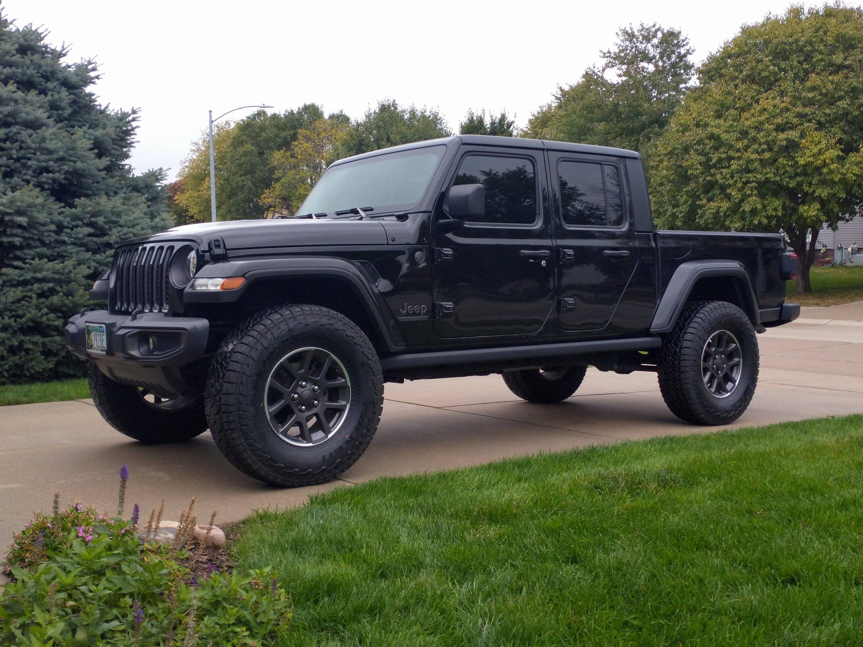

I'm running the 2" Mopar lift with Falken Wildpeak 37x12.5x18 on OEM Overland wheels which are 7.5" wide on 1.75" wheel spacers. No issues
Discount Tire installed them without issue
Jeep Gladiator 37’s. I’m about to pull the trigger Installed 1

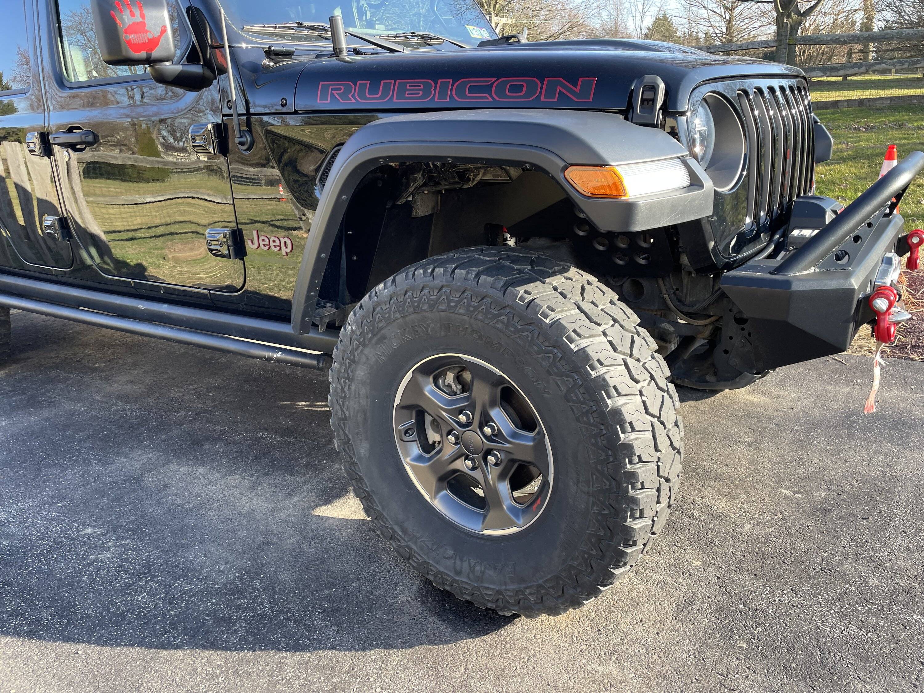

Sorry for long post… On my 2020 Rubi, I’m running 37x12.50 Mickey Thompson AtzP3 D Load tires with Synergy 1.75” wheel spacers on stock wheels. Zero issues with my tire setup. I was running without spacers but was getting into my sway bar offroad at lock.

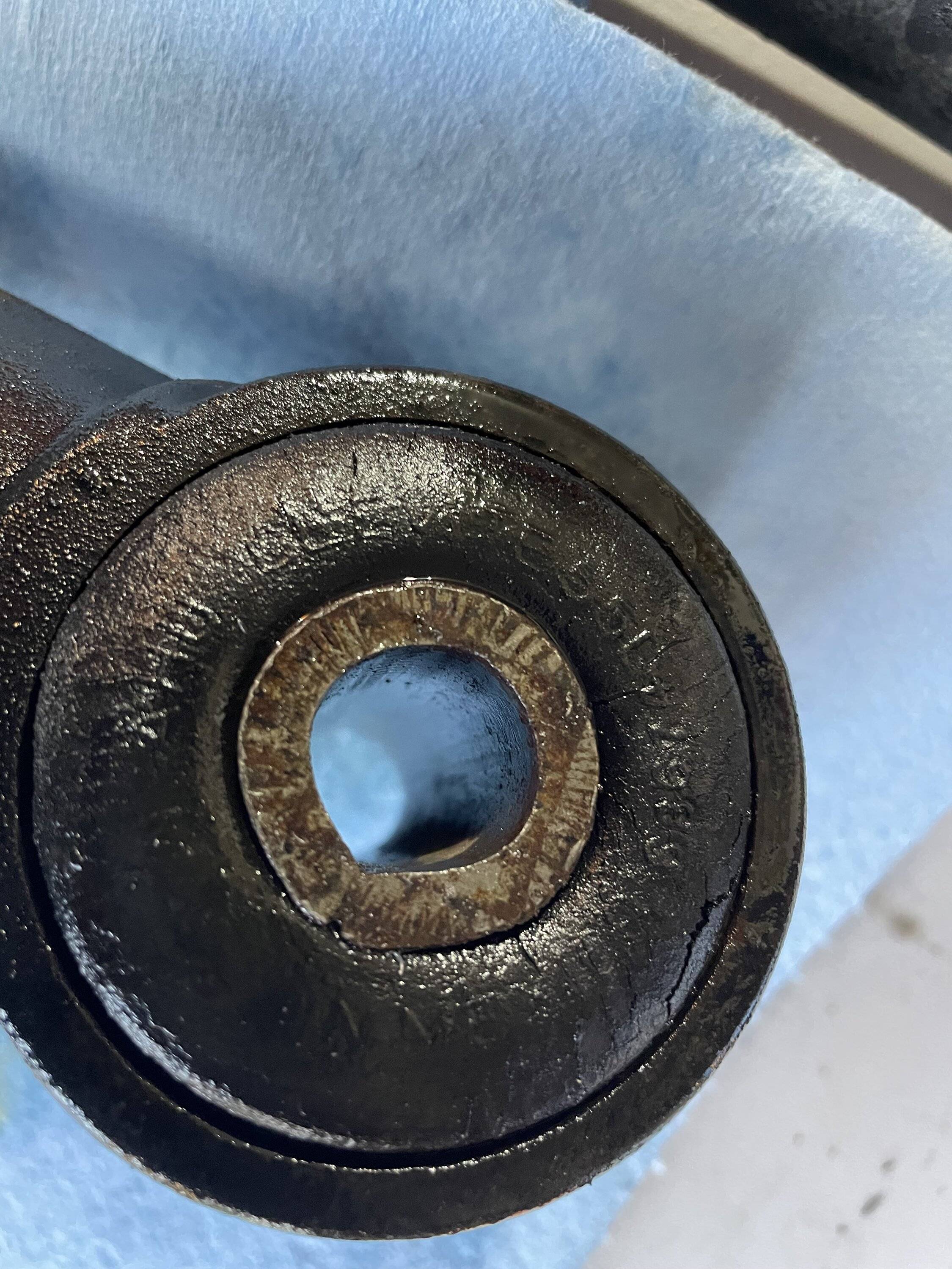

Rusty’s 2” advanced lift, Teraflex 1.5” spacer up front and .75” Daystar spacer out back. using Yeti adjustable trackbars. The Rusty’s front heim joint on the Rusty’s track bar failed after 33,000 miles. I got COVID Rusty’s Control arms and they are starting to “tear drop” in the steel sleeve bushing causing play — the new solid design eliminates this. Knowing what I know now, I’d avoid this type of bushing inner sleeve (see pics the new bushings are cheap but time consuming to replace on your own or mechanics want a fortune.
Running Rusty’s HD Aluminum steering it’s great. My build thread and YouTube have a ton of info. YMMV but My stock steering was shot - 3 of the 4 joints on draglink and tie Rod were flopping around at 33,000 miles. Not sure if it was the failed Trackbar heim that caused the steering issues or the steering caused the heim failure or it all happened concurrently. I have rock crawled, and hit blue/green trails at off road parks, etc. probably 20 times in the last 4 years while light 2 track, dirt roads, and fields/soft roading weekly to hunt, camp, do farm chores, etc.
sorry for such a long post. Hit me up if you have questions.

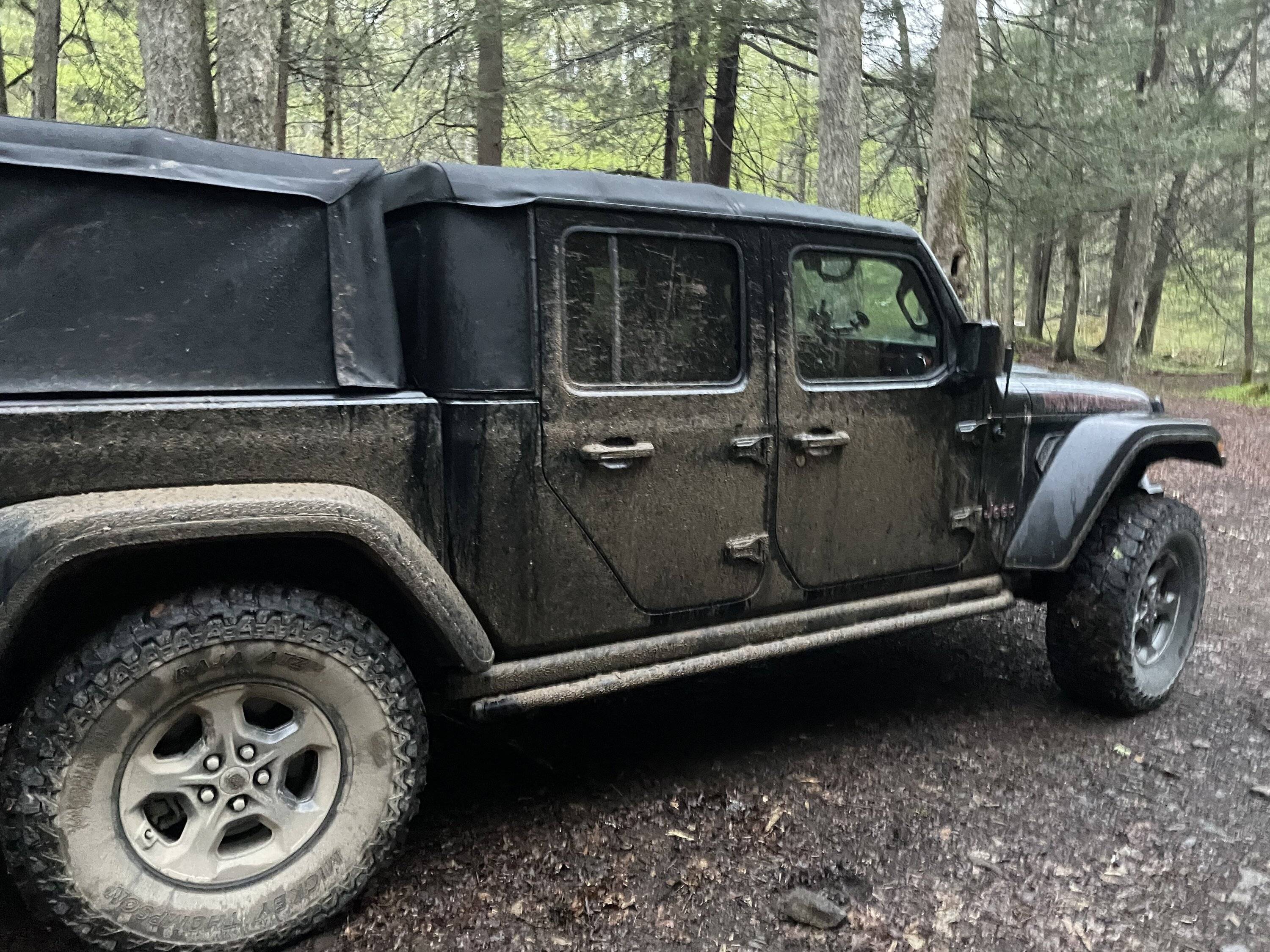

Jeep Gladiator 37’s. I’m about to pull the trigger IMG_7294

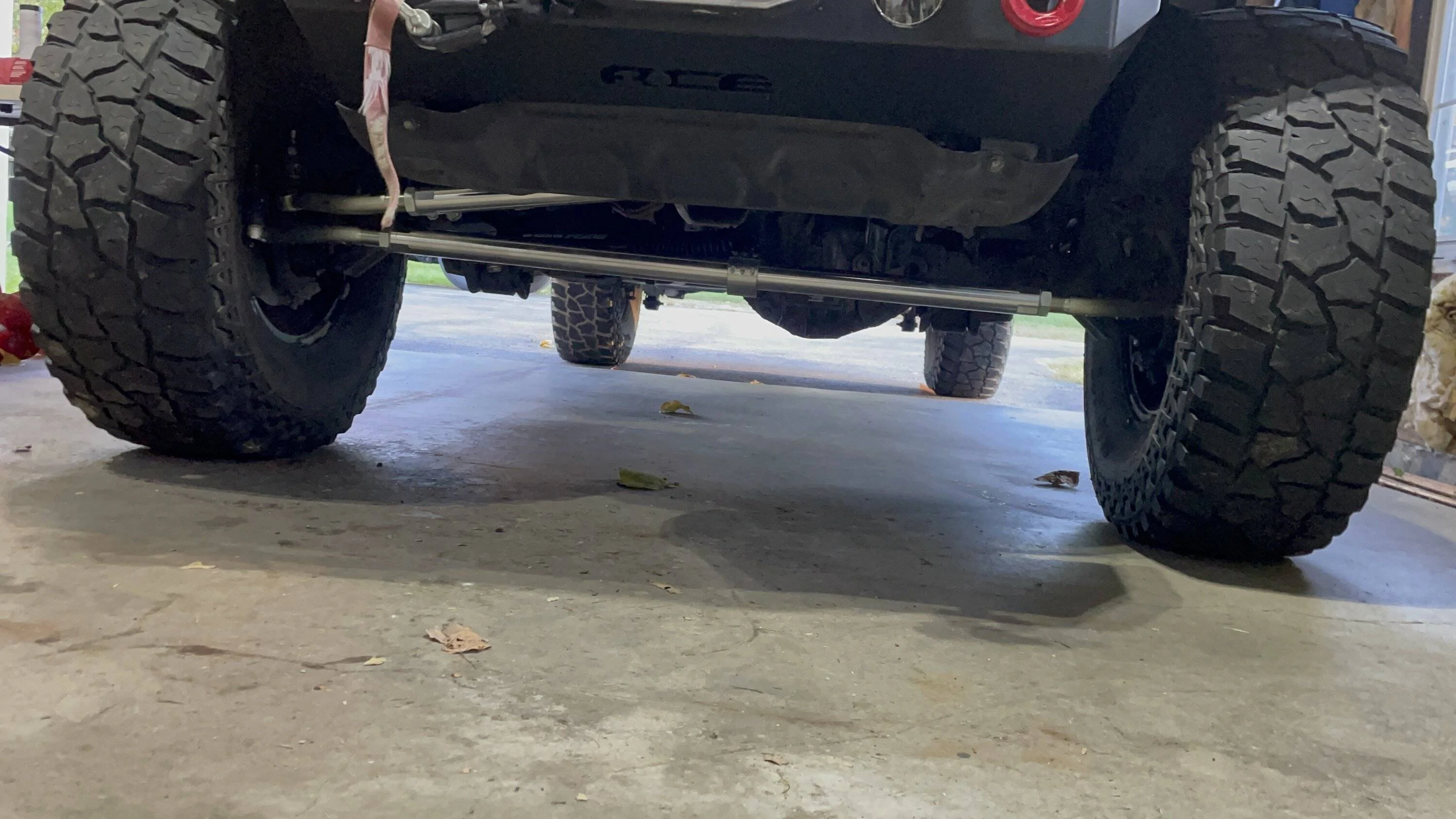

Jeep Gladiator 37’s. I’m about to pull the trigger IMG_6775
Jeep Gladiator 37’s. I’m about to pull the trigger IMG_9105
Jeep Gladiator 37’s. I’m about to pull the trigger IMG_9114
