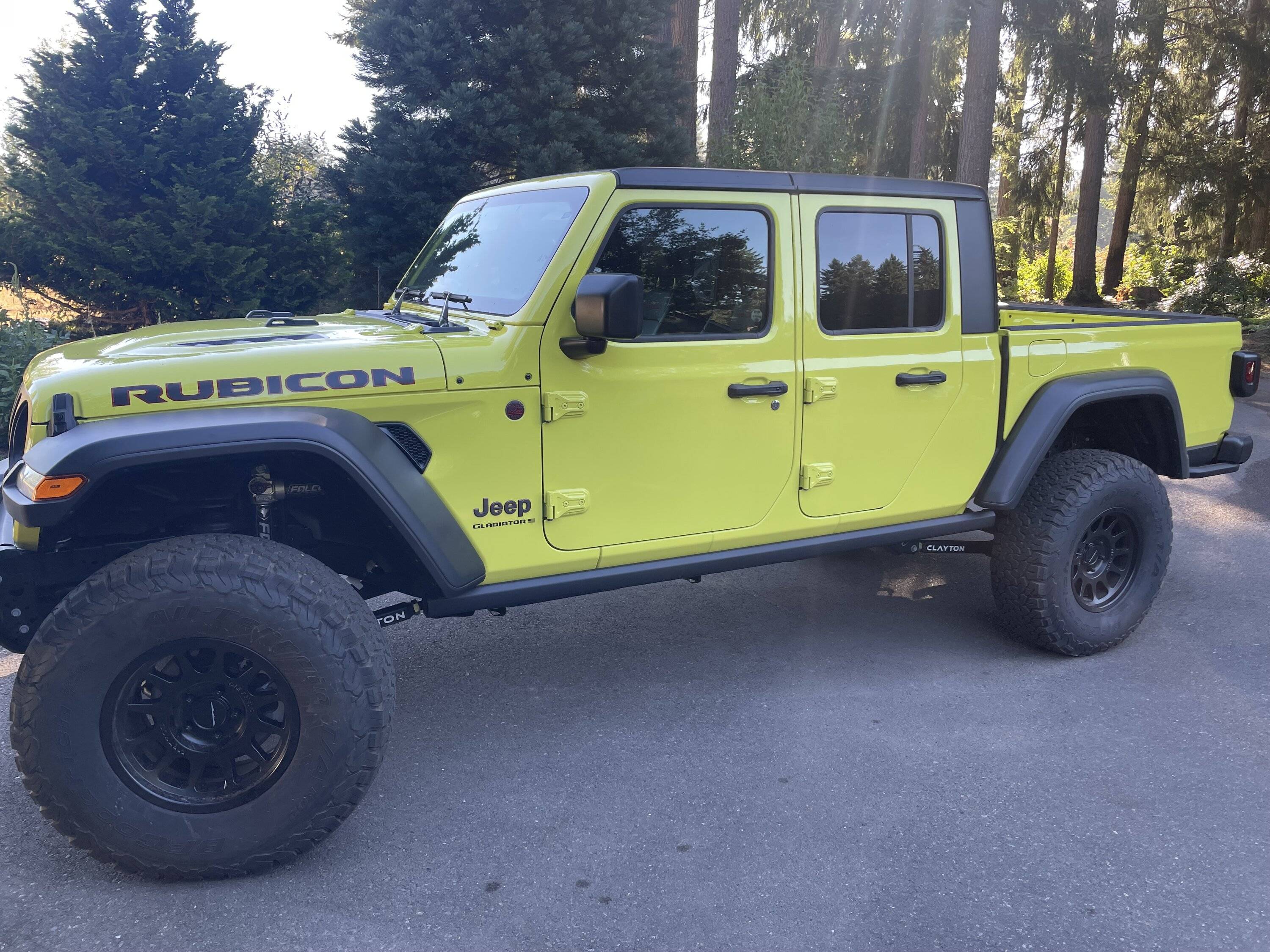

Clayton Overland 2.5+ kit got me 3.5” of lift. Method bead grips hold the KO2s down to single digit psi. No dragging. And it’s yellow so I got that going for me…
Looks nice, especially the High Velocity!!

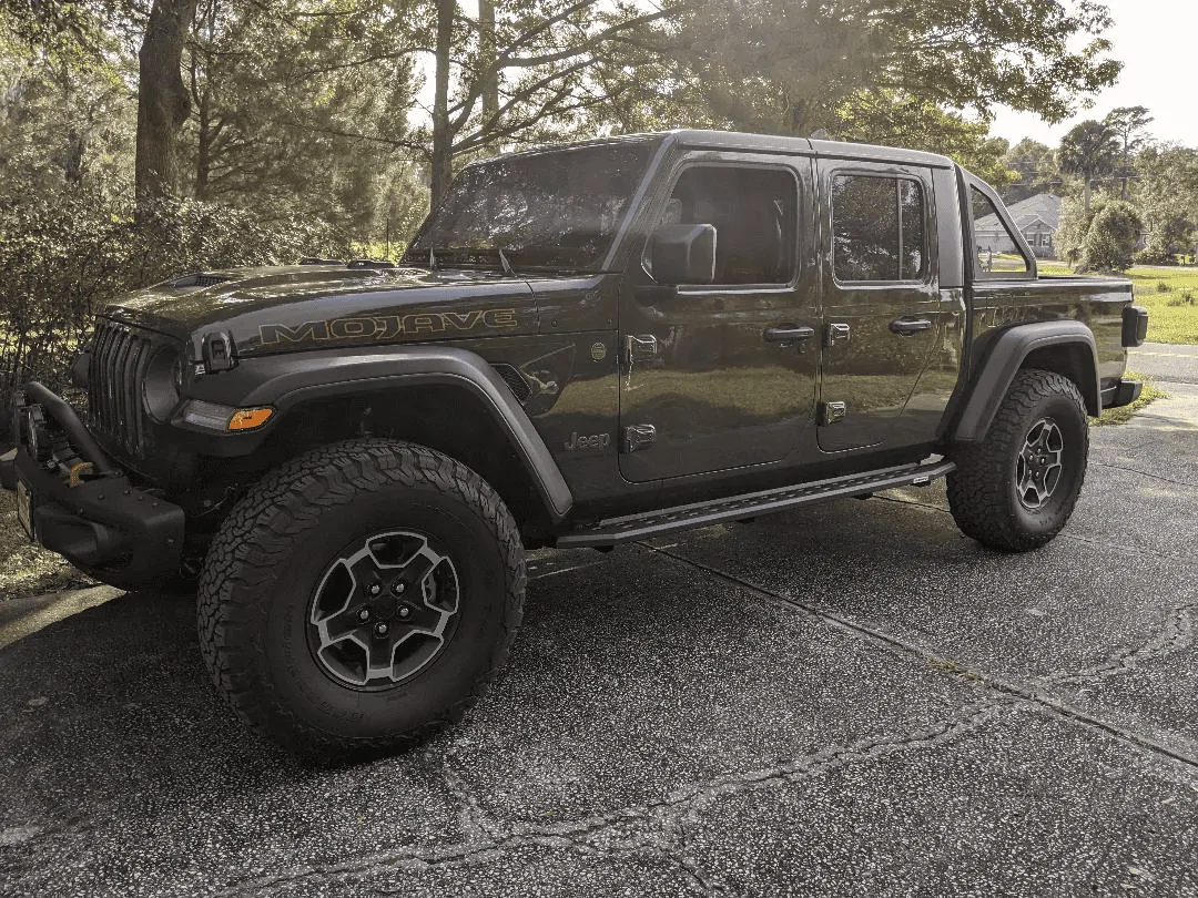

37" BFG KO2 on stock wheels and no lift or wheel spacers.
Do/did I rub? Yes. Rubbed the inner fender liner in the front. I put two washers in the steering stops and trimmed a little of the liner.
Granted, it's a Mojave and a little taller than yours stock. Keeping a low center of gravity was my goal. Discount Tire installed my 12.50 wide tires on stock wheels with no questions or issues.

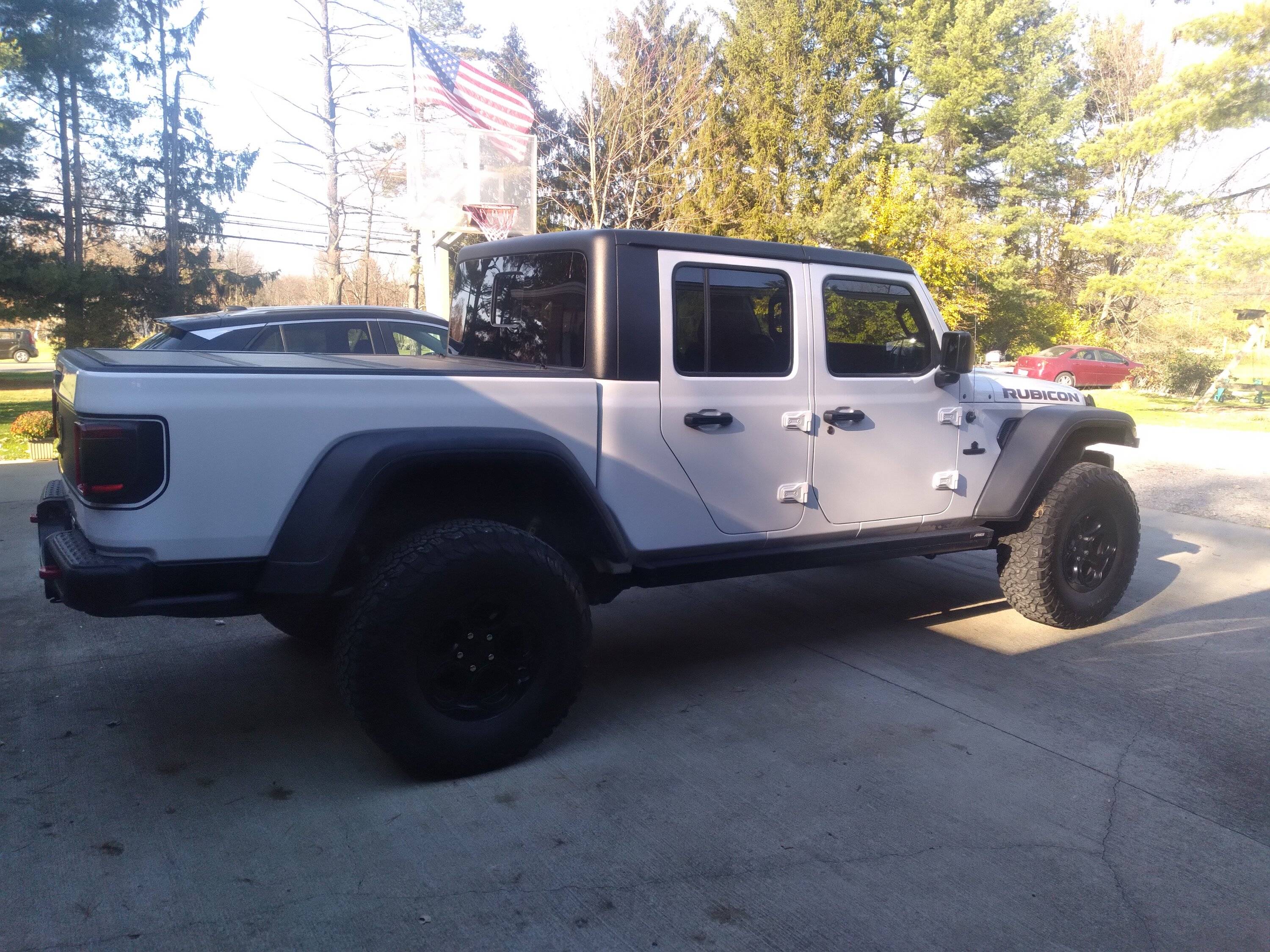

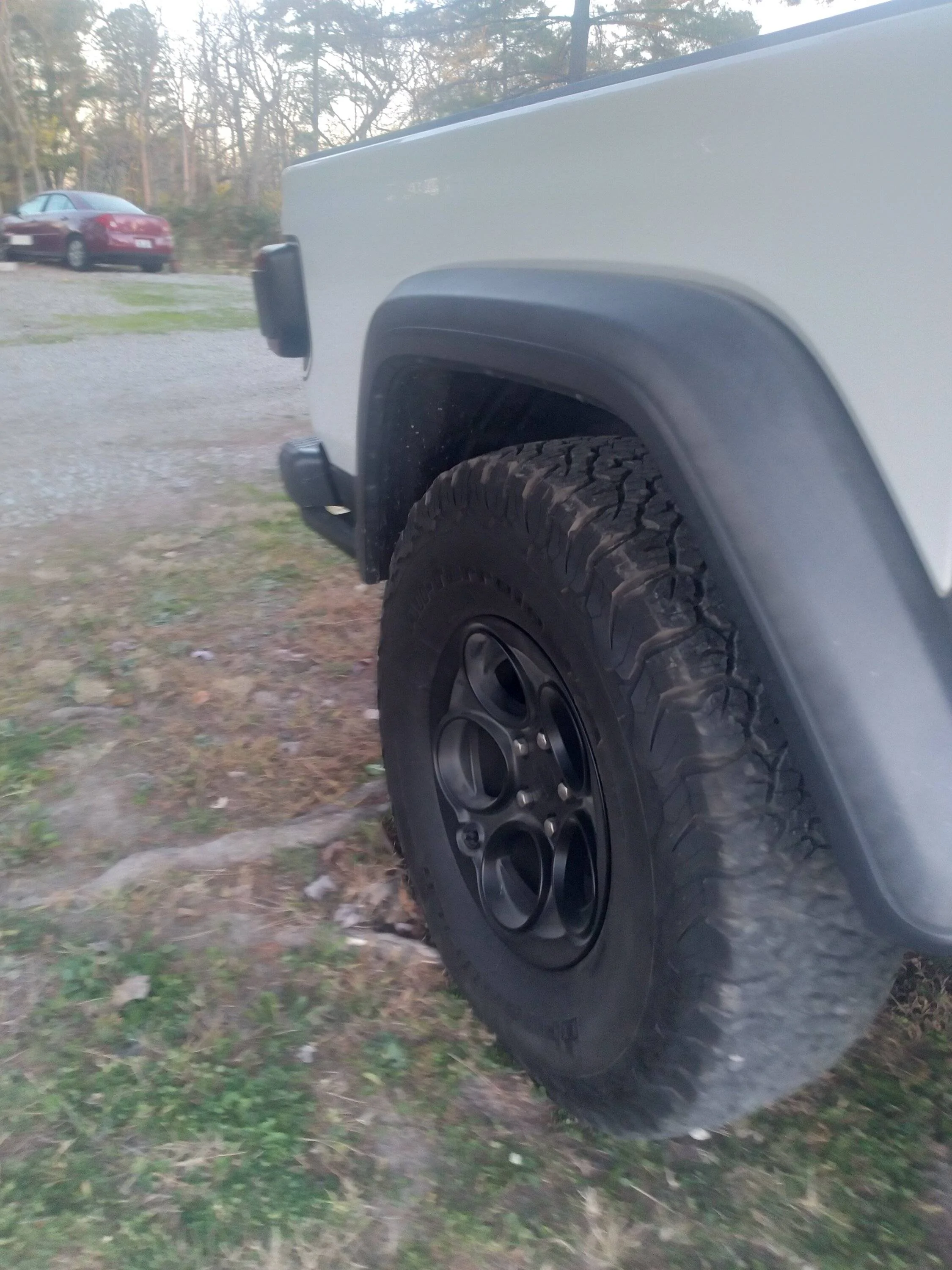

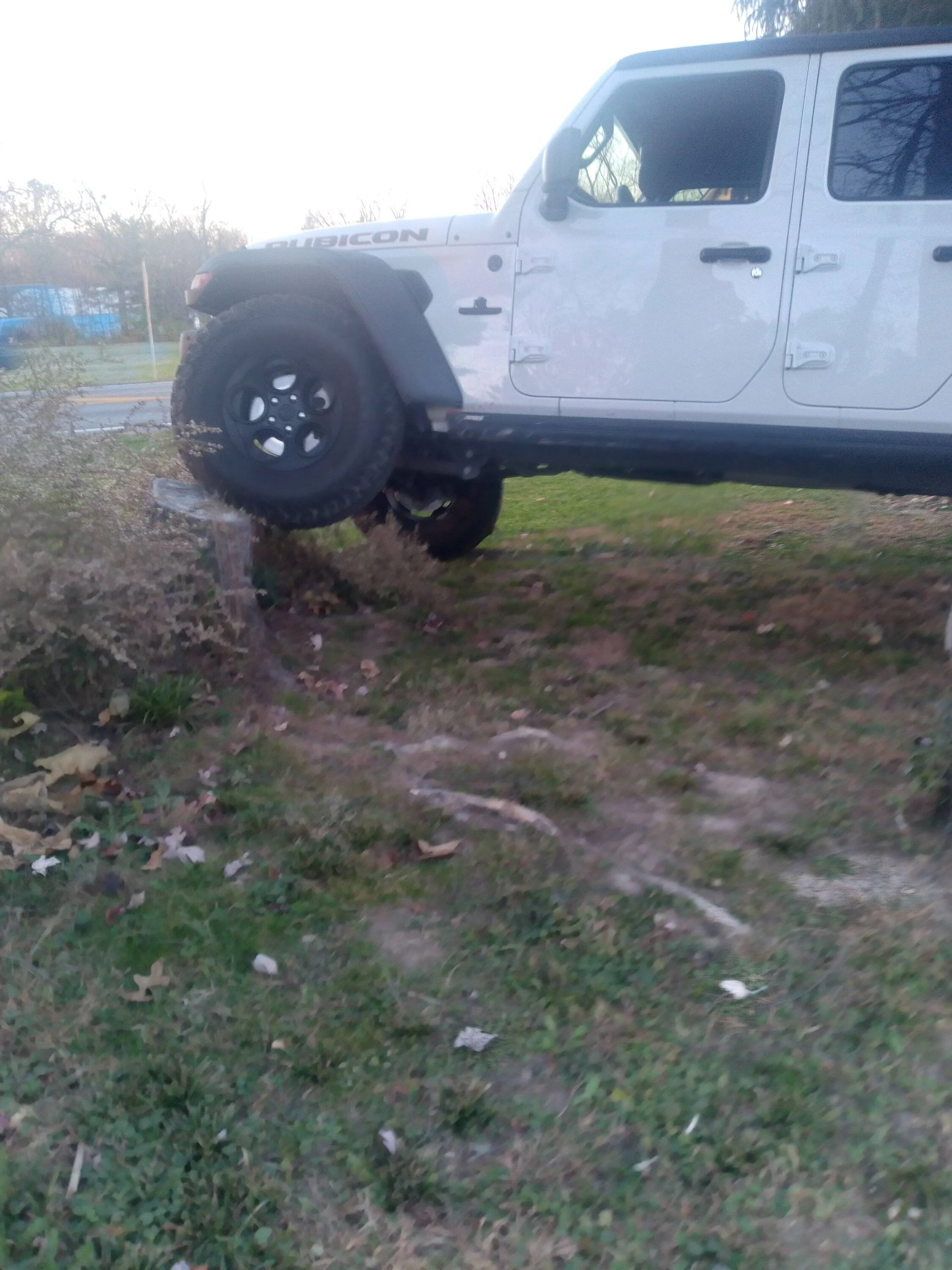

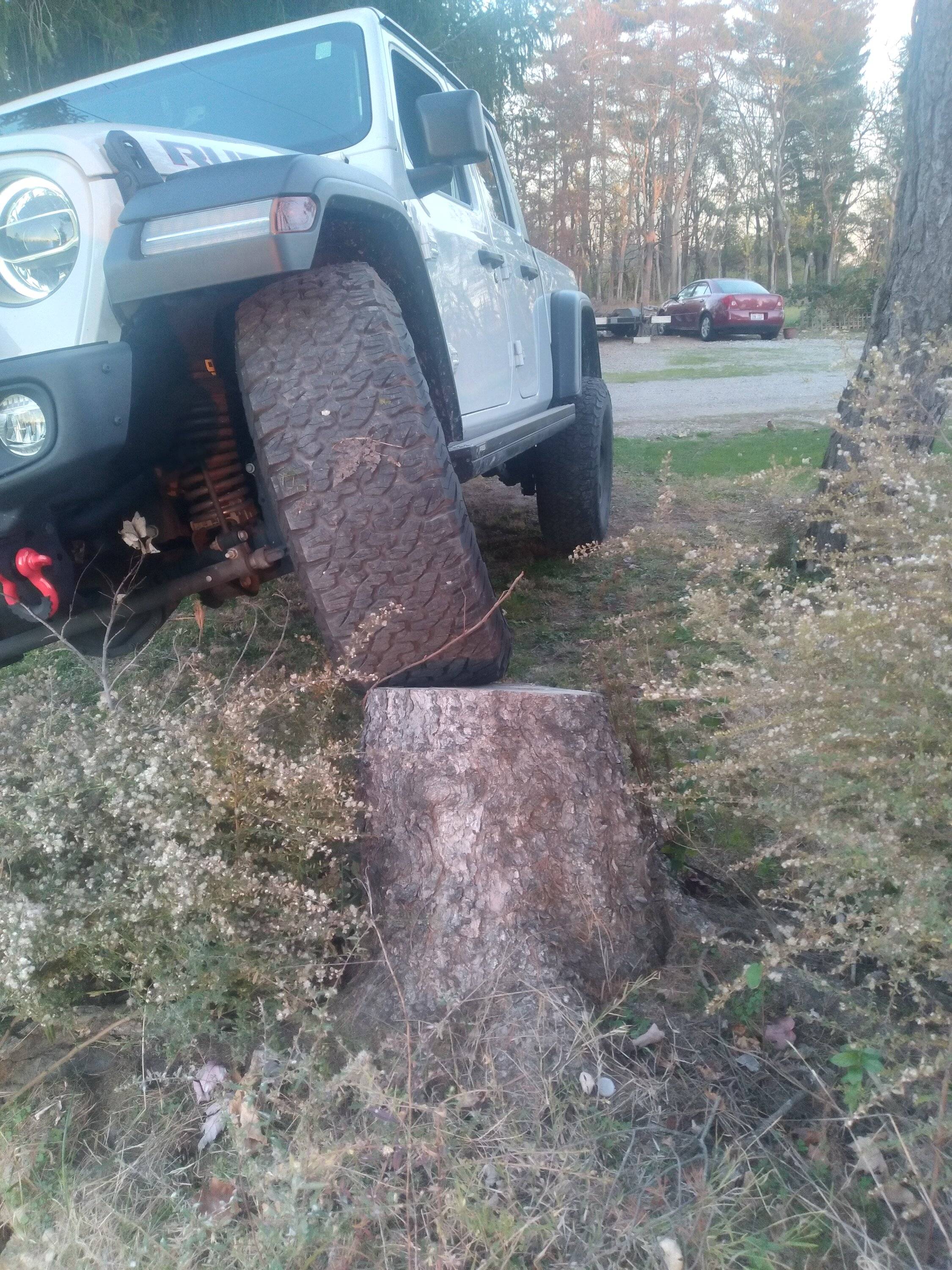

AEV 2" with 37" BFG K02's
Jeep Gladiator 37’s. I’m about to pull the trigger 20231110_143426
Jeep Gladiator 37’s. I’m about to pull the trigger 20231115_171252
Jeep Gladiator 37’s. I’m about to pull the trigger 20231115_171304
Jeep Gladiator 37’s. I’m about to pull the trigger 20231115_171328

Do you have wheel spacers, or are these aftermarket wheels? They look to be aftermarket. I like the look either way.
