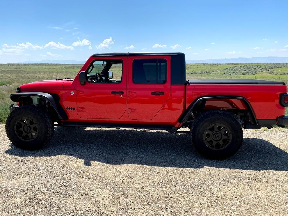

The pic below was my Max Tow with the 1.5" up front & 35's with the Bushwacker Fenders installed. There is no doubt there was room for bigger tires in there.

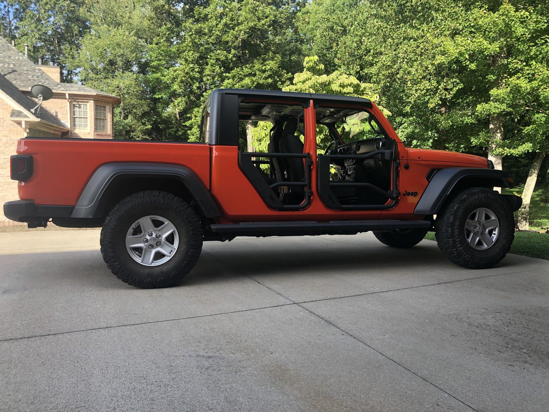

Jeep Gladiator 37’s on Max Tow with front level 90D94B2D-6C2F-49E9-B66D-010F5C268C25
Well—I did it. They fit! Only slight rubbing on the plastic air dam at full lock in reverse—which I can take of.
Looks good.. & stock narrow wheels too.
