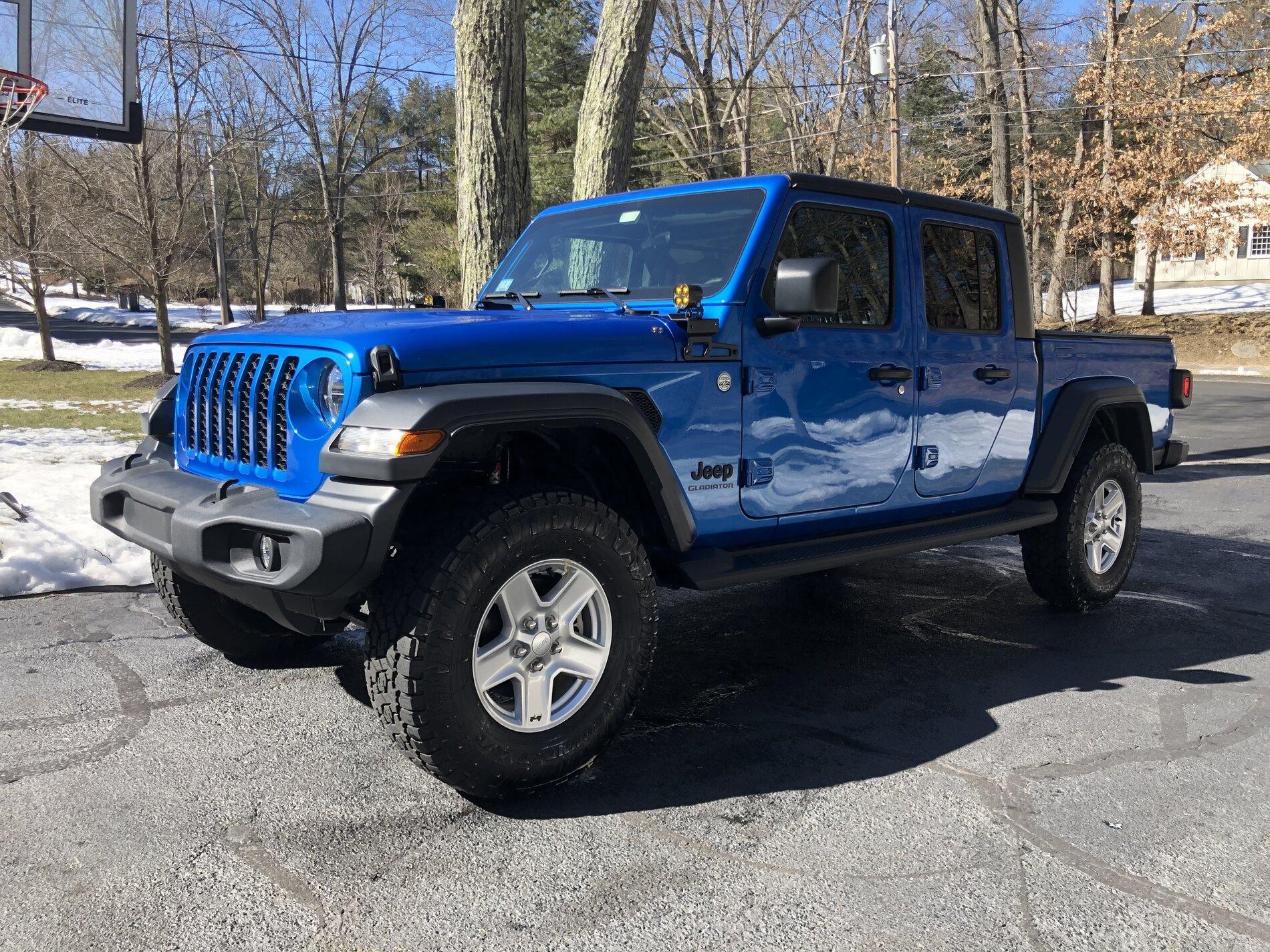

Max tow with 1.5” front .75” rear spacer and Toyo ATIII285/75/17 on stock wheels.
Jeep Gladiator Spacer Lift (to level) and Tires/Wheels on Max Tow 776E0535-B504-4914-99F4-8CAA34896D85
Love it! Thanks for sharing.

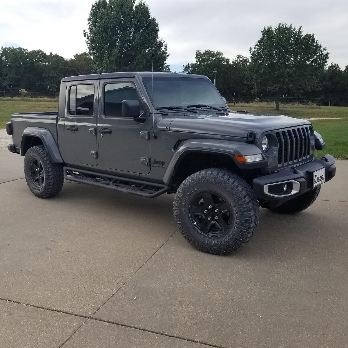

If you are only going to tow on rare occasions, don't worry too much about tire size and lift type, within reason. If you are going to tow often, stock form will always perform better. With bigger tires, re-gearing becomes necessary to maintain the torque and MPG values, and it gets quite expensive.
I plan to pull a small light overland camper with this rig, but only 4 or 5 times a year. 3" lift front, 1-3/4" rear, and 35's. May have to re-gear the 4.10's that the max tow came with to 4.88's.
Jeep Gladiator Spacer Lift (to level) and Tires/Wheels on Max Tow lift complete
Thanks for the pic - looks good! I think the biggest tire I'd go with is technically a 34". I figure by the time I'm ready to tow a camper my tires will be nearing the end of life anyway, so I should be able to get in some towing experience to see how it goes and then reduce back to a smaller size if needed.
