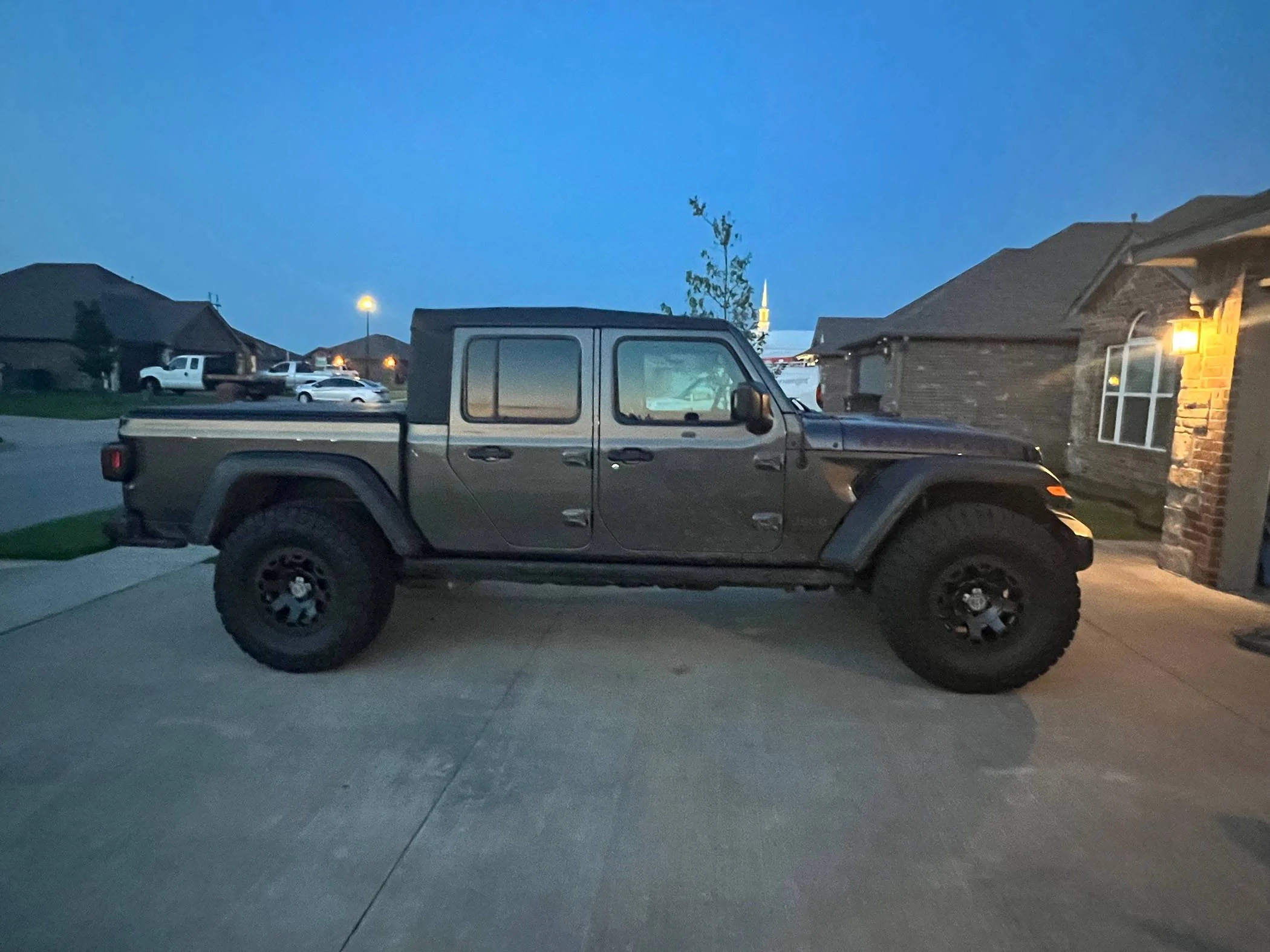

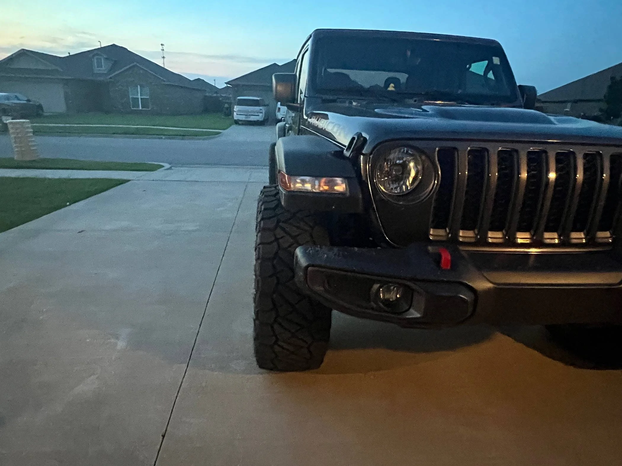

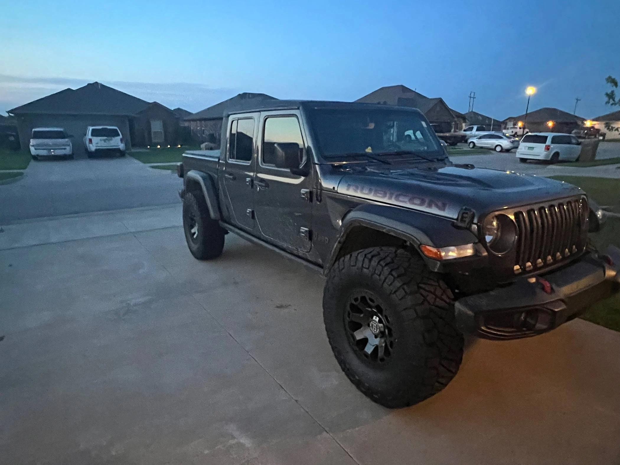

37x13.5x17 with -12 offset Rhinos. Installing lift Wednesday

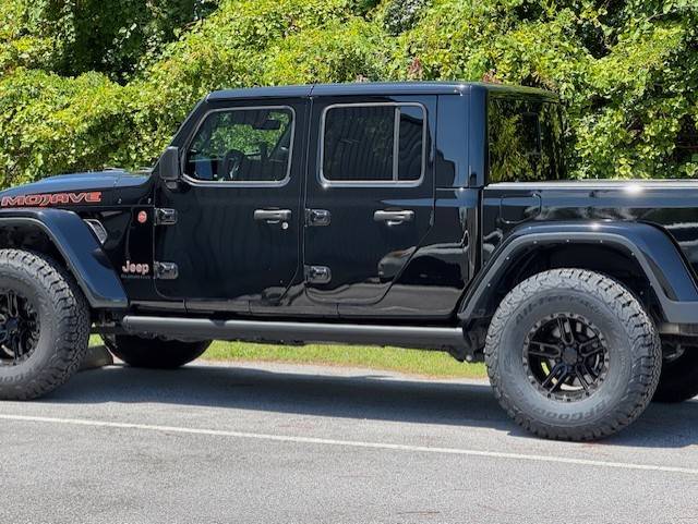

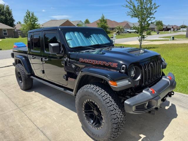

Here's my '21 with 37x12.50r17 BFG A/T KO2s. I have the AEV 2" Lift sitting in my office, just have to get off my butt this weekend or next to install it.
