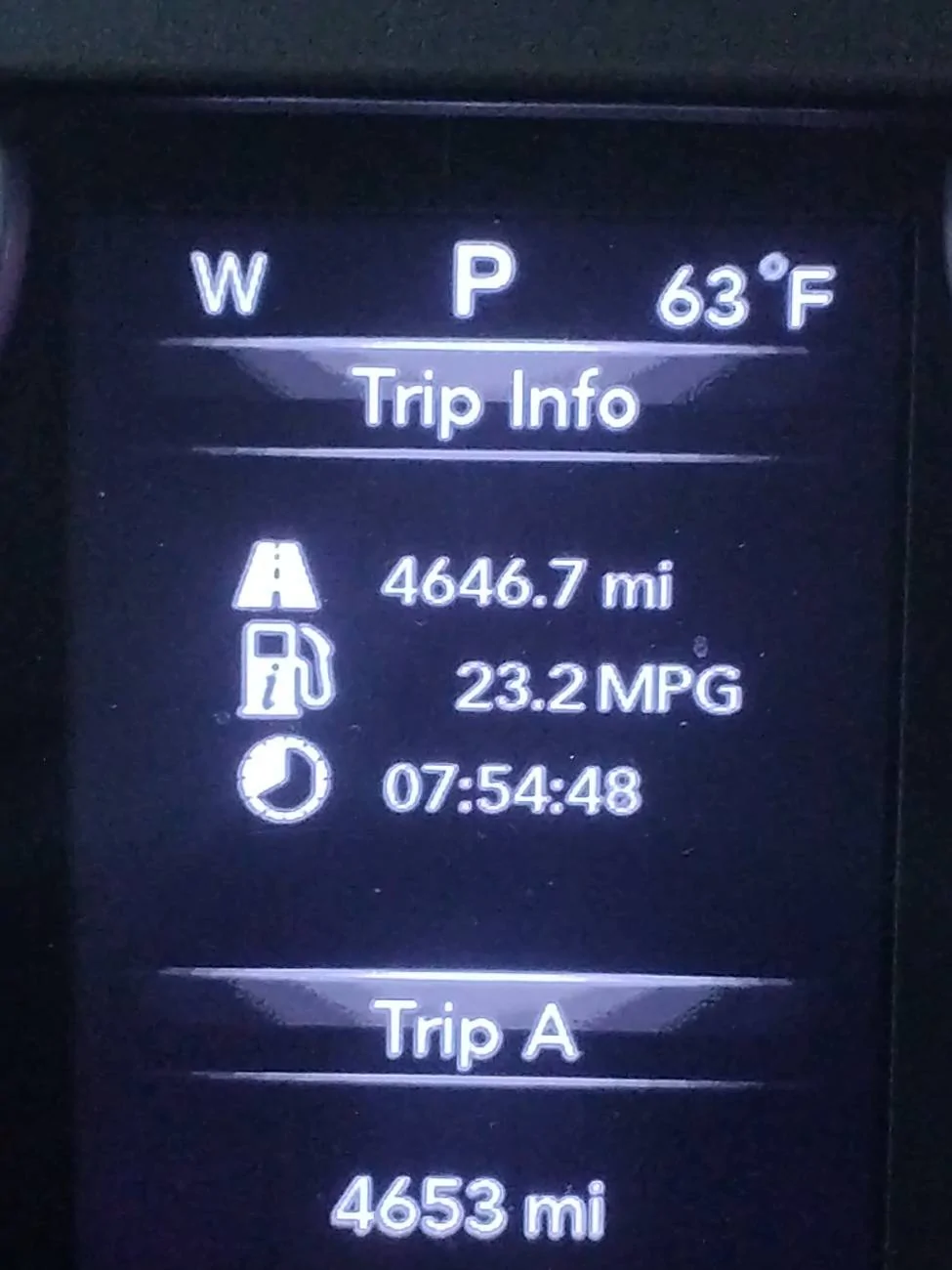

I know that it goes against the grain of what would be expected. I also know that not everyone will see the same results with some not even getting close. In reading the post you will see the same Gladiator but with the previous owner averaged nearly 10 mpg less. I have exceeded the mpg posted by the EPA on every vehicle that I even owned with the exception of a BMW X5 with the M Performance Package and I struggled just to reach it. On the final trip to trade it in I averaged 63 mph. My average RPM was around 1750. I had as many downhill grades as uphills. I did not use AC ( April). I drove with the instant mpg display on and tried my best to obtain the best fuel economy. That is what I got. On the way back with the Max Tow on my first tank my average speed was closer to 72 mph. My average rpm was around 2100. I only got 21 mpg. The true difference in tire size was about 5 inches in diameter/height. The wheel/tire weight was around 112lbs vs maybe 70 on the Max Tow. I averaged 23.2 up to around 5k and at that point went to 315's. I dropped down to a true 20.3 before correcting for the tire change with Jscan. After correcting on the first couple of tanks I have an average of 21.9 mpg in combined driving. I will drive several thousand miles after the lift and report back. I only post from my personal experience and not what I read or had seen somewhere. I simply reported my experience to tell others what is possible and not what they will experience. I had a Charger Hellcat and averaged over 21 mpg. I had a Ram 2500 with the 6.4 and averaged about the same. It's all in how you drive.

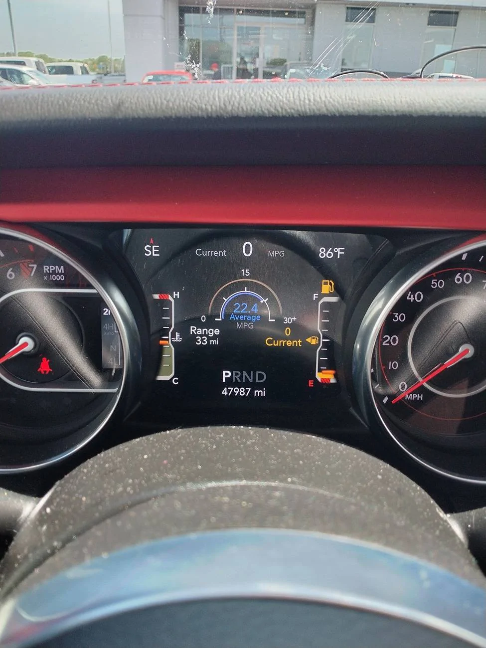

Also I have hand figured my fuel economy on all three Gladiator's as well as tracked it on the EVIC which is pretty close to accurate. With the larger tires and no other changes your RPM is lower at any given speed. On my Rubicon w/37's I drove it nearly 500 miles to trade it in on this Gladiator with Max Tow. This was through East Tennessee up to Norfolk, Virginia on far from flat ground. I got 23 MPG hand figured. On the Max Tow coming back OEM 245/75r17's I struggled to even hit 21 MPG. Same route, same gear, same driver. The change was in RPM at say 65 was 350 to 400 RPM higher depending upon torque converter lock up.
