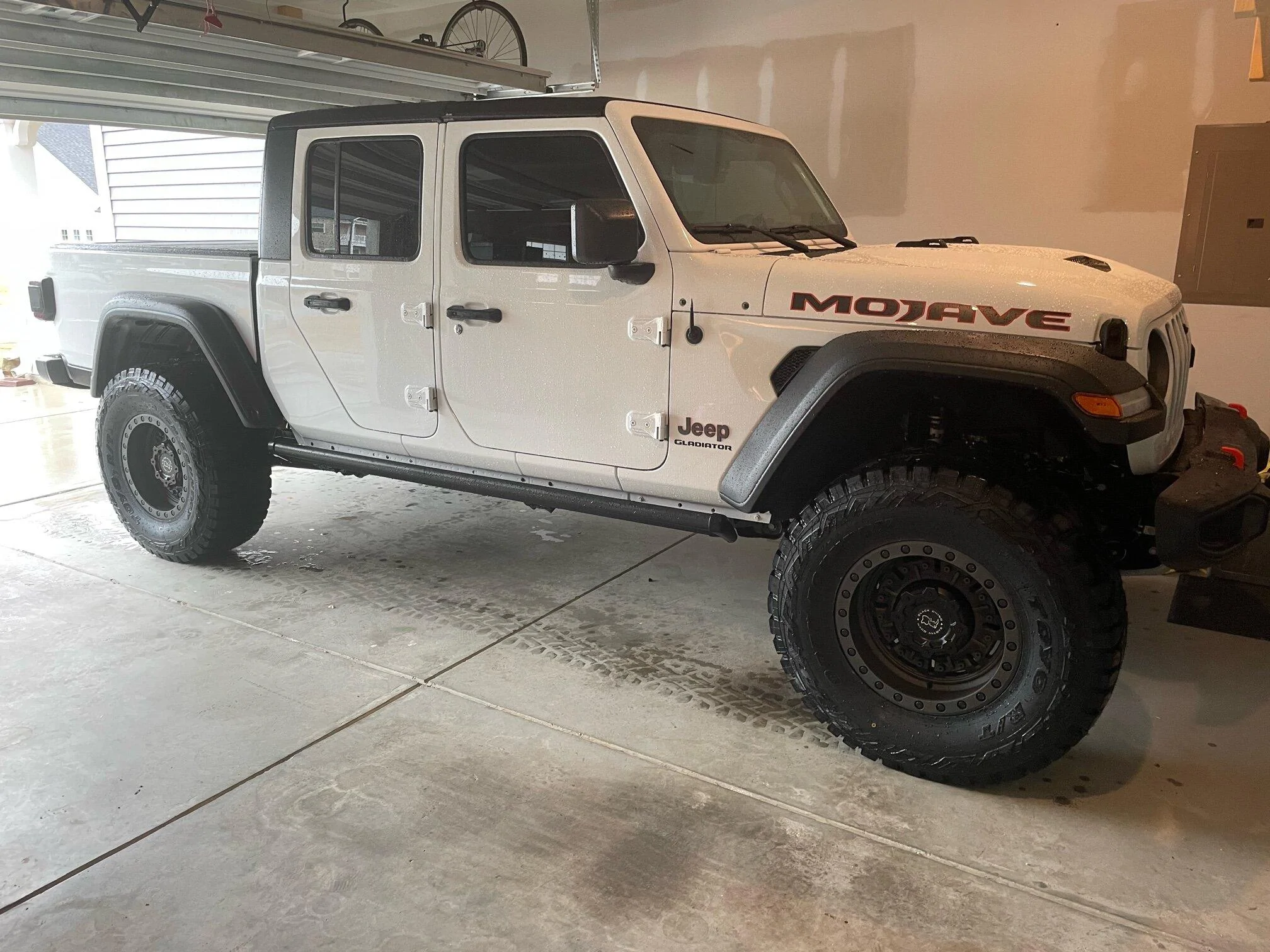

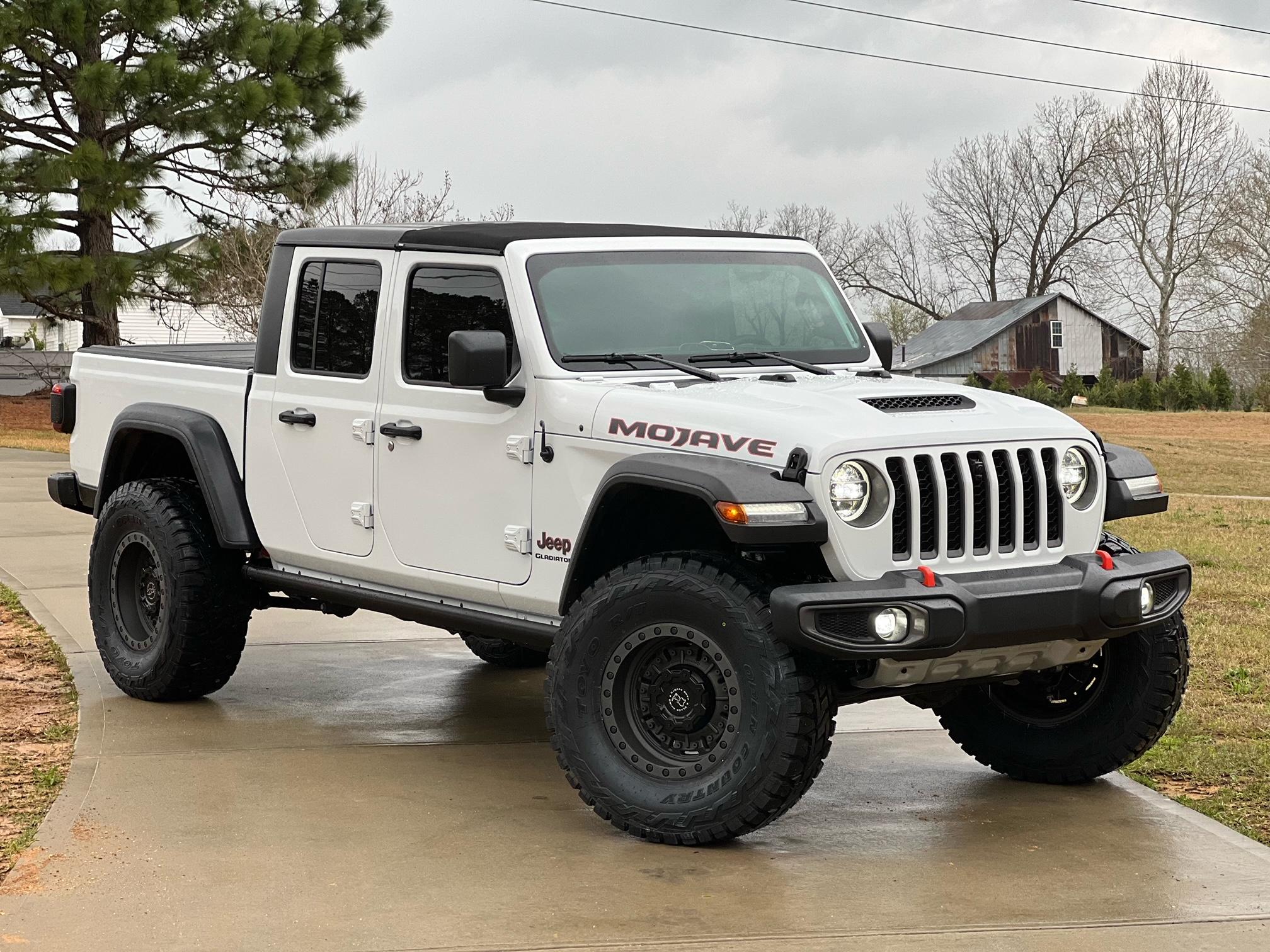

Looks good. I just joined this group. I have a White Mohave with 37" x 13.5 Toyo RT's on 18" Black Rhino Abrams.
I went a different route on the lift as others on this thread to keep my original Fox Suspension. I have a 3.5 in Coil Spring Kit Part Number 13650000. Then Alpine lower control arms . Shock Extensions. Forged Track bars front and read. Fox Racing ATS Steering Stabilizer. It rides better than stock.
So basically I have a lift with keeping stock Shocks on 37" tires. I tried the no suspension lift with 37" tires and I felt I had no room to flex in the wheel well and front bumpers. My opinion tho. I love seeing all the ones that completed it on stock suspension.

I’m new to the site and wanted to ask how you like the Black Rhino Abrams ? That’s the gun metal correct ? It’s hard to see the picture clearly . Thank you for any feedback

Yes, they are the Gun Metal Black. I love these rims. This setup rides so good. I actually took it to work today as the weather was so bad and I was doing 70 in pouring rain with no issues. No shake in the steering wheel like other Jeeps I have owned. This rides better than stock.

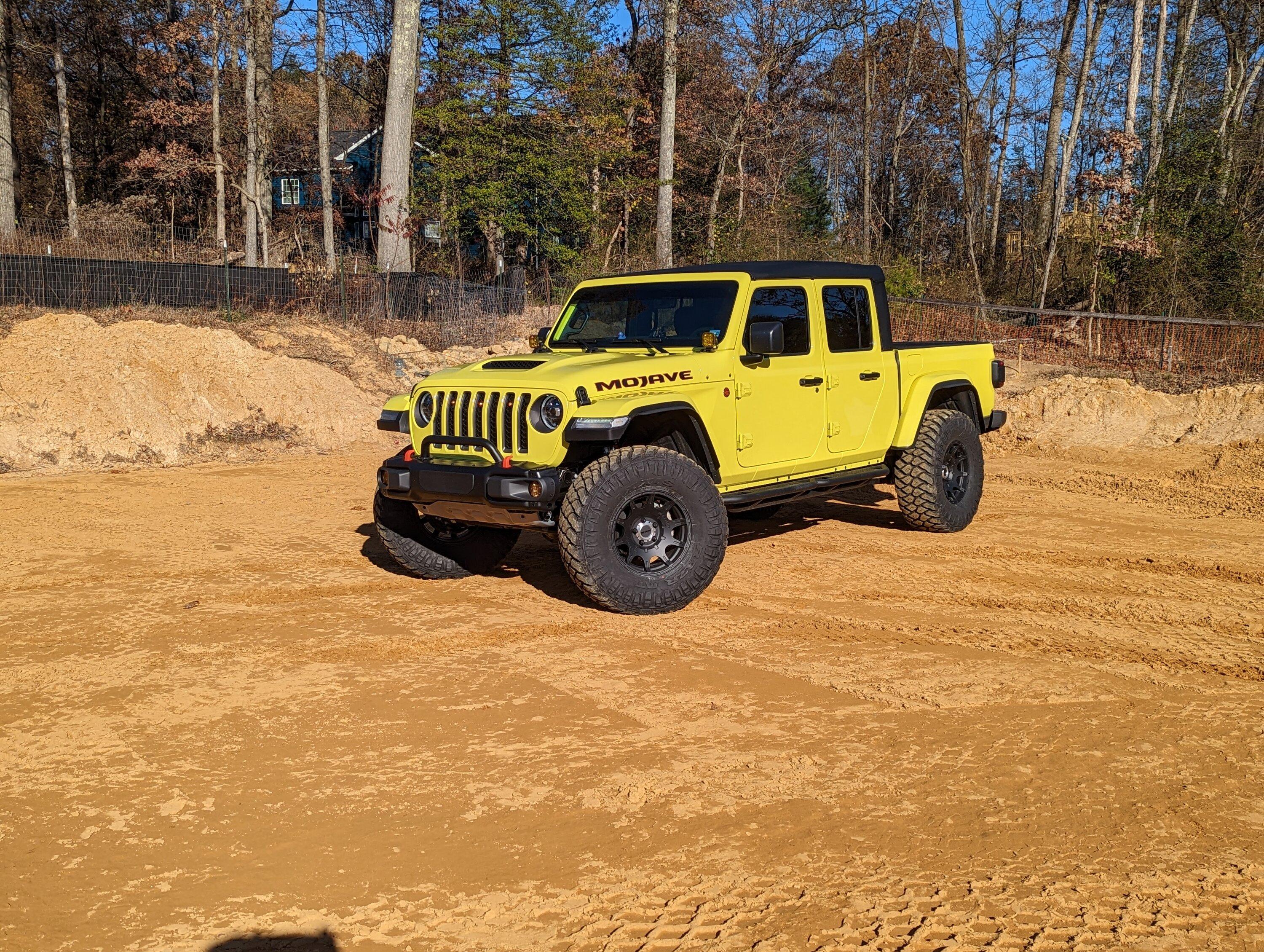

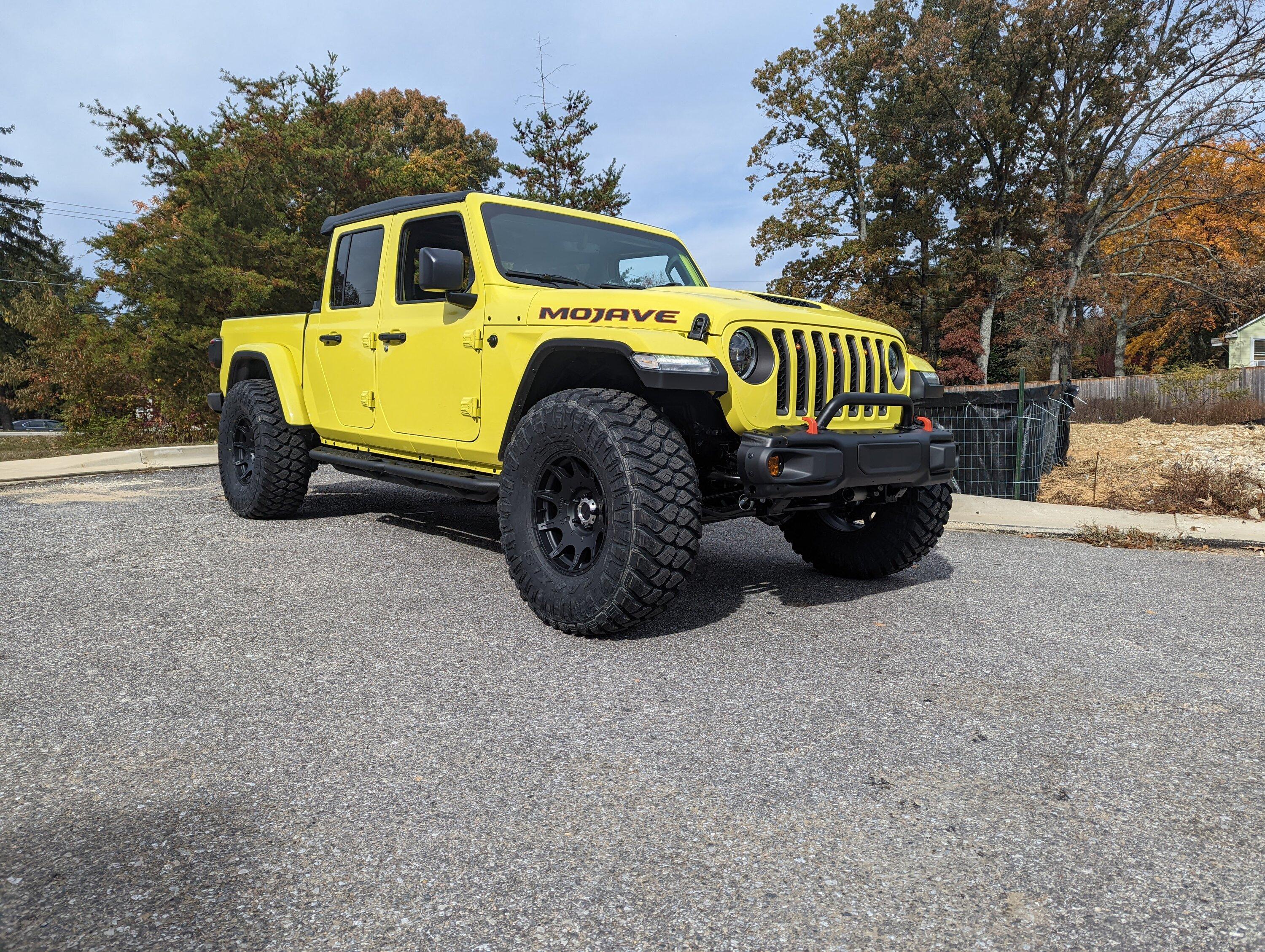

No lift with 37s and with the AEV kit

Are they the Rhino Adams gun metal ?

They are black Rhino Abrams
