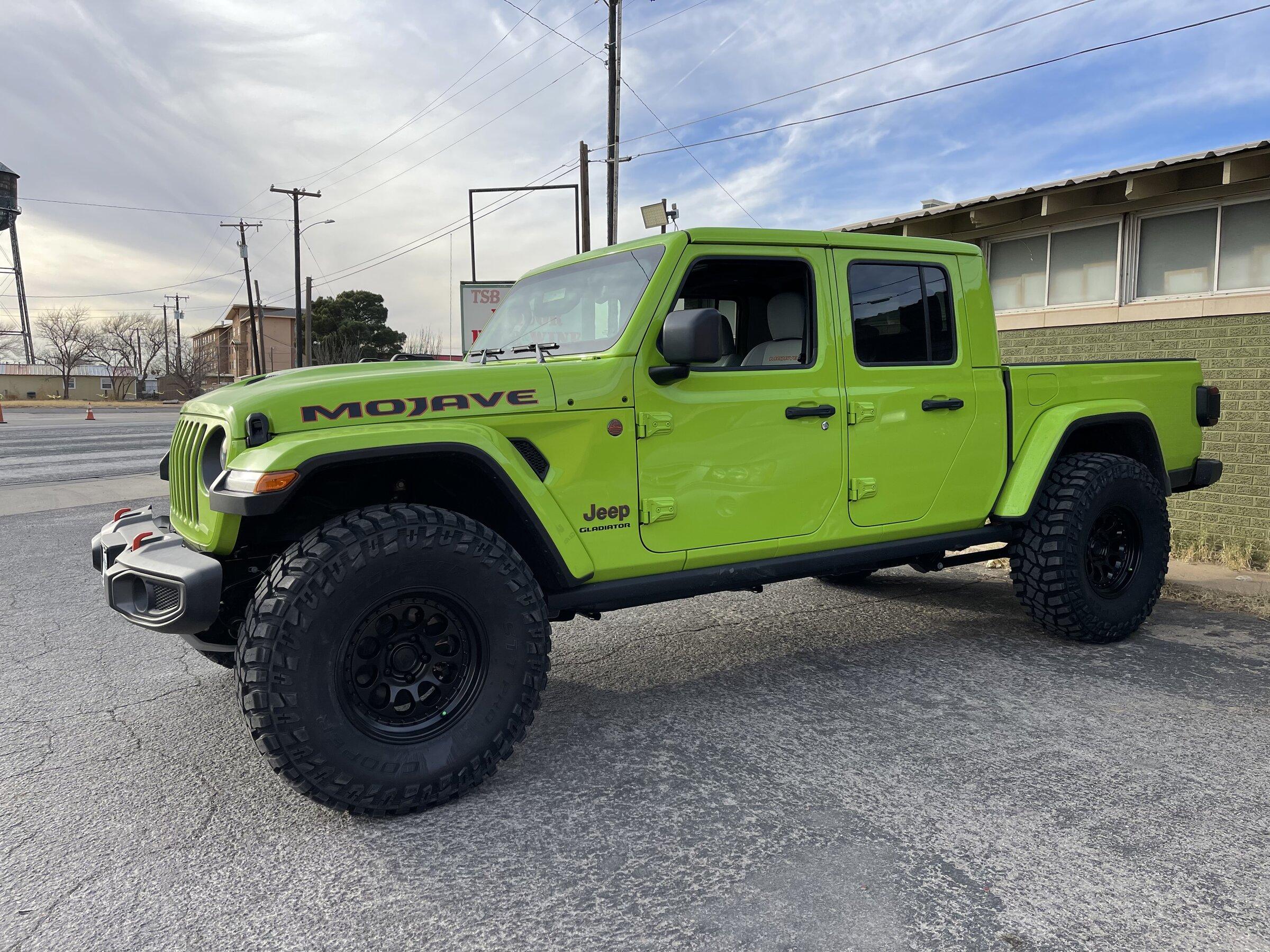

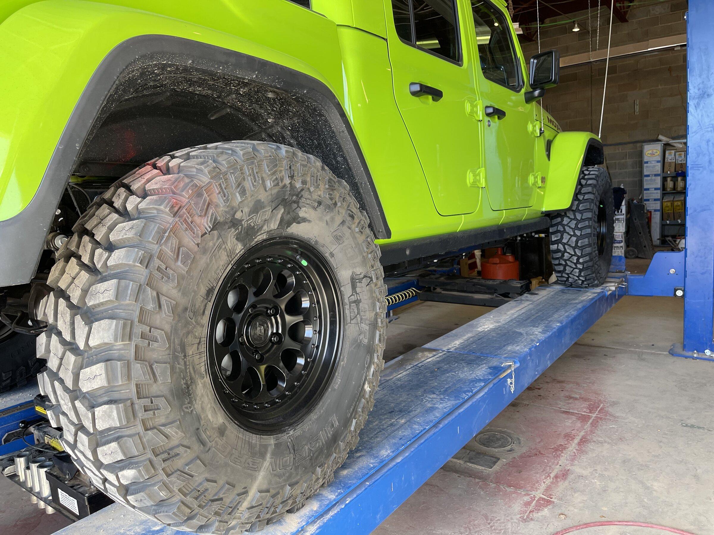

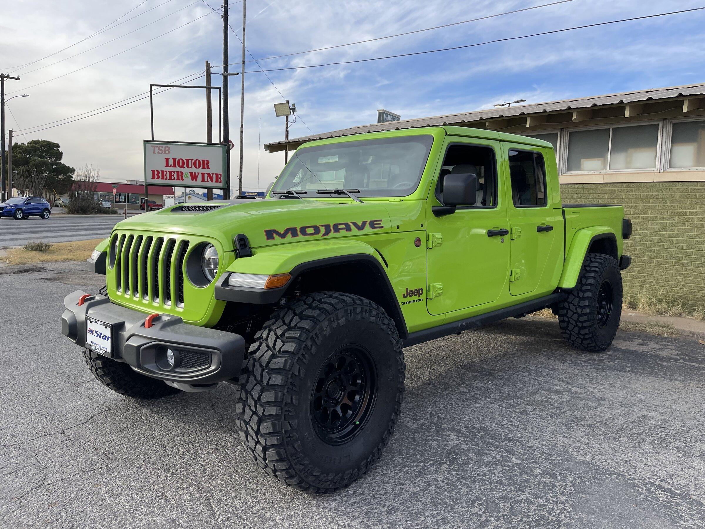

Edit to prior post. I had rubbing in the wheel well when I hit curbs/large rocks at speed. With 37 Patagonia on stock rims. No rub at full lock though. Only hitting obstacles. I added the aev 2 inch kit, photos below for what it looks like before and after. 4wp installed for $630 and the kit cost $440. Problem solved.

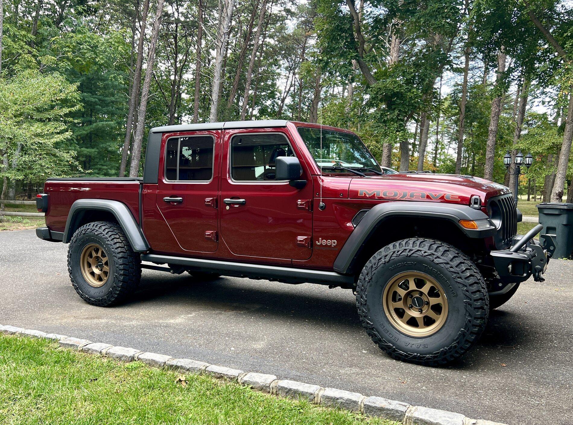

I have a Snazz Mojave as well and am looking at bronze (even though the wife says its ugly) wheels too. Can you provide the specs for this setup?
I was a big fan of the bronze, wheel specs 17x8.5 4.75” backspacing. Had a little poke but not a lot, had AEV wheels on it before that and the extra backspacing of the Methods definitely made the jeep look more aggressive.

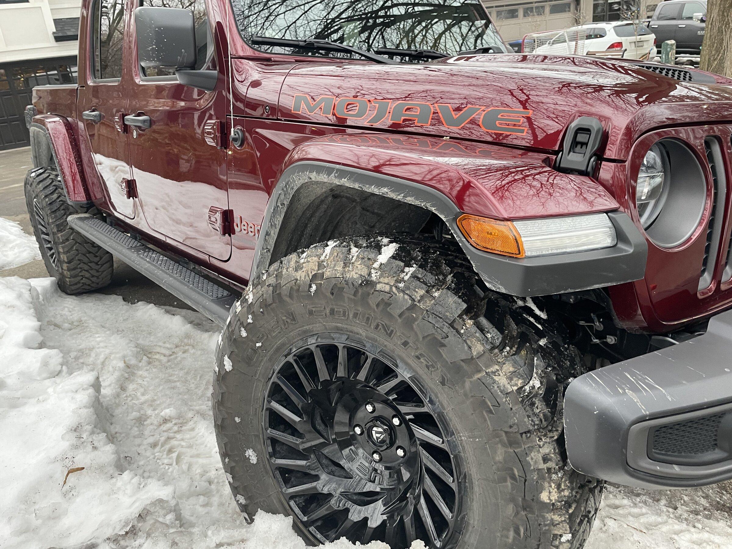

Thanks for the response! Guess I was late to the party lol...
Nice setup! I am looking for specs because I don't want a ridiculous amount of poke. Can you give me some more detail on yours? How much tread do you have coming past the fenders (if any)?
I'm not trying to do any lift or aftermarket fenders (I did enough when I had my JK), so Im keeping much of the Mojave stock.

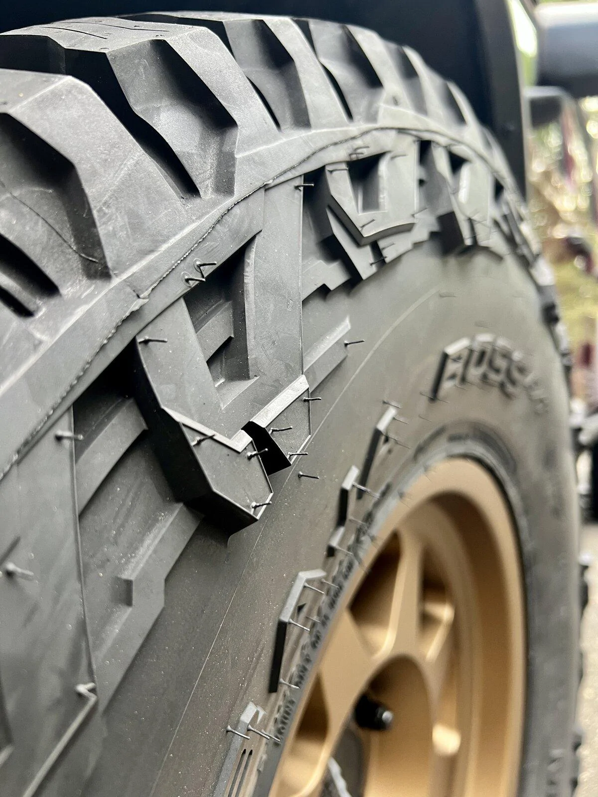

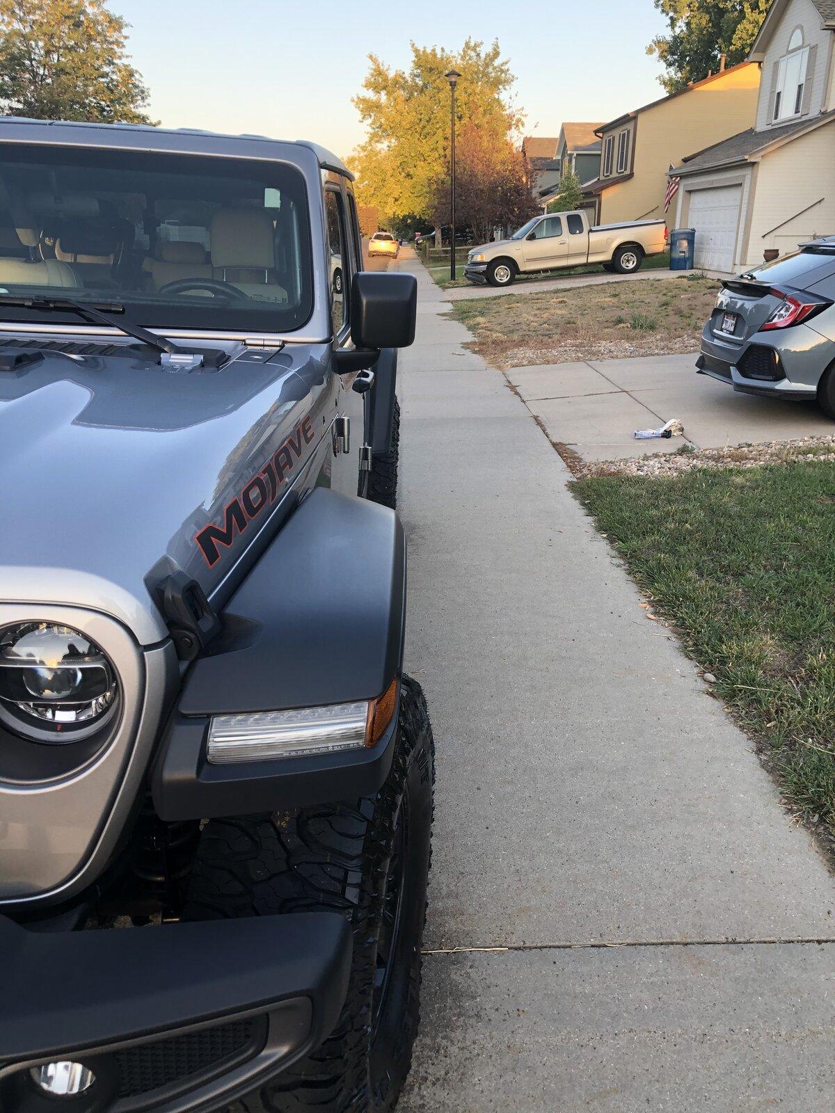

My methods are also 4.75” backspace. 12.50”/37” tires.
Jeep Gladiator Stock Mojave w/ 37s Thread 0059F950-6F9D-461C-8DC4-A864F89B3A4D

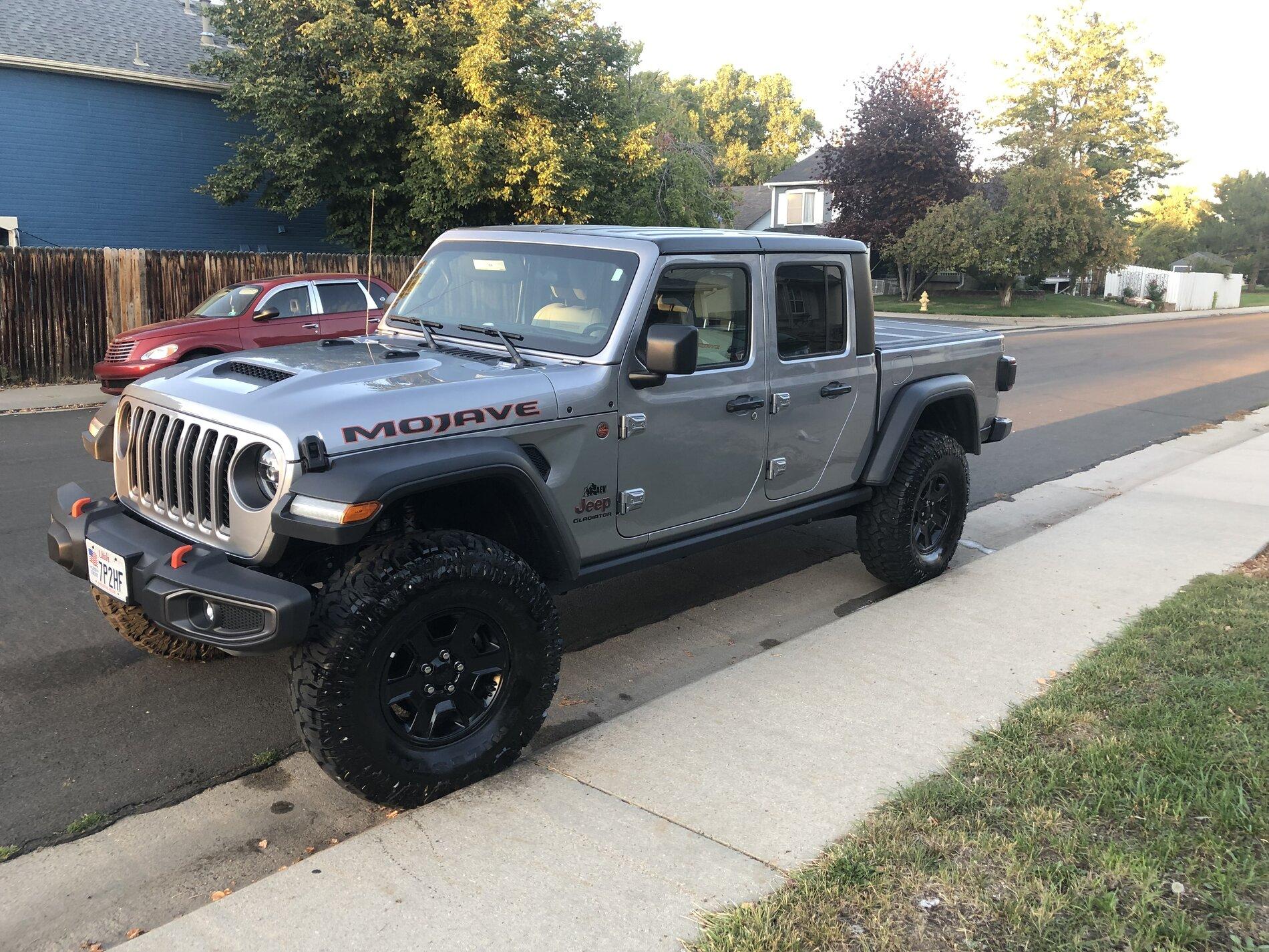

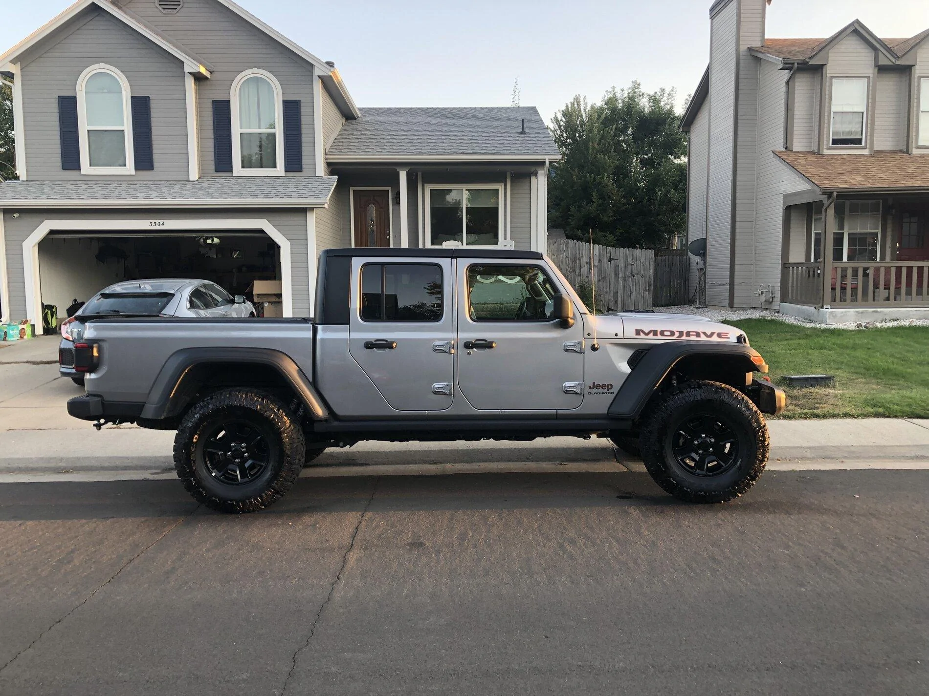

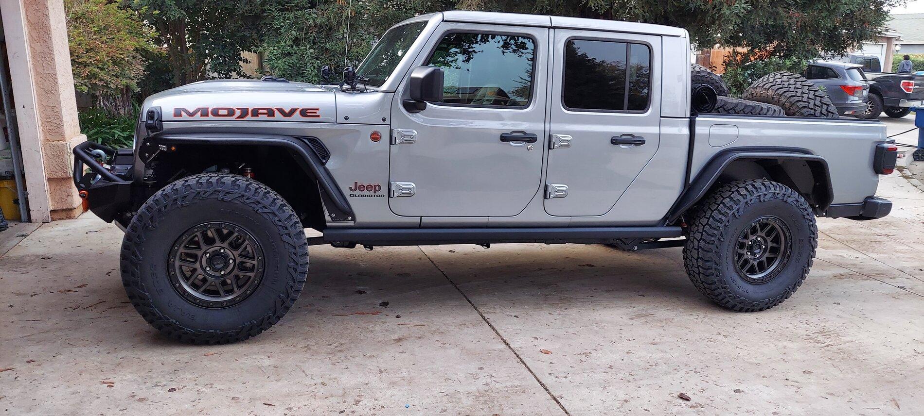

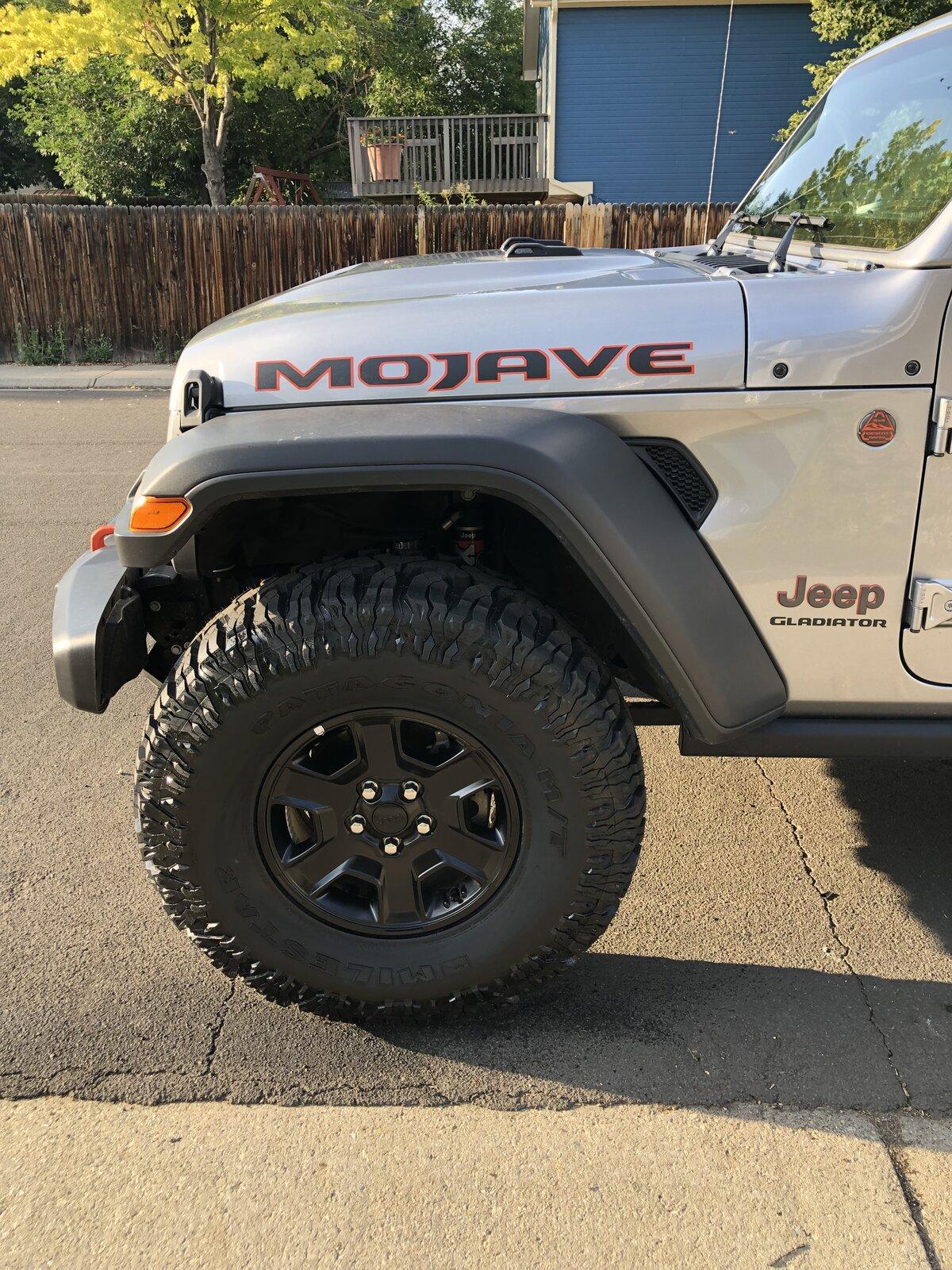

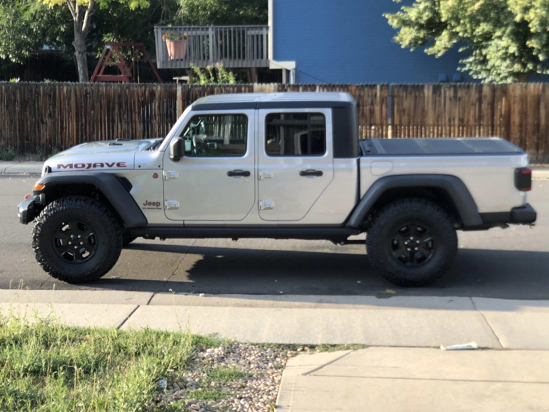

Jeep Gladiator Stock Mojave w/ 37s Thread 7E5583F0-F1BE-4334-AB8A-49EBD1B5F486

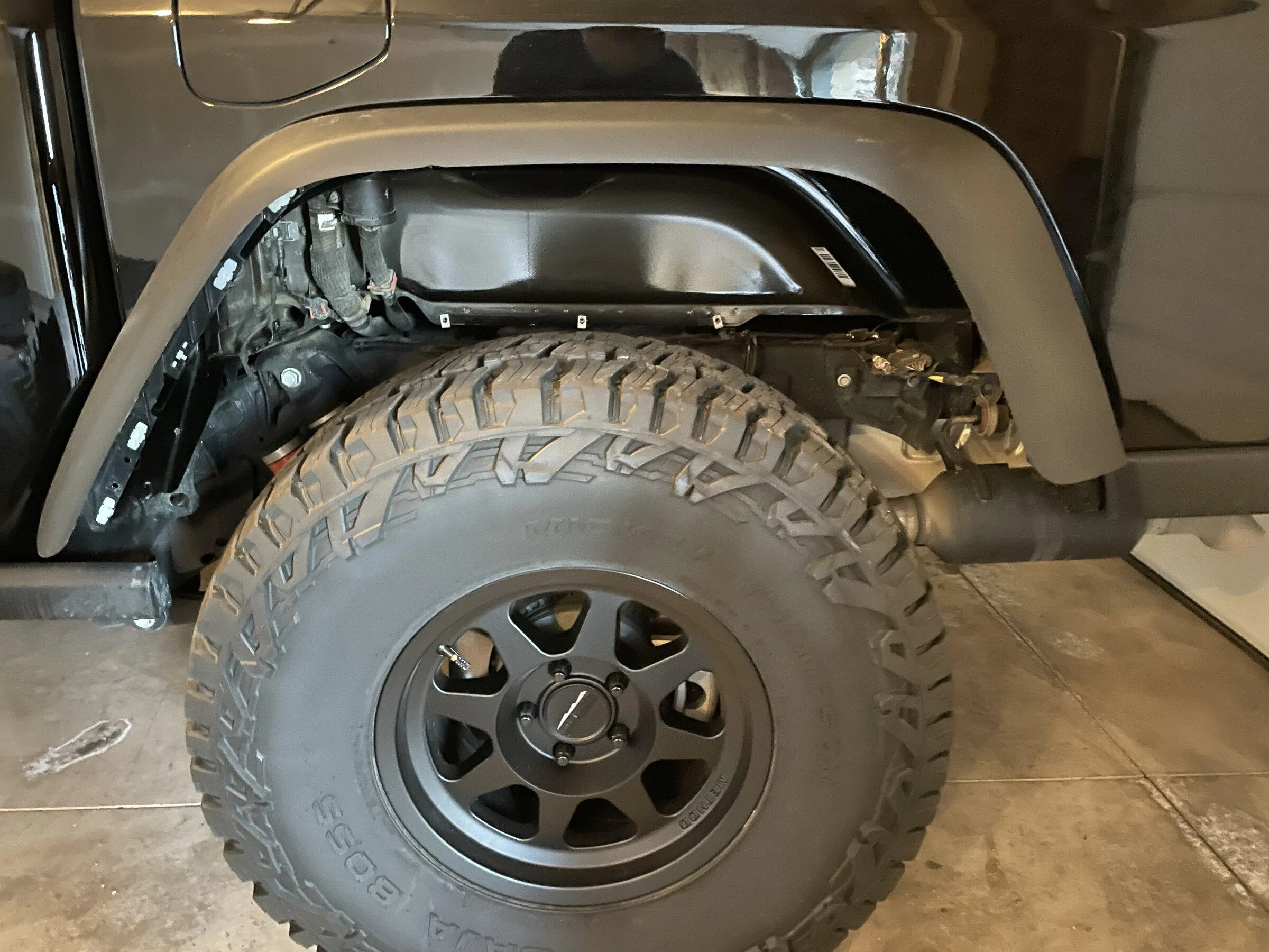

Stock Mojave Suspension
17 inch Method 701’s (Zero Offset)
37x12.50x17 Mickey Thompson Baja Boss ATs
zero rubbing in daily driving and on road use, minor rubbing when flexed in rear off road but a fender chop eliminated that entirely
Jeep Gladiator Stock Mojave w/ 37s Thread AA6D0482-3C2E-47E8-B969-339C2DBB3306

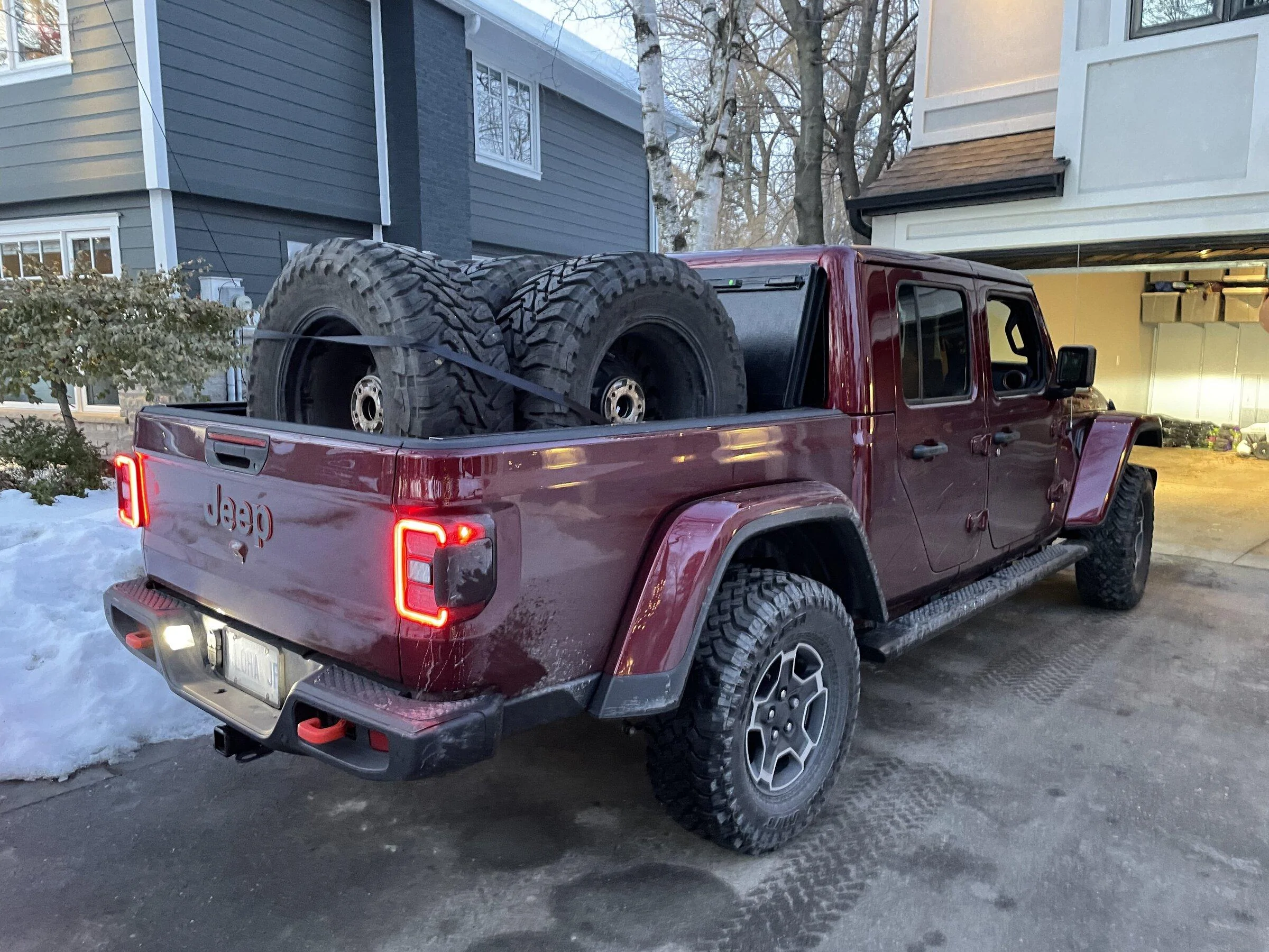

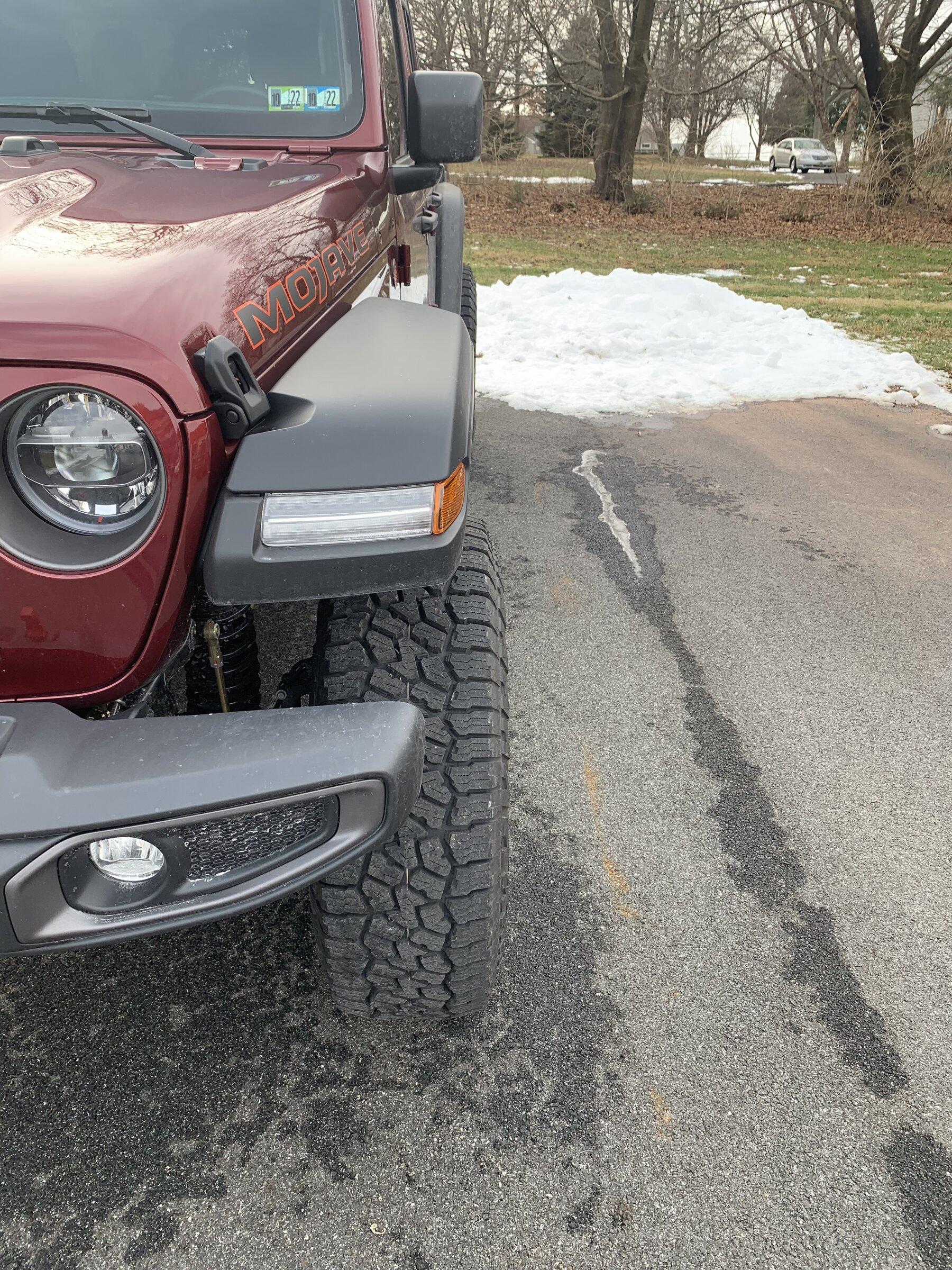

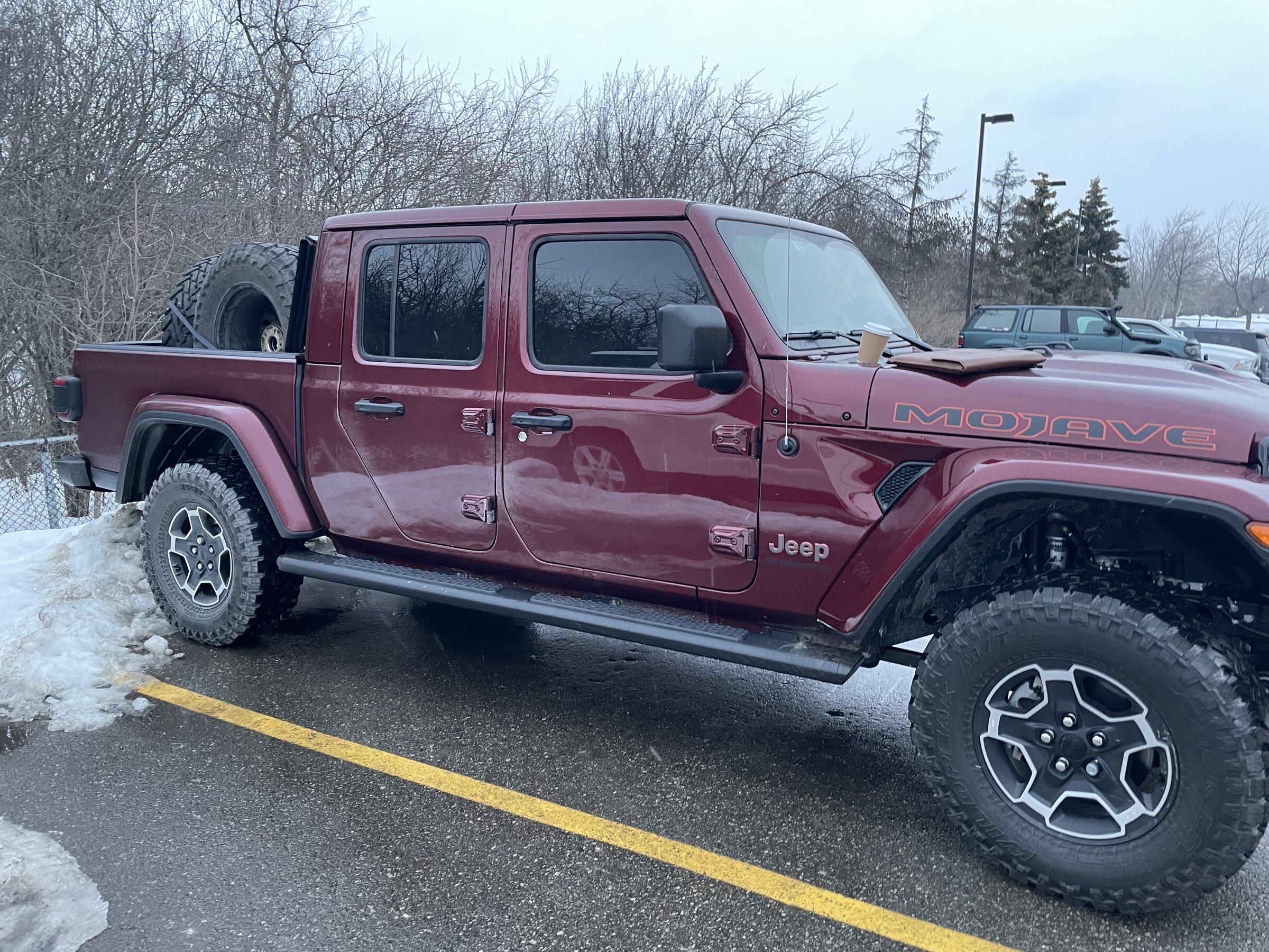

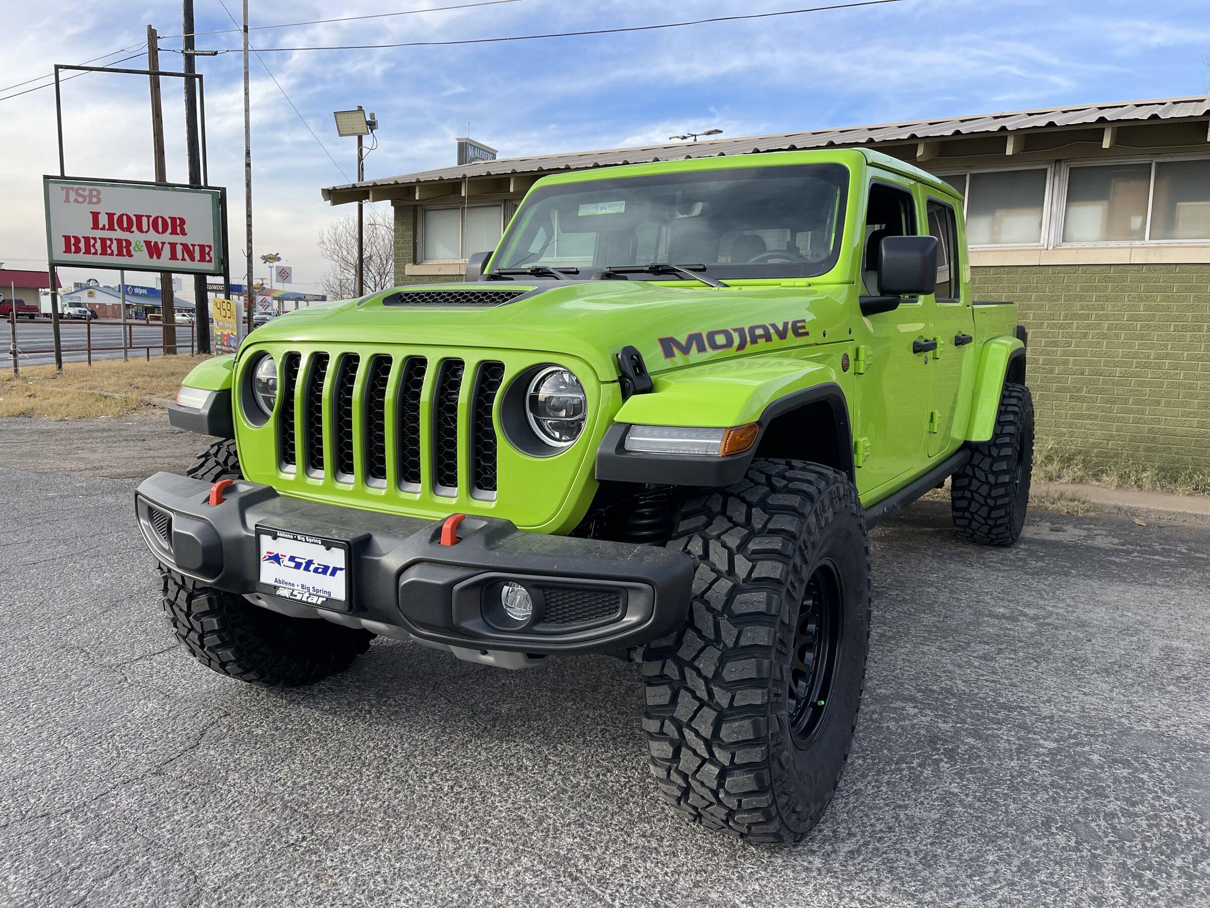

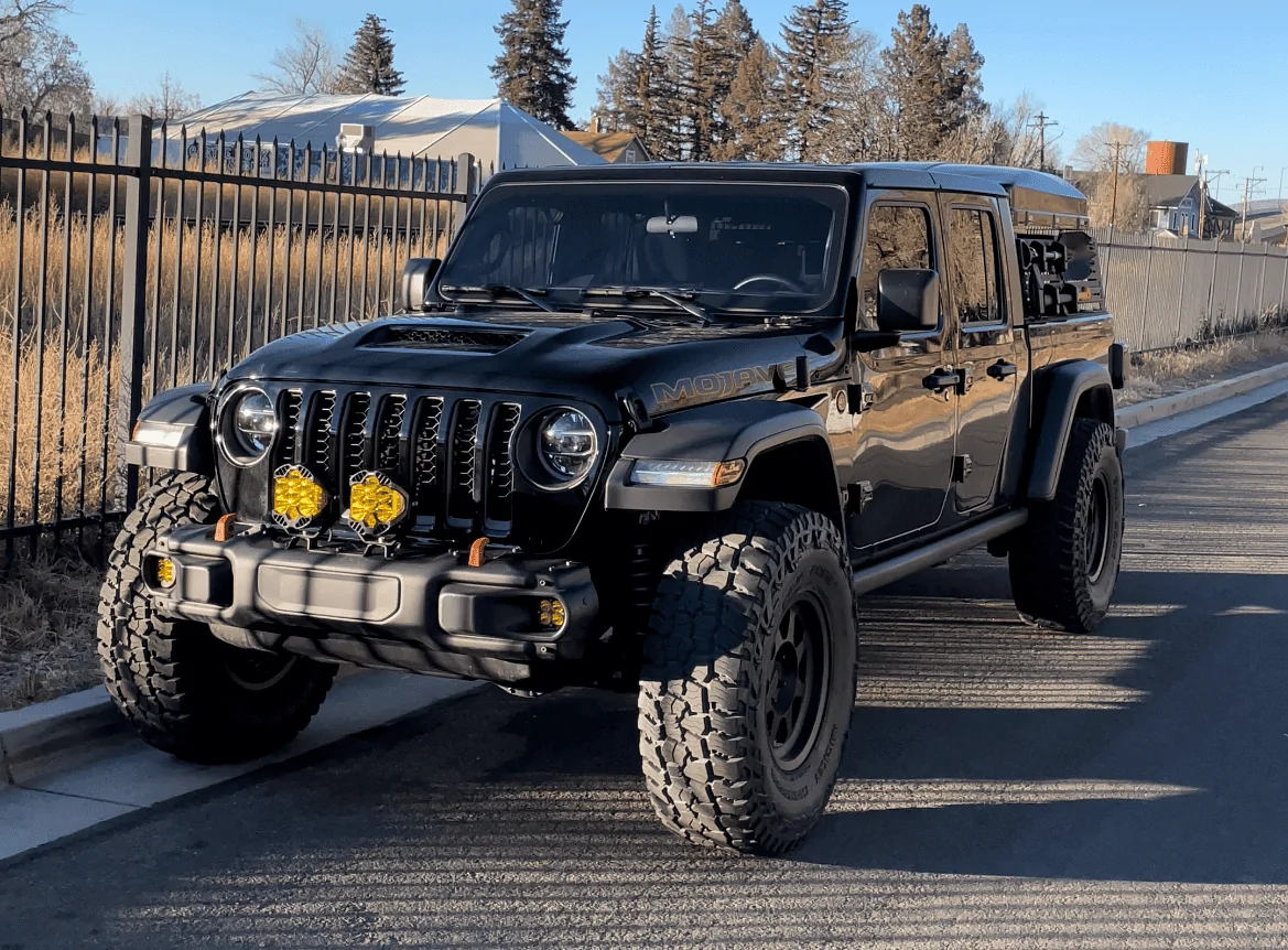

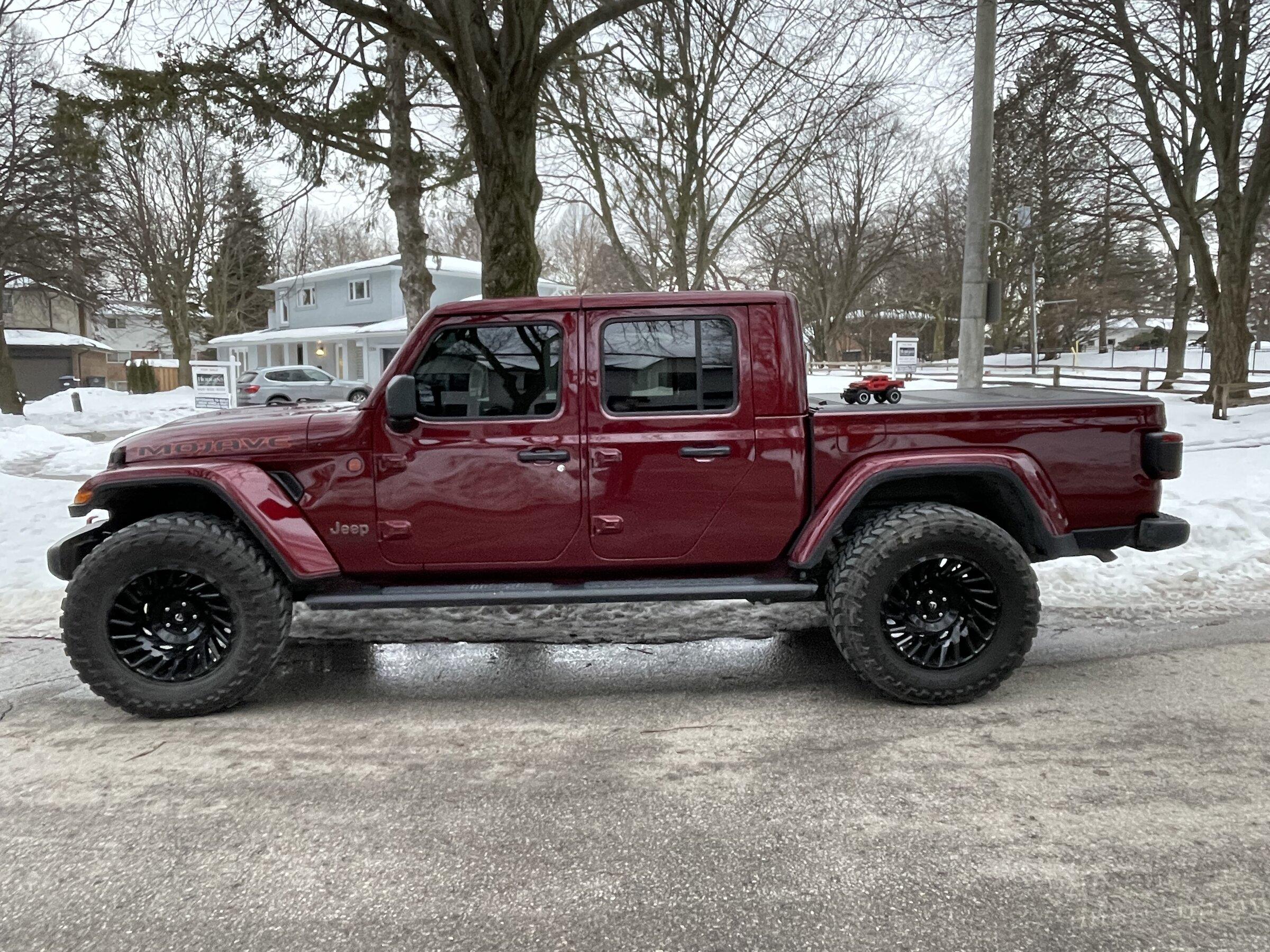

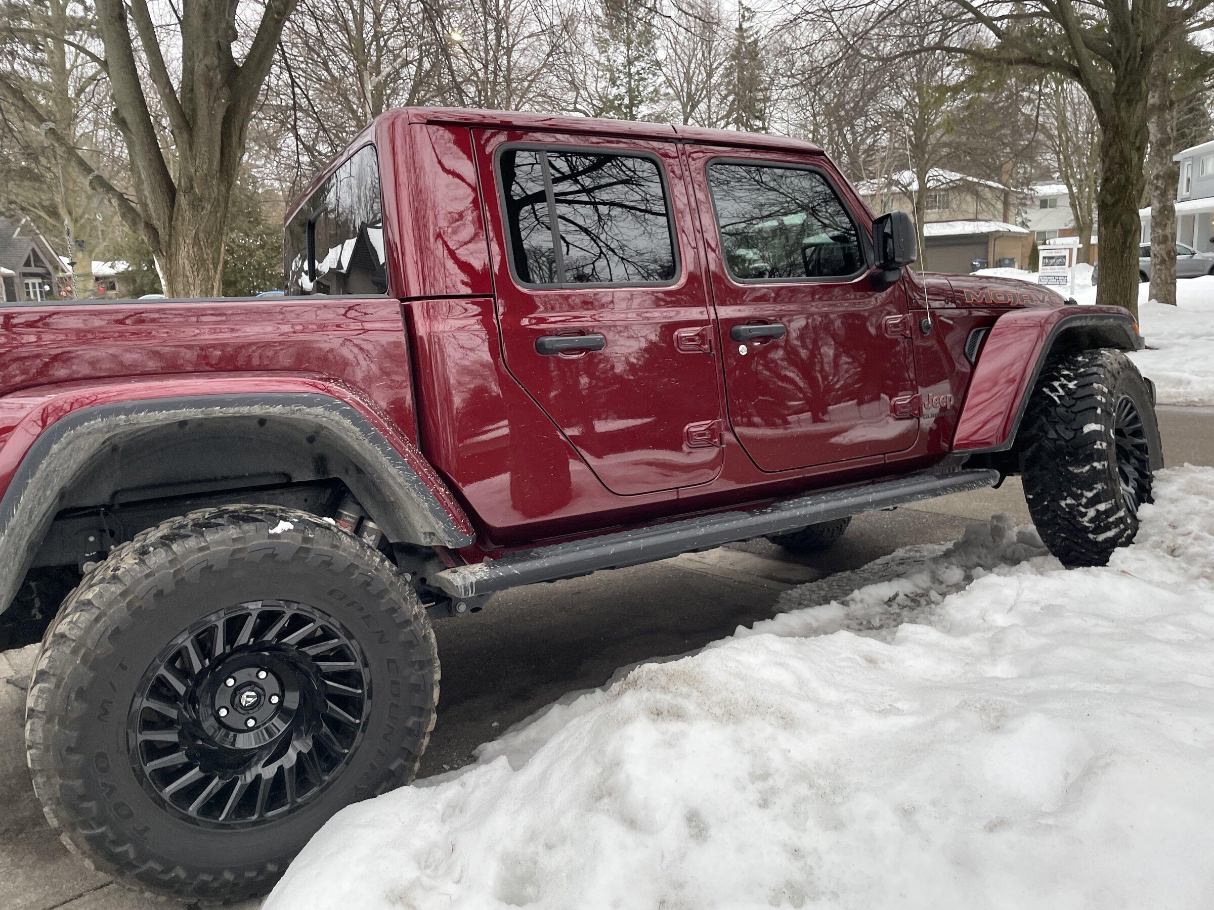

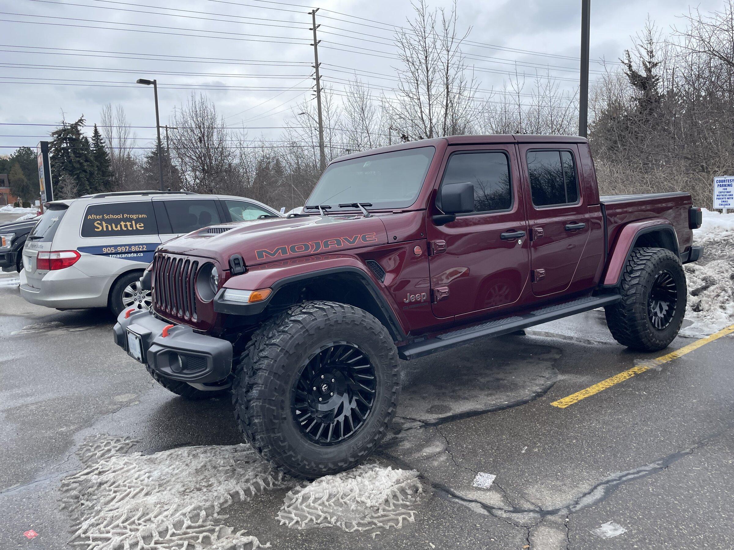

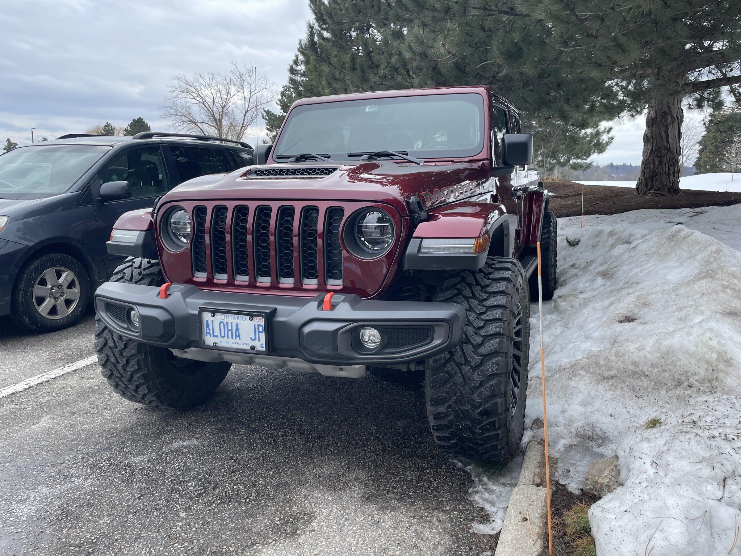

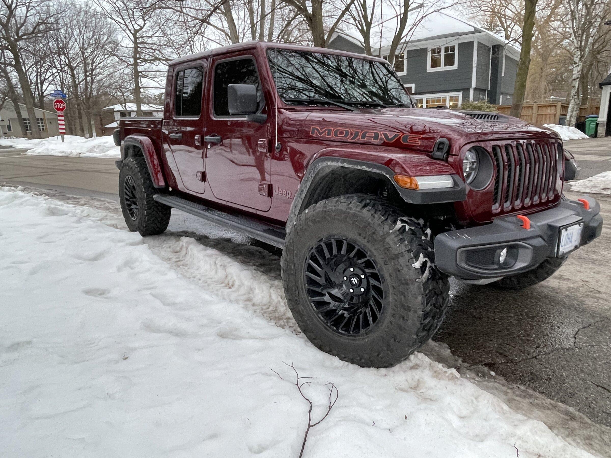

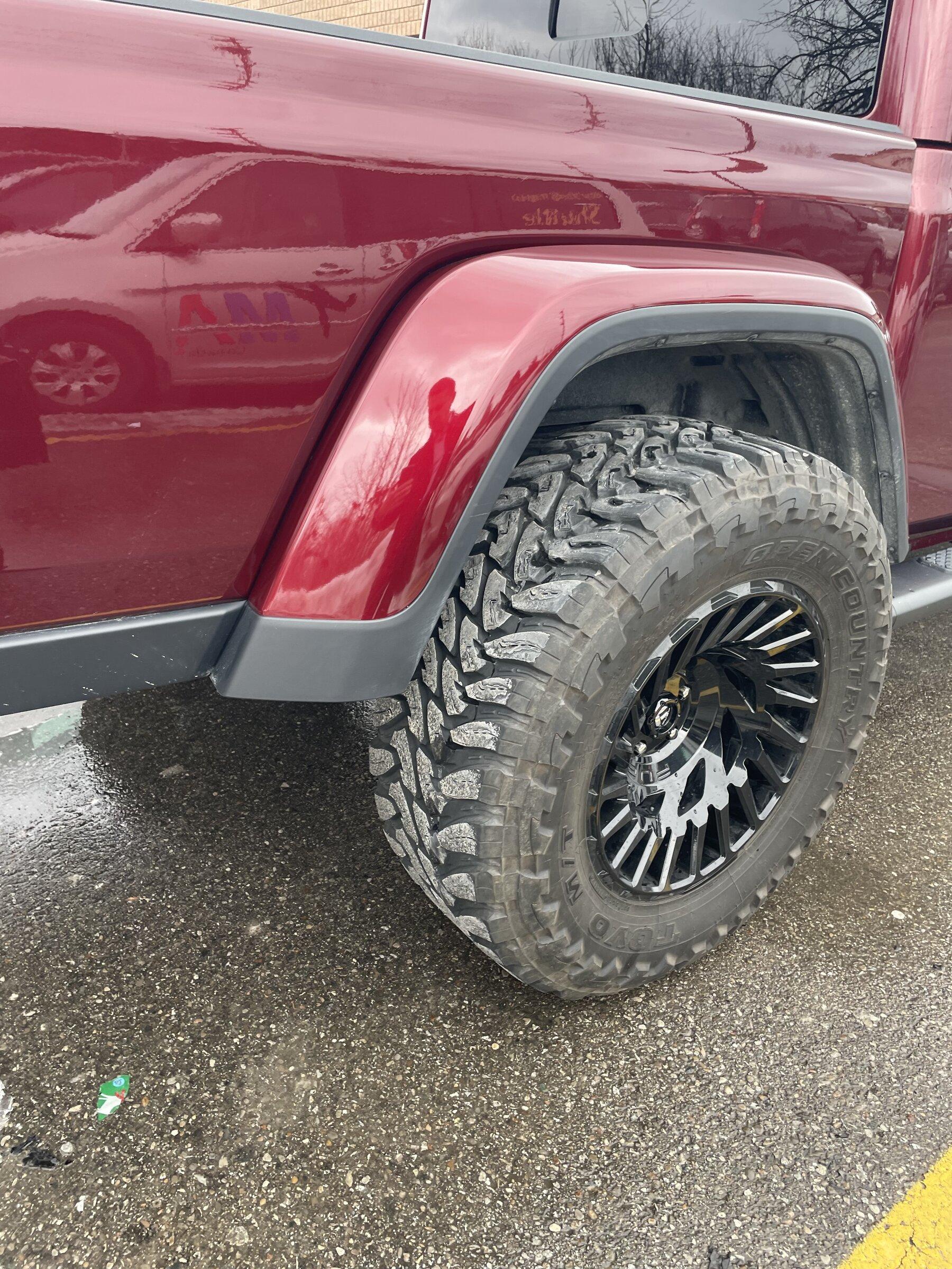

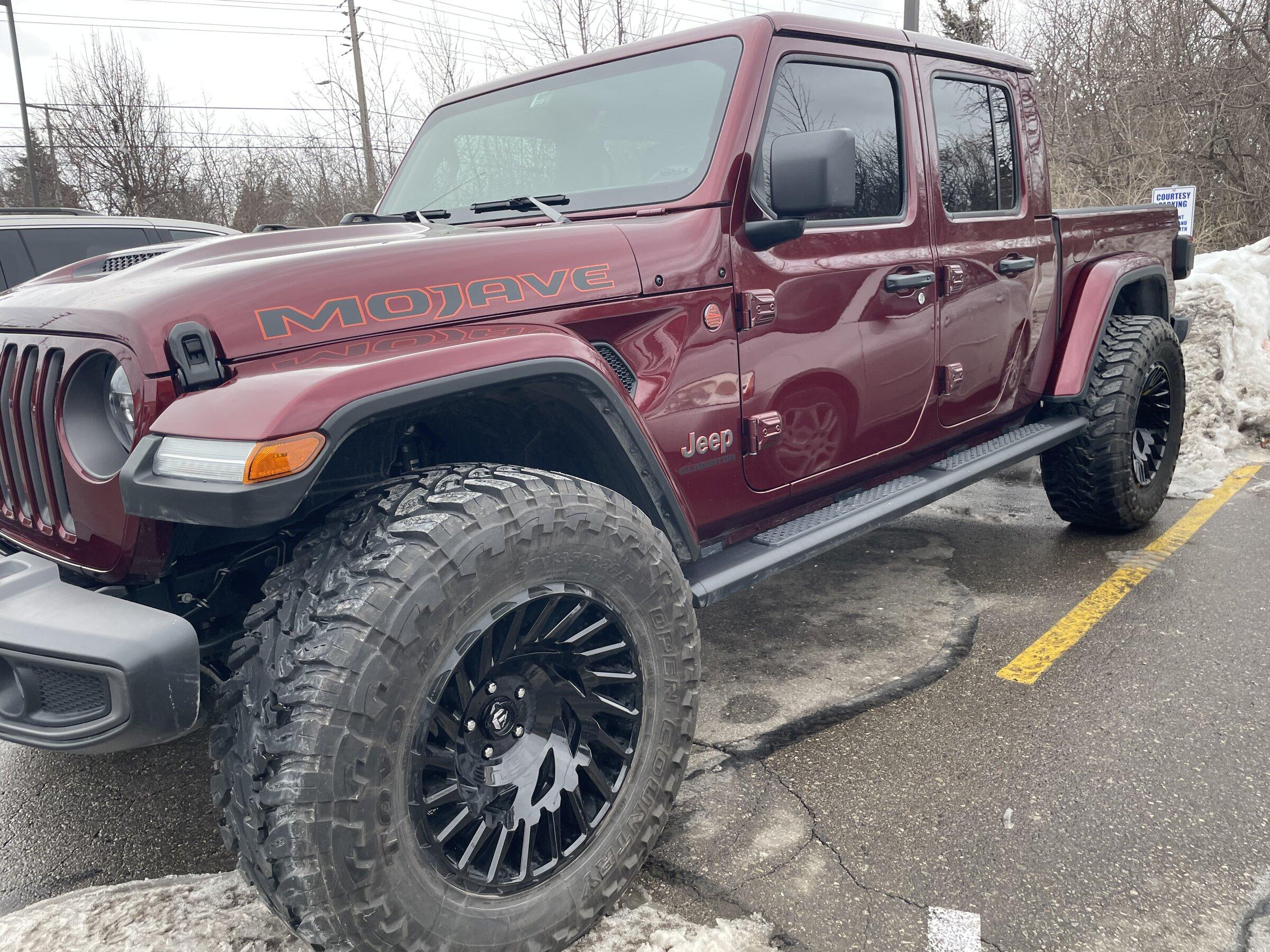

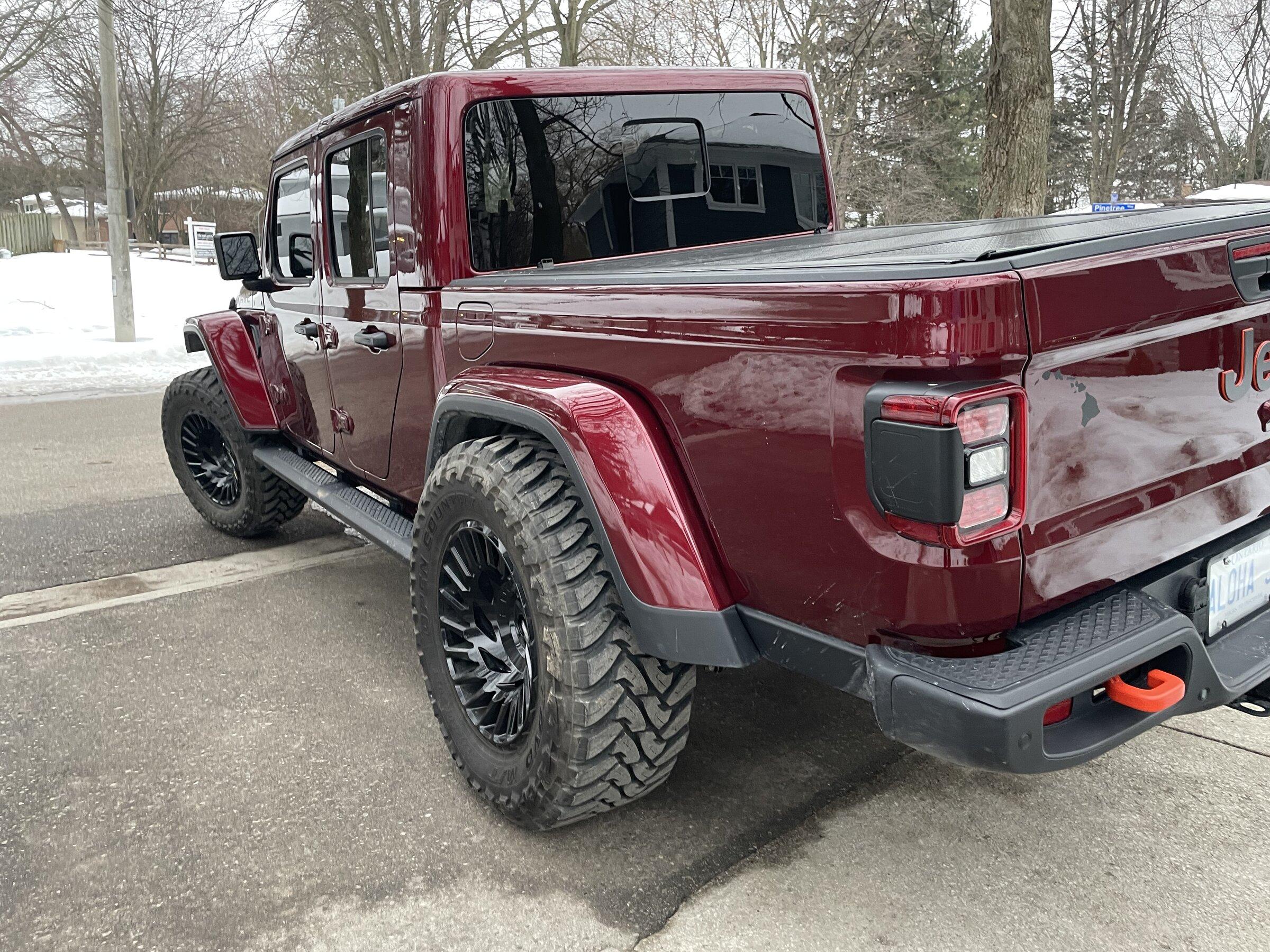

This thread helped, so I registered and will contribute my photos.
No lift Mojave
17x8.5 -10 wheels
37x12.5R17 STT Pro (discount tire website shows 36.77”)
Absolutely no rub on road, will update later after overland style trips for any rubbing.
Jeep Gladiator Stock Mojave w/ 37s Thread 504B6486-6A65-4FA7-A561-AB66D876403D
Jeep Gladiator Stock Mojave w/ 37s Thread 7B89D665-812B-43B1-B9BD-52B2AFB44A4E
Jeep Gladiator Stock Mojave w/ 37s Thread D6E1A0A6-D57C-4656-AEA2-66C41C838AA9
Jeep Gladiator Stock Mojave w/ 37s Thread 92D32C36-CA1D-4E56-B3FD-4DBE2DBC1D0A

Gnarly beast!!!
