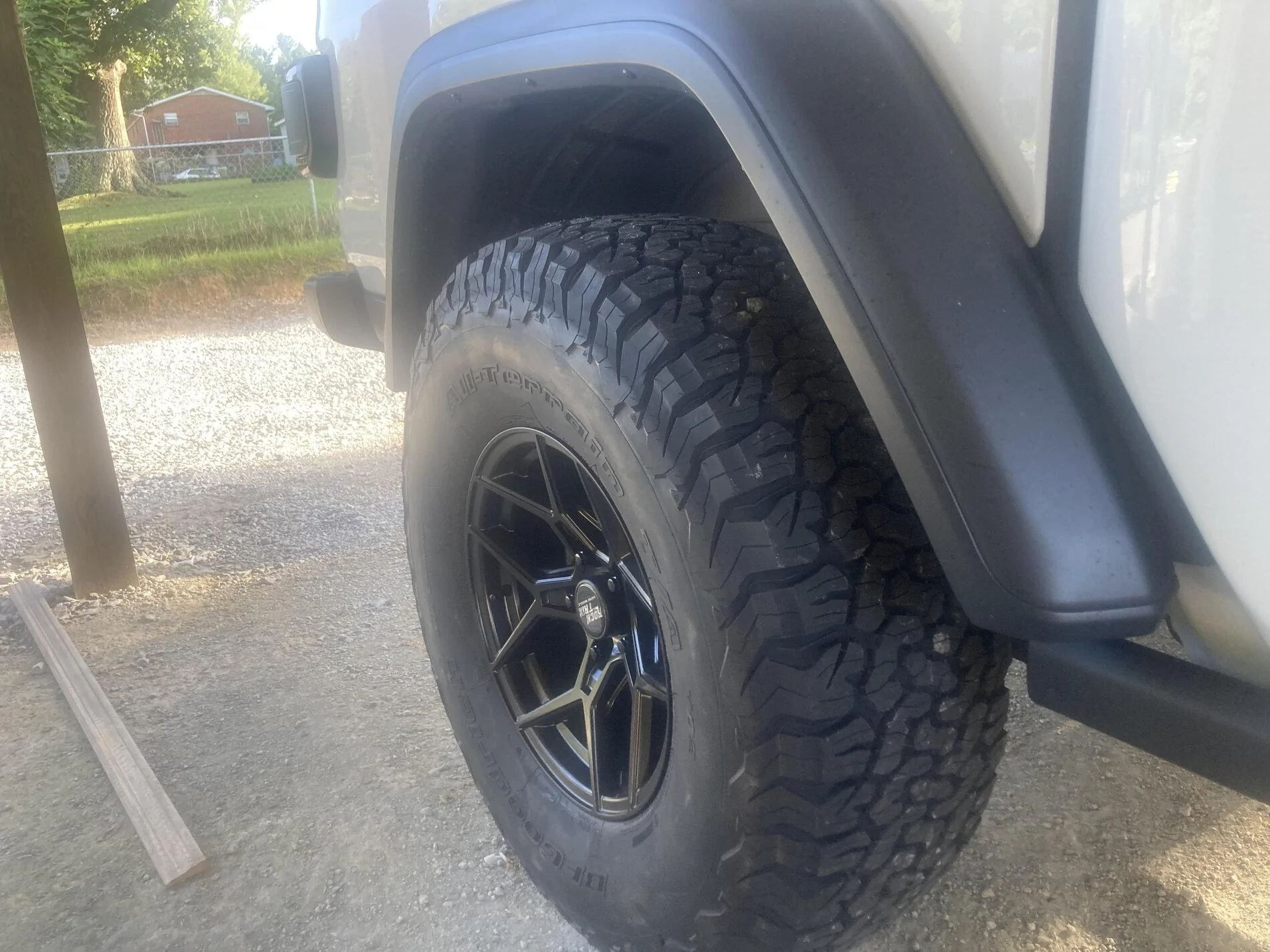

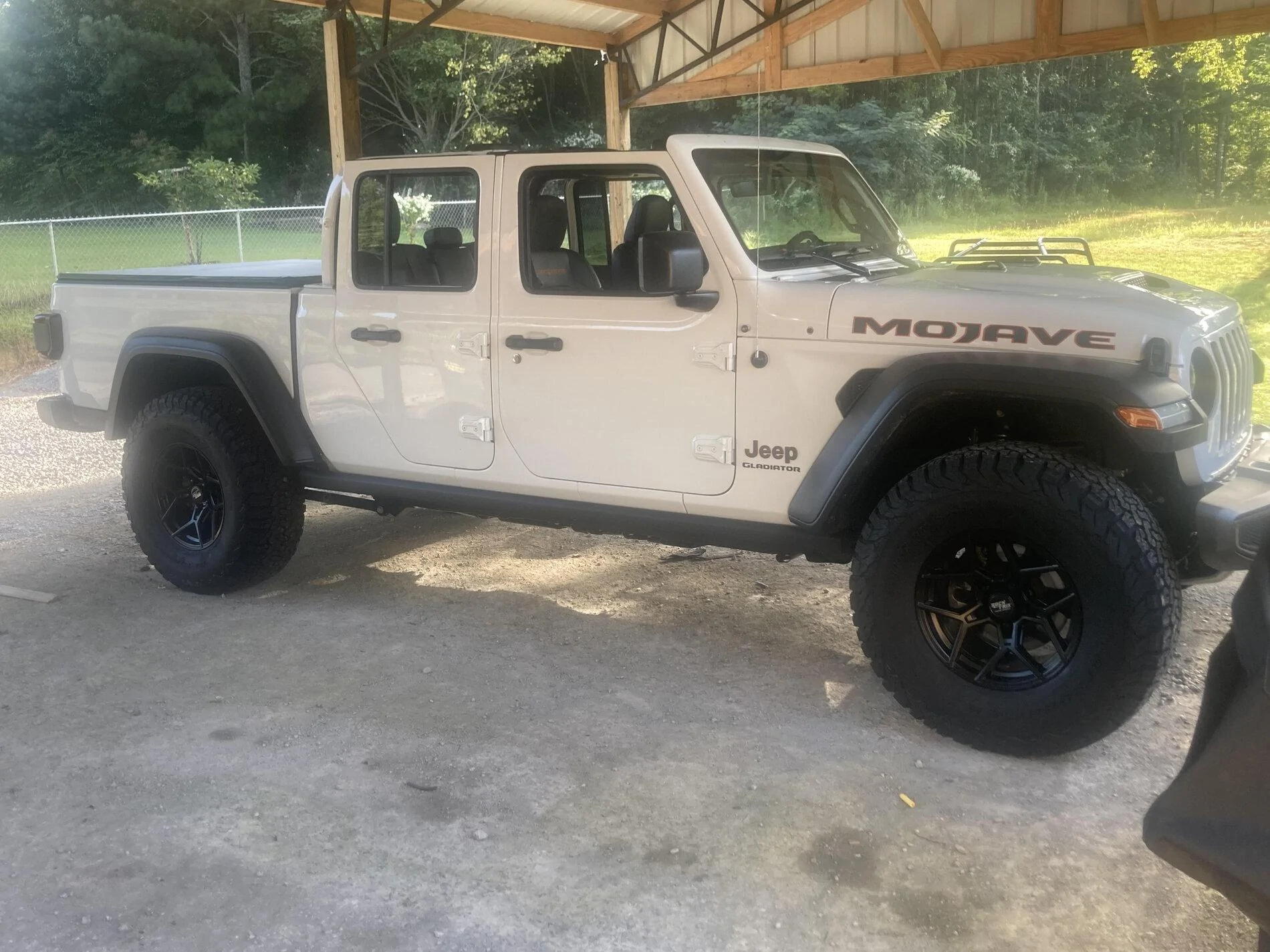

Truck looks SWEET!!!! Love the wheels now, LOL. Are you at stock Mojave height? If so what are your wheel specs? Any rubbing? I'm really liking your set up. Thanks
Yup, stock Mojave height. Wheels are 17x9, -12mm offset. Tires are 37x12.5, and measure nearly dead on 35.5" tall at 28psi. No rubbing whatsoever.
Thanks a bunch, how much outside of the fenders are you? Looks like a bit but hard to tell for sure in your pics. Thanks again. I'm now leaning heavily toward your set up.
I haven't measured it, but it's probably a couple of inches.

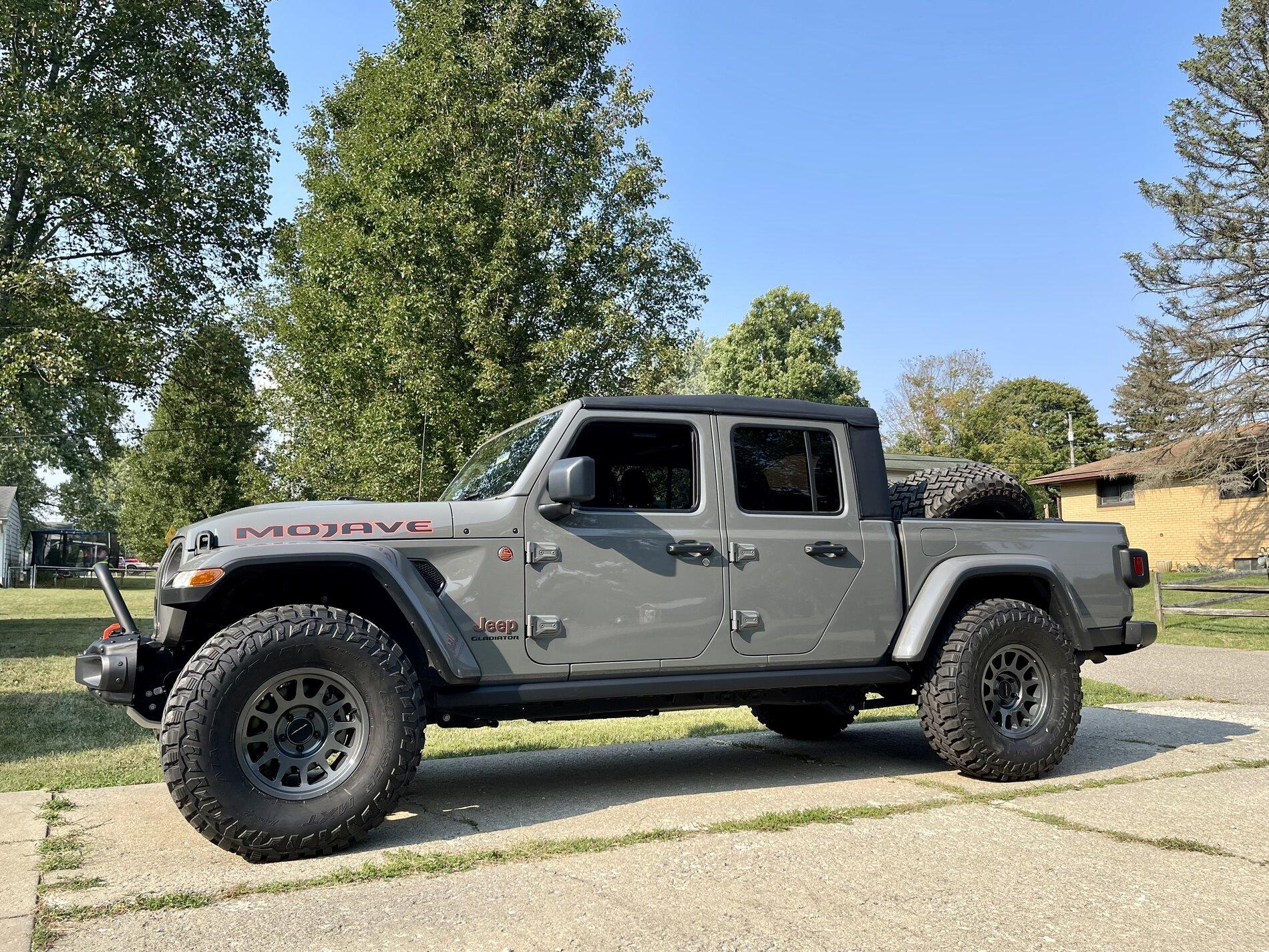

Falken 37 x 12.5; gunmetal AEV Borah JT/+25mm wheels. No rub at full lock on road.
Kurt,
Those rims with +25 offset are 8.5 wide correct? What back space do they have plus what kind of clearance you have on the truck and components? Thanks.

Kurt,
back spacing can be calculated from specs given. Not sure how much space there was but it wasnt much as stock.
with my current Clayton control arms and lift, i will get the slightest of touch on the control arm at full lock while pressed against the steering lock. It doesnt bother me.

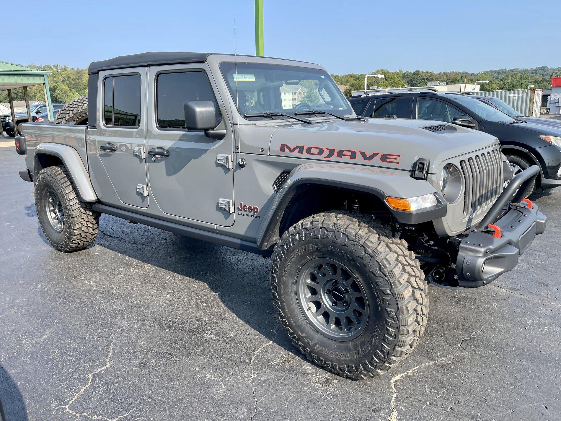

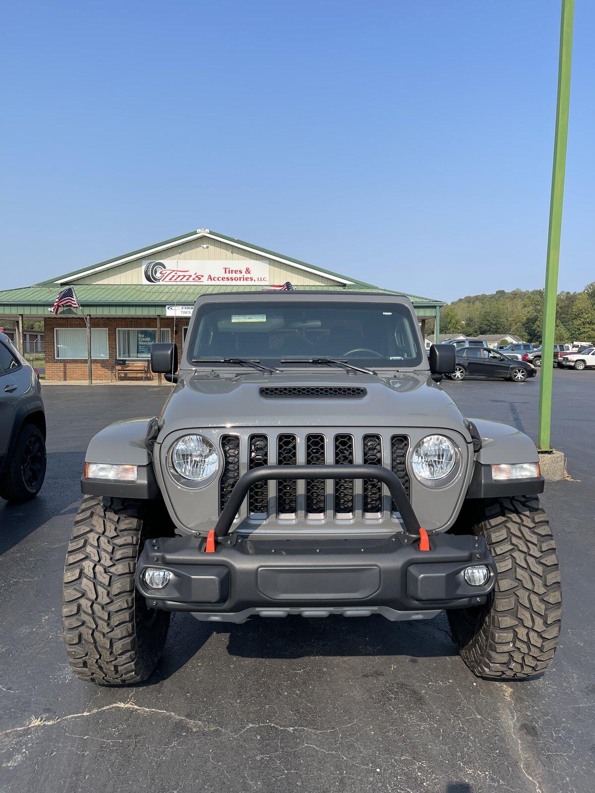

Edit to prior post. I had rubbing in the wheel well when I hit curbs/large rocks at speed. With 37 Patagonia on stock rims. No rub at full lock though. Only hitting obstacles. I added the aev 2 inch kit, photos below for what it looks like before and after. 4wp installed for $630 and the kit cost $440. Problem solved.
Looks great.

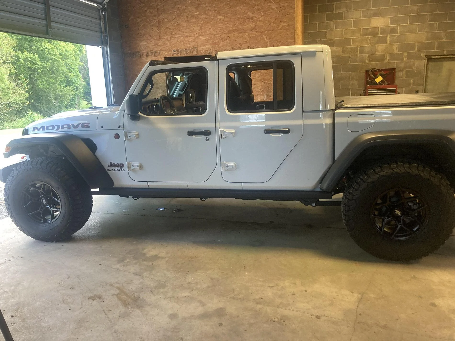

Put my 37 KO2s on a few days ago. I am cheating a little, have an 1” spacer up front, offsets the height I lost from bumper/winch.
Looks great. How tall do the tires measure mounted?
