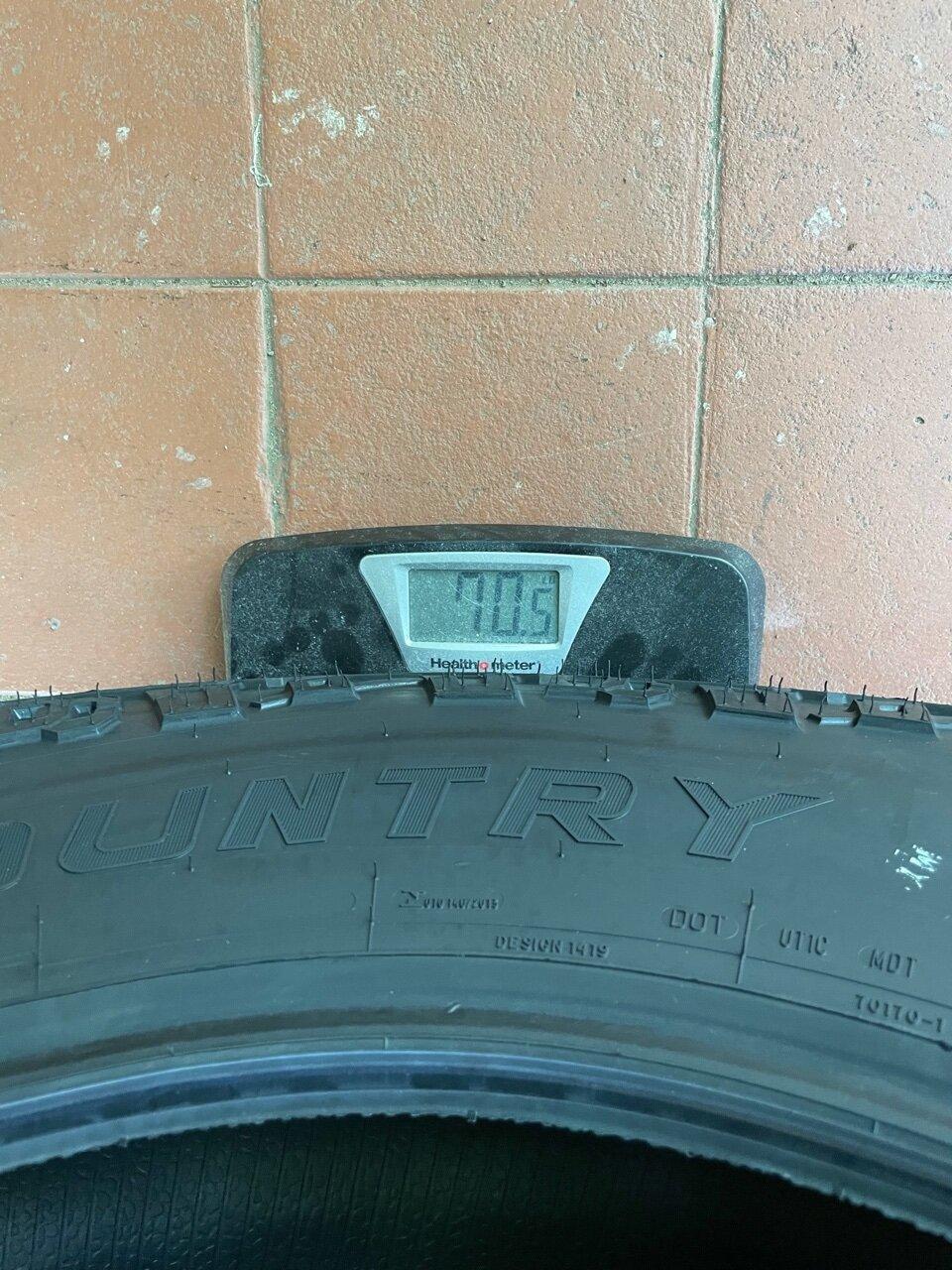

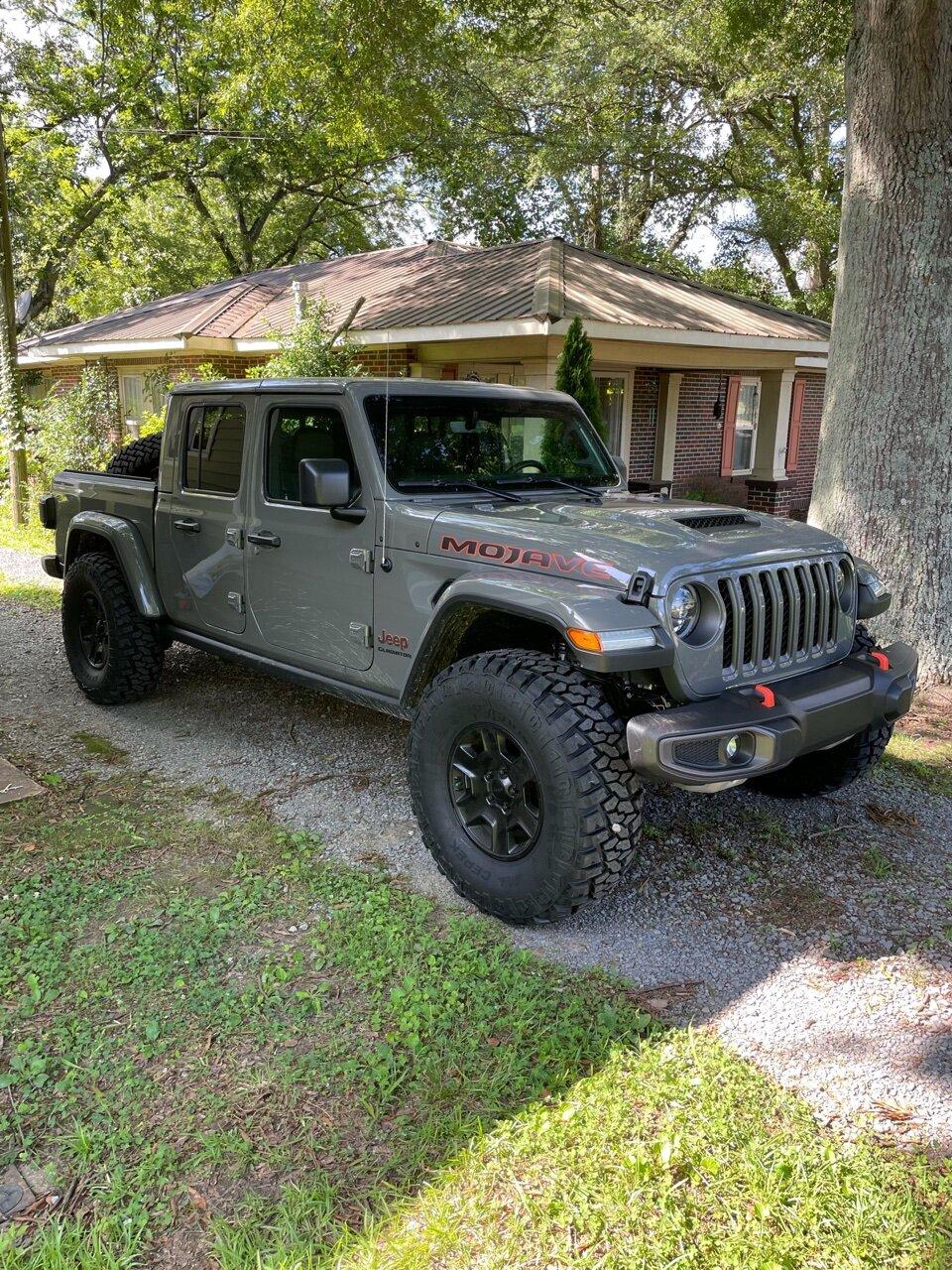

37x12.50r17 Extreme Country on factory wheels. Synergy 1.25 spacers (read on here I had to have them) no rubbing stock suspension. Tires are 70.5lbs. Have not measured because I know they aren’t true 37”. I have a 3” Rock Krawler lift laying in floor waiting to go on.

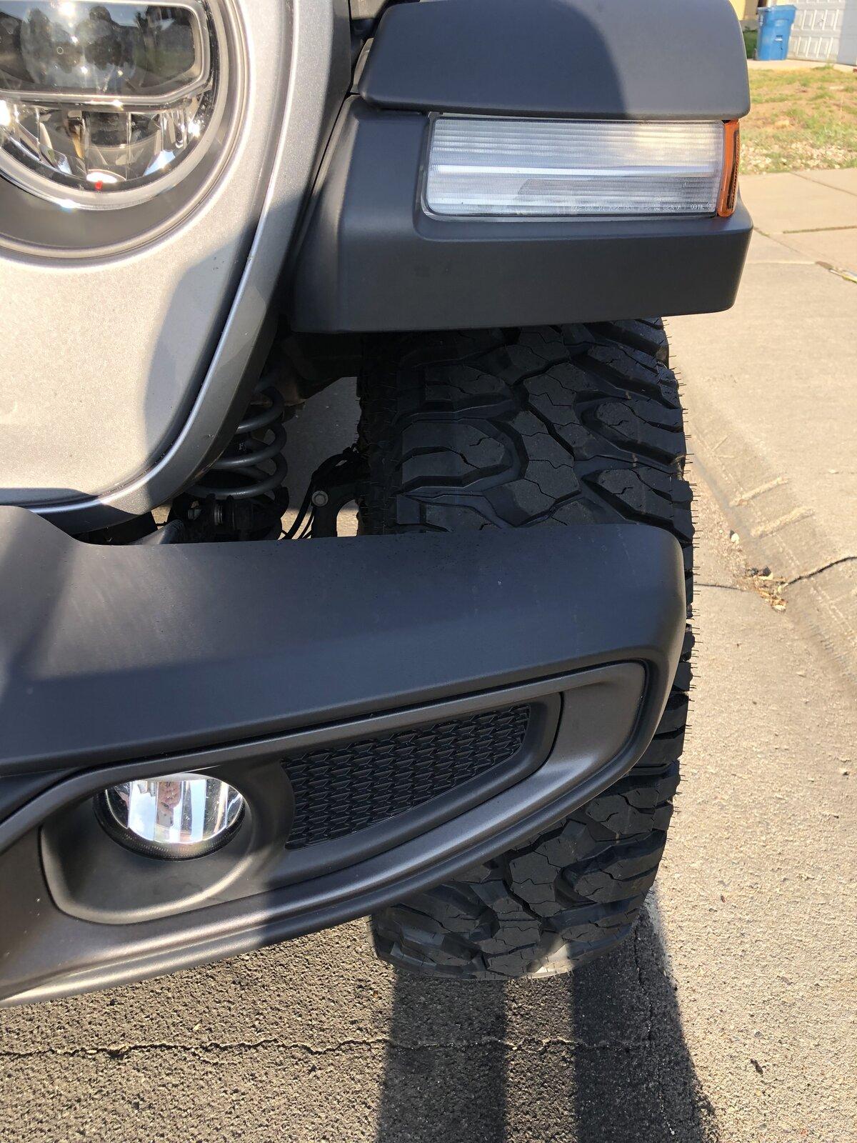

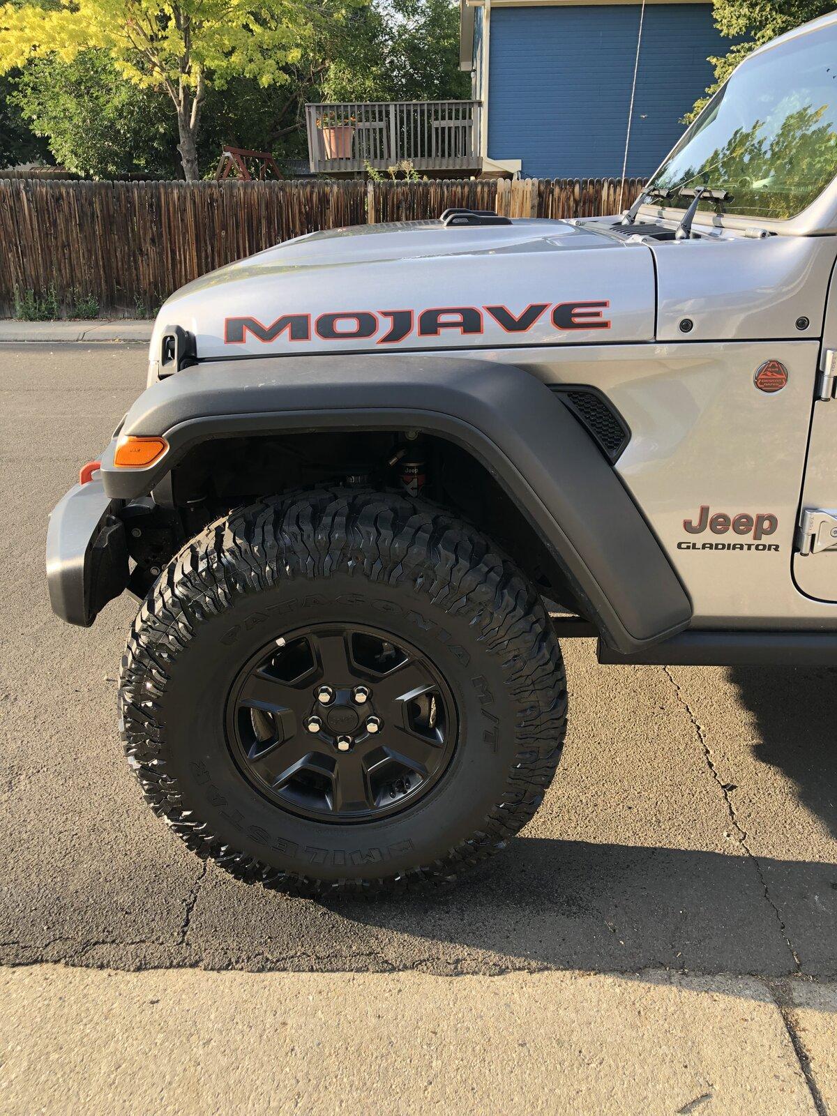

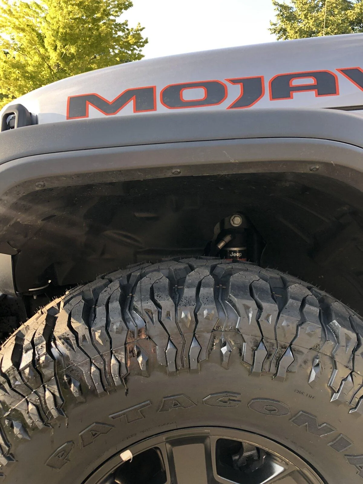

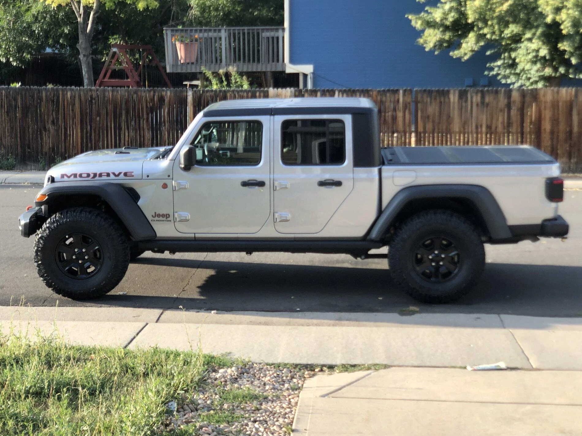

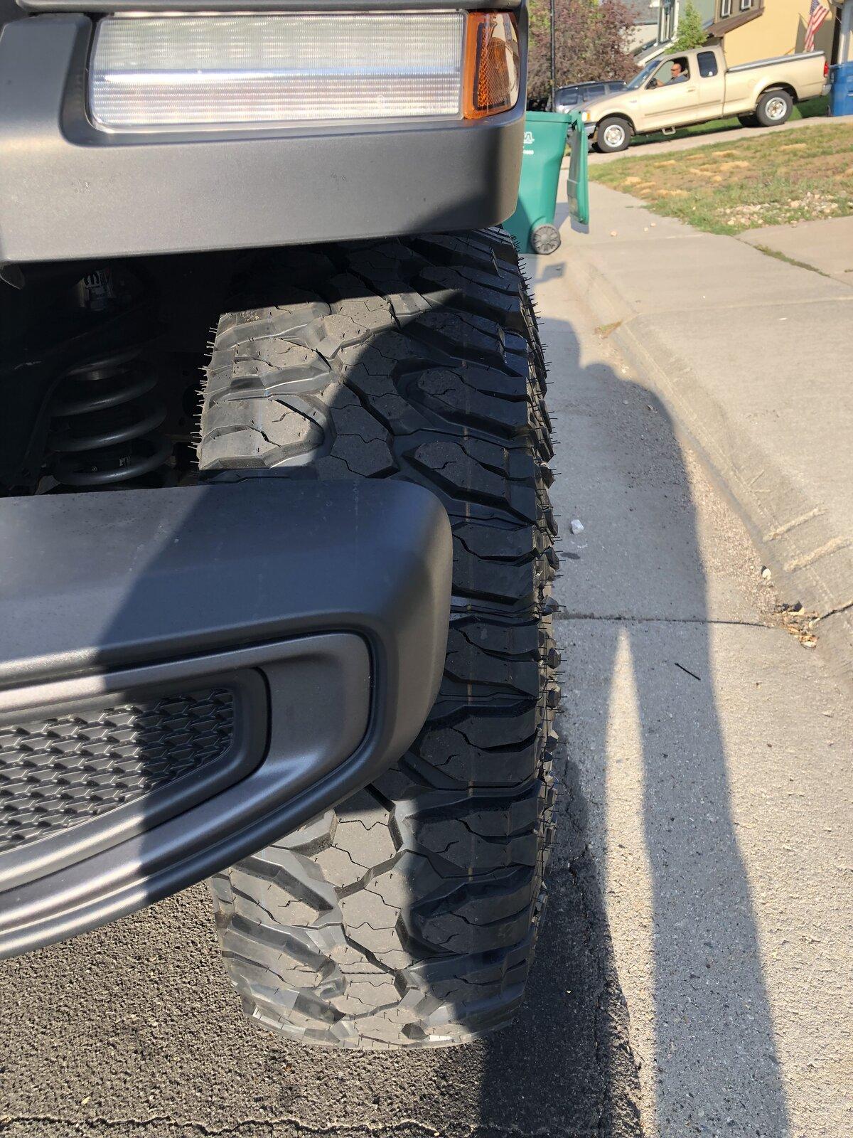

Stock Mojave 37 12.50 17 fit no rub, stock wheels.

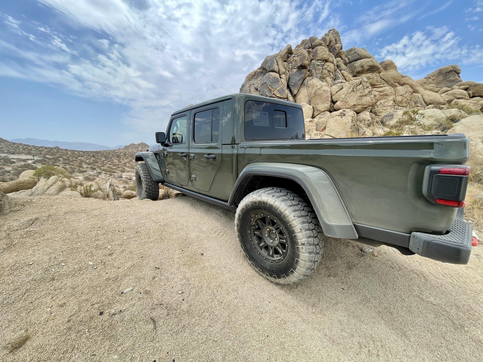

I currently have 35’s on a stock Rubicon. I would think the set up you are asking about should be fine. I can help find you some rocks in KY. Turkey Bay in Land Between the Lakes.

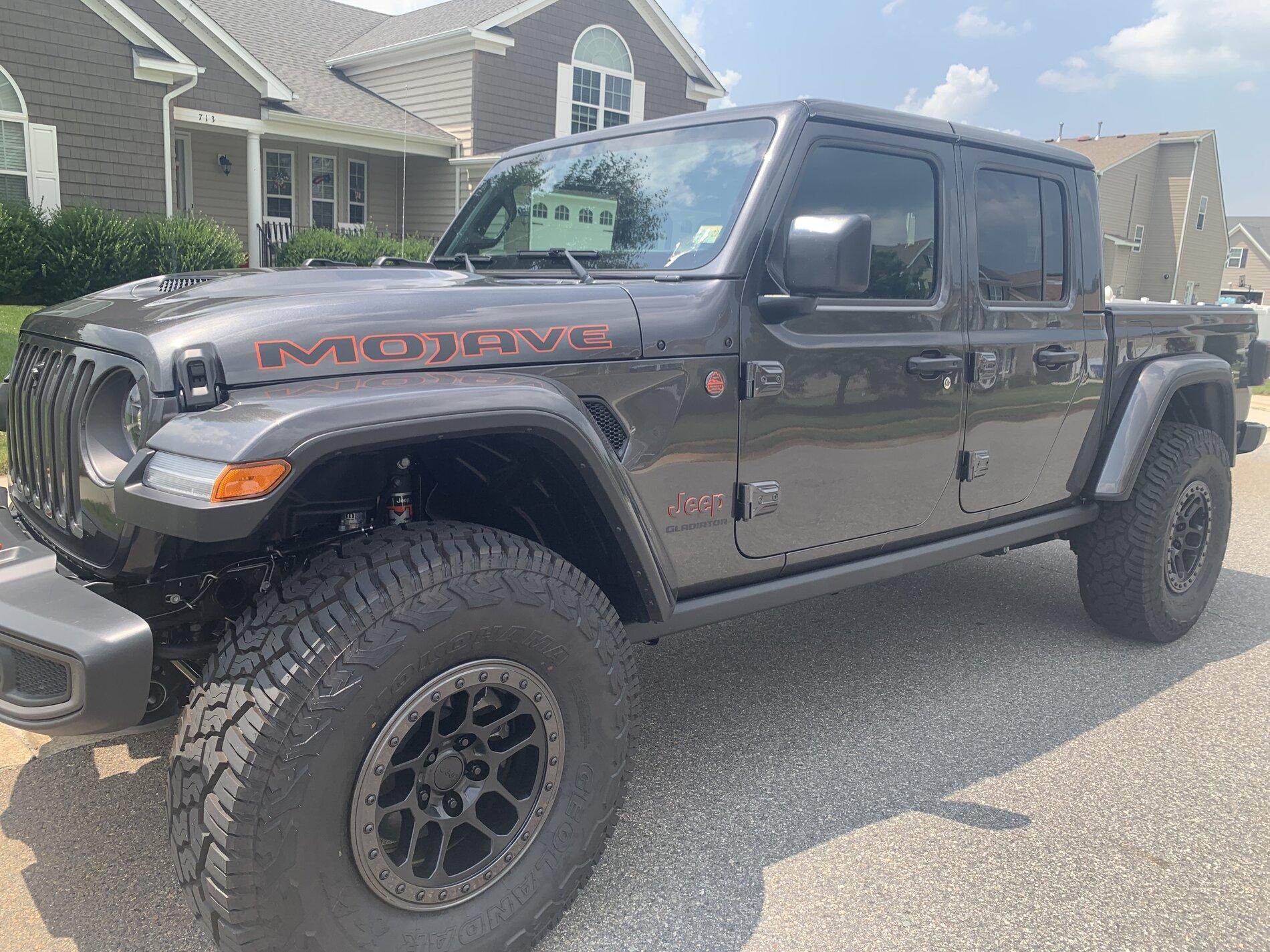

Here's one more...
Did you have those tires from a previous jeep or did u find a set leftover somewhere? I ran that exact tire 2 JKs ago and loved it. Went to XMTs since they stopped making them.
