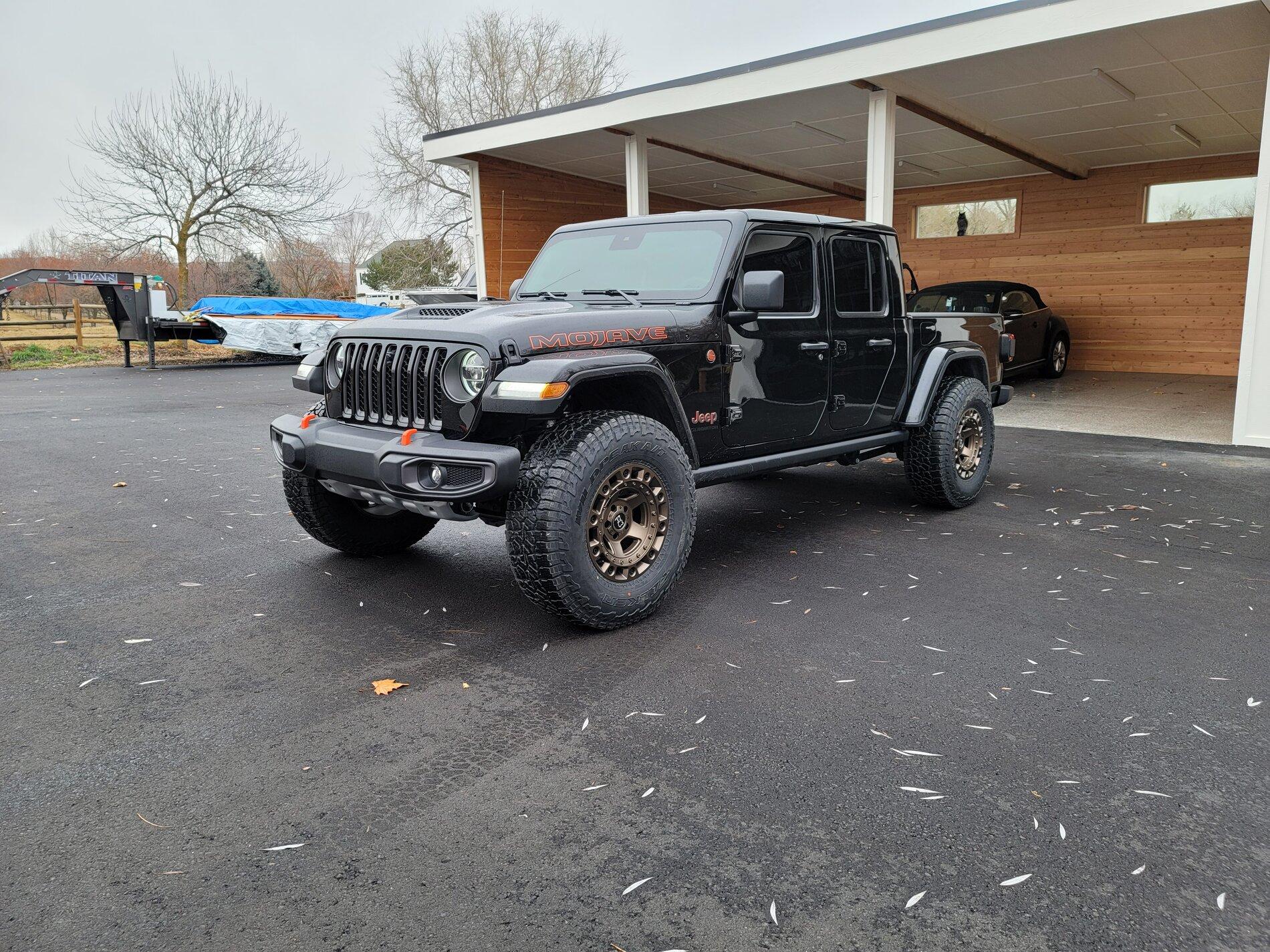

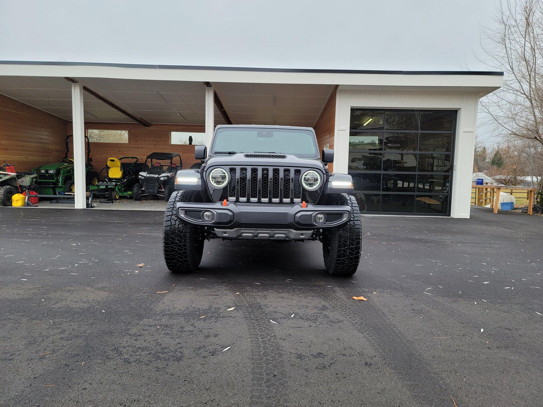

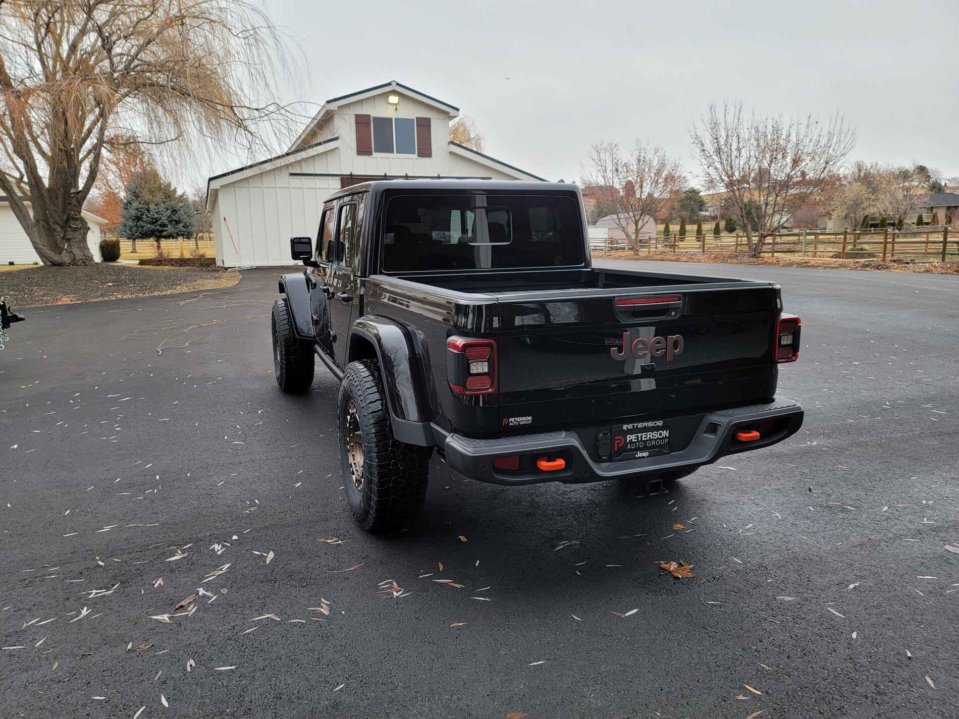

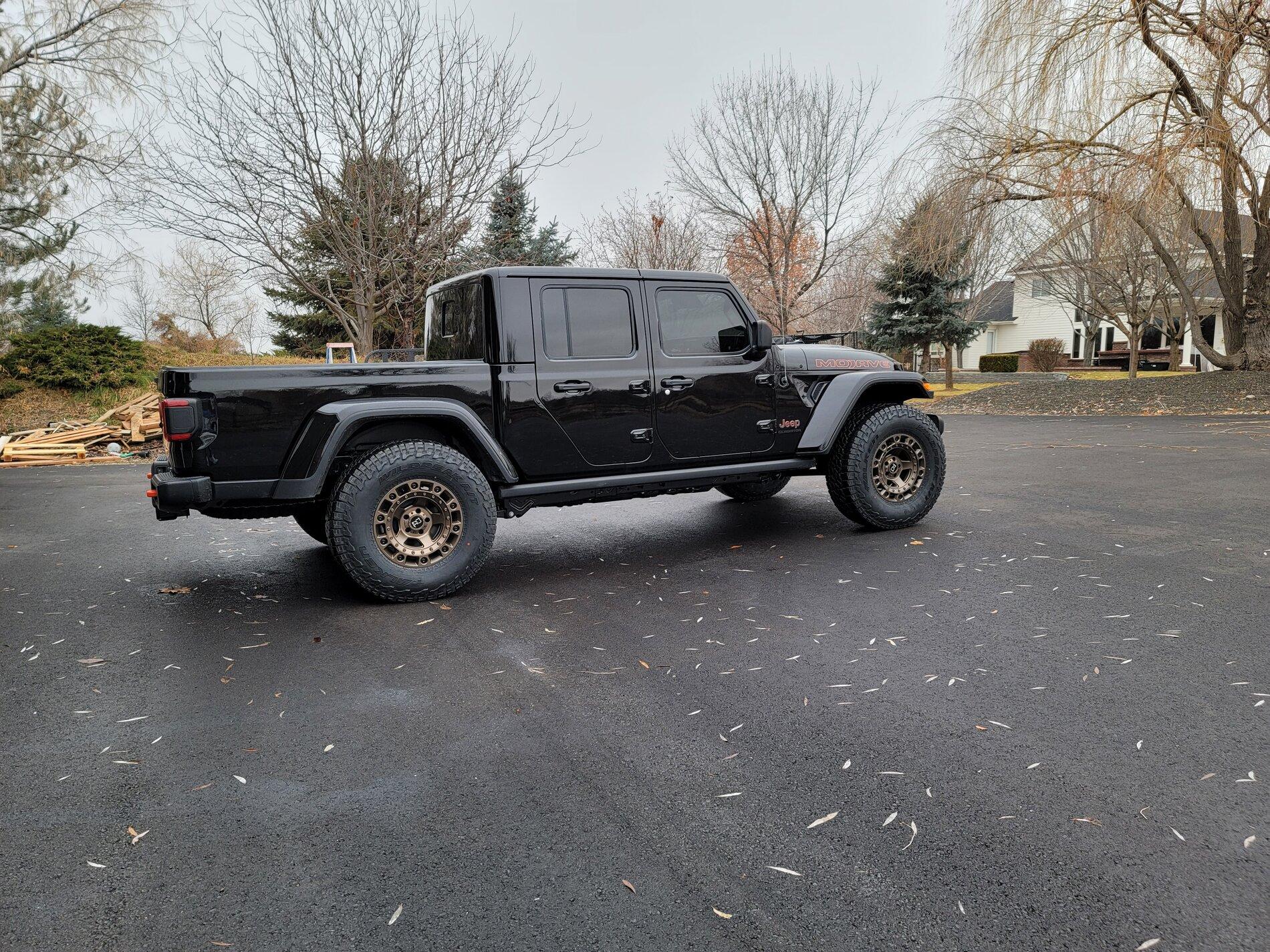

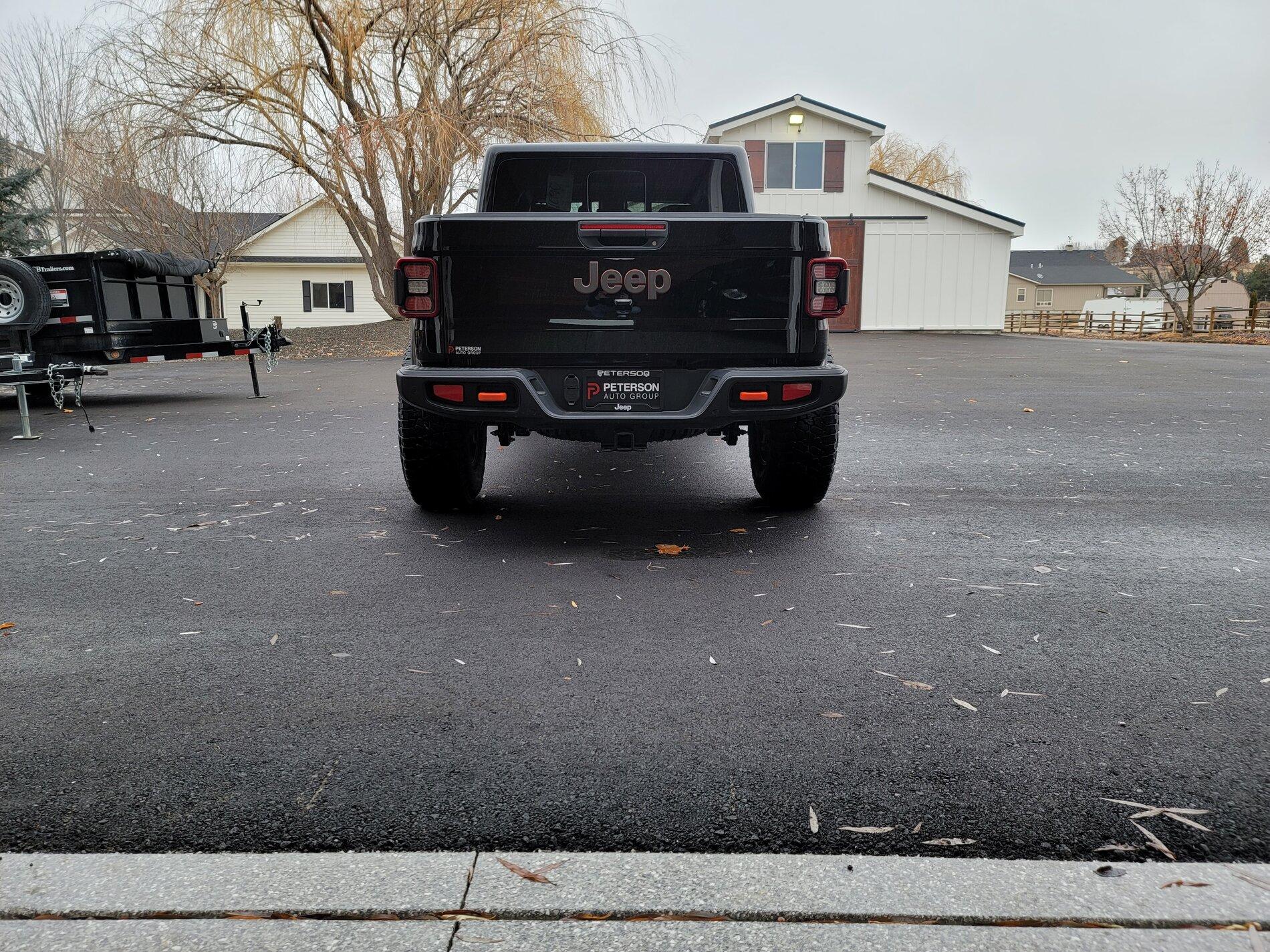

No problem at all, I scoured all over to find good info on these before I did anything so I'm happy to help. Here are some more pics. It's on a slope so it looks like the rear squats but it sits near dead level.
JBR
Jeep Gladiator Stock Mojave w/ 37s Thread 20210108_142334
Jeep Gladiator Stock Mojave w/ 37s Thread 20210108_142401
Jeep Gladiator Stock Mojave w/ 37s Thread 20210108_142419
Jeep Gladiator Stock Mojave w/ 37s Thread 20210108_142515
Jeep Gladiator Stock Mojave w/ 37s Thread 20210108_142532

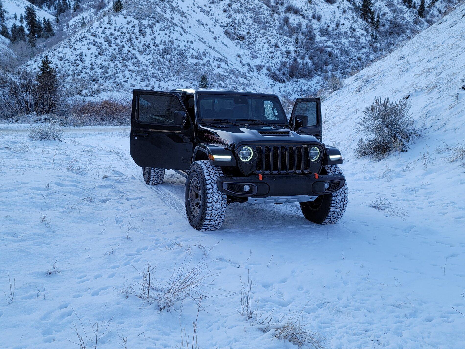

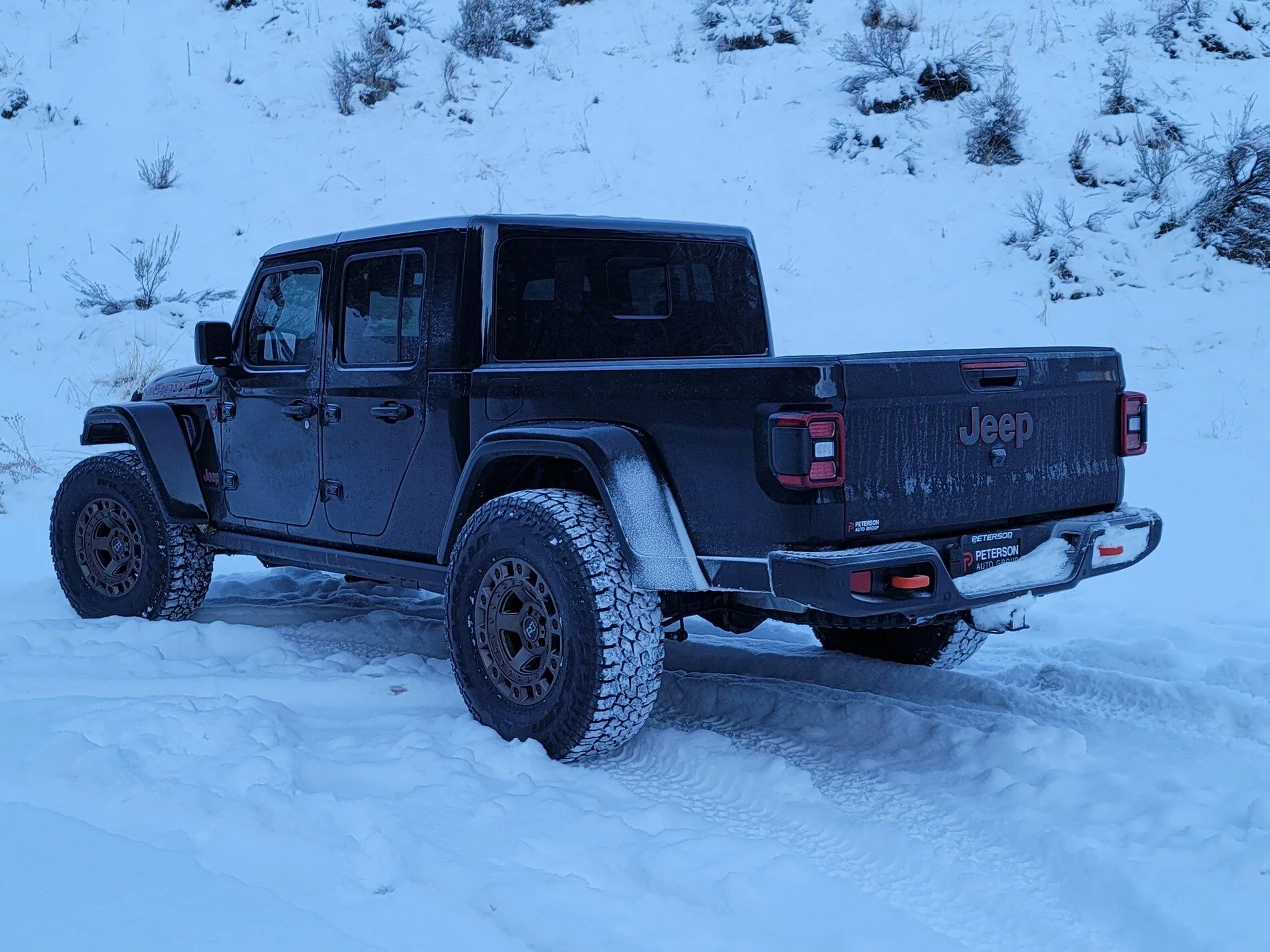

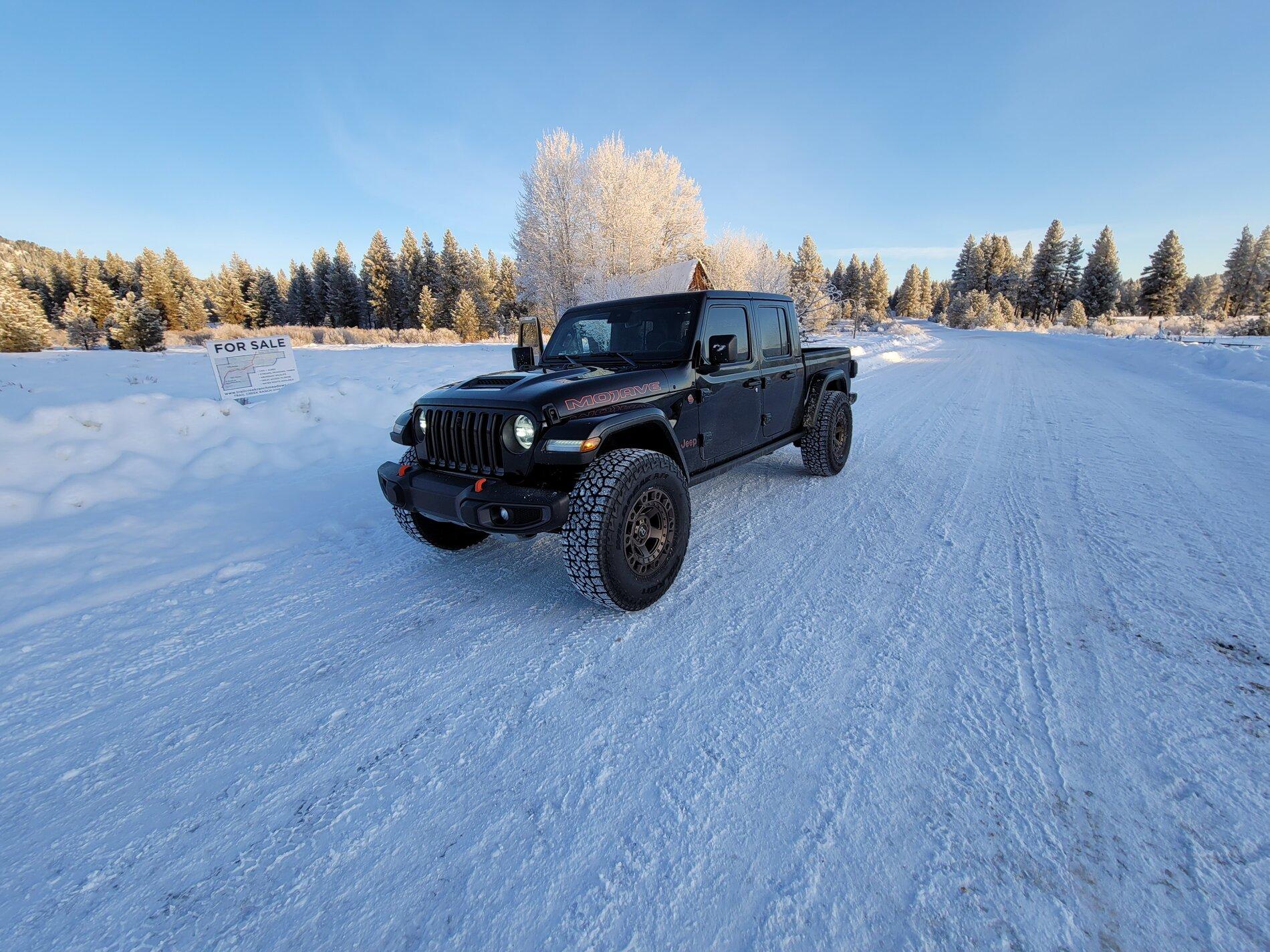

Went looking for Wolves today and I can't say enough about how much I love this thing. It crushed though a few feet of snow with little effort. Never rubbed at all.
The smoothest ride I've got.
Jeep Gladiator Stock Mojave w/ 37s Thread 20210109_094336
Jeep Gladiator Stock Mojave w/ 37s Thread 20210109_085216
Jeep Gladiator Stock Mojave w/ 37s Thread 20210109_093346

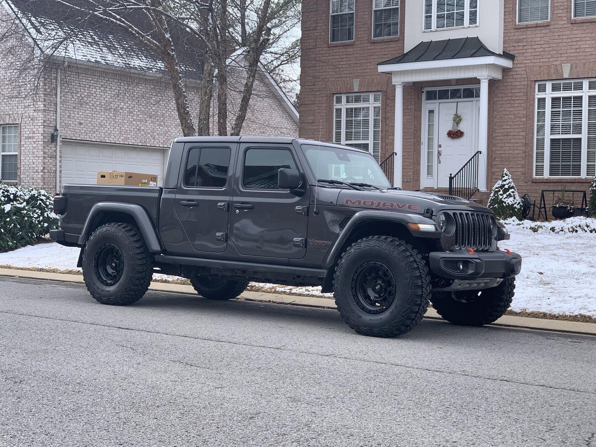

Falken 37 x 12.5; gunmetal AEV Borah JT/+25mm wheels. No rub at full lock on road.
Sweet! I ordered mud flaps cause my wheel offset causes my tires to throw so much crap on the rig. Lol I like you're tucked In better. I might have to find a different wheel as much as I love mine. We'll see how the flaps do

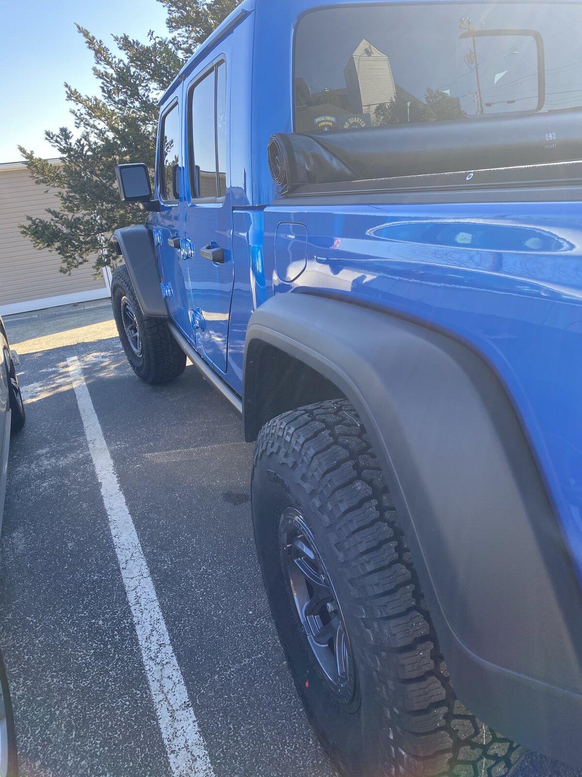

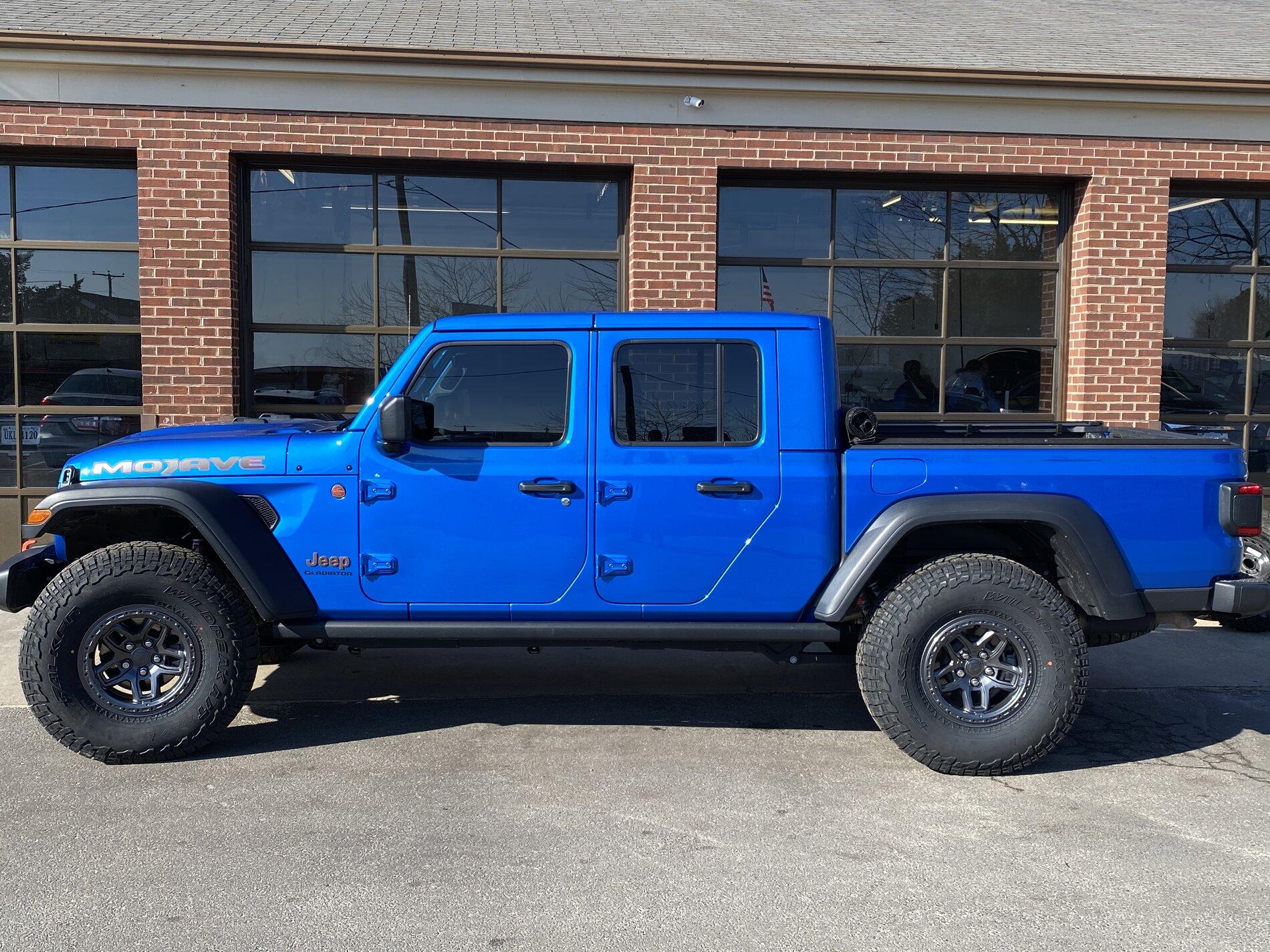

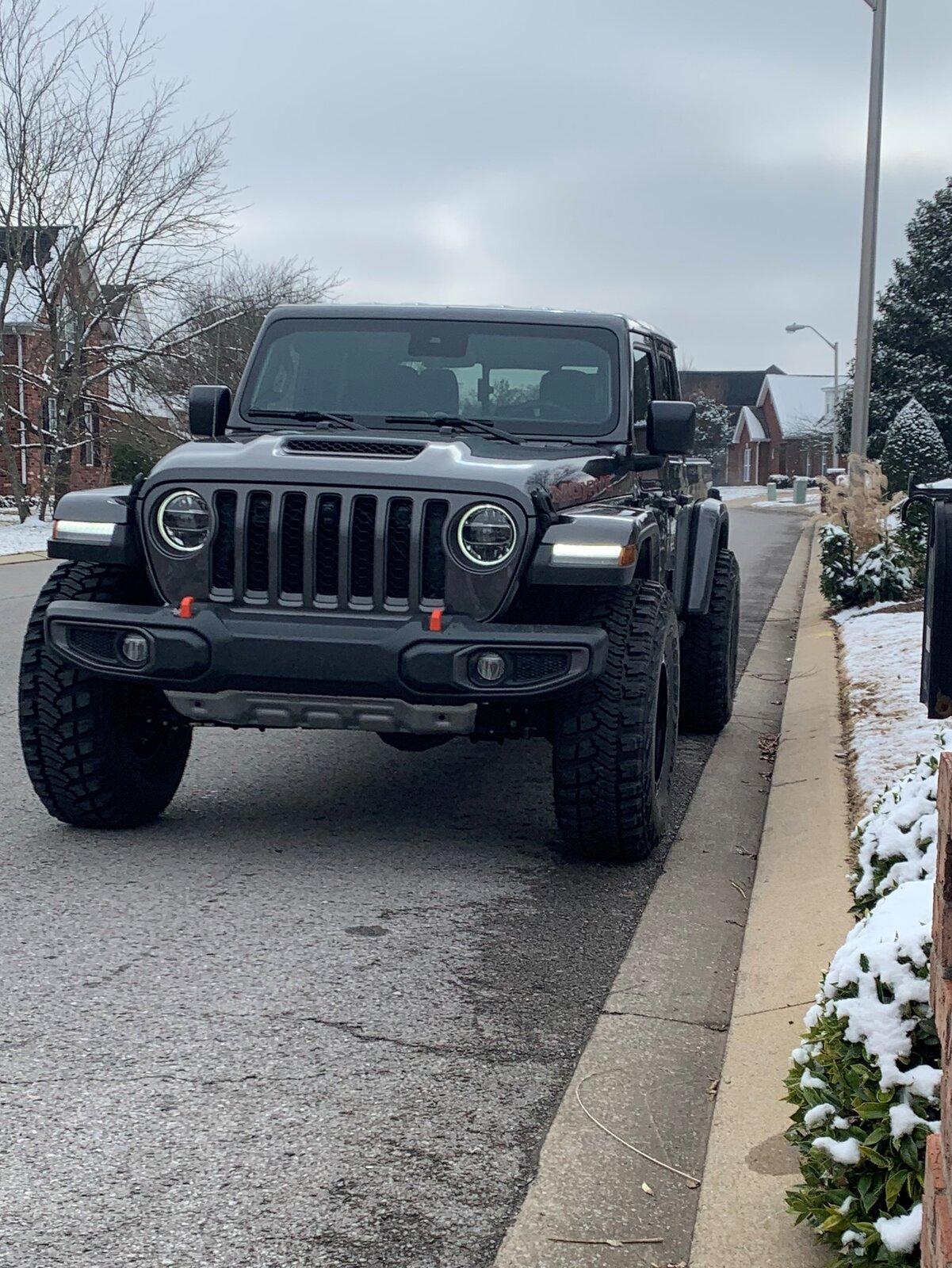

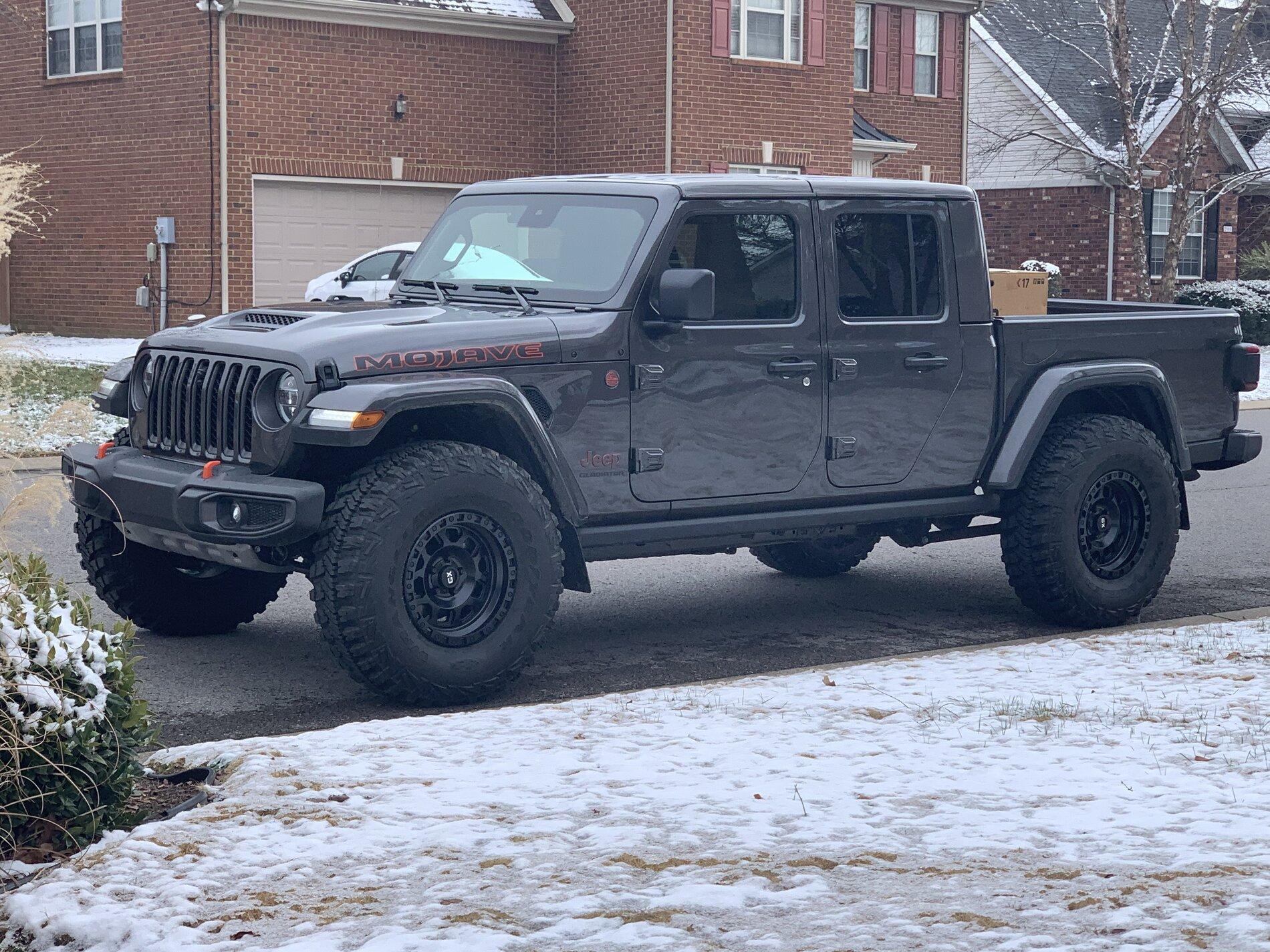

Just had these put on today. Stock/no lift. Goodyear MT/R 37x12.5R17LT on 17x9 with -12mm offset.
Jeep Gladiator Stock Mojave w/ 37s Thread IMG_5754
Jeep Gladiator Stock Mojave w/ 37s Thread IMG_5758-2
Jeep Gladiator Stock Mojave w/ 37s Thread IMG_5761
