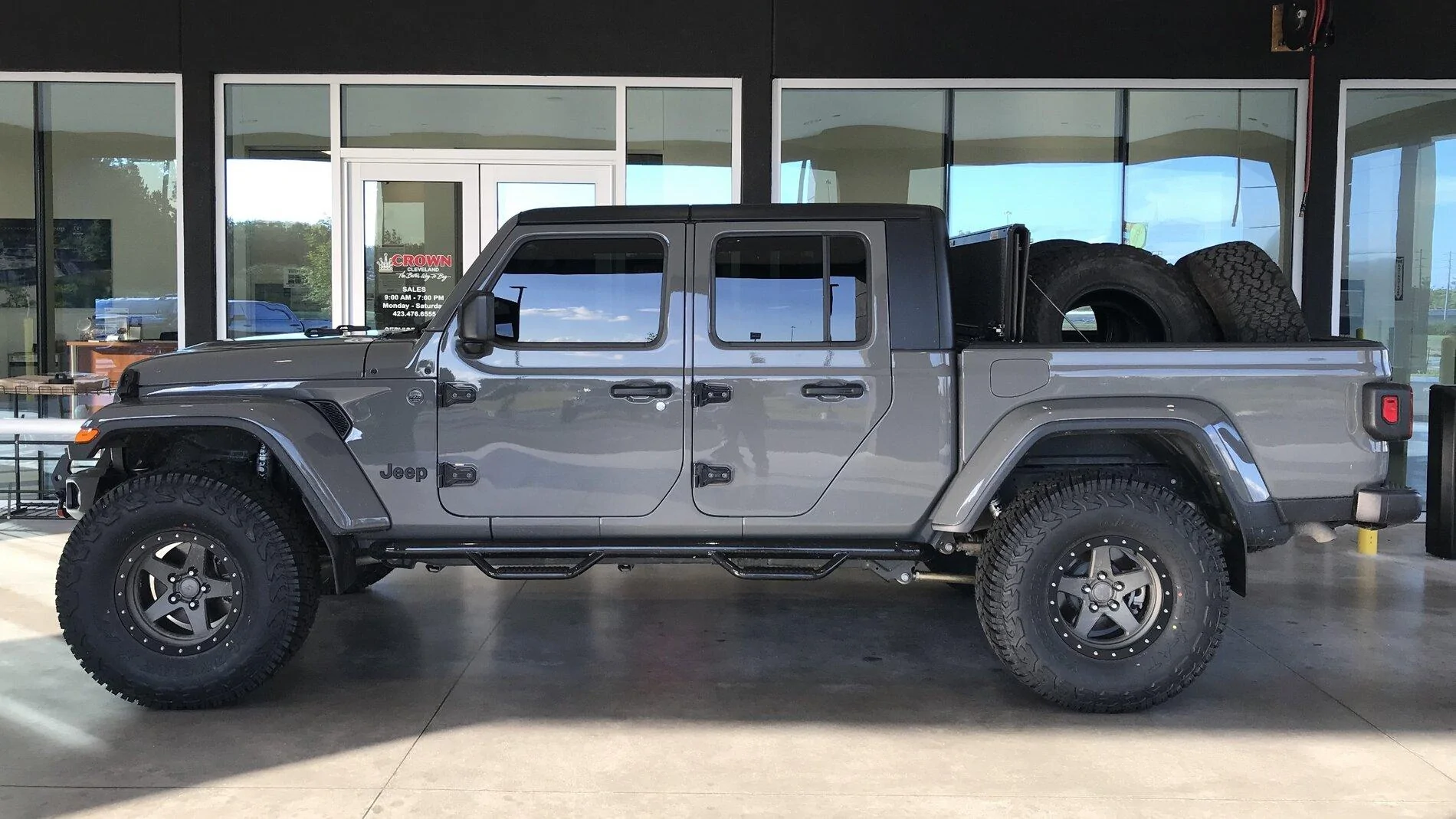

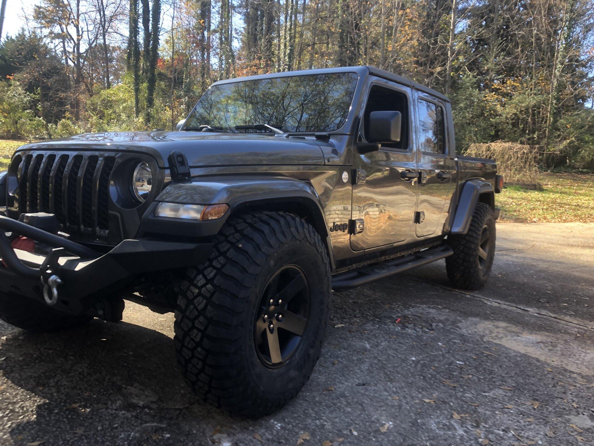

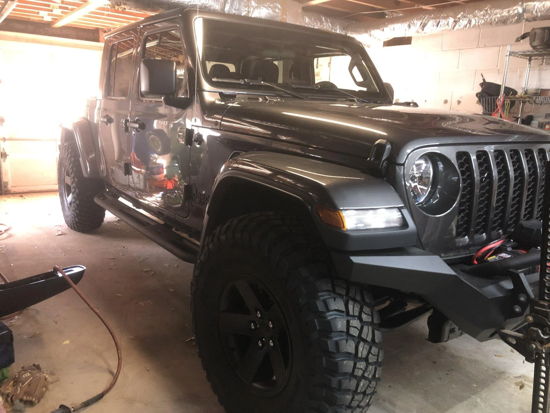

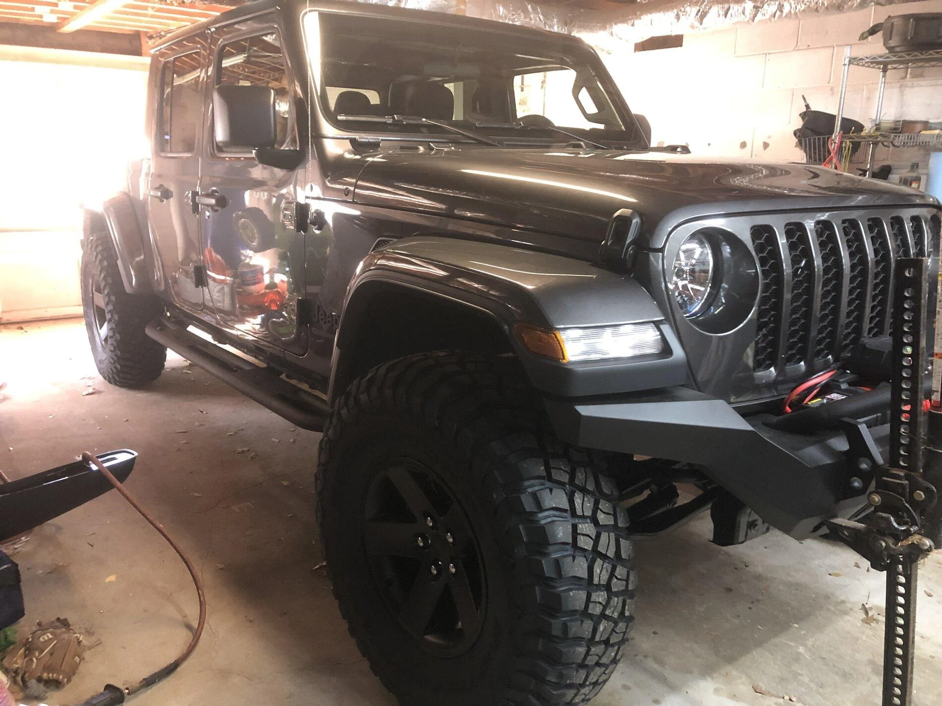

Jeep Gladiator 37's on a Sport S- Recomendations IMG_5775
falken wildpeak 37 12.50 20 2.5 inch lift
