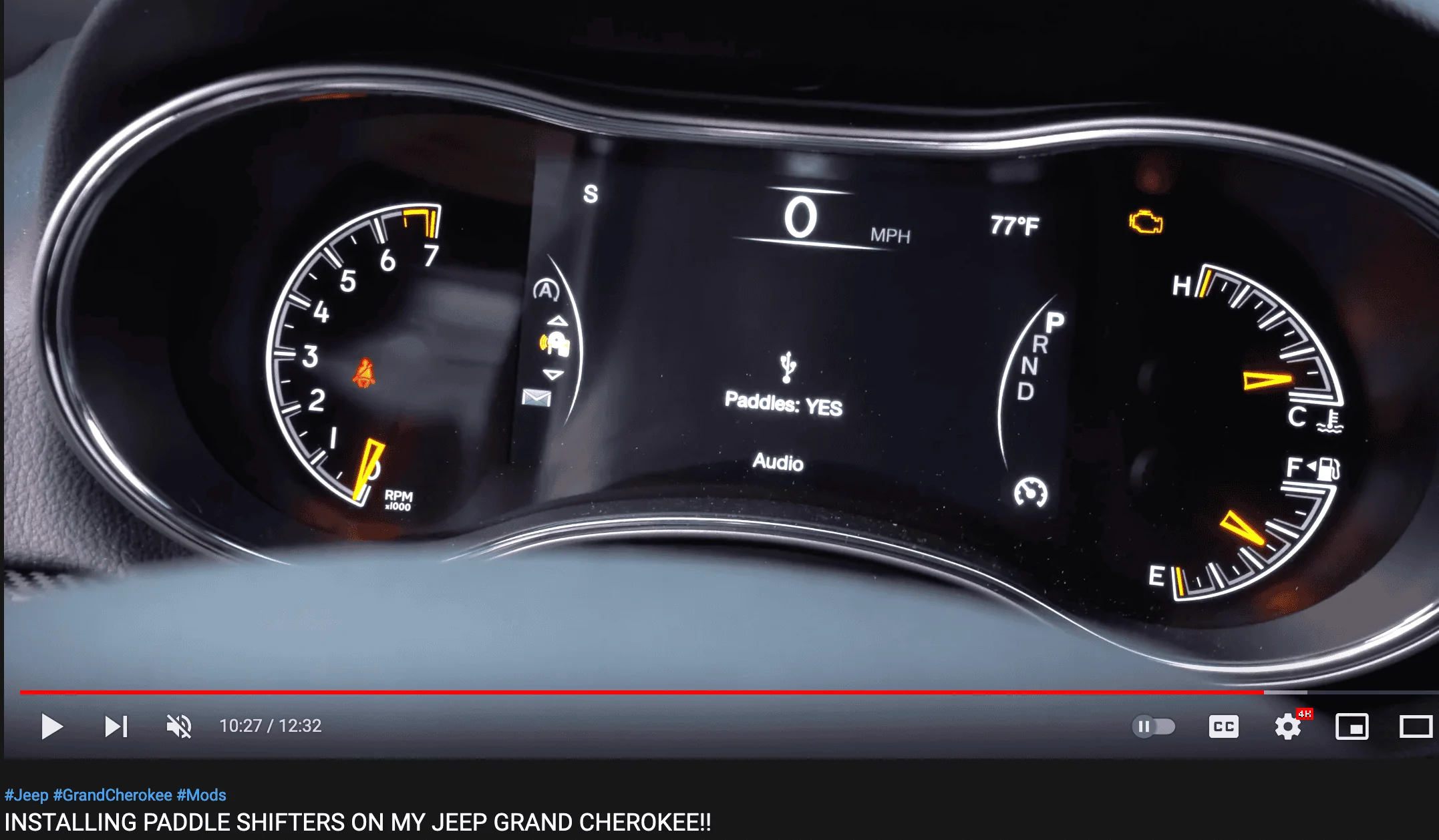

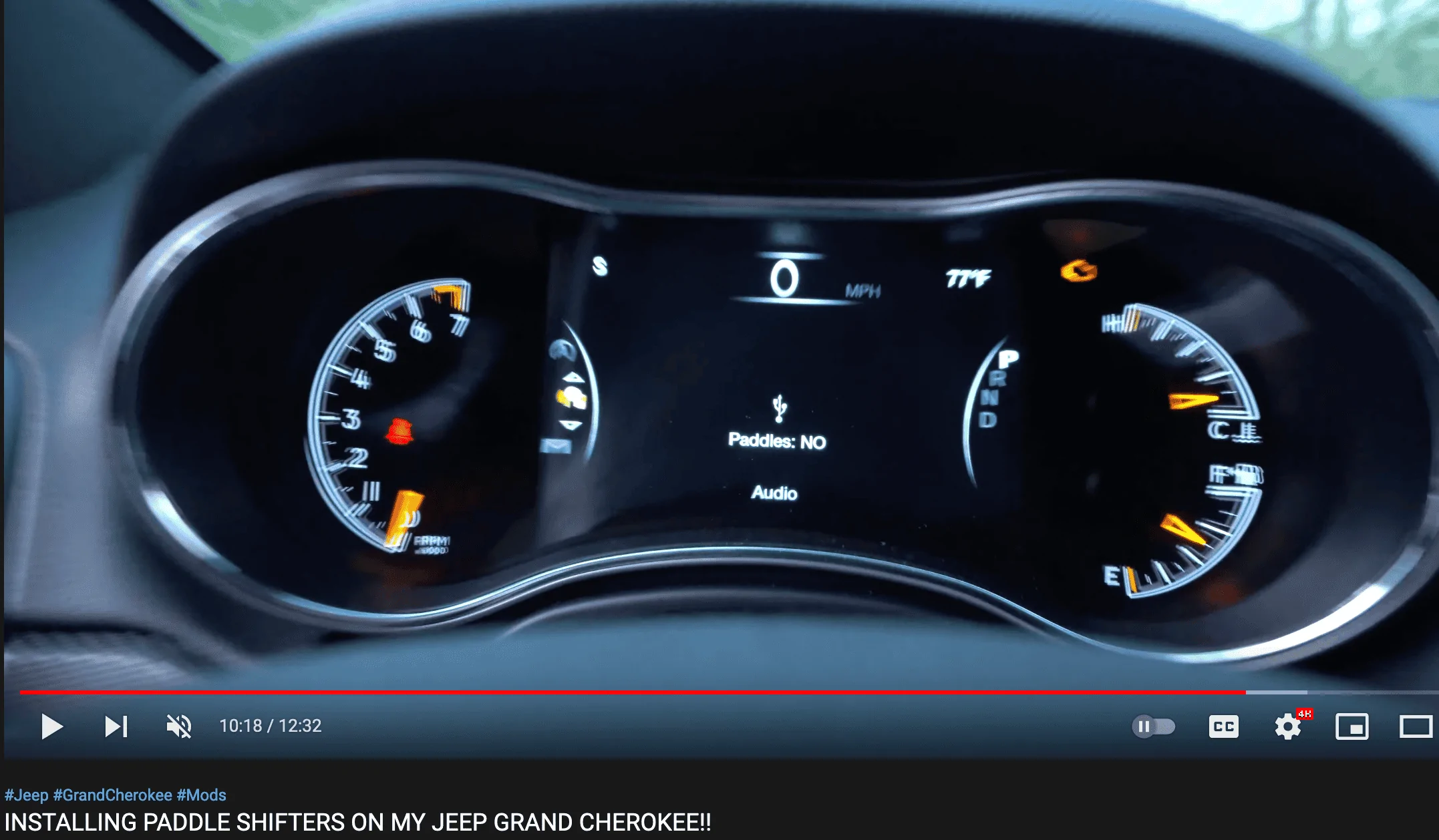

So I think I've followed this thread since it started. That red stitched 392 wheel is on my want list now. I've read that the back of the steering wheel switches are a bit different to accommodate the paddles. I don't need the paddles. Does anyone know for sure if the back of the wheel switches from my sport will or will not work on the 7SG452R3AA wheel?
I just replaced the steering wheel in my Rubicon with a red stitched 392 wheel a couple of days ago and also added paddle shifters. Both my old switches and the new ones fit both wheels.

No. I only have a 392 steering wheel (with heat) with Orange stitching and near new Rubicon steering wheel that I took off of mine with cruise and radio buttons without paddles. It also has heat.
Paddles are in back order. I have the harness and the back switch covers which are brand new that I bought for the project.
Just tried my shifters and they work! Super easy mod to do.
