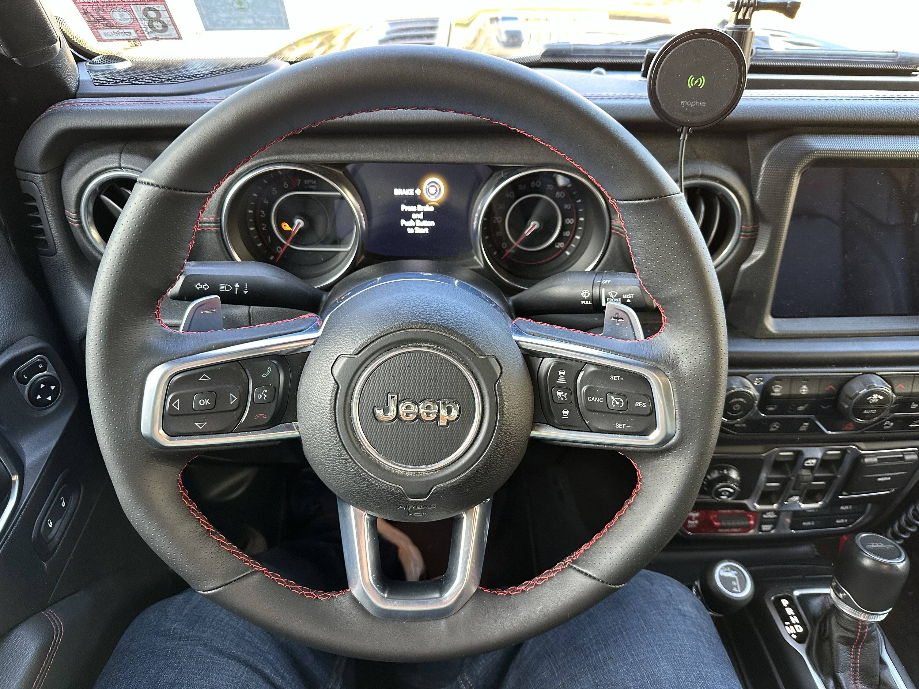

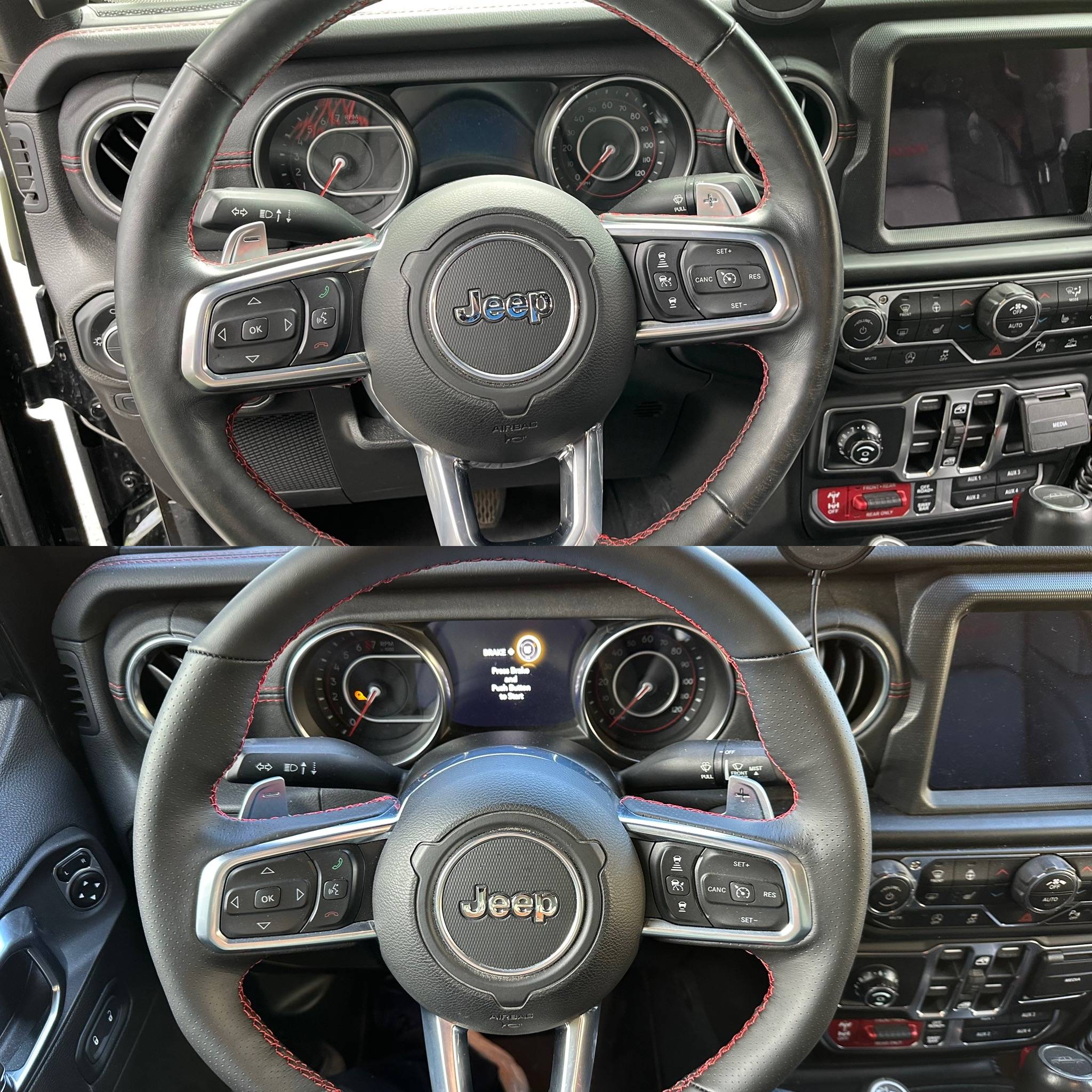

So for a quick update…I really wanted the 392 wheel for the better feel, but I just couldn’t do the gold stitching with all my red. Fast forward to this summer and my buddy got a 2024 392. With the new interior, they have switched to red stitching, so I took his VIN and ordered the wheel. After 4 months of waiting, it finally came in today, and I’m super happy with it. I also added a top/bottom comparison photo of the 2 o you can see the difference.
if anyone else is interested, the part number is 7SG452R3AA
