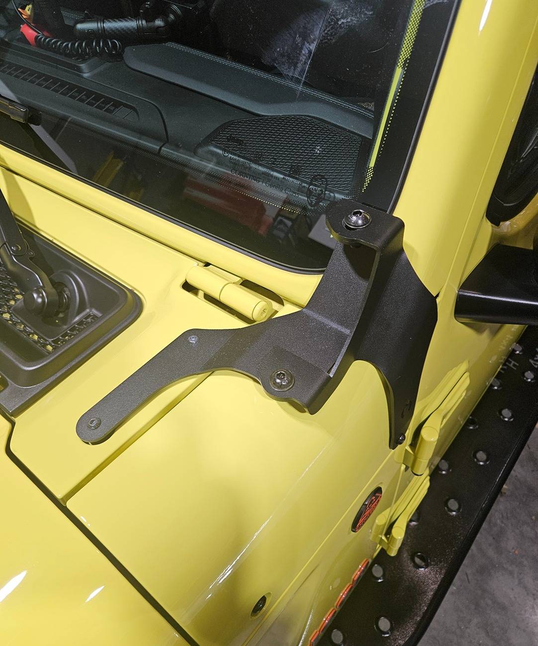

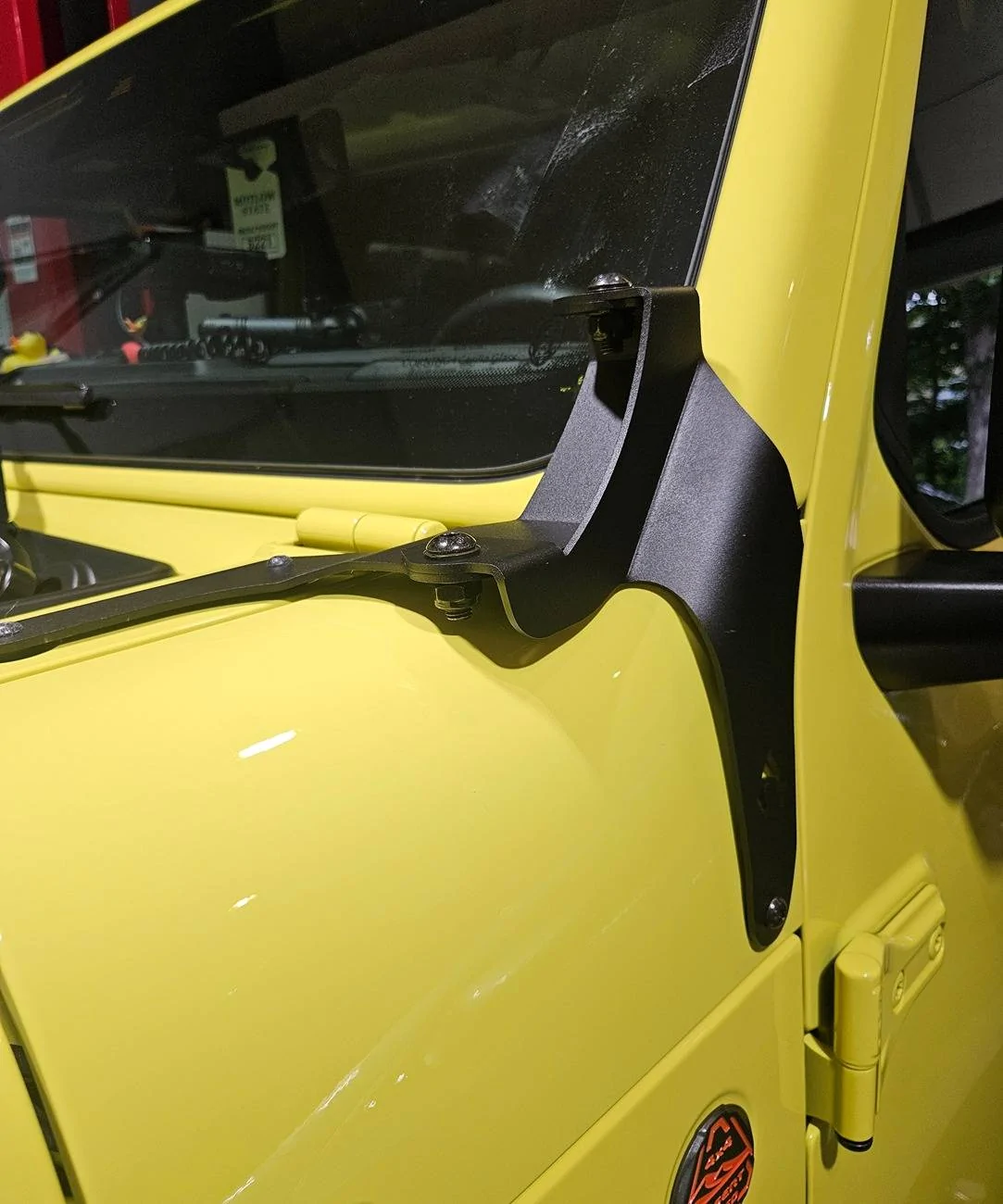

I received a set of ARTEC Industries JL A-Pillar Dual LED Cube Light Mounts, as they were ones (at the time) that could fit on my 24 Mojave. Now that I'm actually enjoying summertime here in Anchorage, I decided to tool some more on the Dreadnought.
Found out that:
1. They were designed around Rigid D-Series 3x3 Cube LEDs
2. They could not be assembled without the lights in hand first.

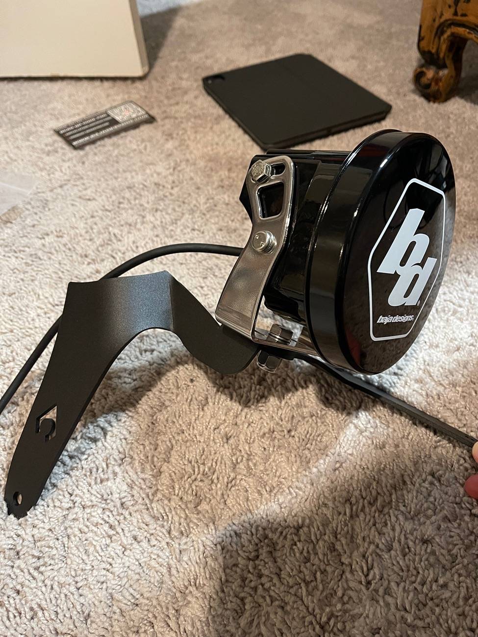

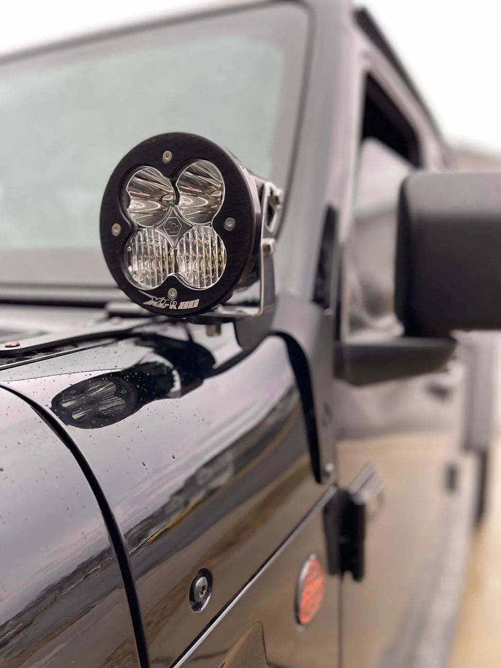

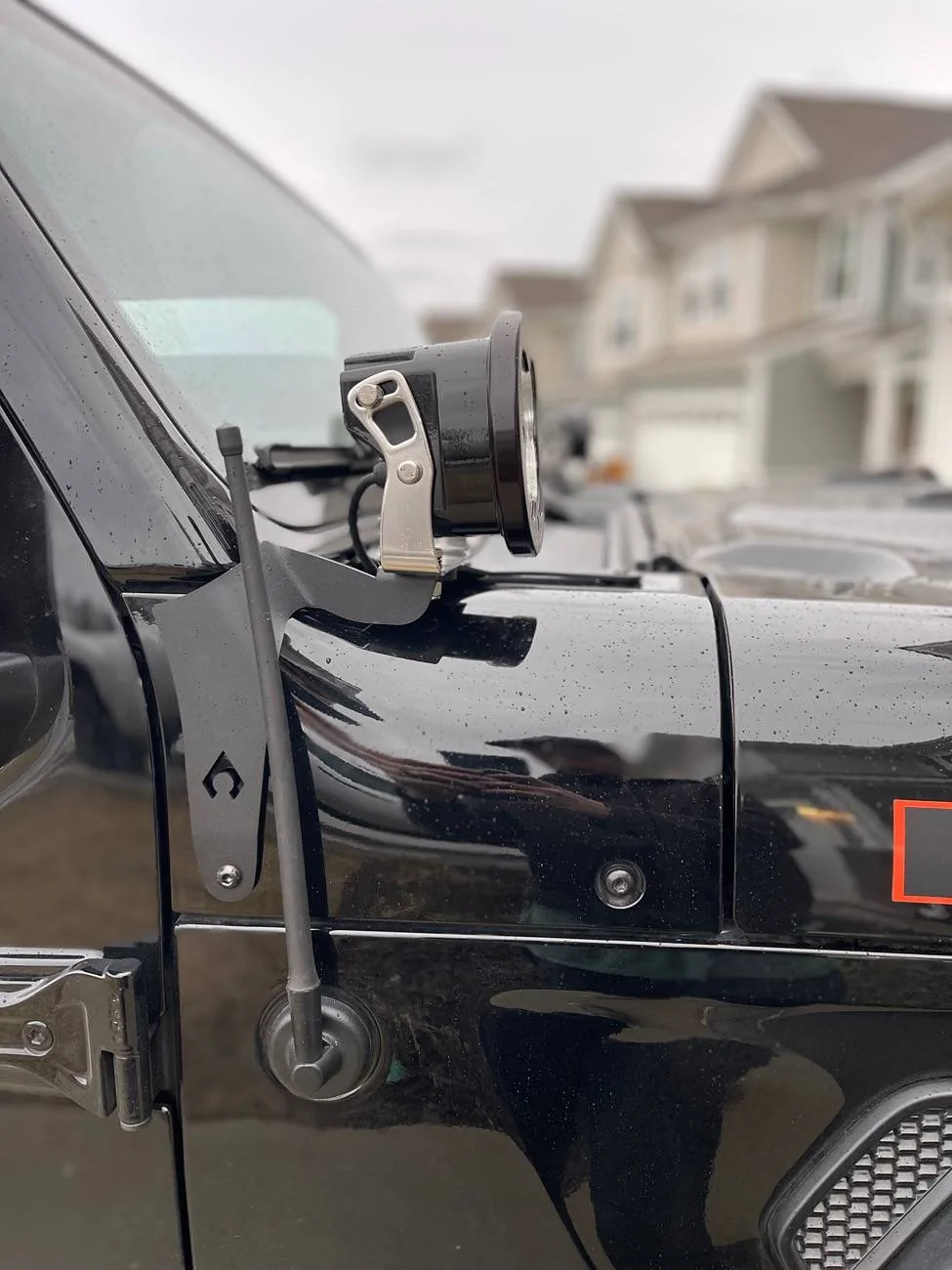

I’ve got the Artec single pillars which are the same design. You can use any lights I’d think as long as you have them in your possession at time of install. I went with Baja Designs XLR-80’s for reference. These are the Driving combo (spot/flood beam). If I did it again I’d go with the dual mount and have a pair of S1 wide cornerings as ditch lights. As for your setup I’d stay away from flood pattern unless you do the Rigid DSS line which is side shooters reducing the hood glare or plan to face angled out. I will say the Artec mounts are solid and move the lights further outside your windshield view which is a huge reason I went with them.

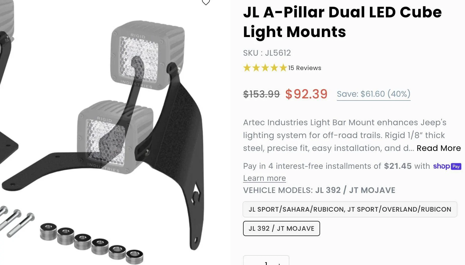

So you have these brackets that are designed specifically for the Baja Designs D series lights?
Jeep Gladiator 3x3 Cube Lights - Need Help finding alternatives on a 2024 Mojave Screenshot 2025-06-17 at 6.02.02 PM
You'll need to find lights that are less than 1.93" wide so that they will fit between the two brackets, plus some washers / spacers to fill in any gaps.
You wrote that you "received" these, so I'm guessing that it may be unacceptable to buy a set of brackets that have more traditional mounting, such as:
https://artecindustries.com/collect...-392-mojave-a-pillar-dual-surface-light-mount
and then just use whatever cube lights that meet your needs / budget.
That’s a good point if they are not the 392/Mojave brackets they will not work based on the mounting points as the Mojave has a taller cowl than the Rubicon and other models.

Worry not, they are the ones meant for the Mojave/392 cowling.

I have mine installed without lights. I had some extra bolts from a winch install kit and mounted them with no lights. They look a little silly empty, but they're ready to go. I may actually install some 2' LED whips in the top location, just for fun.
