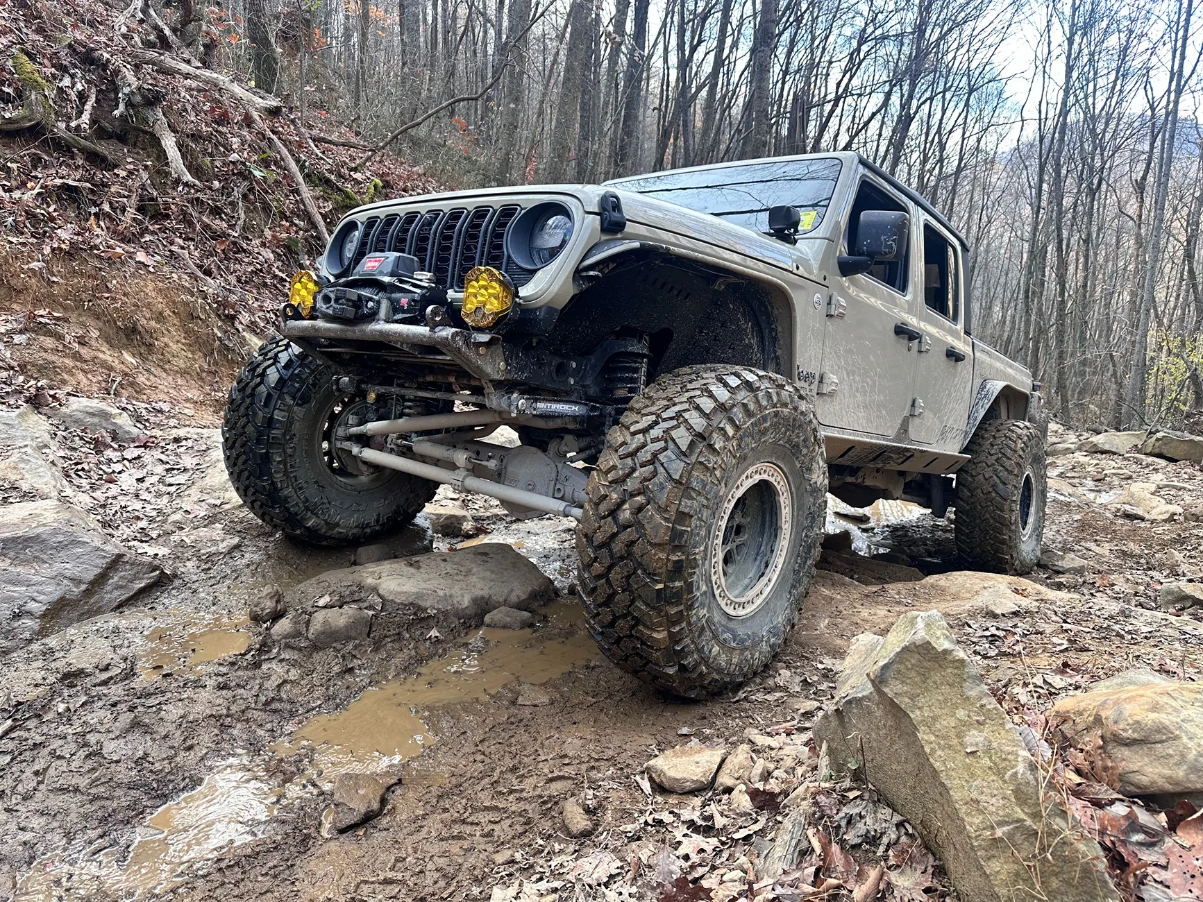

nbennettksu
Sep 1, 2023
134
163
Fort Lauderdale

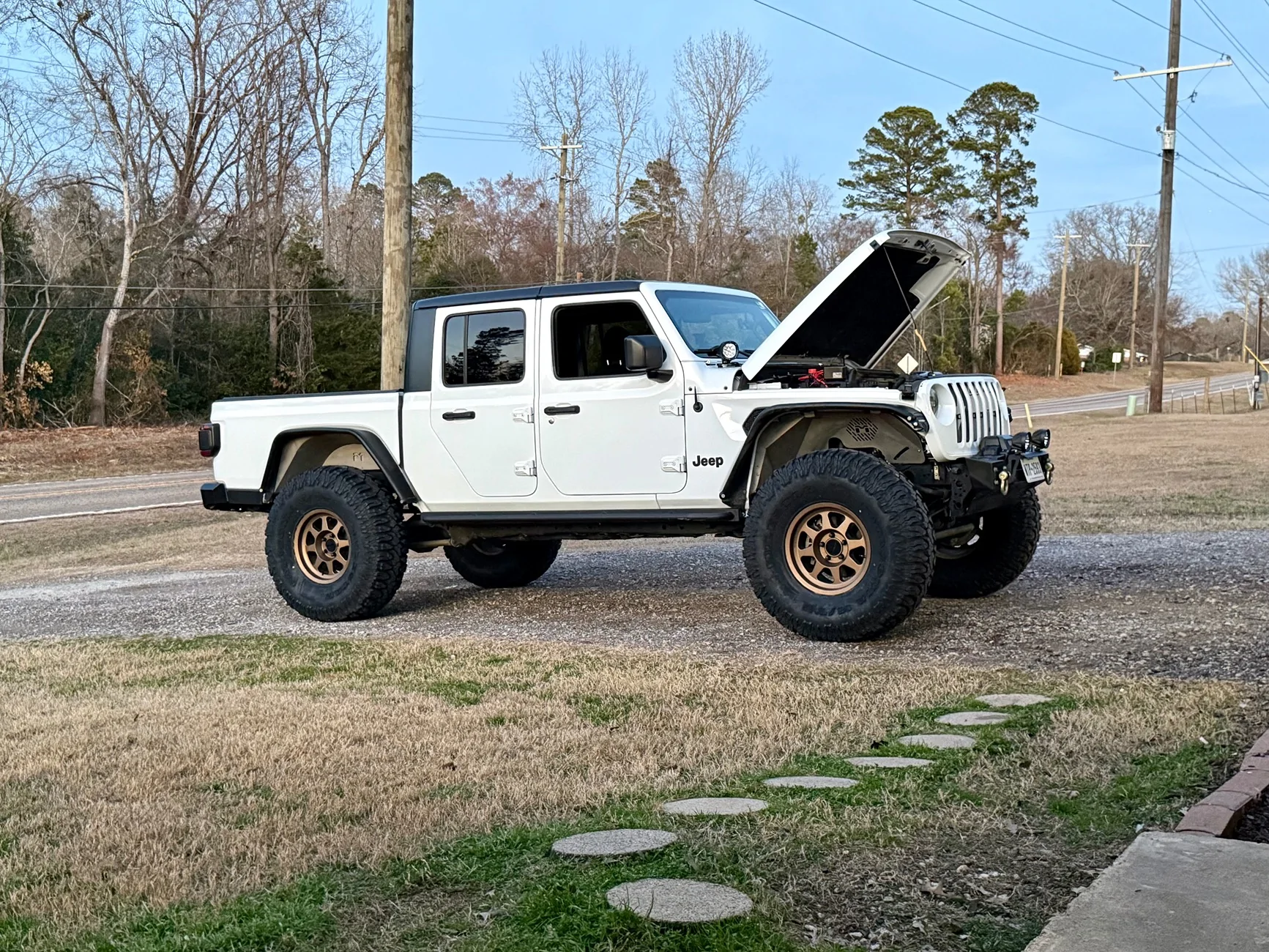

- 4.5” part tereflex part RPM mid arms.. for now
- Falcon 2.1 shocks
- 40" trail grapplers
- Spicer Ultimate DANA 44 front., OE rear
- KDB highline fenders
- Kmc grenade
- RPM fr/r track bars
- rockjock antirock front, soon rear
-Tom Woods front drive shaft
- Falcon front stab
Jeep Gladiator 40’s Fitment. IMG_2146

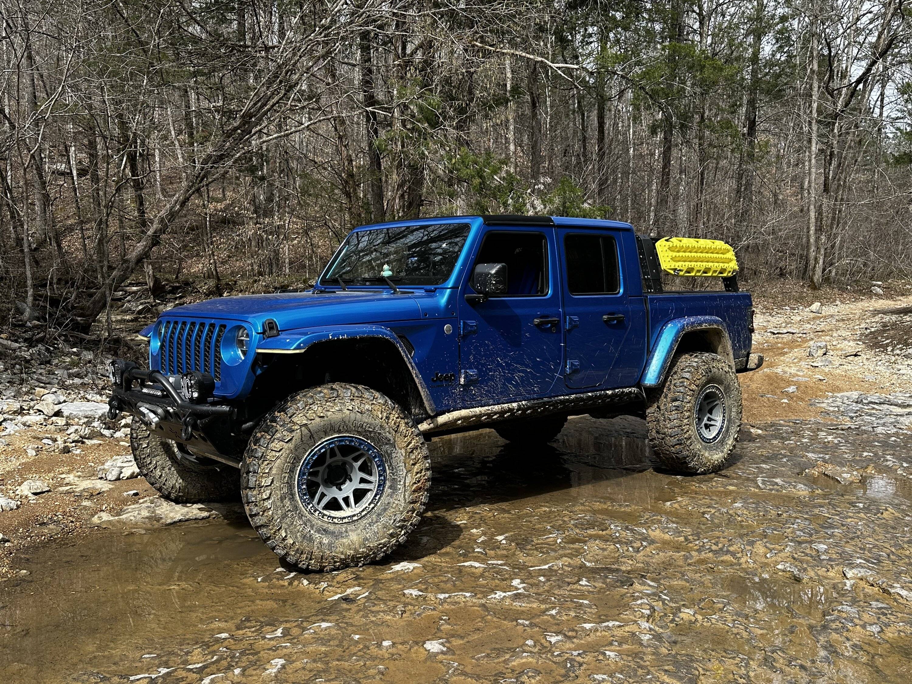

slodsm
Jeremy
Jan 24, 2026
71
130
Tyler Tx
2021 Gladiator
Cryogenics plant operations

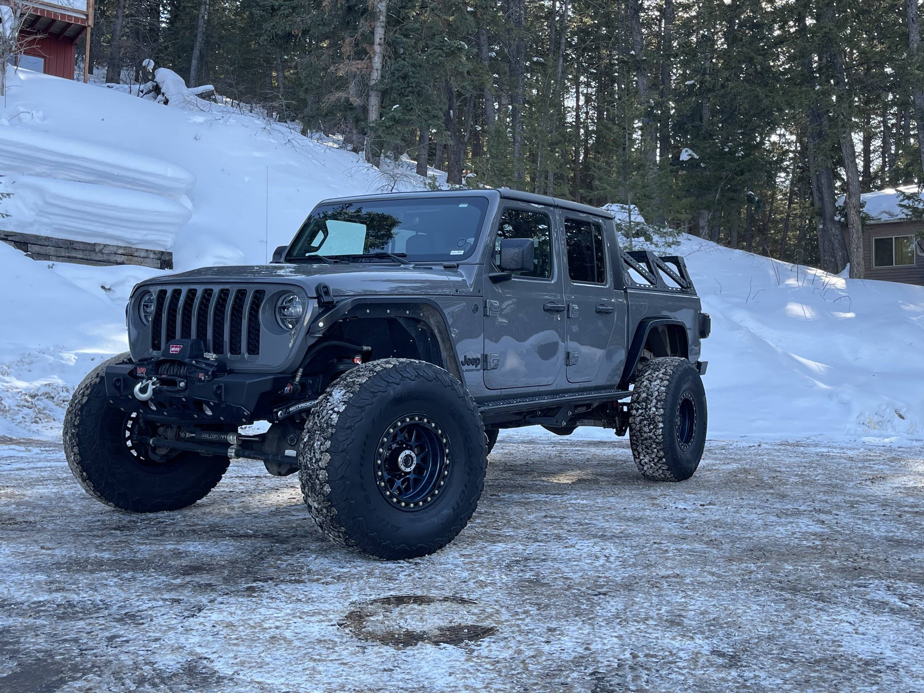

Patagonia 40’s, method 703 17x9 -12 with metal cloak game changer 3.5. I have 3” of bumpstop front and rear. I could use another 1/2 up front and lose a 1/2 in the rear. Since that isn’t possible, I may go to a 4.5” spring at some point because if I am stuffed hard and the tire is turned just right, I rub on the inside of my fender.
Still using a Dana 44 wide trac that’s completely built, I see no reason to put tons under it and add the weight when I never even had an issue with the axles rock stock, my wife and I just take road trips and wheel and id rather not break something stupid 1500 miles from home if it’s avoidable.
Jeep Gladiator 40’s Fitment. IMG_1308

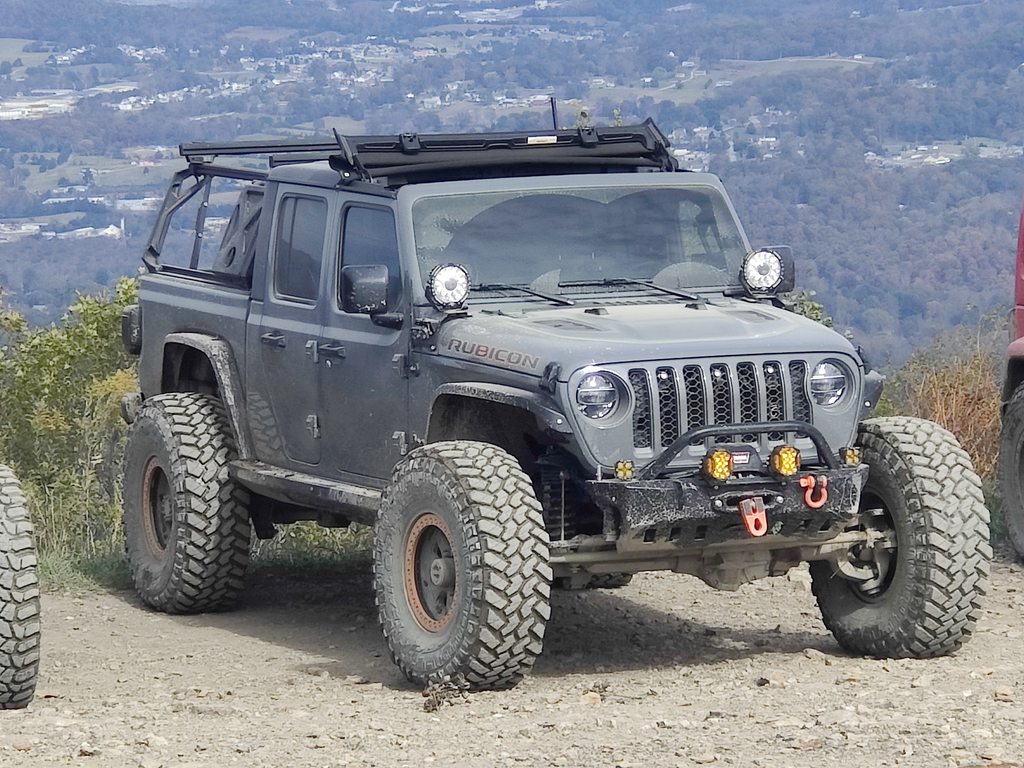

2019 Jl Rubibcon 2D - 2022 Jeep Gladiator Rubicon - 2020 Jeep Grand Cheroke
40's on Dynatrac 60's Full width 72"
17x9 wheels with -12mm
3.5 MC GC lift
3" of bump stop f&r
Not much rubbing anywhere.
Jeep Gladiator 40’s Fitment. IYHqtu2h
