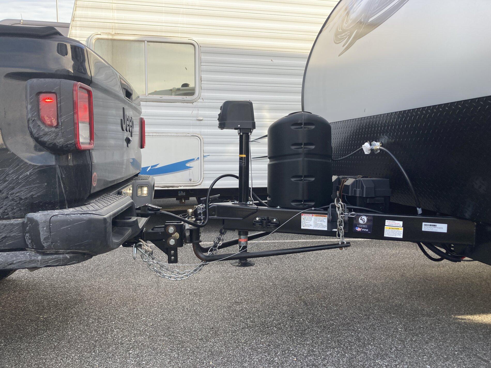

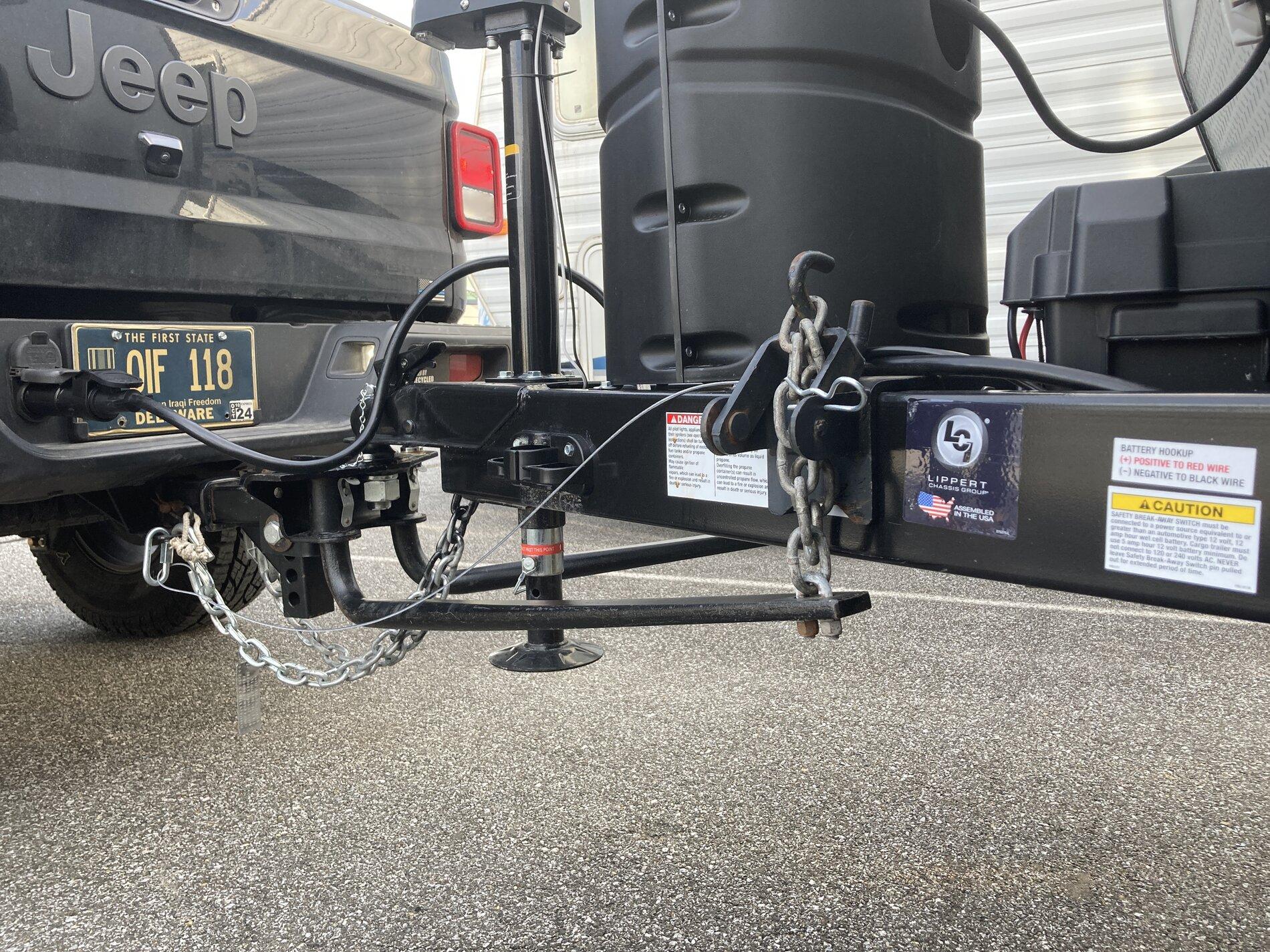

this is exactly why I went a little smaller on the TT, and got the max tow package. It gives me room for wiggle with ballparking numbers. Ive learned to make the adjustments over the last year but pretty much have it eyeballed and dialed in lol. Though I still think my WDH needs adjustment since the bars just dont look right to me...despite it hitting all the measurements int he install instructions for the E2.
