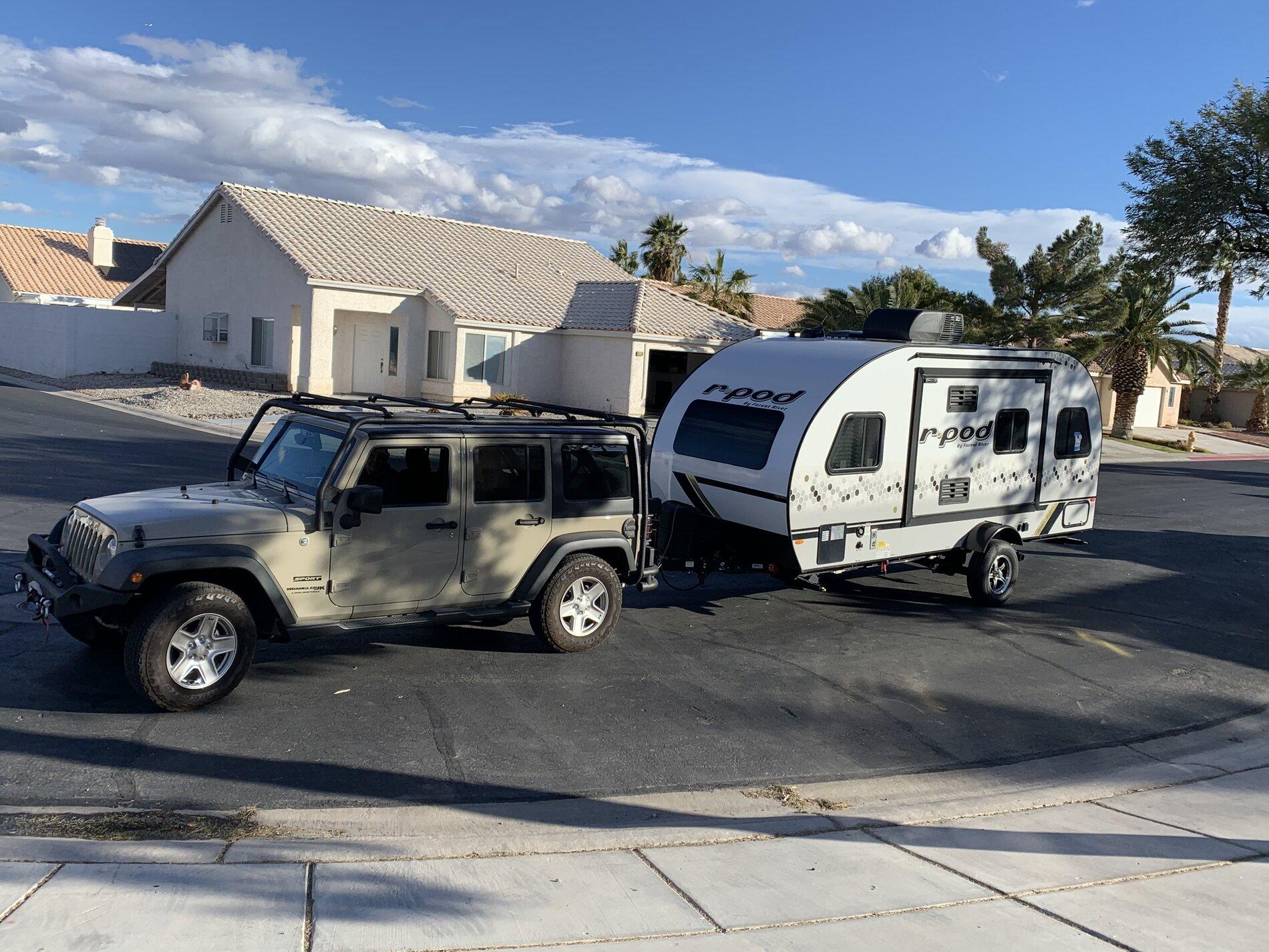

We use our Equal-I-Zer weight distribution unit because it is also an fantastic anti-sway unit. We use it because of the huge difference it makes in handling, especially with high side-winds and large trucks passing. Stops sway dead and bounce. The weight distribution also keeps the front wheels down on the ground with full force. Without the WDU the tongue weight tends to force the front wheels to unload and the nose of the vehicle to rise up. You can see it in the R-pod picture I posted. That's why I mentioned that the unit had not been set up when the photo was taken. But it does clearly show how the trailer lifts the nose and reduces front wheel traction. The comment about the tongue weight reducing the available car load is absolutely correct and can be a real problem if your load is close to capacity. I'm a big guy, we have two dogs etc. with the full 350 lbs tongue weight used by the RPod on the Wrangler, we could not have guests in the back seat. Hence the move up to a Gladiator. I would use a WDU/anti-sway on a 2000 pound load specifically because of the VERY improved handling. The CURT Echo brake controller also makes the whole set-up unbelievably easy. Especially for beginners. No wiring, no complicated setup, goes with you when you change cars. We always test new rig stuff locally by test camping at a local KOA or Sams and driving a self made obstacle course at a local Walmart. Hope this helps, have fun.
