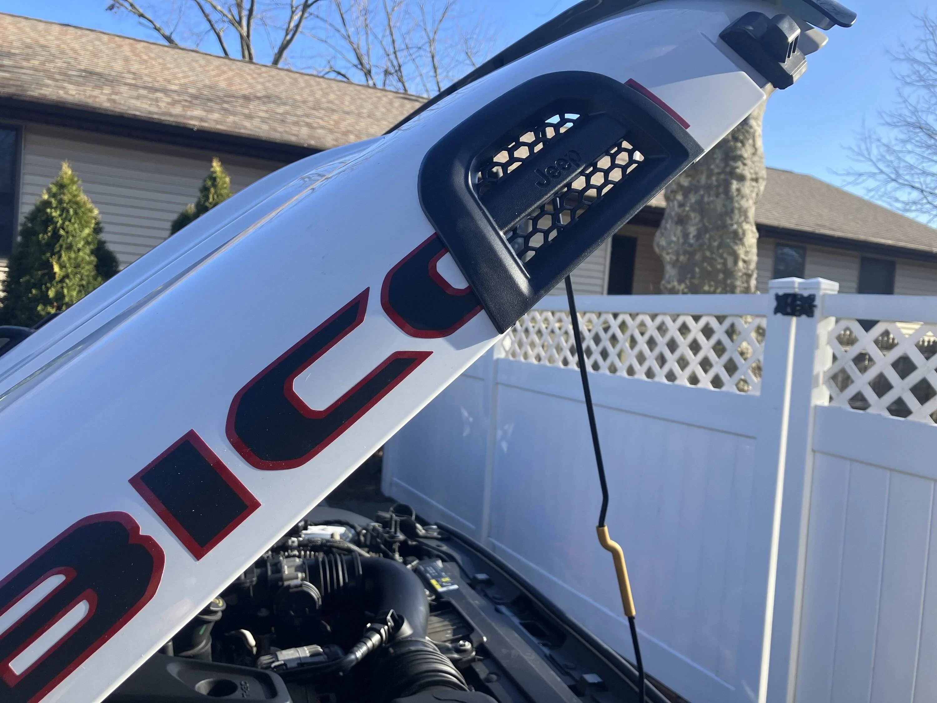

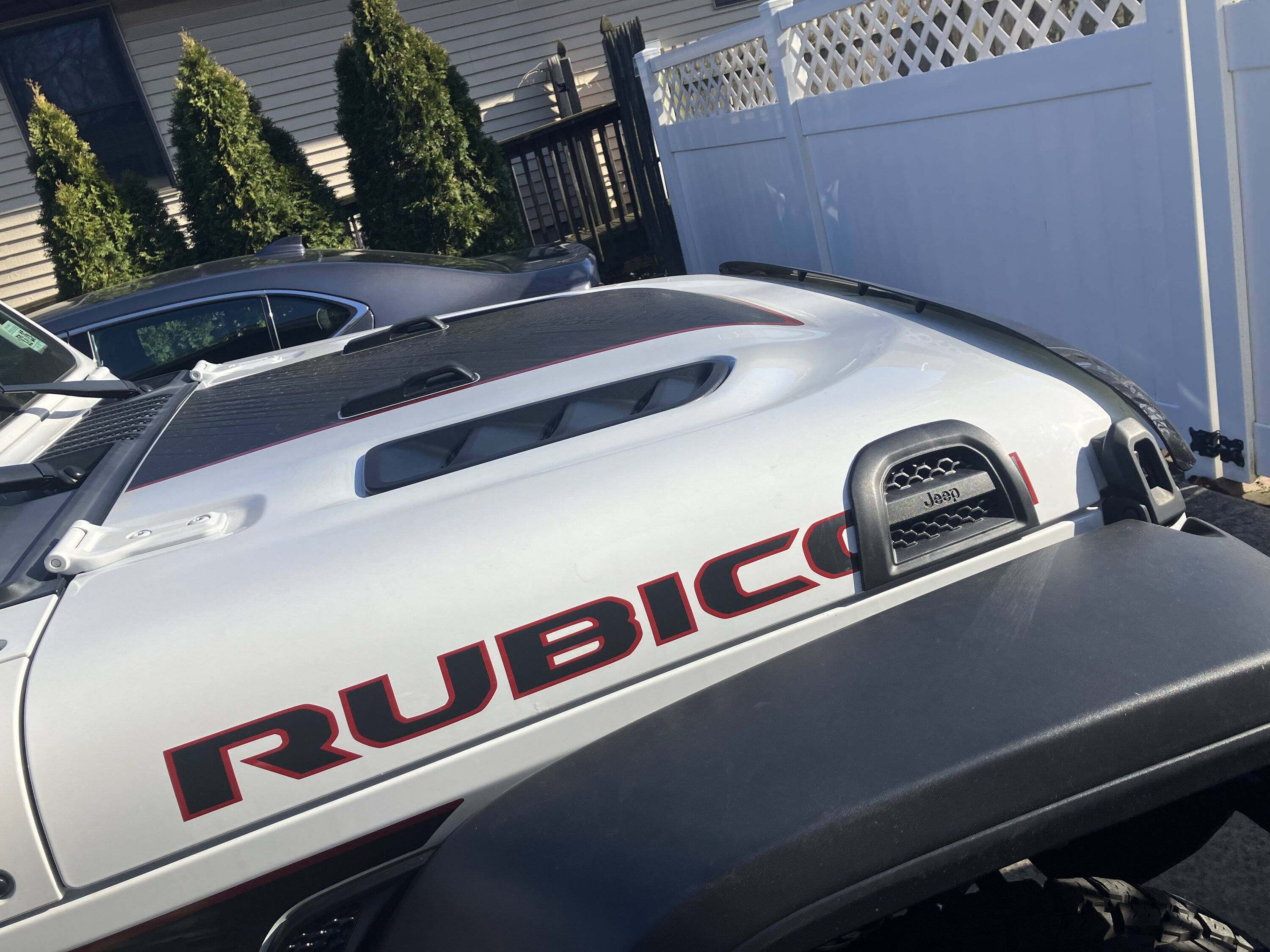

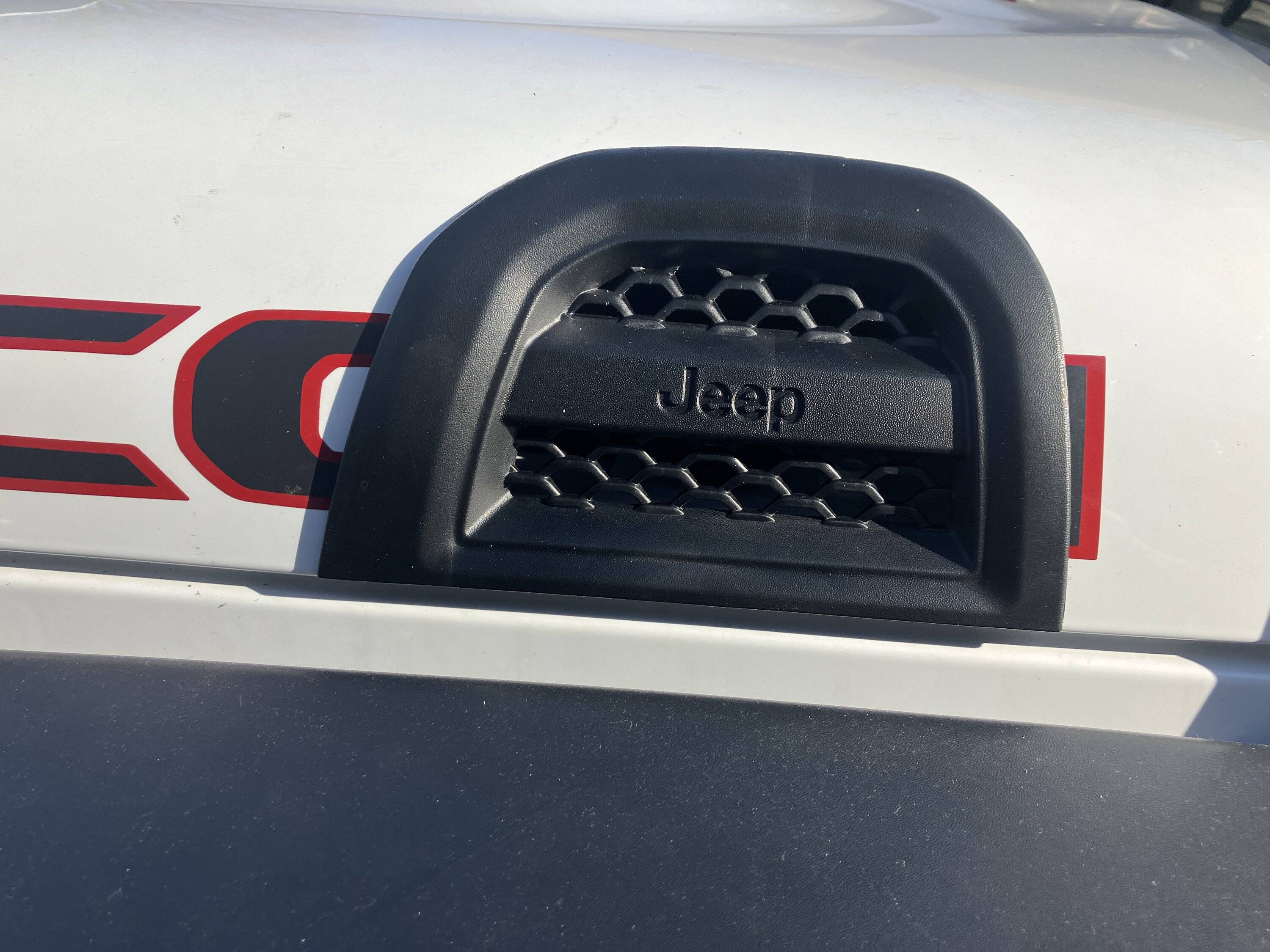

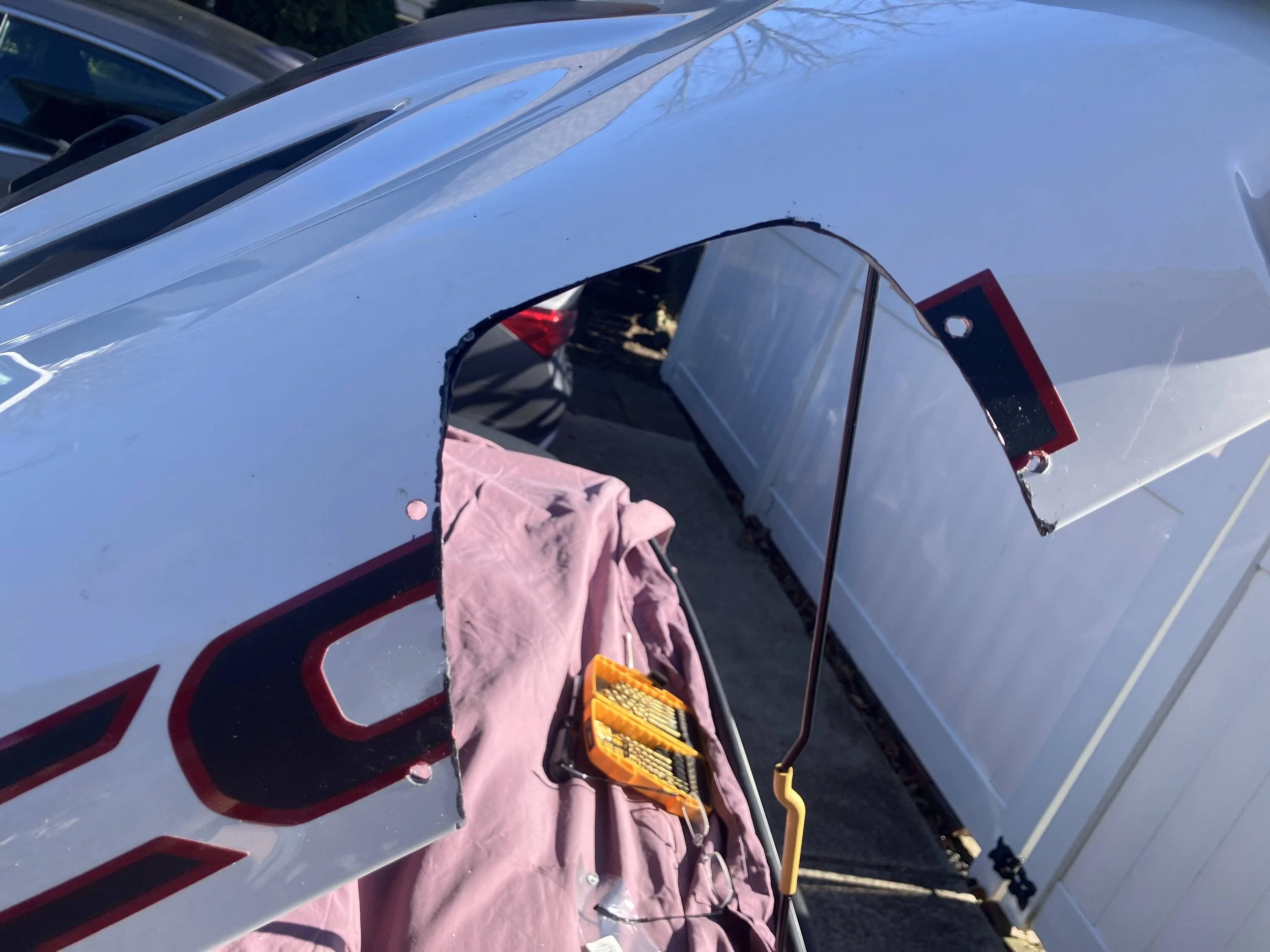

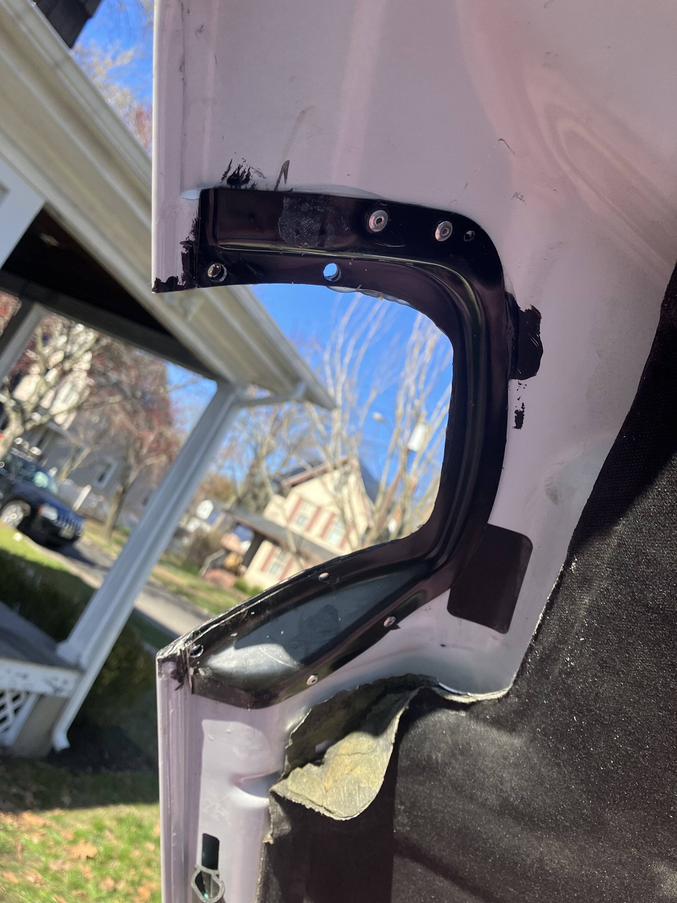

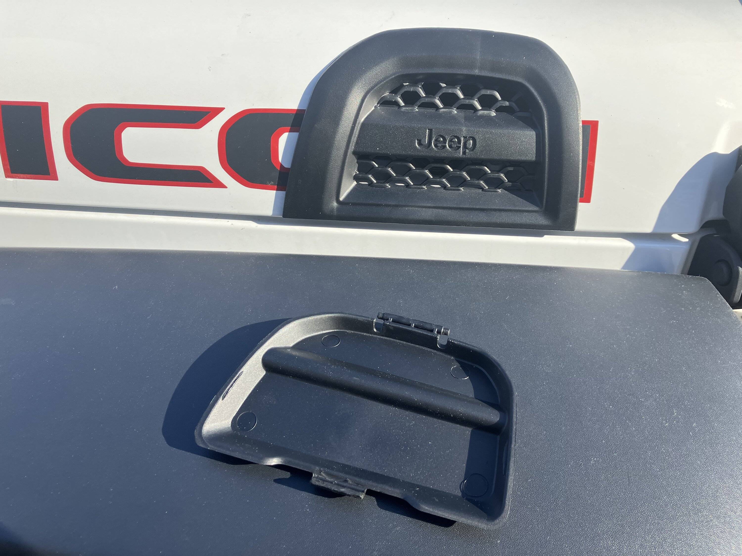

Well I pulled the trigger and dissected my hood to complete my Mopar CAI. Been gathering the courage to cut into a $56k Jeep and not f#>k it up. Was considering the rugged ridge intake pipe set up that had the cowl vent replacement. Just seemed it was a lot of distance for the 3.6L to have to pull air. I like how the Mopar design has no restrictions. With the vent being located at the mouth of the air box. Install was fine, lots of tape, measure twice, and have a good dremel with all the fixings!! As I will testify “ it’s not for the faint of heart “ but if I can do it anyone can. I can unpucker now it’s installed ?.

Looks like you did a great job. Is there risk of filling the entire box with water? Or water from melted snow? Days like these would make me wonder. I understand that the water stays under the filter, but with a really heavy rain, would it empty out the bottom of the box fast enough to not end up in the throttle body when it’s running? I’m not hating. I’m genuinely interested in the path from above. Is water deflected inside the hood somehow?

Second to the last photo shows the removable block off plate that is included. It closes the intake off and allows the intake to function as factory and draw from the fender. The stock bottom of your air box remains if you install a Mopar CAI, which has drain holes in it, 4 I believe. So you are only replacing the upper half and filter. Charge pipe is different from stock, also included are both boots with clamps and an installed MAF sensor. Of course the cutout assembly. I had a Scat Pack Challenger with the heat extractor hood never had an issue snow, rain, ect with anything in the engine bay. Like the instructions state Use common sense.
