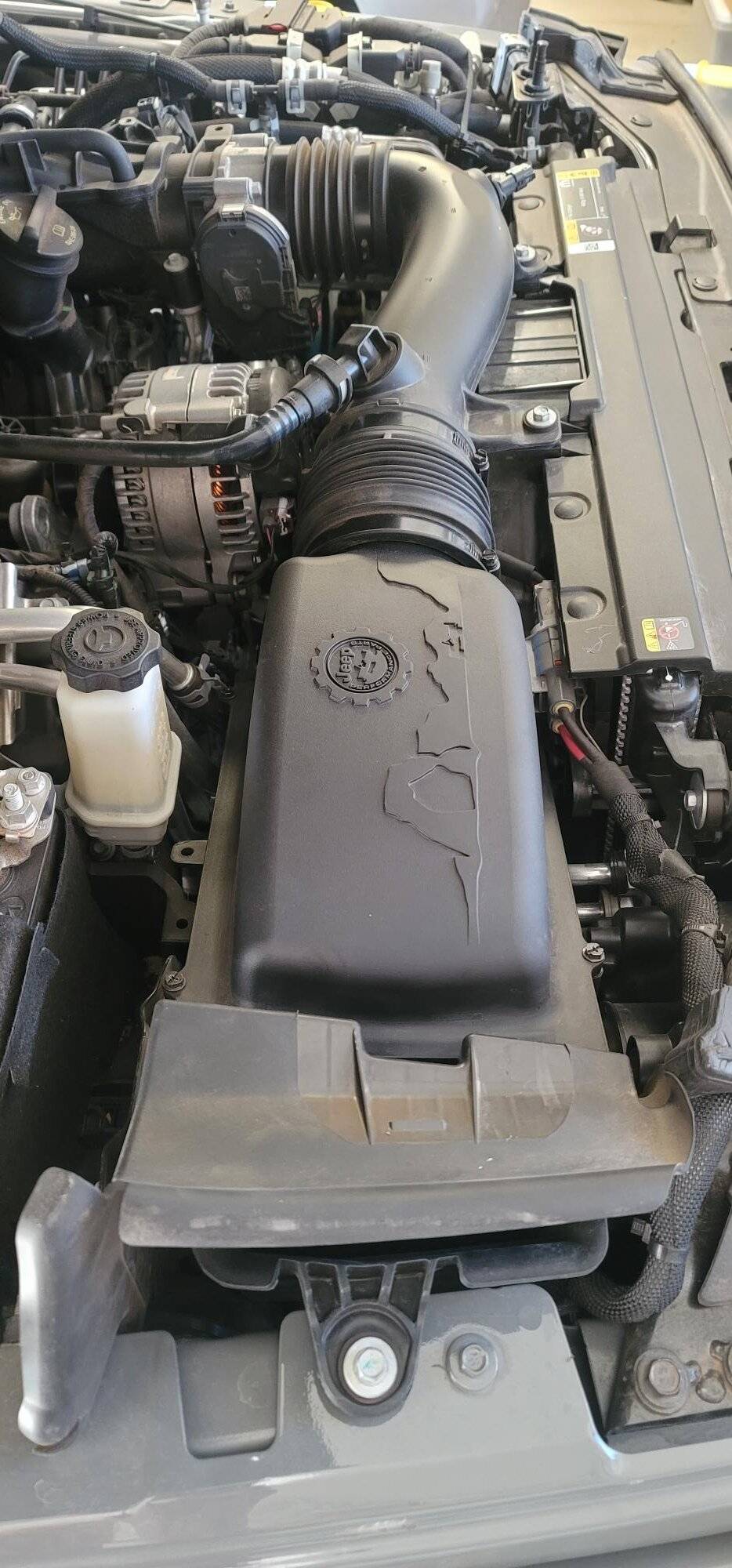

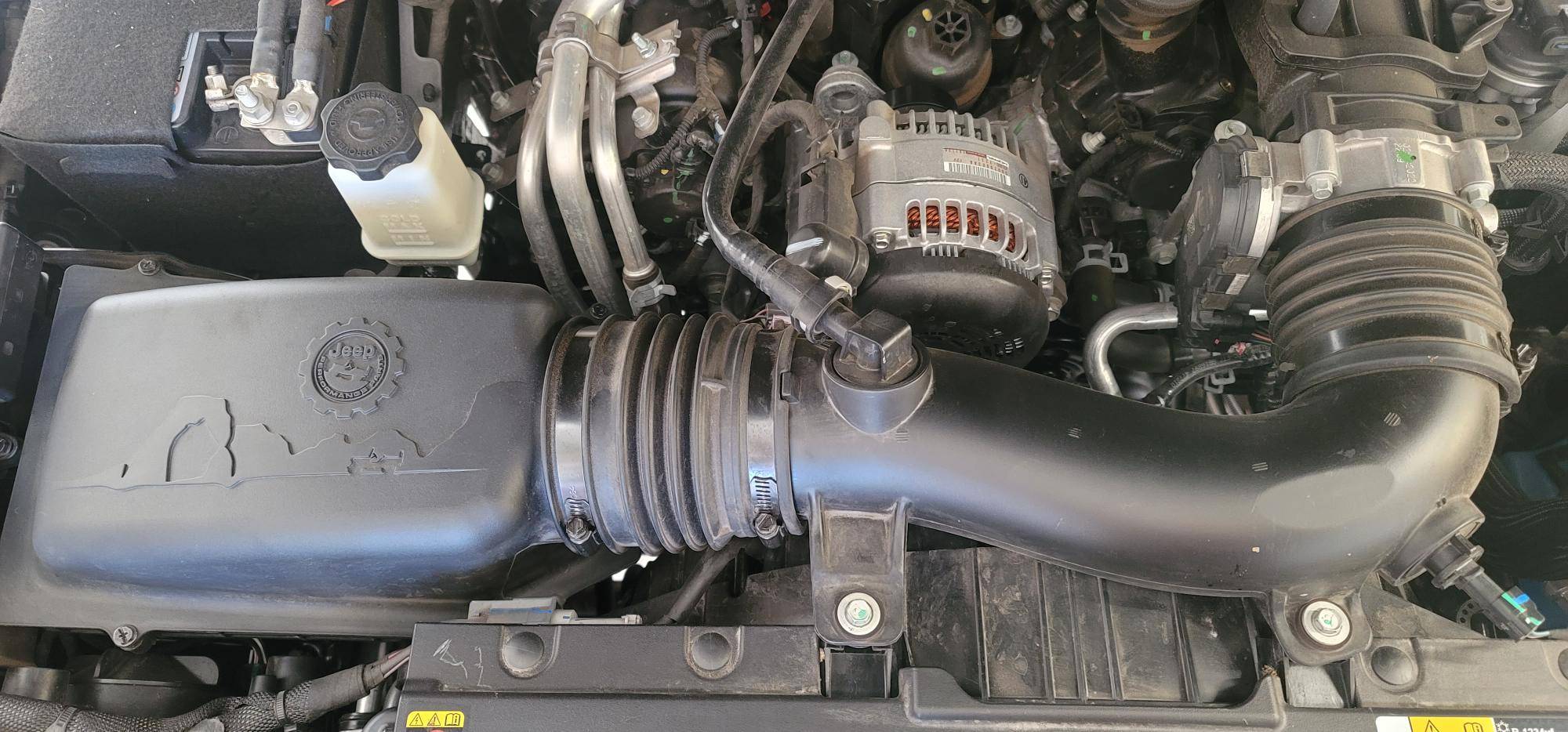

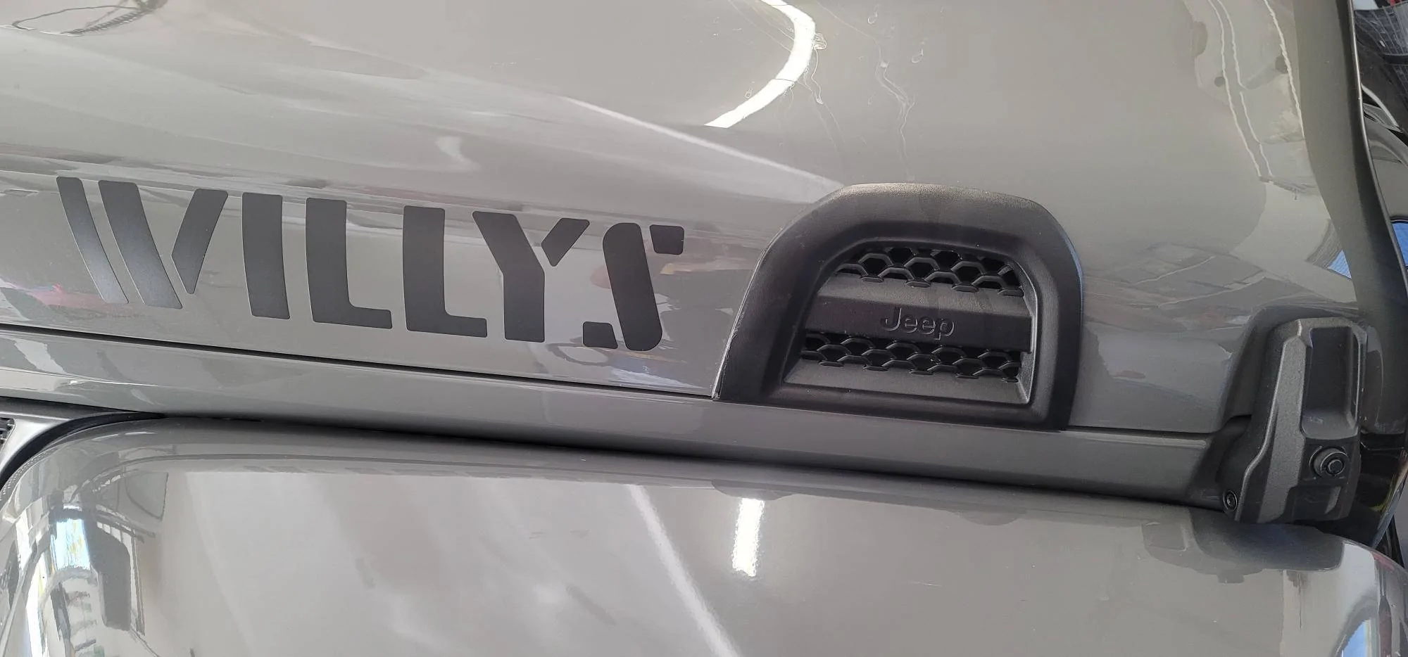

I have to agree that this install is not for the faint of heart! I did not remove the hood so I would not have to crack the painted bolts. I have done enough upgrades and repairs but this install was the most nerve racking too say the least. Since I have a Willys, shorter than Rubicon, no issue covering any letters. I have taken this through several car washes and driven in some decent rainfall and no issues with water getting in.

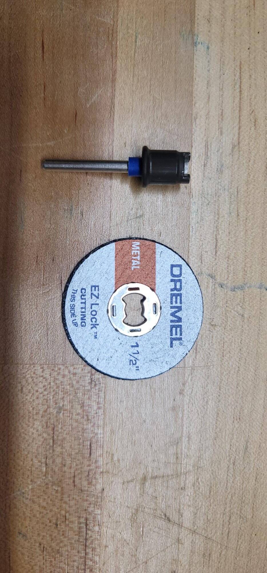

Confidence is needed but if you follow the instructions, it actually went quite well. If you do decide to go this route, use a Dremel tool that is AC wired. I do not recommend using a battery Dremel tool unless you have about 10 batteries! I had only 2 batteries so a 3 hour job took 6 hours! Also I used the Dremel Cutting wheel and it works very well.
