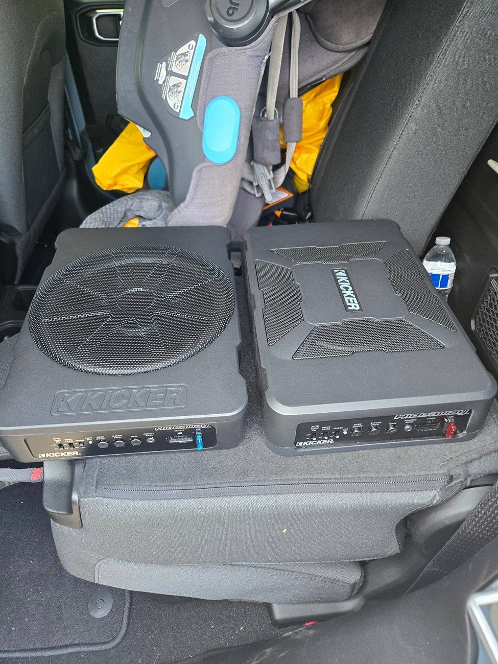

Ok , lets get into this. Going to kill the debate. I bought both the 8 inch kicker hideaway and the 10 inch kicker hideaway. HS8 vs HS10 .
My expectation before the install = they are going to sound about the same. A person on Reddit stated that he hooked up both and could not tell a difference.
BOTH the HS8 and the HS10 use a 14 gauge power wire. That is a pretty thin wire.
HS8 uses an 8 inch sub ,and the HS10 uses a 10 inch sub.
The HS8 is rated at 150 Watts , and the HS10 is rated at 180 Watts . Very Minimal difference .
20 Watt difference is nothing .
After hooking up both subs and adjusting the bass knobs , the difference is VERY VERY minimal .
The HS10 (180W) only has 20 more watts compared to the HS8. You can barely tell a difference . They are both amp/sub combos. They will not hit like a 500 watt subs in box setup. If you had a 180 watt vs 500 watt , you should hear and feel a difference . But , a 150 combo vs a 180 combo , there just ain't that much of a difference.
That's my opinion after purchasing and testing both subs.

I don't know how many amps these subs draw, but 14ga wire can handle up to 20 amps at 12v.
14 gauge wire can handle a lot depending on how long of a run it is.
