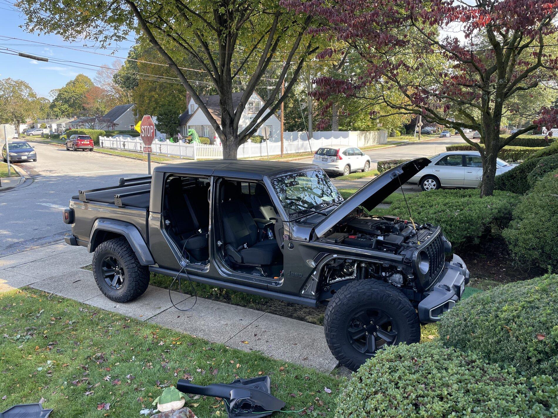

Pulled doors and front fender off to limit contorting my old body into spaces it doesn't fit.

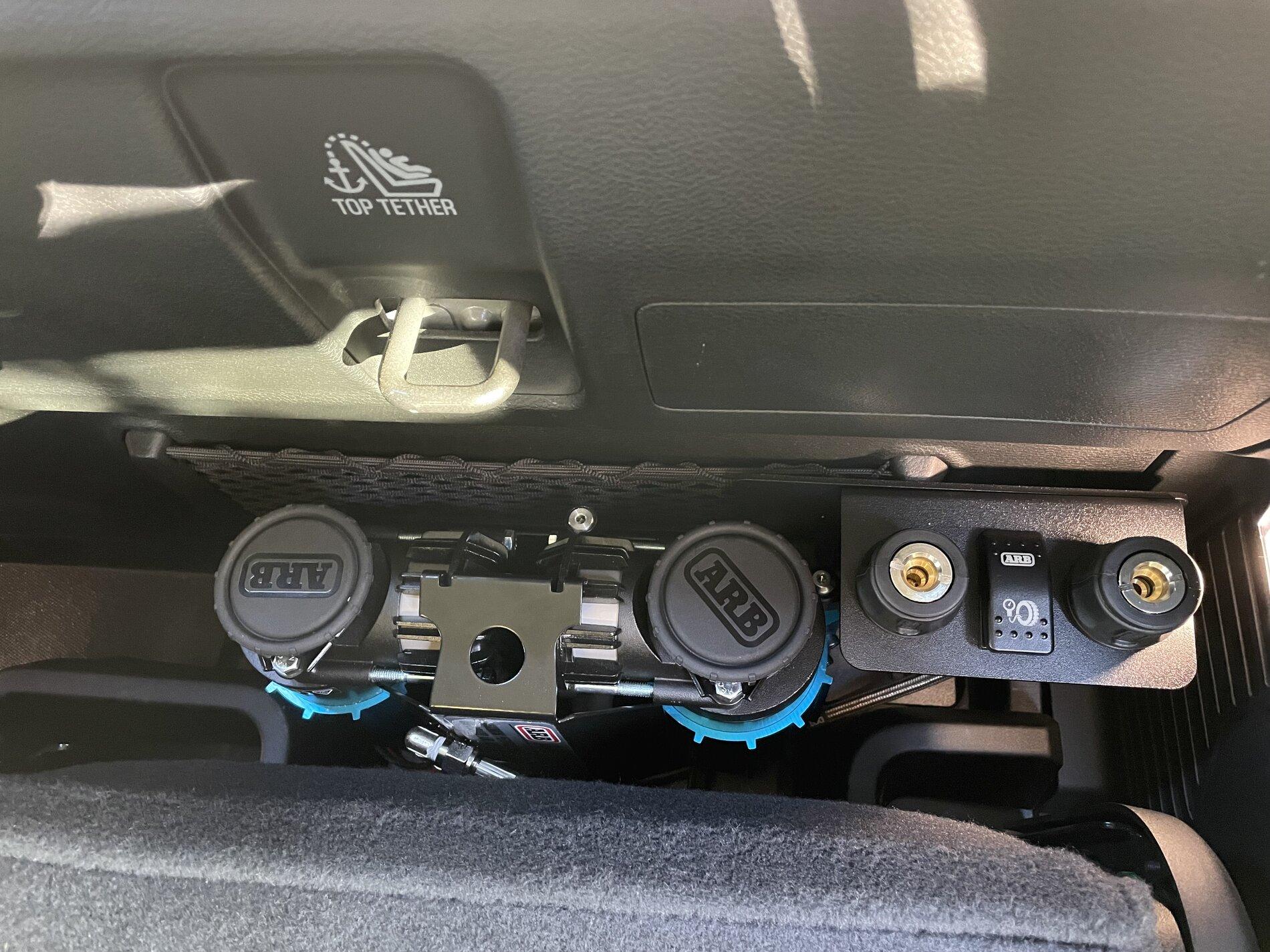

Compressor mounted.

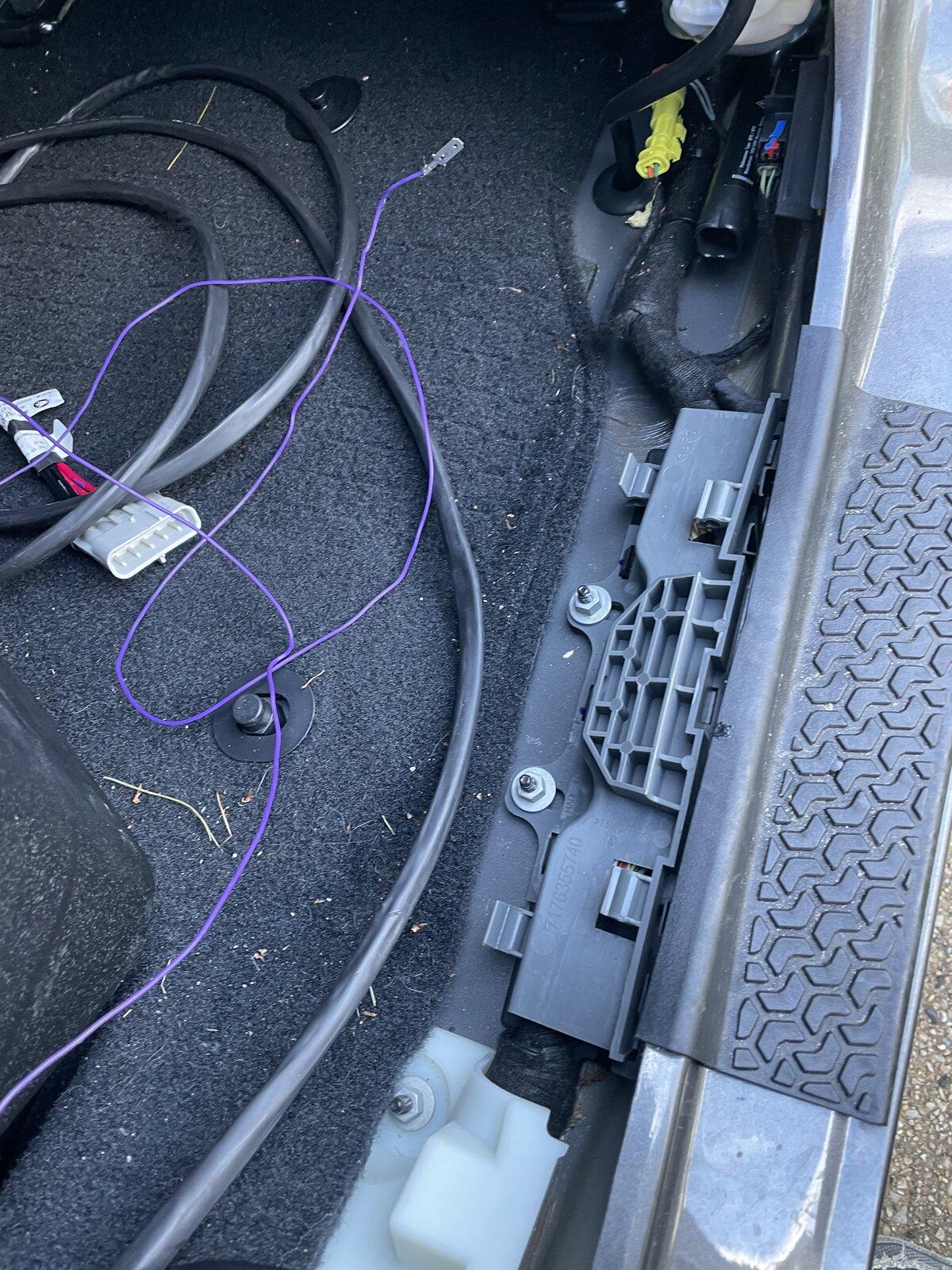

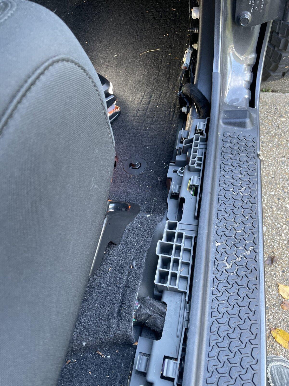

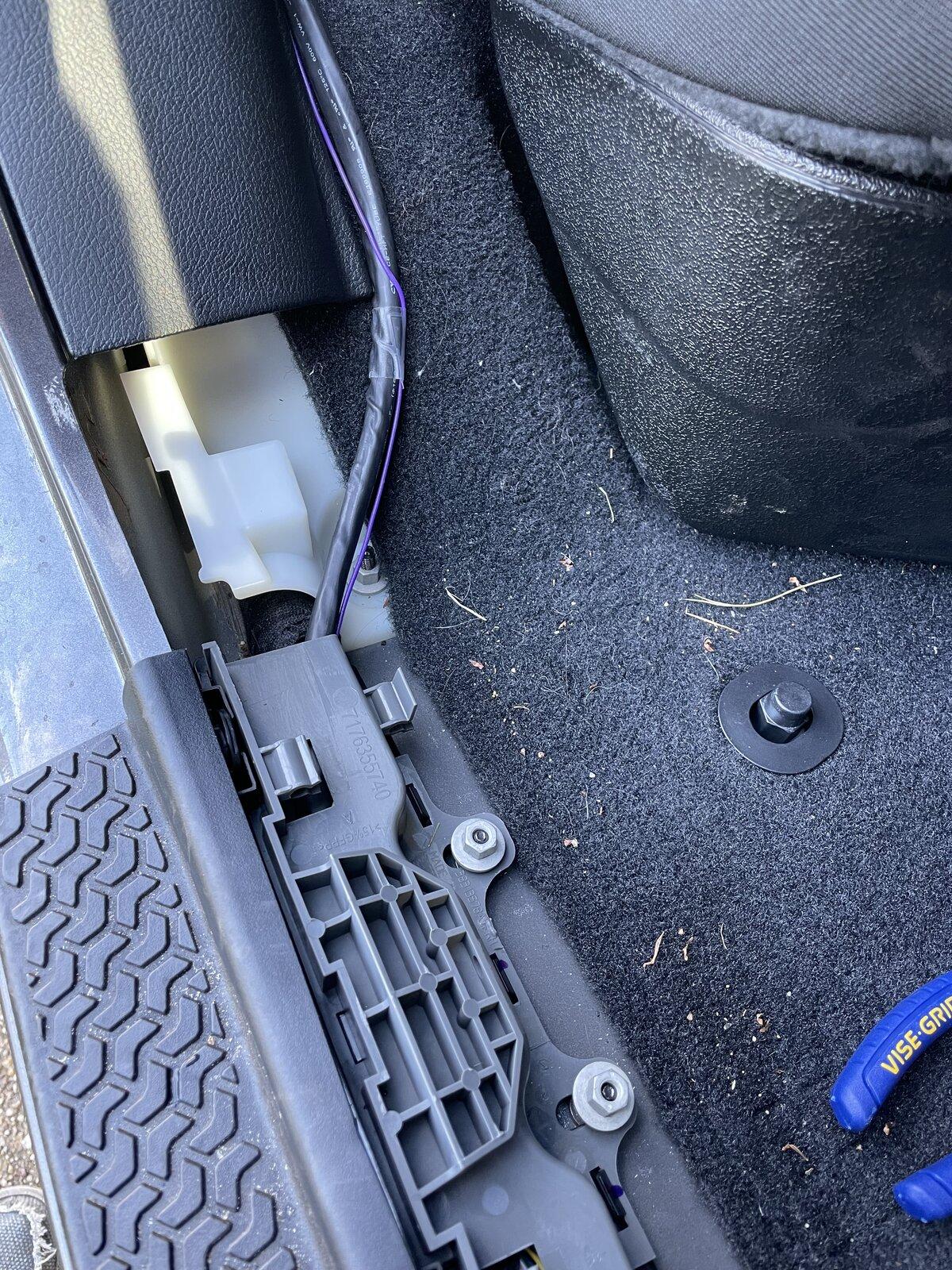

Removed all floor moldings to run the wires, heat shrinked all connections

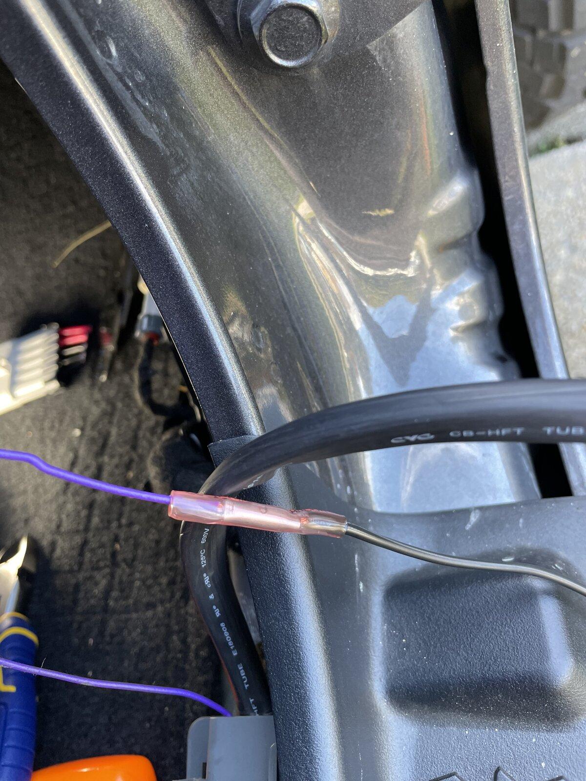

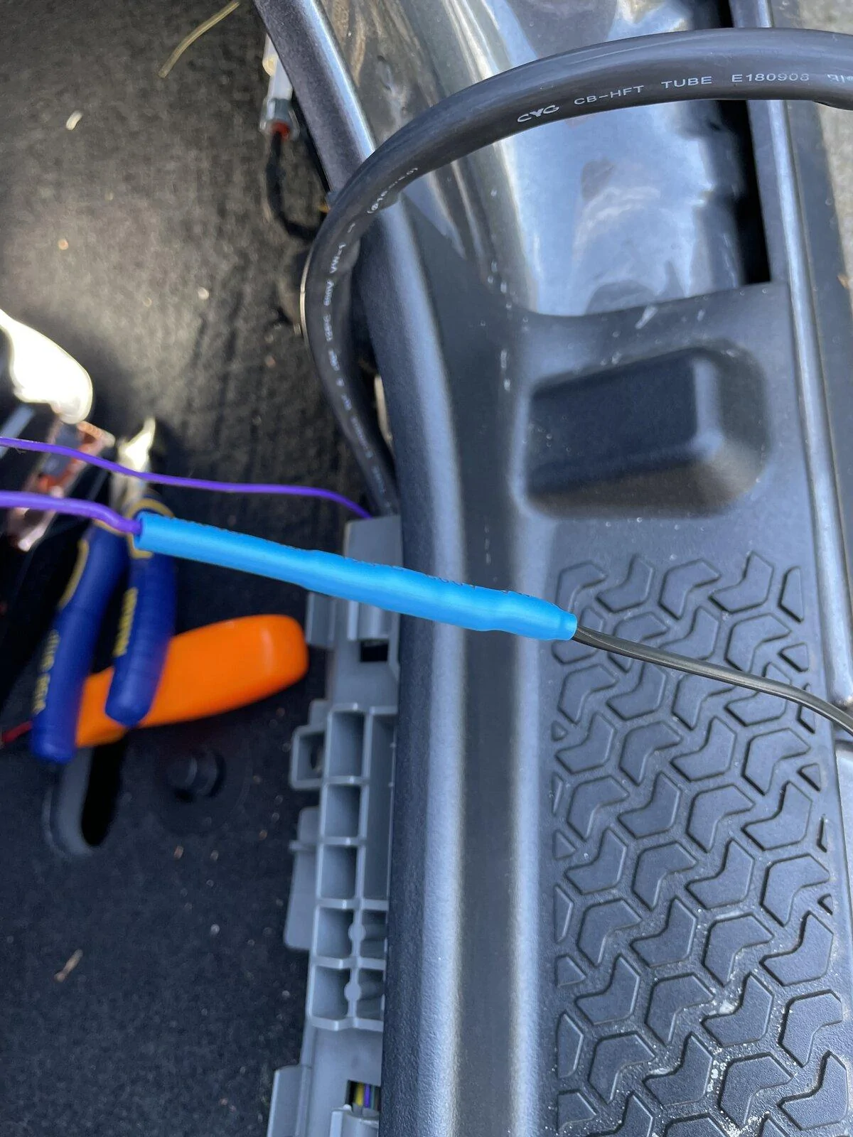

Extending the purple wire to reach the engine bay and the VOSwitch box.
Jeep Gladiator 813 Fab - behind rear seat mount questions. IMG_1065
Jeep Gladiator 813 Fab - behind rear seat mount questions. IMG_1066
Had to call and audible since I could not for the life of me get those wires through the firewall. Everything too packed in on the drivers side engine bay. Beat the shit out of my hands trying. So, I went through the drain hole on the front passenger side. Ran the purple wire to a VOSwitch, and grounded the black wire to the bolt holding the compressor to the floor.
