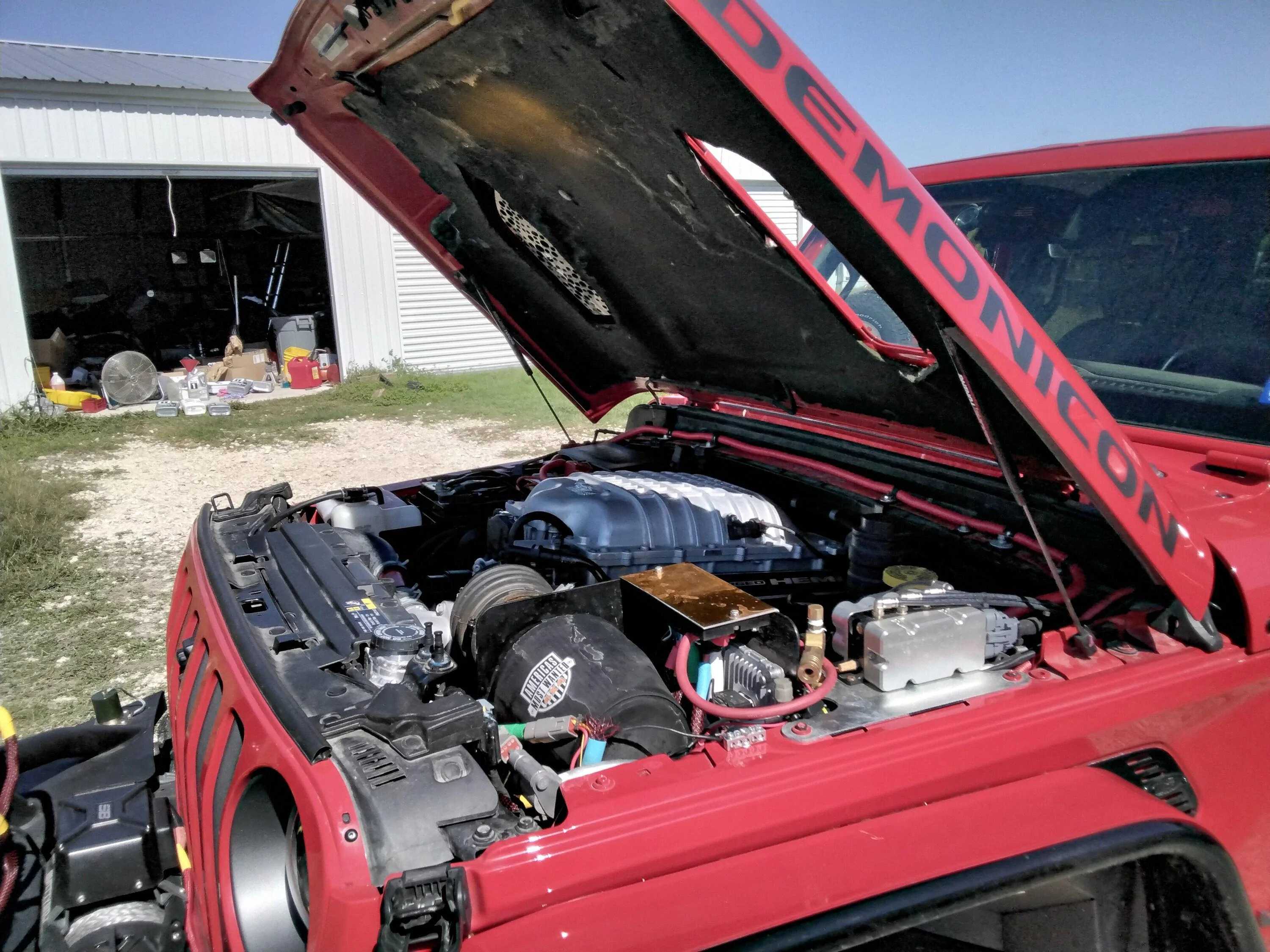

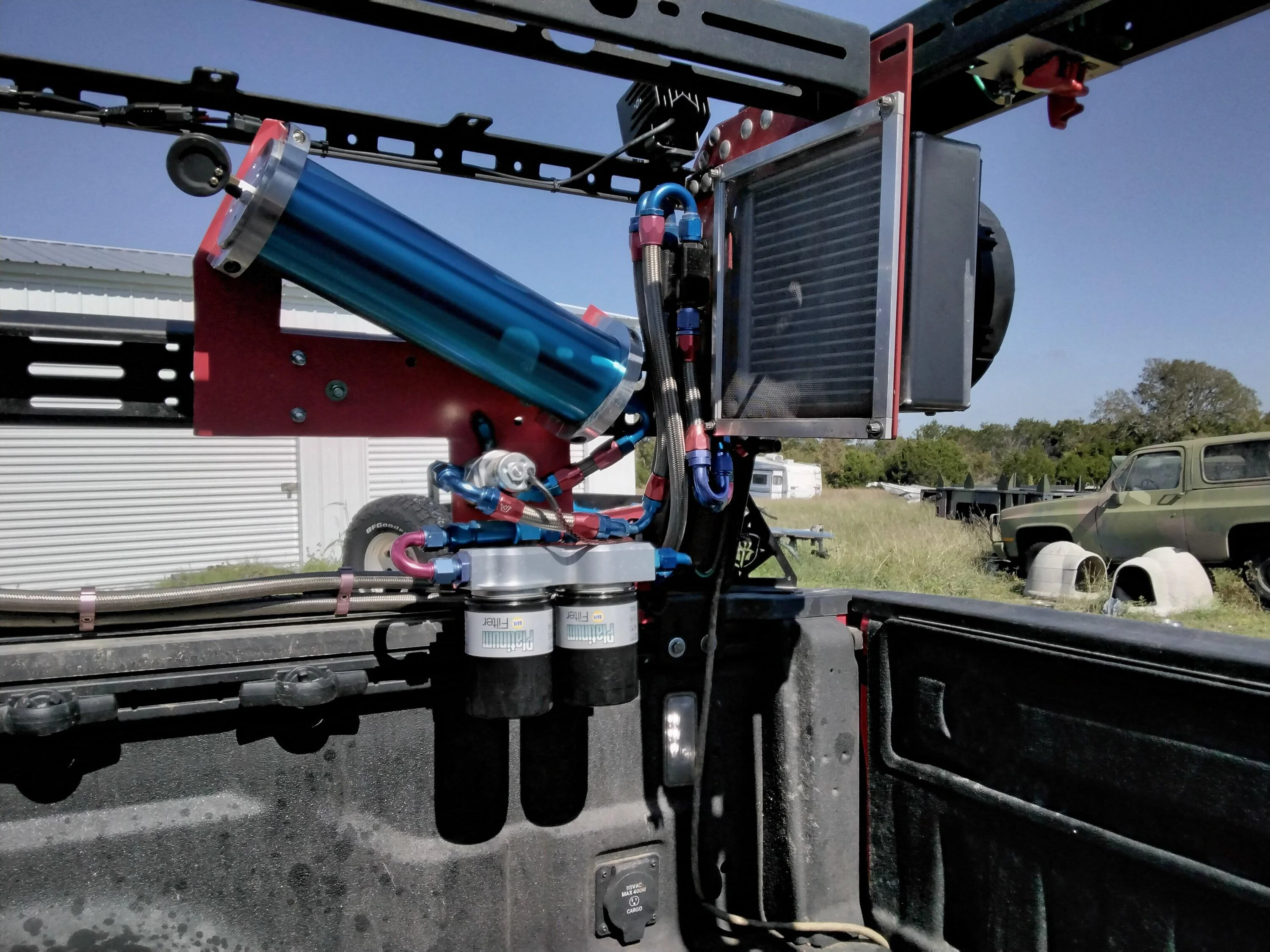

Here is mine, 50,000 on it and 7 mpg with 40's on Dana 60's. I do have a lead foot after 22 years on the Autobahns.
There will be minor problems. At 100 mph (2,300 rpm) the oil temperature would climb North of 350 degrees. Photo # 2 shows how I fixed that. Now it runs at 230 degrees at 140 mph.
You cannot put a price on how much you will laugh when you put your foot down.
I also added Methanol injection and am currently hooking up Nitrous, pictures to follow.
Jeep Gladiator 840hp Supercharged V8 Demon Gladiator Build IMG_20211025_132750
Jeep Gladiator 840hp Supercharged V8 Demon Gladiator Build IMG_20211025_132718

Thanks for the photos.
Do you have the oil filter bypass cooler and additional super charger reservoir? I think they are new recent additions.
I guess not, because I don't know what an oil filter bypass cooler is. Whatever it is, I'm sure it was added because of the insane oil temps. My supercharger reservoir is only about a pint, I intend to add another supercharger cooler in the bed similar but larger than the oil setup. At that time I will be adding an additional 2 liter coolant tank. You cannot overcool a Supercharger (I think?)
It goes between your oil filter and the block. It lets the oil pump through a cooler in the rad stack.
The new reservoir for the super charger is a large tank that sits where the spare tire go and uses a coolant pump from the trx to run fluid through.
