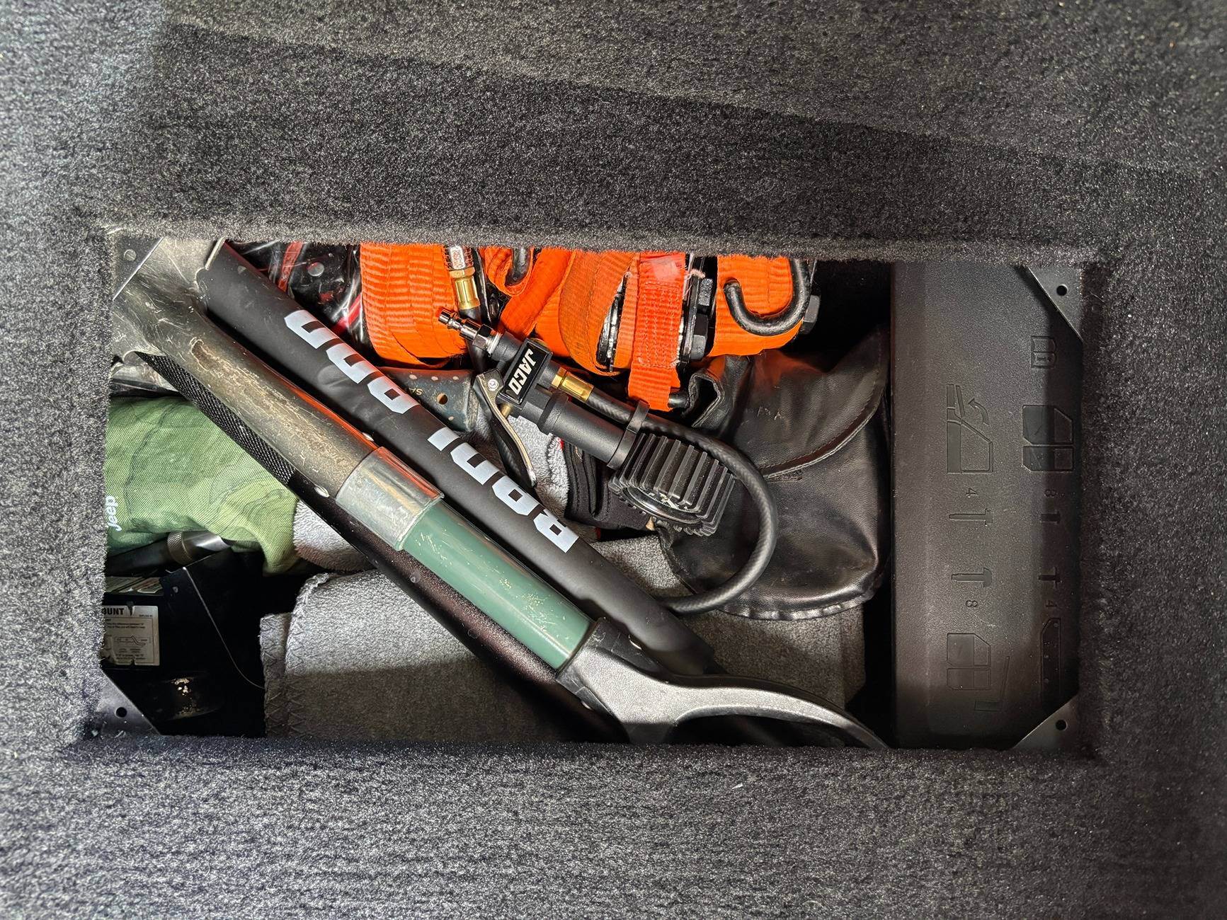

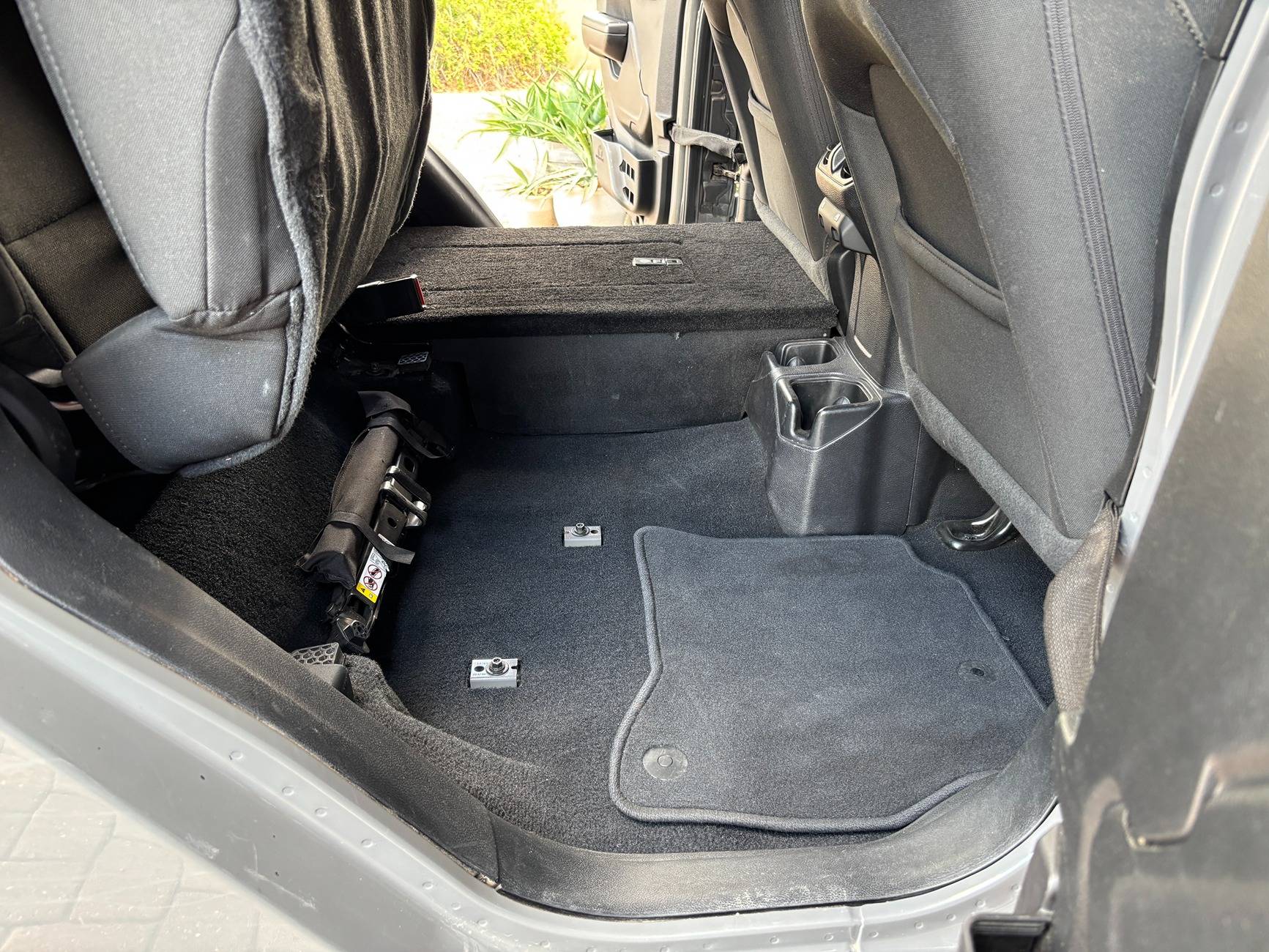

For months I considered purchasing a seat delete. While I appreciate the build quality from large-scale companies, I couldn't justify the price. $750 for 3/4 of a box was a hard pill to swallow, so I decided to build my own. The problem I also had was the under-utilization of space. To be fair, seat deletes on the market are for the masses and need to accommodate the front seats in all positions. If you don't have yours all the way back you're missing out on storage space.
I don't have any photos of the build process but this is the end result. Starting with the top, it's anchored in the back using the two factory bolts. Using a spade-bit, I bored out holes just deep enough to hold the heads of the bolts. This allows you a flat surface to place whatever you want on top. I measured the top so that it would leave a slight gap with the back of the driver's when positioned for me. After leveling the top, I then measured the front panel. Once that was cut and attached, I scribed the sides as the floorboard has a contour. Initially I secured everything together with dowels but ultimately abandoned this idea for good ol' fashioned counter-sunk wood screws. Pocket screws would suffice as well.

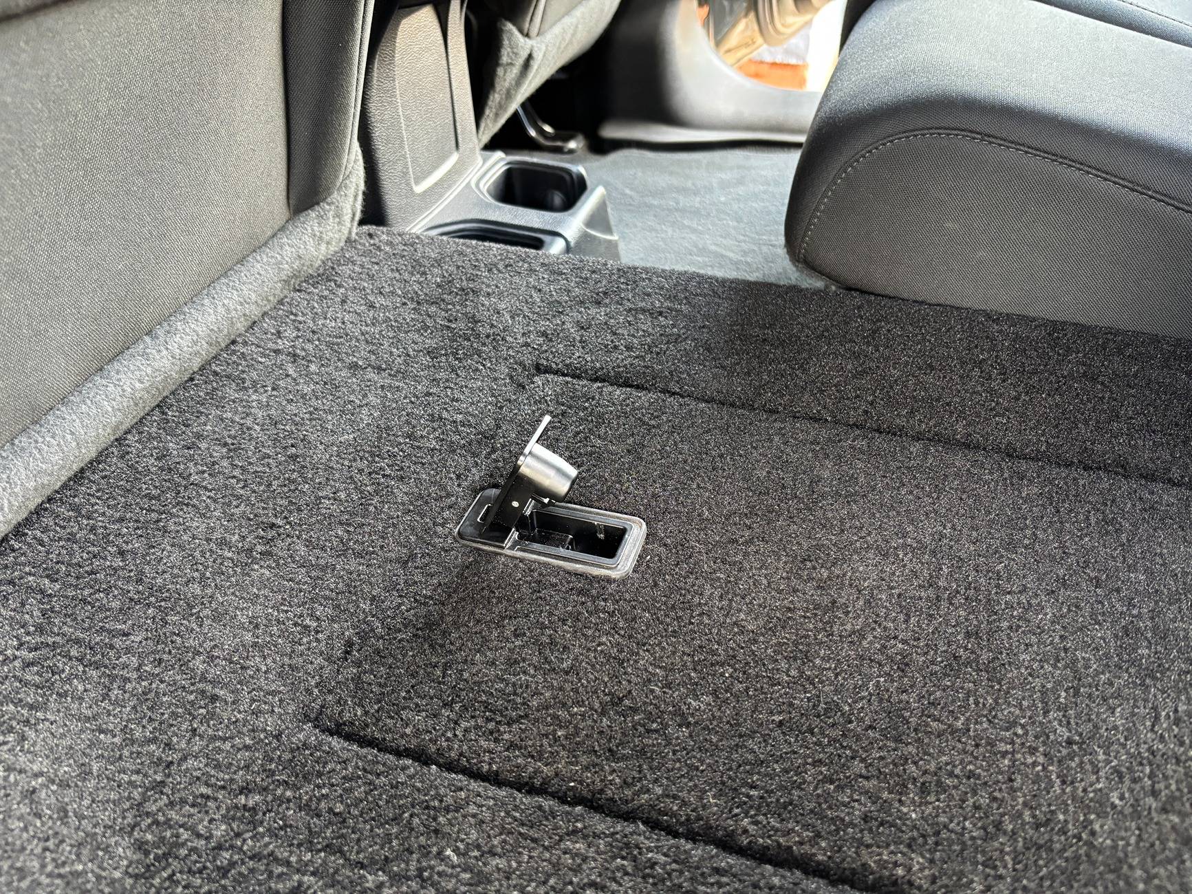

When it was all assembled, I then disassembled everything and coated the sides with bed liner. For the top, I cut out the hatch to account for the thickness of low-pile marine carpet and mounted a locking latch. The hatch is secured at the front with the latch and at the rear with a bar that extends underneath the top. Supports at all four corners keep it from falling down into the storage area. Carpeting was the worst part of this build and I'll admit I hid most of my mistakes under the top! But from above it looks great! Since I removed the storage bins both behind the seat and underneath, I built a small bin for behind the remaining rear seat using the same 1/2" plywood and marine grade carpet. It also has a narrow "bar" that runs along the back to cover a small gap.
Overall, I'm guessing I spend around $150 in materials with tons left over for future projects. Measurements are below.
20.5" wide x 40" long
Hatch
9.5" wide x 19" long
Interior
18.25" wide x 23.5" long x 6.5-7.5" tall.

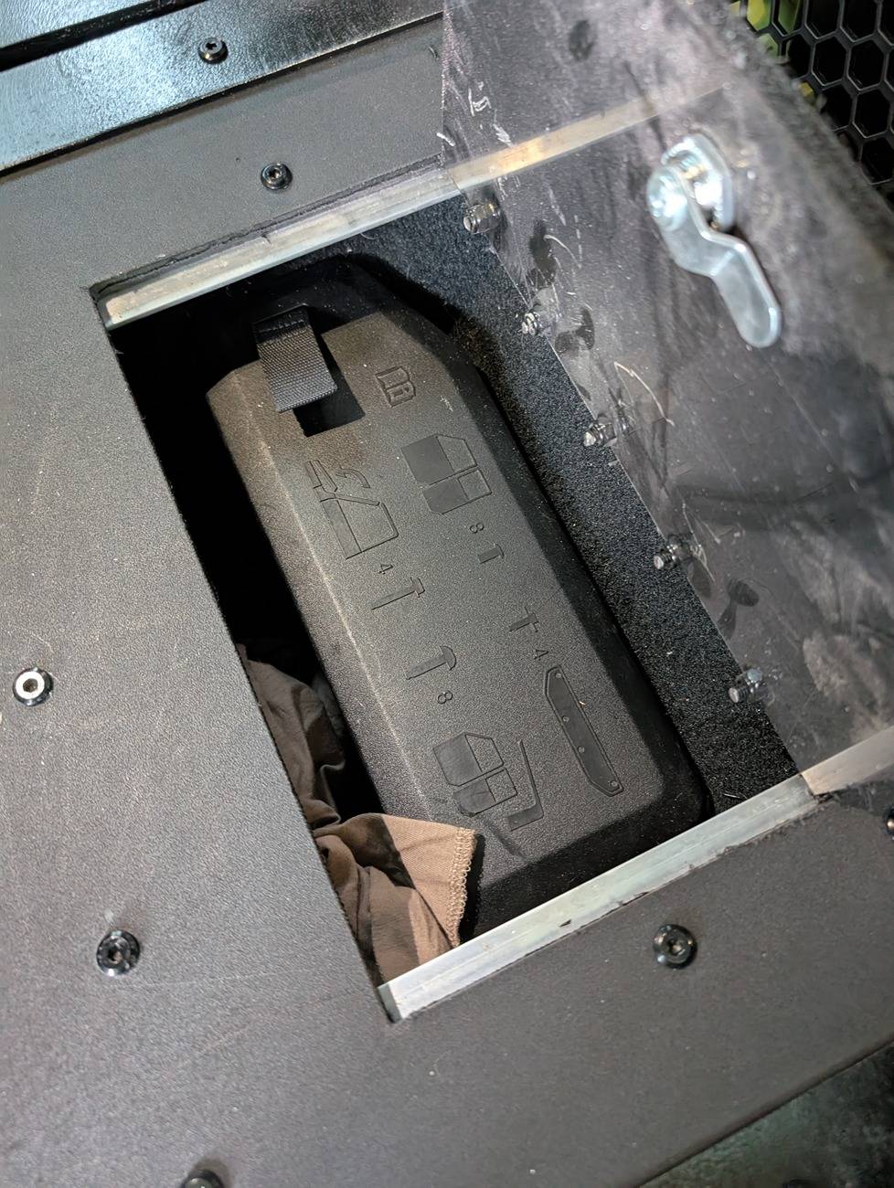

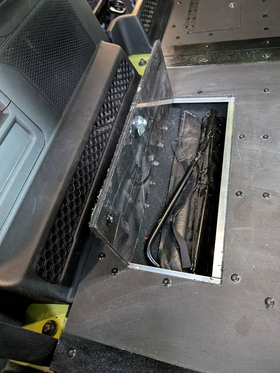

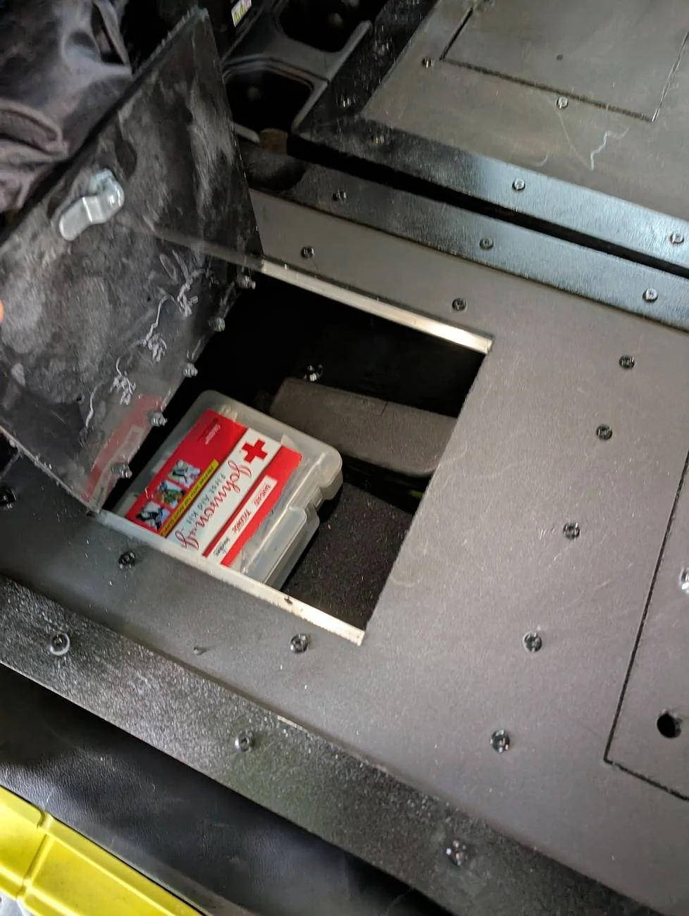

That one looks awesome, I finally completed my version. Made out of aluminum and 3/8 inch hdpe. Setup so you have easy access to the jack and screw box
Jeep Gladiator DIY Rear Seat Delete PXL_20250725_232547427
Jeep Gladiator DIY Rear Seat Delete PXL_20250725_232600403
Jeep Gladiator DIY Rear Seat Delete PXL_20250725_232636583
Jeep Gladiator DIY Rear Seat Delete PXL_20250725_232646167
