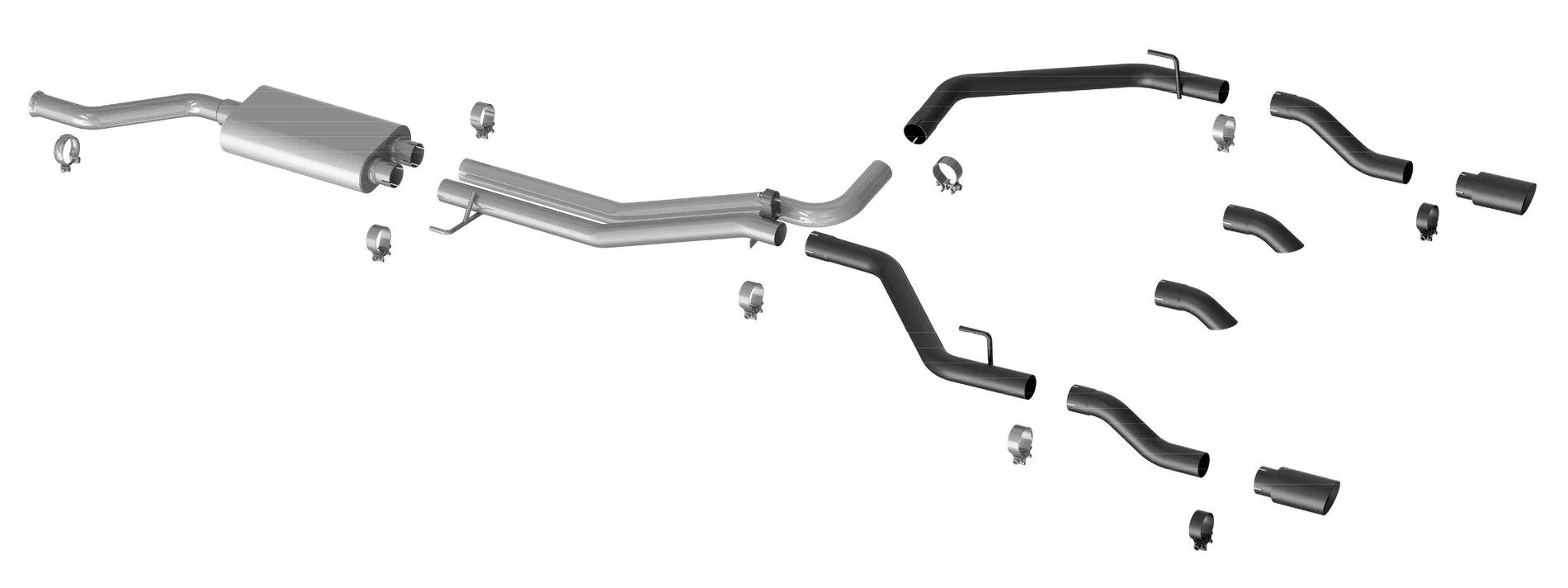

Jeep Gladiator ACE Performance Exhaust for Jeep Gladiator! ACEJTPESS-E_Rendering
Here's some updated info as well as a schematic of what comes in the kit.
System Design:
This Jeep system is designed with true dual tailpipes exiting the muffler. This provides for unique sound development by using the muffler to tune the exhaust flow. This is not possible in a single in and out muffler used in other systems. The dual tailpipes also help maintain a lower flow restriction which means less back pressure.
Muffler:
The muffler is manufactured using 304 SS and is an all-welded construction design for strength. It utilizes tuning chambers for sound control and is manufactured with large diameter interior tubes to minimize back pressure restrictions and to improve performance.
Pipes:
The pipes are also manufactured with 304 SS material for both longer life and strength. They are 2 ½ inch diameter and are all Mandrel Bend construction which maintains the interior diameter at it’s maximum in the bend area. This prevents reduced flow and increased back pressure.

Would the system be negatively affected in any way if you just attached the turndown tips at the end of the silver pipe, without taking it all the way to the back?

It has not been dyno'd in that configuration, but you should not see any decreases in performance. If anything, that configuration is less restrictive.

Most states require that the exhaust exits behind rear axle. Those with state inspections anyways.

This kit comes with both. So if you're concerned about emission laws, you have the tips for on-road. Then when it's time to wheel, those can be removed.
