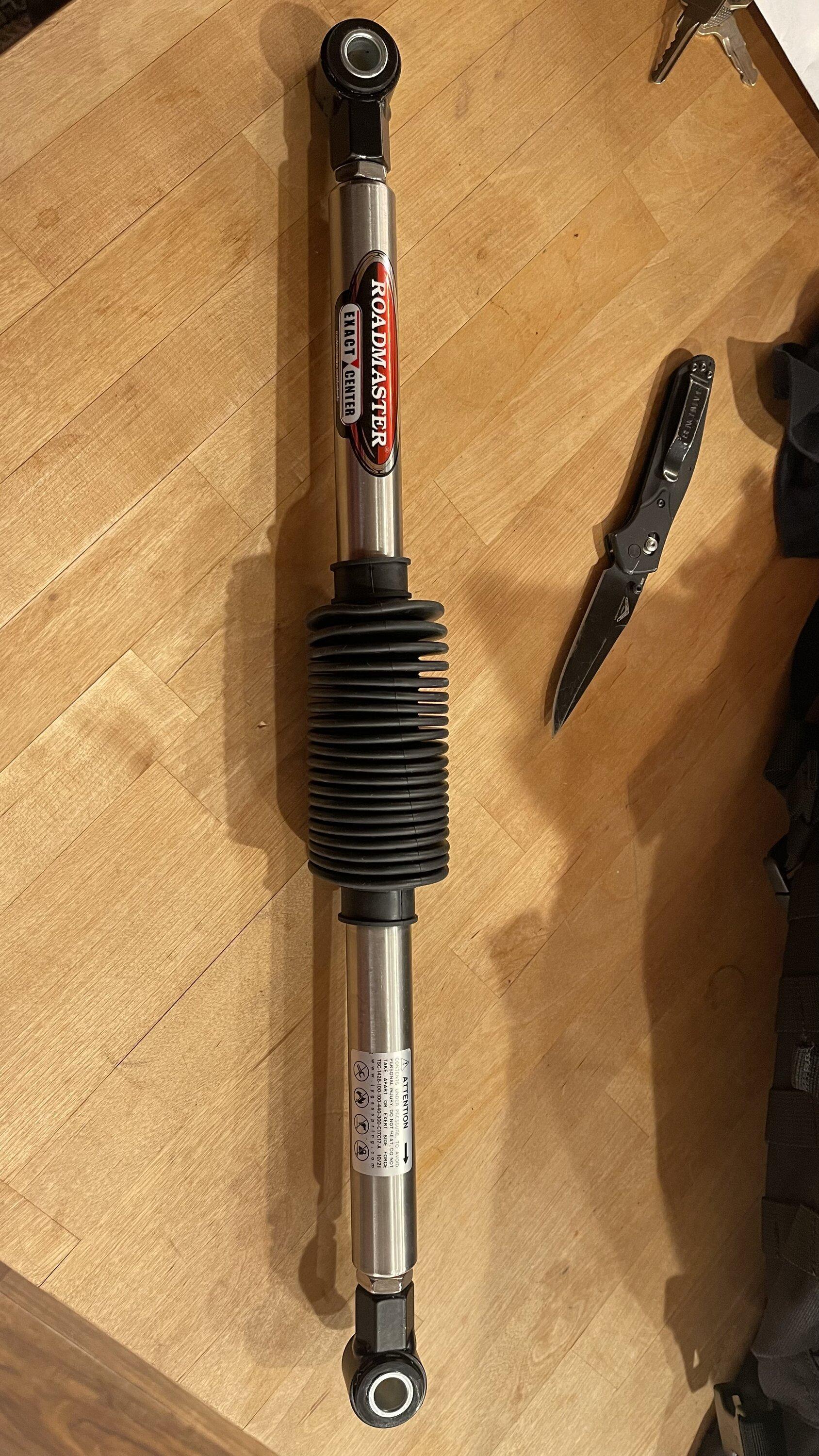

Jeep Gladiator Active Centering Stabalizer BB804615-437E-4316-AF51-1EEC14C32F79

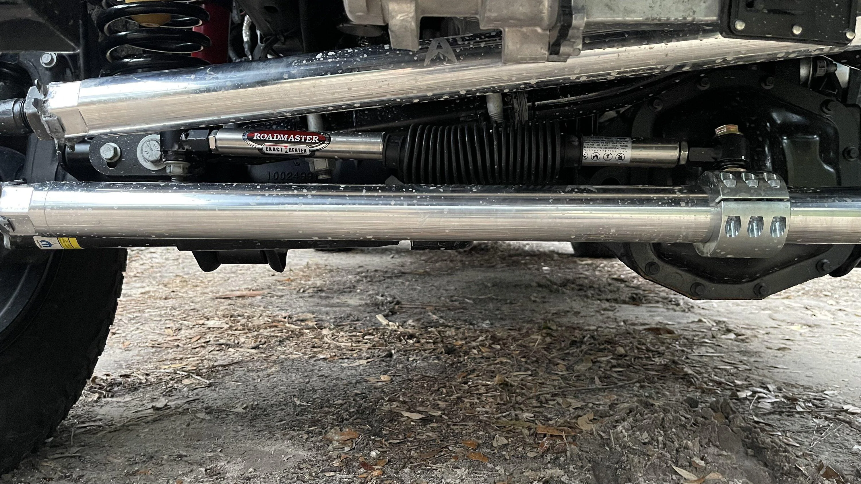

Jeep Gladiator Active Centering Stabalizer 79C3C45C-D0E8-47E1-ABCE-40488122CD24
I’m running the oem hydraulic stabilizer in its oem location and the exact center unit above it. Around the neighborhood it steers / tracks considerably better. I’m getting everything aligned tomorrow then il try it on the highway.
