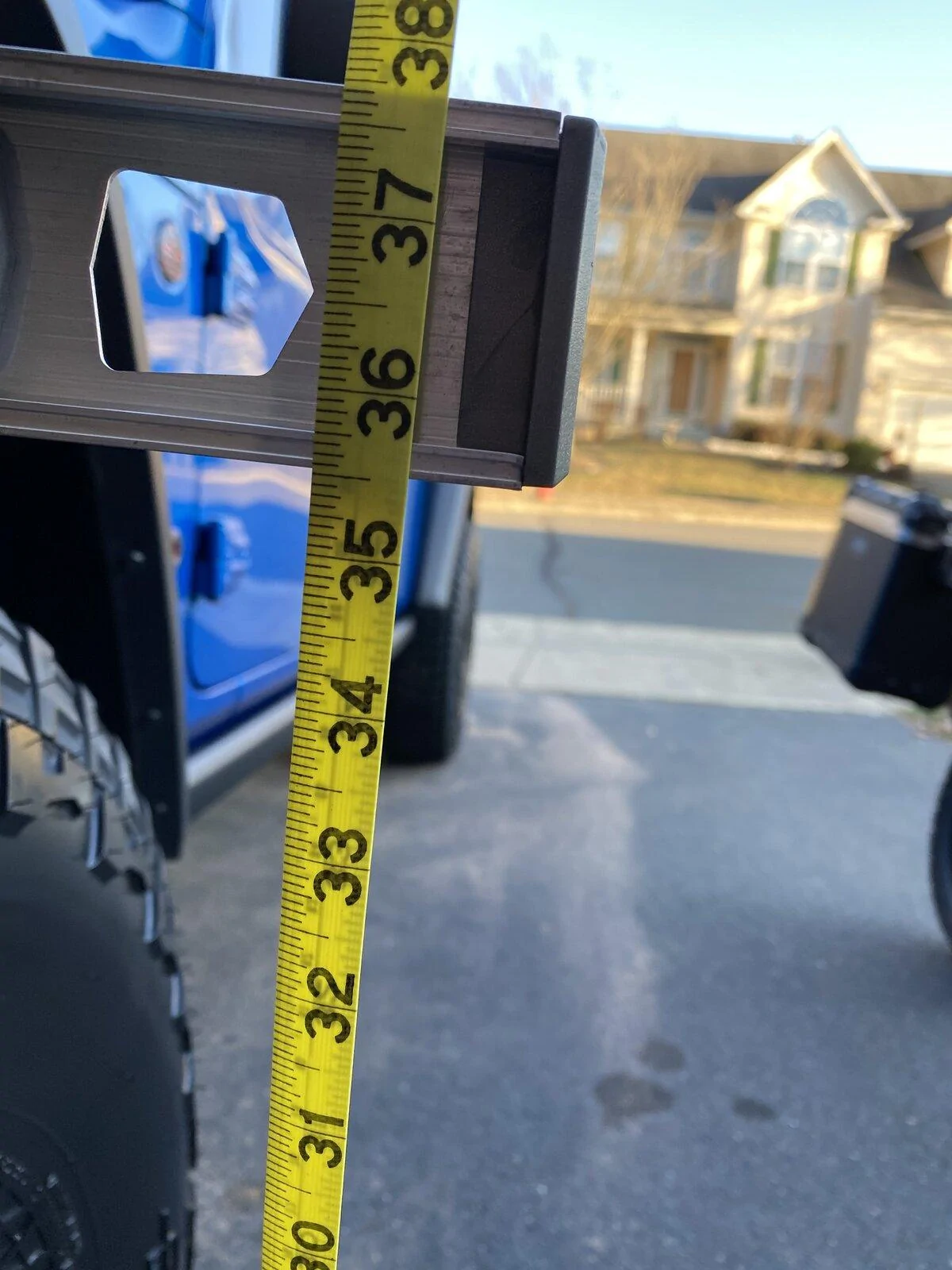

Falken 37x12.5r17 on 8.5” wide AEV wheels @45 psi Measured at 35.5“. My woman saw it “goodness. Its like guys trying to pick you up in bars. At least you delivered” hahaha
i wish someone would make a 40” tire that actually measures out to ~36-37”. That way i can put a “40“ on and boost my ‘gram following, talk shit to other people more easily, but not actually have the headache of 40” tires.
Jeep Gladiator Actual measurements of 37" tires mounted?? 9927E277-9020-4F40-9B5A-484ACB218AED
