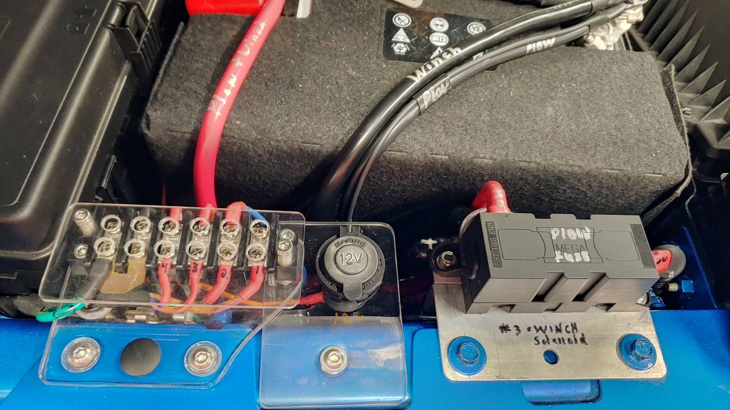

Odd - I've use my switches for the winch solenoid, my backup lights and for powering the 12 volt outlet and USB charging I installed in the bed - no issues.
Granted, that's not the same as lighting pulling who knows how many amps and so on, but still - there's about 3 amps or so for the winch cutoff solenoid coil. Not sure what the initial surge would be.
Theory talk -
The aux switches power things through RELAYS - meaning through a pair of contacts in a relay, not directly from anything. They shouldn't care a bit what's connected because a relay totally isolates the load from the switches and thus the BCM and any network.
