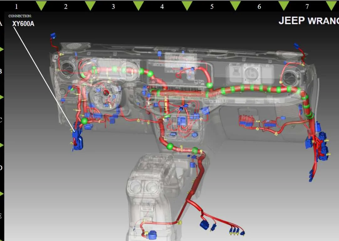

Is it possible to add power mirrors to a 2025 Gladiator that did not come with them? Sources?
We can get you the mirrors, harnesses and switch but you will need to check the body side wiring for the circuits that power them.
Looking at the body side door connector XY600A
Jeep Gladiator Adding power mirrors? 1772146381965-oq
We would be looking for all circuits related to the mirrors in the attachment
If they are present then we can test Pin #13 for voltage.
