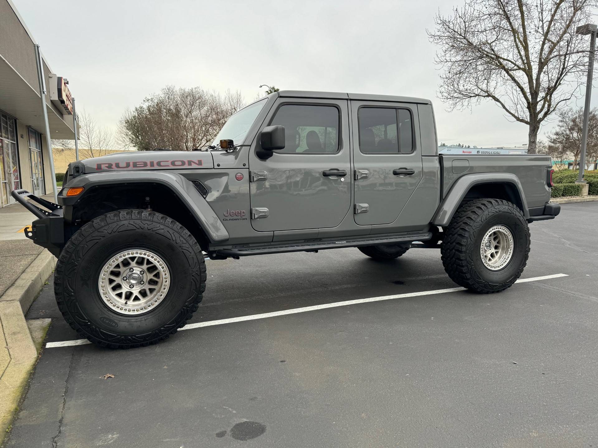

I like to like to go against everyone whos says 1-tons and tons of money.
3.5" lift (franken lift, a few different brands mixed together.)
40s on 17x9 with 3.5" bs wheels
Apex 2" Aluminum steering
Fox ATS
steering box brace.
Edit: and 5:13 gears
Fender chop and Motobilt high line inner fenders coming soon.
Drives amazing, and cruises down the highway with 1 finger at 75.
But it also sees minimal off-road, because I also have a rock buggy on 40s.
