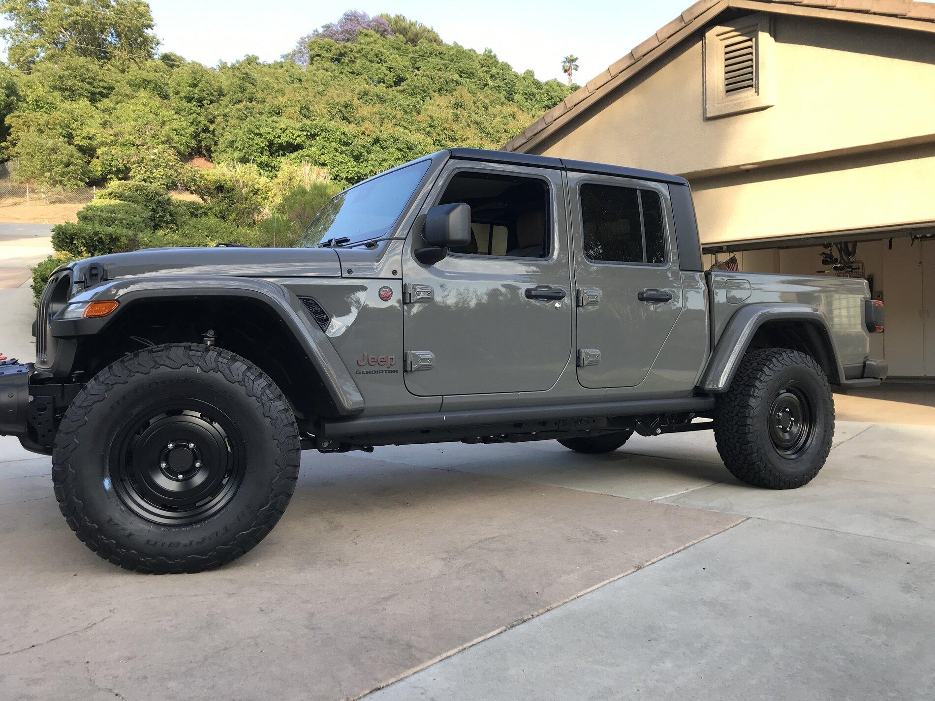

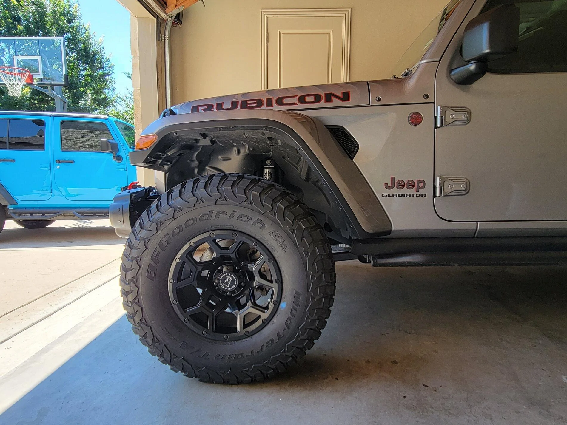

I have the the Mopar lift on my '20 JTR. I have 37x12.5x17 BFG KM3's. 17x9.5 Black Rhino rims have a -18mm offset. Here's a front view of how the tire sits:
Jeep Gladiator Advice on Wheel Selection 20210616_141206
Jeep Gladiator Advice on Wheel Selection 20210616_115925
My alignment has been spot on with the Mopar LCA's. You can always add a different LCA if you want/need to. I have the 3.6L with the auto trans, and I haven't had a single problem to suggest I needed to re-gear. I would think the diesel would be fine with your setup. Just depends on how you drive it, and your personal preference. Drive it for a while after the install. That should tell you if you need to re-gear or not.

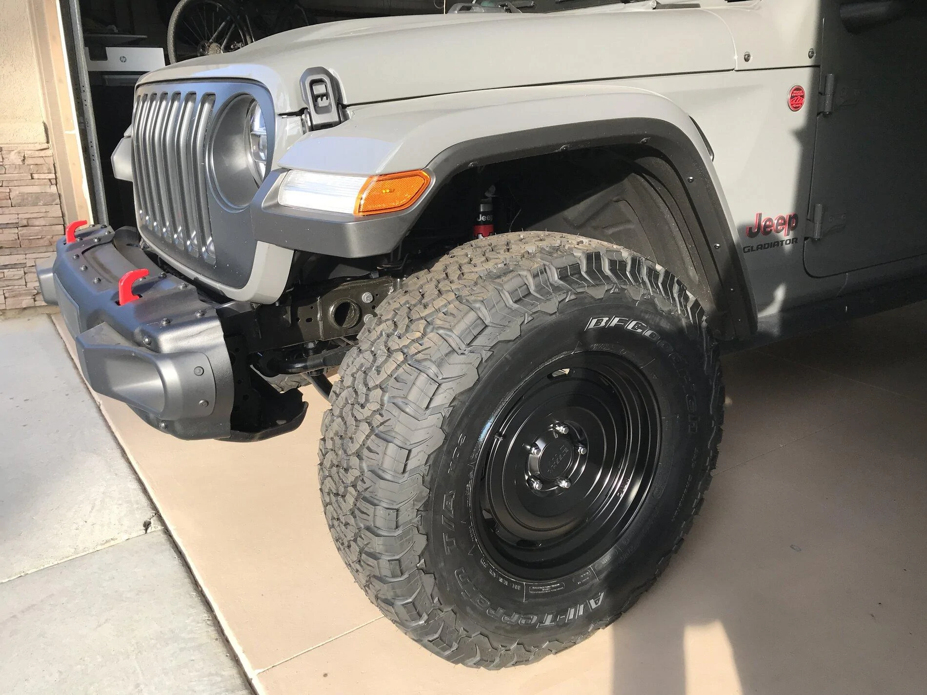

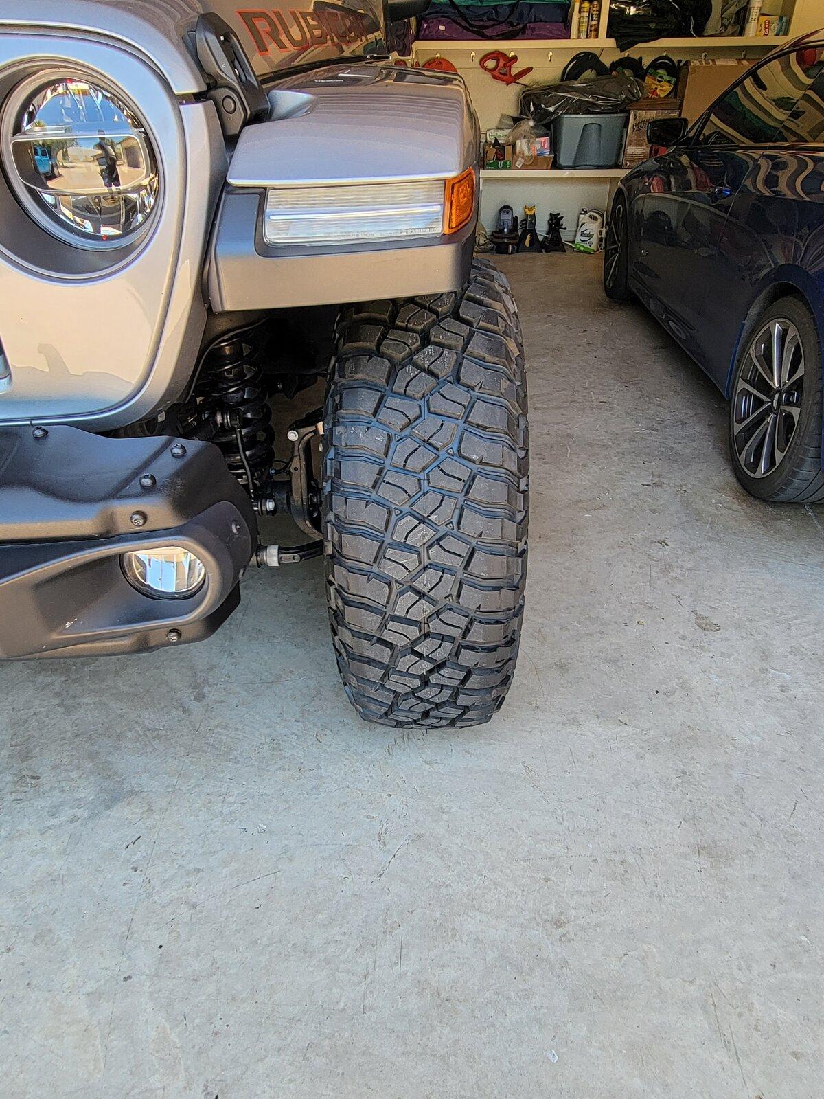

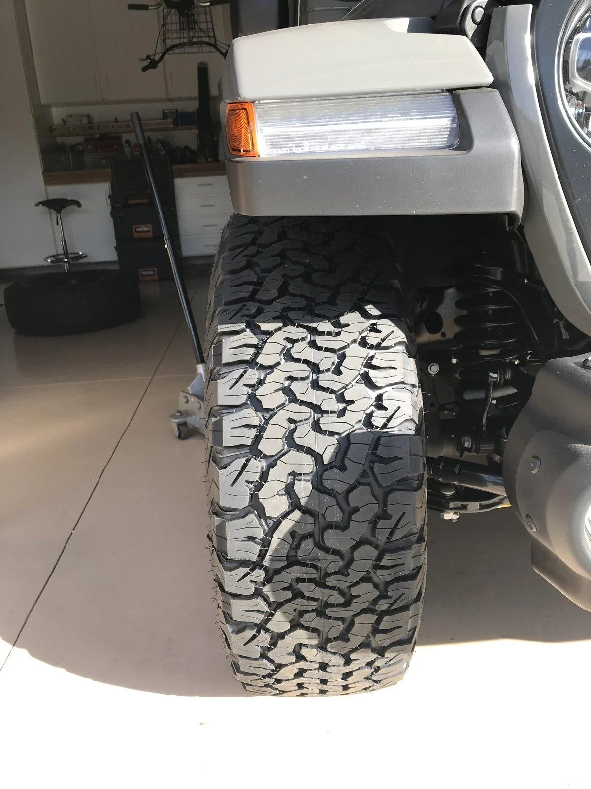

This is the rim you are looking at in a 315. I think you will be fine with 37s and a 2” lift.
This is exactly the picture I was looking for. Thank you that looks great!
