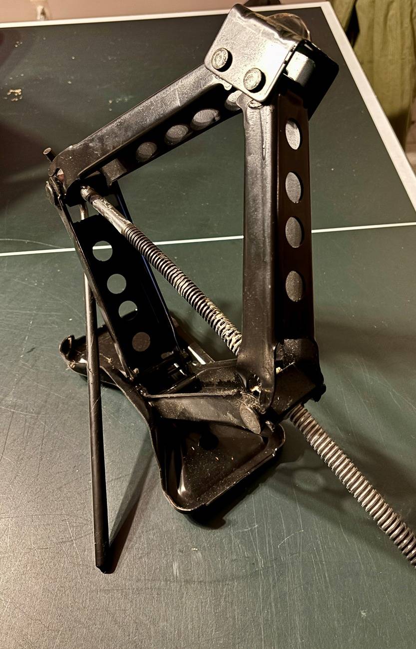

AEV Jack Base Slid Out From Under While Jacked

Thanks you I have seen that Jack and another one similar to it, but it takes up so much space and added weight. I was hoping to use the AEV. Is there no hope for it? I love that it just fits underneath the rear seat and the Jack as well.

The floor looks pretty smooth/slick. Prob wouldn’t take much of being off center for it to want to scoot under all that weight. But in general, the set up you have pictured gives me anxiety. Personally wouldn’t count on that in any situation. Factory jack is not great, and that base would be hard to keep perfectly level I’d think, but never used it myself.
You’re right. Only on a street maybe and level dirt I guess. I don’t know what’s lightweight compact that can be used. I’ve seen an off-road bottle jack.

The jack appears to be pressing on the end of the control arm. As you raise the vehicle this end of the control arm rotates, and wants to roll off of the top of the jack. Use the axle tubes instead.
Yeah, I feel so dumb lol I was thinking the curvature of the jack and the low point would be perfect right there for just a little raising. I didn’t think it through foolishly. First time ever that has happened to me over 40 years. I’ve never had anything fall off before thank God the tire was still on as I was waiting, and I would never go under it with that jack though.

Here is the approved lifting points.
This ^ never jack under a pivot. It's kind of an easy mistake to make if you're used to an independent suspension vehicle, the axle tube is much lower to the ground anyway.
You’re right this is my only solid axle vehicle. Most of my other cars are sports cars. I saw the curvature on the jack and I’m like hey let’s put it here lol but the axle was the right spot now I know.

I figured I made a mistake so that’s what caused the slipping?
Probably the rotation of that lower control arm, as the jeep went up, that arm went downward, spinning it in the top "cradle" of that jack, making the jack want to move away from the arm, or at least rotate it forward at the top, but the bottom is stuck in the AEV deal, so it just tilts.

Under an axle tube would be far better. However, scissor jacks make me nervous in all cases. When you're at home, you should really invest in a floor jack. Four wheels distributed on their long frame PLUS a typically 4+ inch, cupped plate that you could have used where you tried your scissor jack without danger. That said, you should still jack from the axle tube. there are a few other places that these jacks can be placed and used with great safety but let's just go with the axle tube and a floor jack. Parking brake set, or at least for the tires still on the ground, blocked to prevent any roll.
