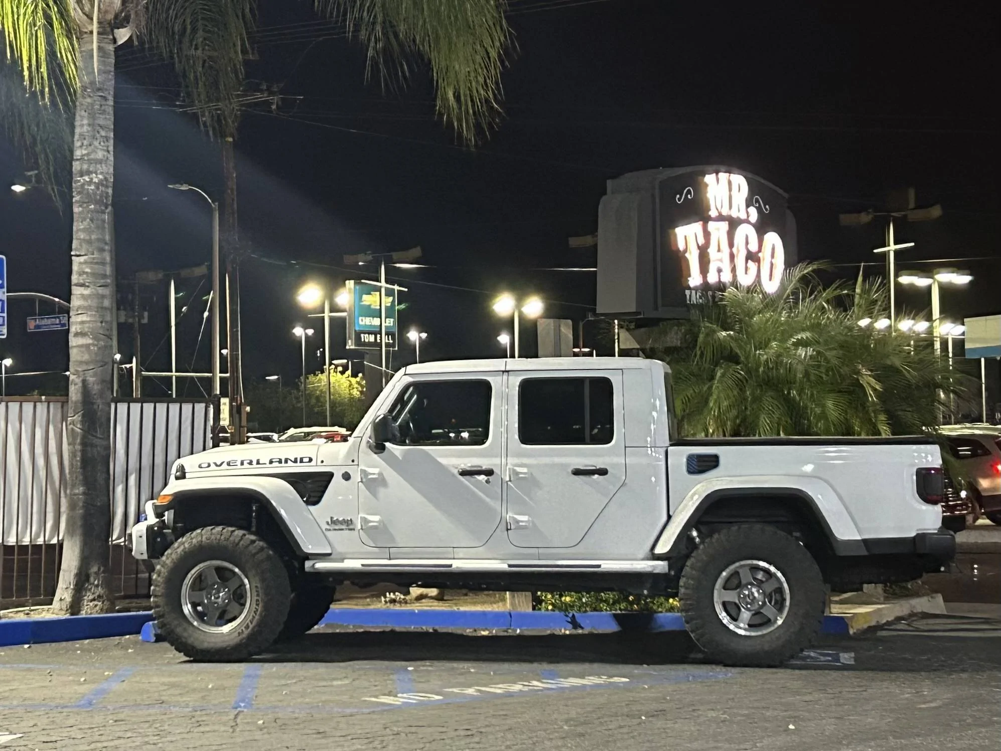

What is your end goal? What height do you intend to run? What tire size is ideal for you? Lots and lots of factors to consider. I did a lot of research before getting my lift and I used multiple companies to do so.
ReadyLift 4” lift kit for gas trucks
Falcon 2.1 shocks
Teraflex .5” front spacers
Rusty’s 4” diesel lift springs front
Clayton track bar rear
Stock upper control arms
ReadyLift non adjustable LCAs
Stock driveshafts
37” tires
The end result is a dead nuts level gladiator that rides stiffer than stock on road. 4.5” front and 3” rear. I have noticed that the faster I drive off road (to an extent of course), the smoother it feels. I wouldn’t trade it for the world.
