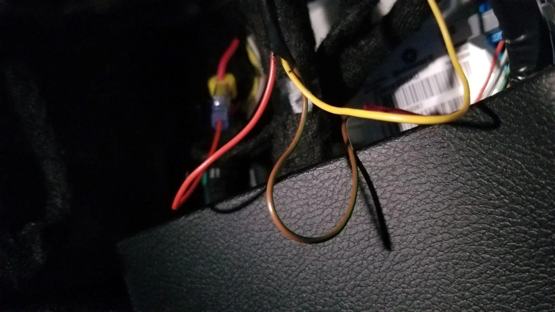

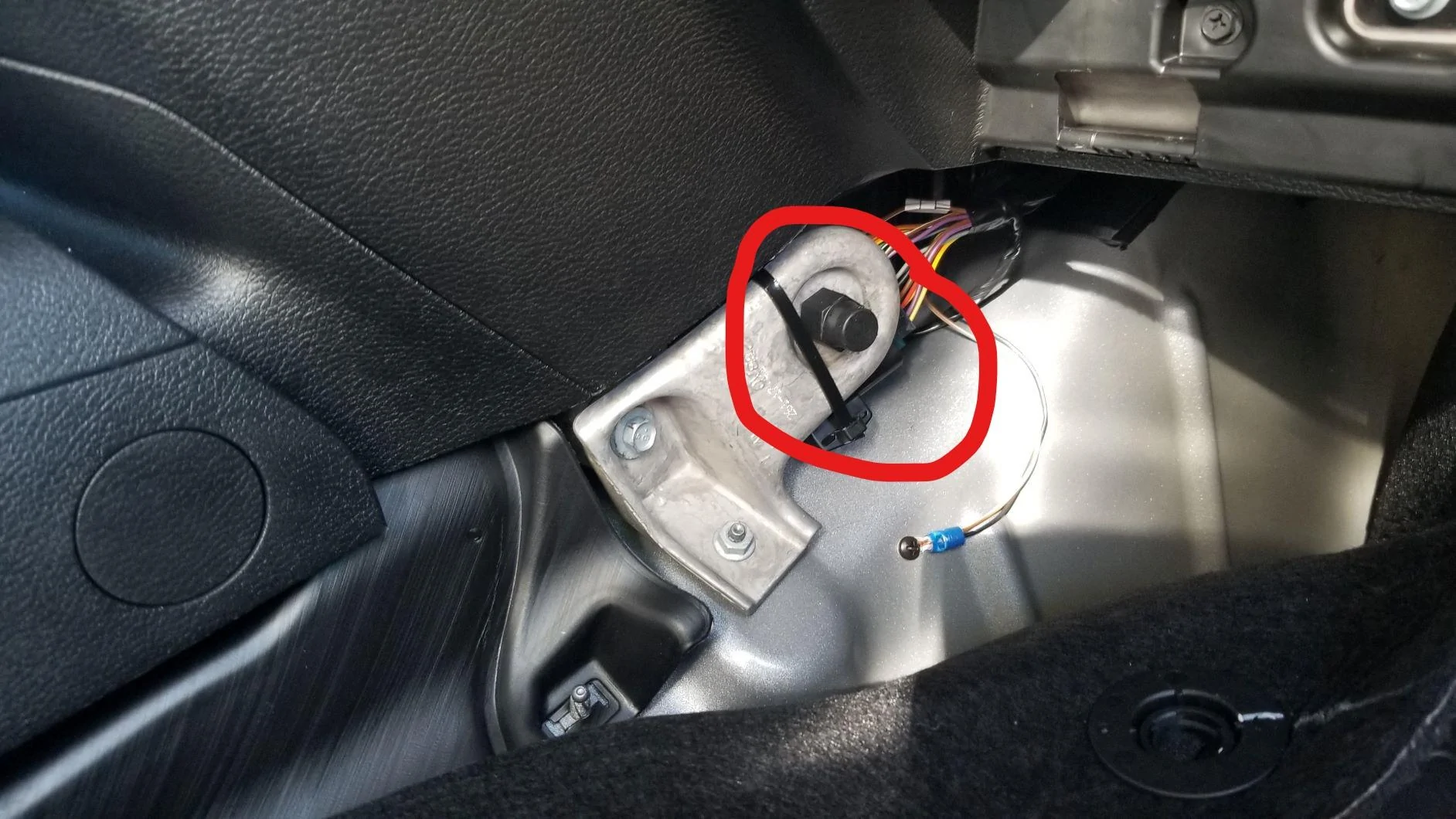

I read somewhere to check/adjust the alarm sensitivity. I looked for the alarm module and how it was connected. Starting from the blinking LED on the driver side knee panel, I traced the wires. The wires led to a “black box” zip tied to the frame of the center console (on passenger side), and some wires were tapped into a harness behind the kick panel on the passenger side. As I was taking the kick panel off, I kept hearing the alarm box clicking - like a relay switching on and off. I kept wiggling panels and wires to see what was triggering the alarm.
Alas, it was the alarm system wire taps! One of the two wires didn’t make full contact. Any slight movement caused the alarm to trigger. Also, I would get a door ajar (passenger side) light on the dash (when doors were completely shut).
Looking back, I occasionally got a door ajar light and chime going off randomly (while driving). I used to pull over and closed the passenger side doors - grumbling that the wife and kids didn’t close the door all the way on previous rides.
The loose wire taps explains why it would go off at night (thermal expansion/contraction) and busy street (vibration). The quick fix was to pinch the tap to make a more secure connection. I know these aren’t the most reliable types of taps, but it seems to be perfectly fine now. I haven’t researched to see if the alarm is tapped into a door switch, dome light, etc.

Here is where the alarm module was located:
Jeep Gladiator Alarm Issues Solved... [alarm keeps going off at night] Inked20200922_151230_LI
Not great picture, but the wire taps from alarm module to trucks wiring:
Red (alarm) to red (truck), yellow (alarm) to brown/green (truck)

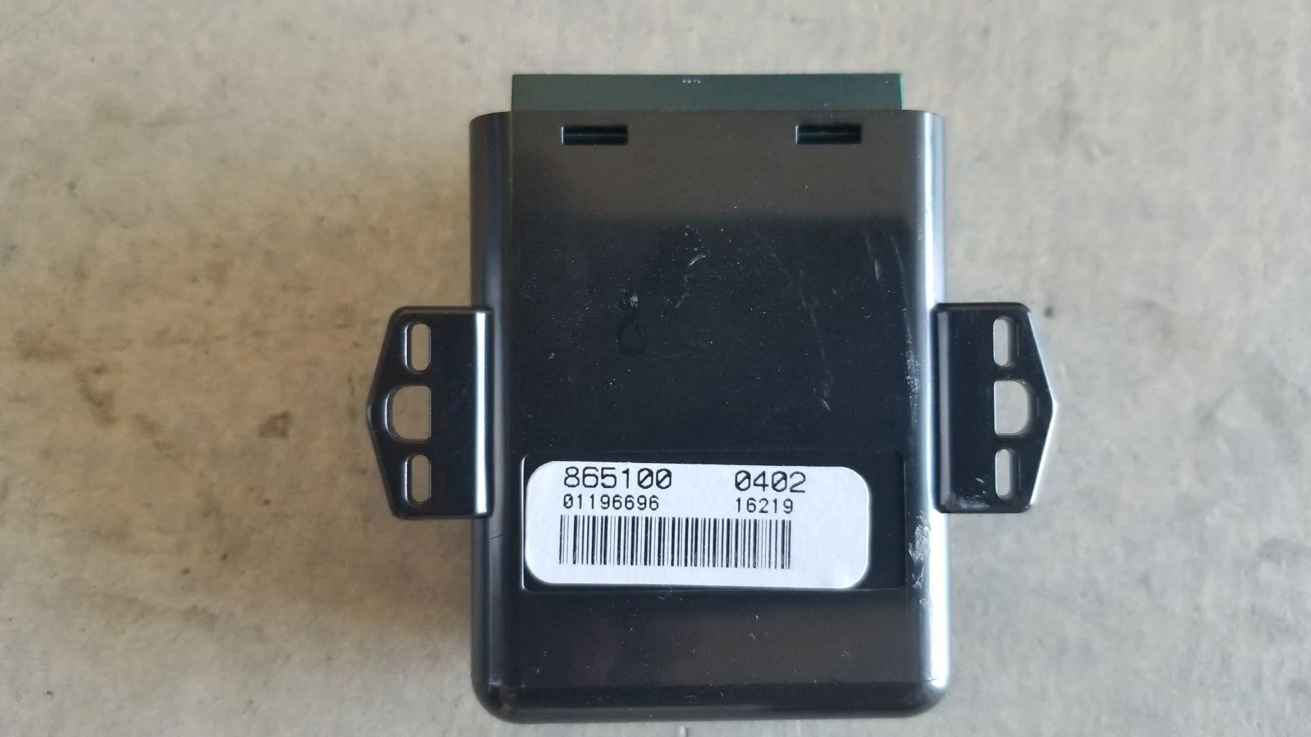

I'm not sure exactly what the little black box is, but I don't have the tracking service. The sales paperwork just has it listed as "KARR ALARM 2". This is what it looks like:
Jeep Gladiator Alarm Issues Solved... [alarm keeps going off at night] 20200922_152113
I think it is the brain. There's a harness with wires that tap into several other wires in the truck.
That's big enough to be an alarm. Maybe your model didn't include the factory alarm. My KARR device is about a fourth of that size.
It's about the size of a pager. Despite looking for it on Google, I can't tell what model it is. I'll ask the dealer when I get around to it.
