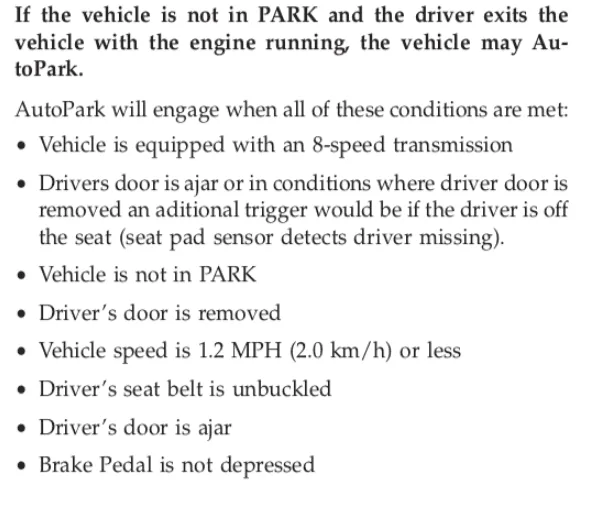

So there is a condition where the doors are off and the system is expecting to see pressure in the drivers seat, probably even when the seat belt is latched. So say you lift your butt off the seat because your grabbing your phone out of your pocket, you have your seat belt on doors are off. I'd bet it will put you into autopark.
I don't think auto park engages over 10 mph.

LOL, I was too in "freak out mode" when this happened to me. I think a combination of not having the driver door closed all the way and no seatbelt on was my culprit.
When i read your post it sounded like a lot of drive to reverse and neutral, but i think to turn off autopark, you have to put it into park, then can get it back to drive or reverse.

if I recall, my issue was because the car thought the door was open and my seatbelt wasn't connected.
If you have issues again, plug the seatbelt in, does it go away? Or open then re-shut door harder.
