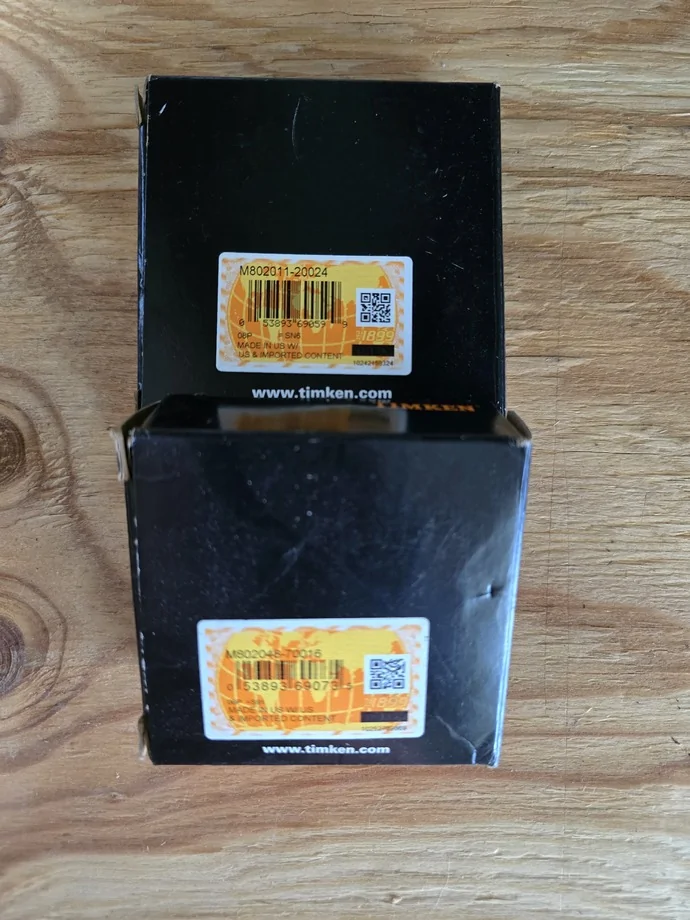

Have it properly diagnosed and checked by a shop because they will most likely start with the small things first.. It could be anything from your pinion like @VA6489 stated to the transmission like @Maximus Gladius stated. BLUF: Get it looked at by someone whose dealt with that issue before.
The whine on mine started out small and got louder over time. Turns out it was the pinion bearing which is an issue because of the design. I'll attach the video. Keep in mind that it didn't start out that loud.

Can you send me the link for the upgrade bearing kit .
