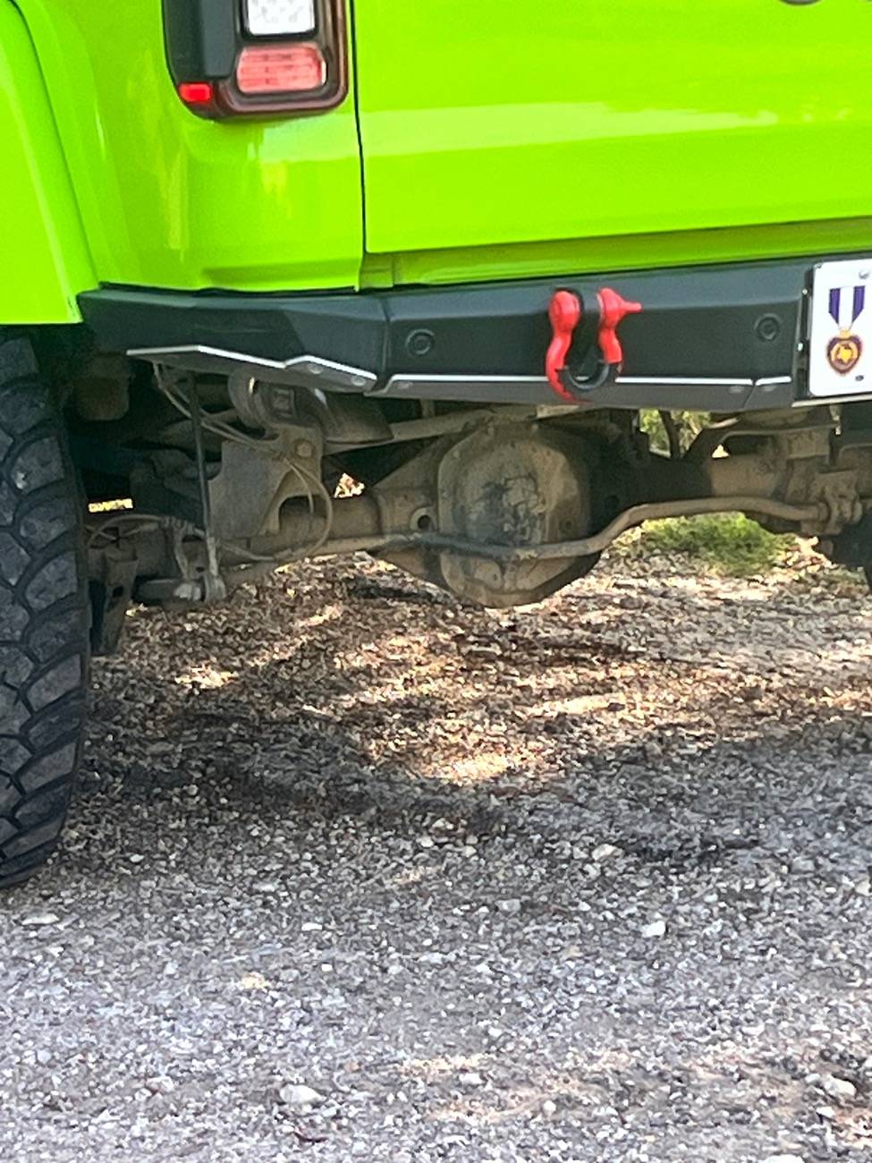

Ok so does mopar have a part number for the rear sensor replacement? I’ve got the bypass z auto plug in but the factory plug still leaks by.

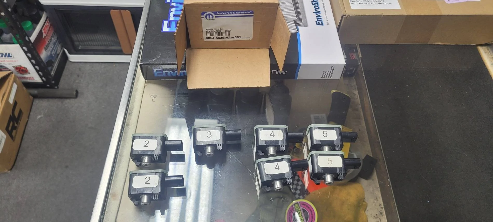

The repair kit comes with 5 sensors. You start by installing #1 and test...if no joy, install #2, repeat till the light is off. My 01/21 build required the #3 sensor.......Another 2018 JL I did last year required 2 #1's.

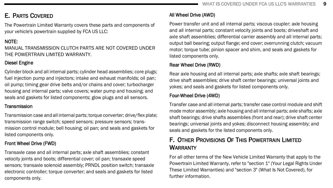

question is this problem part of the drive train or 3 year warranty

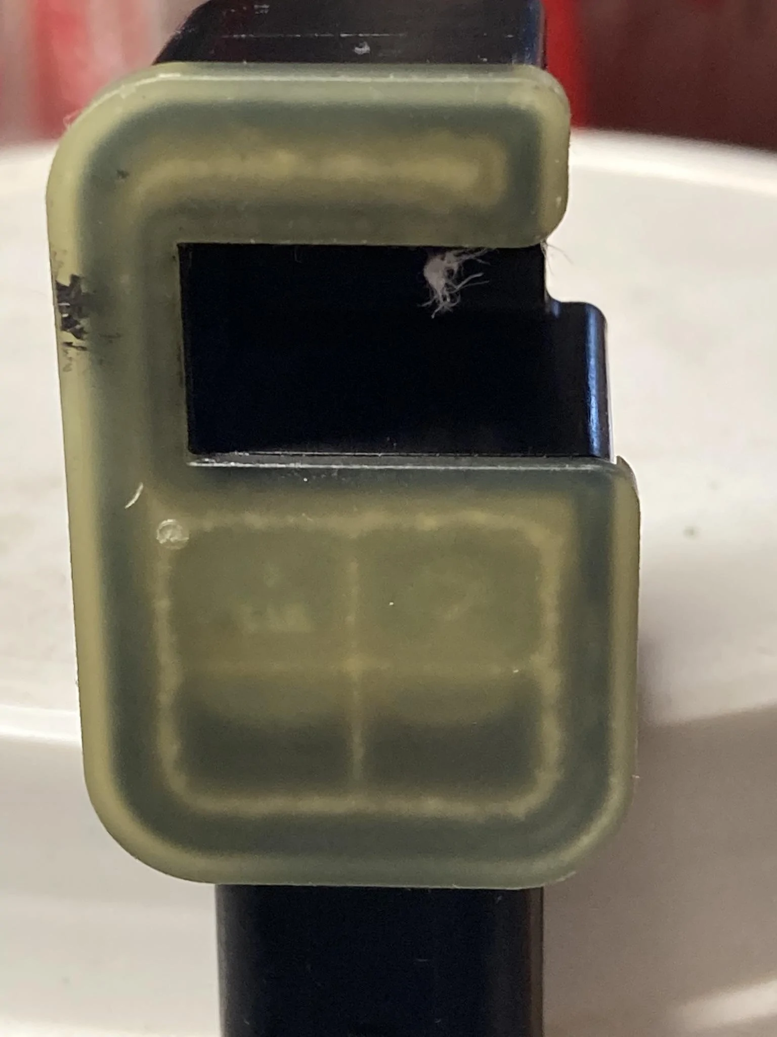

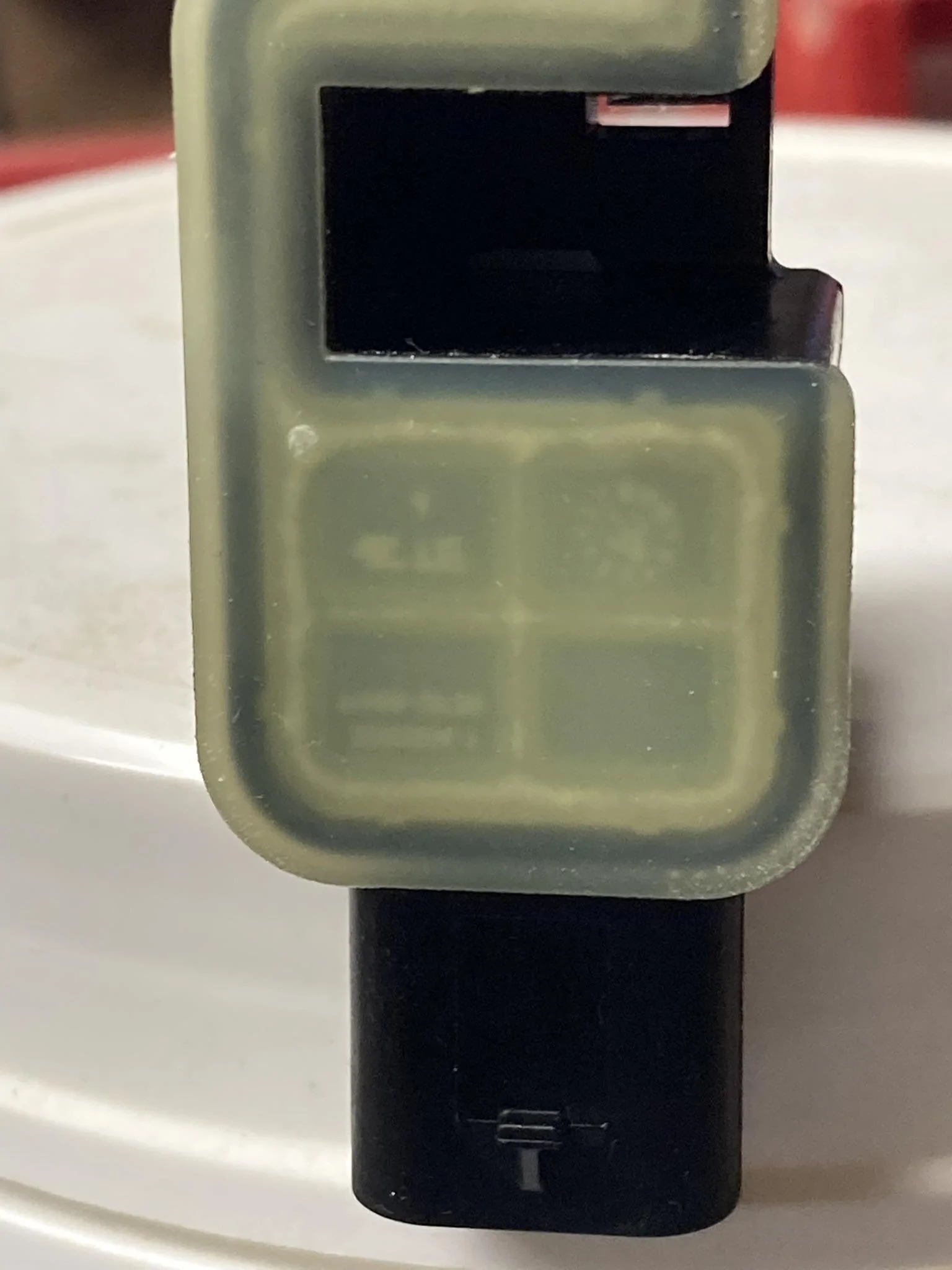

It’s just the sensor. It’s not actually locked. The sensors fill with gear oil and fail. You can either replace the sensor, and the next one will have it happen eventually as well unless you pot the sensor, meaning fill it with potting compound to prevent it from having a cavity for oil to get in.
Or the easy way is this, which bypasses the bad sensor. Back to full function in 10 seconds.
