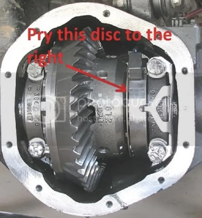

I purchased the z-locker bypass harness and still had that dreadful flashing light on. Then on my way home tonight 2 weeks after that harness. Now the rear locker is blinking. I’m going to take streets only as it’s my daily, but I did order the actuator I have found in some of these forum threads. If not I hate to go to the dealer to get riddled more bad news.
Here is the actuator I ordered.
