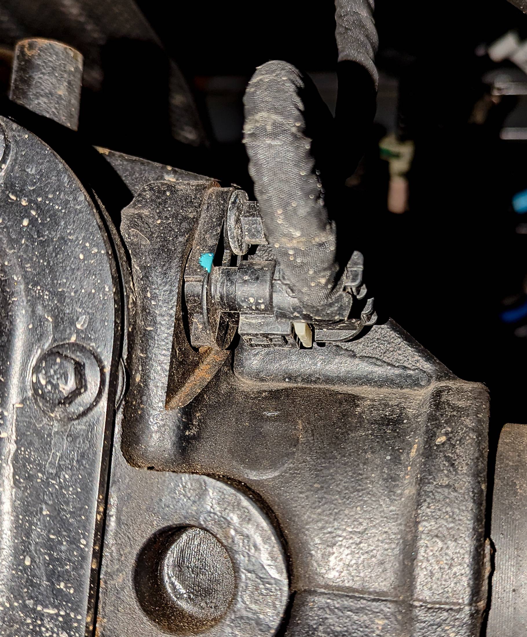

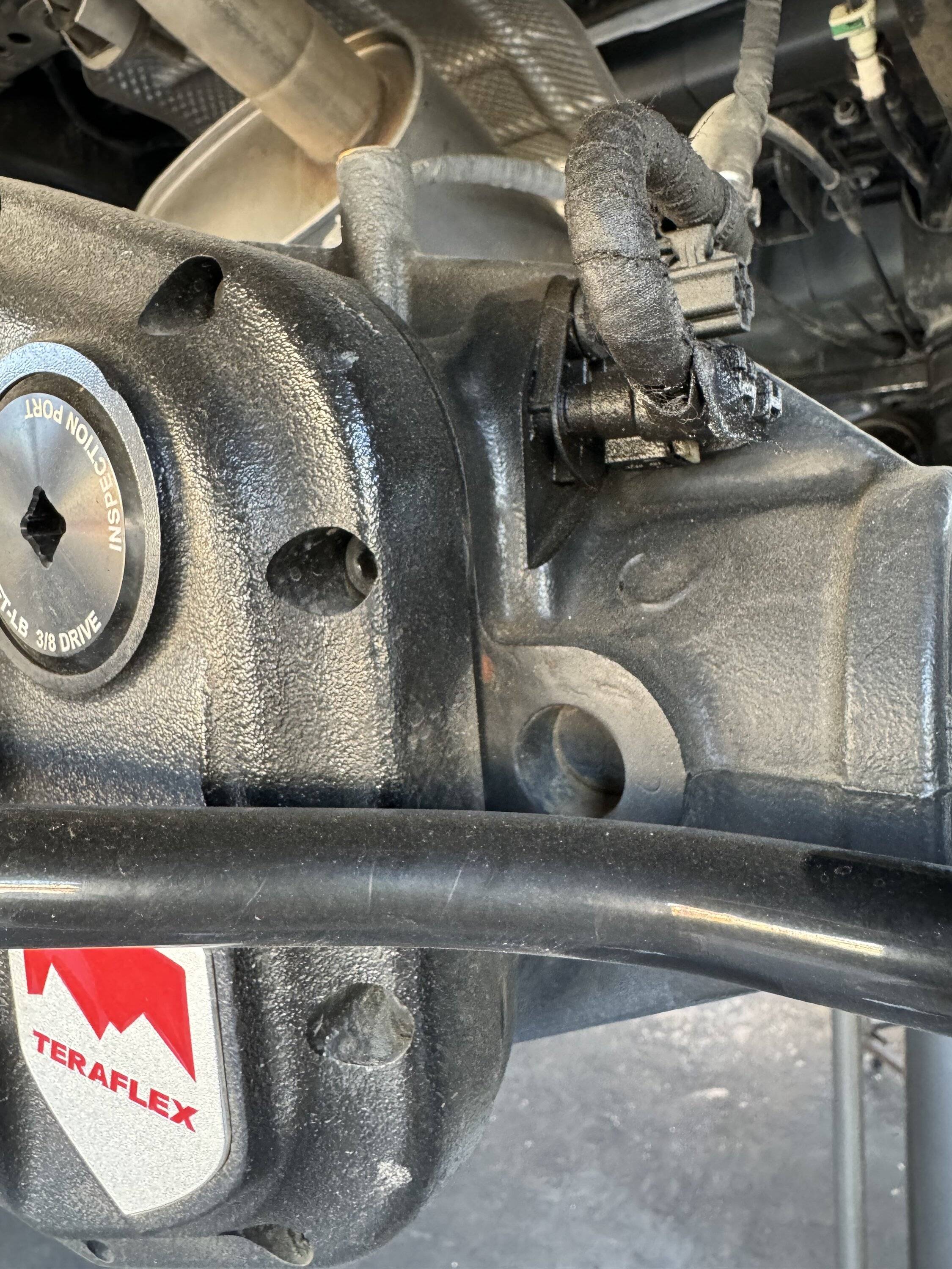

So I was servicing my 2022 gladiator Mojave and I noticed there is some oil leak from what I believe to be the electronic diff locker connector.
Any ideas what might cause this? Will this affect it if I don’t fix it right away?
Also worth mentioning a couple months back I installed a teraflex diff cover and used the OEM gasket, but the cover itself doesn’t seem to be leaking any oil.

The flatter design of that cover may be splashing more fluid towards the locker sensor than the stock unit. This may be a concern given the sensors seem to be prone to oil intrusion which can cause them to fail.
Something else that comes to mind is to ask how much fluid you put in the axle. Did you use the inspection port shown in the picture as the fluid level reference, possibly leading to an over full condition?

I run the same Teraflex covers and they do not recommend running the stock gaskets like you are using and call for RTV only.
I tried to use the factory gaskets also and had mist staining and eventual drips until I just went RTV as they recommend.

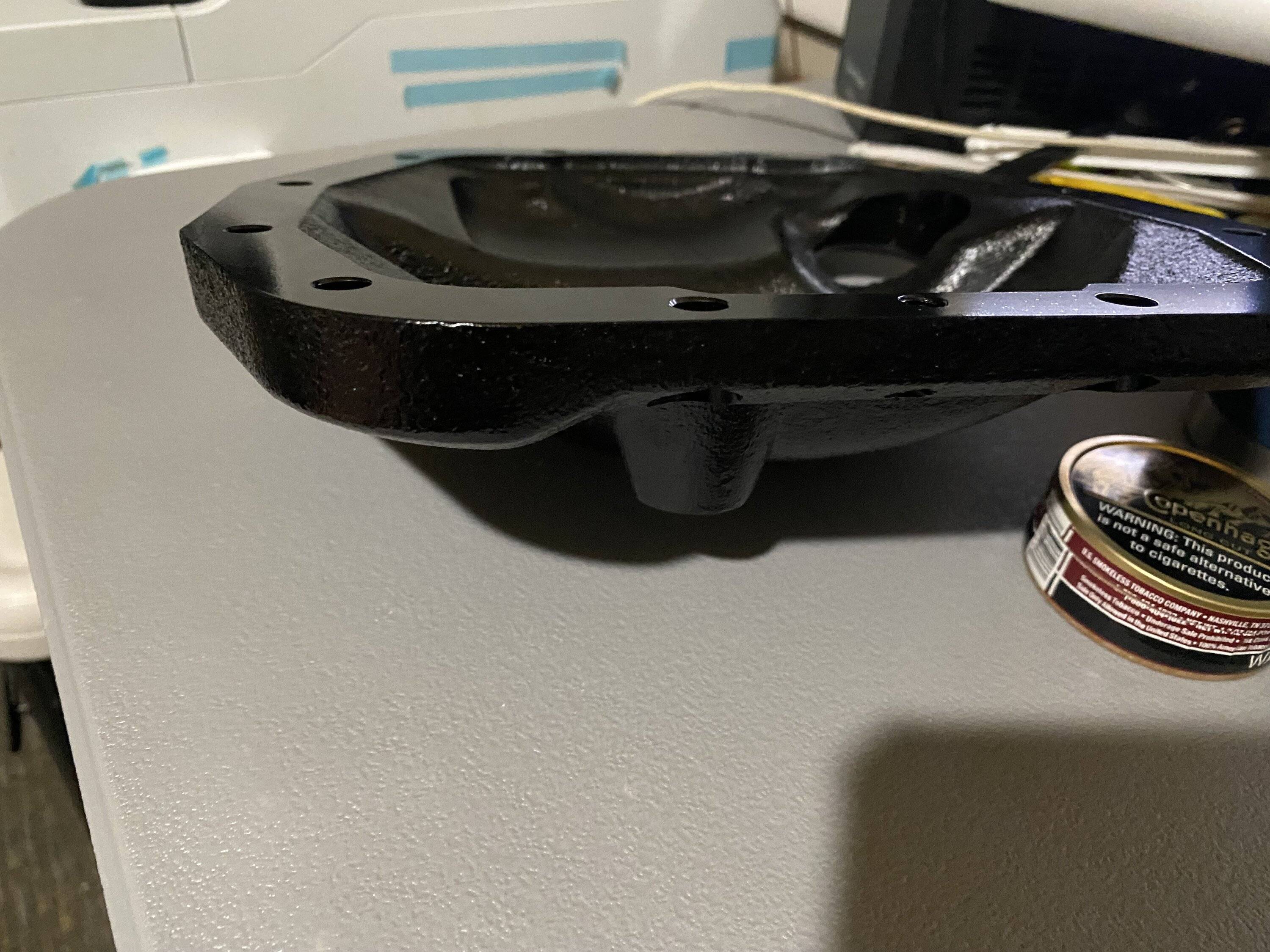

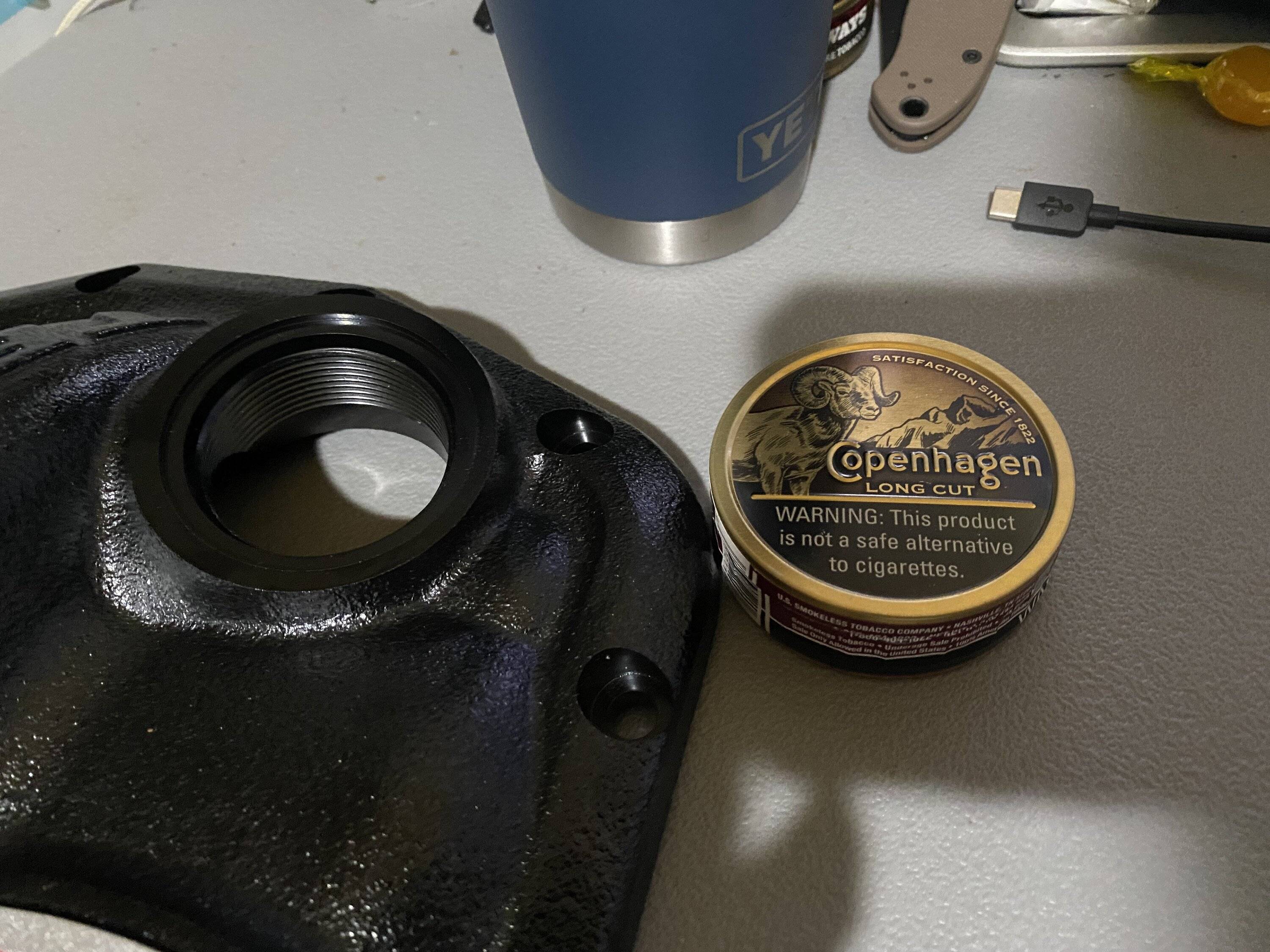

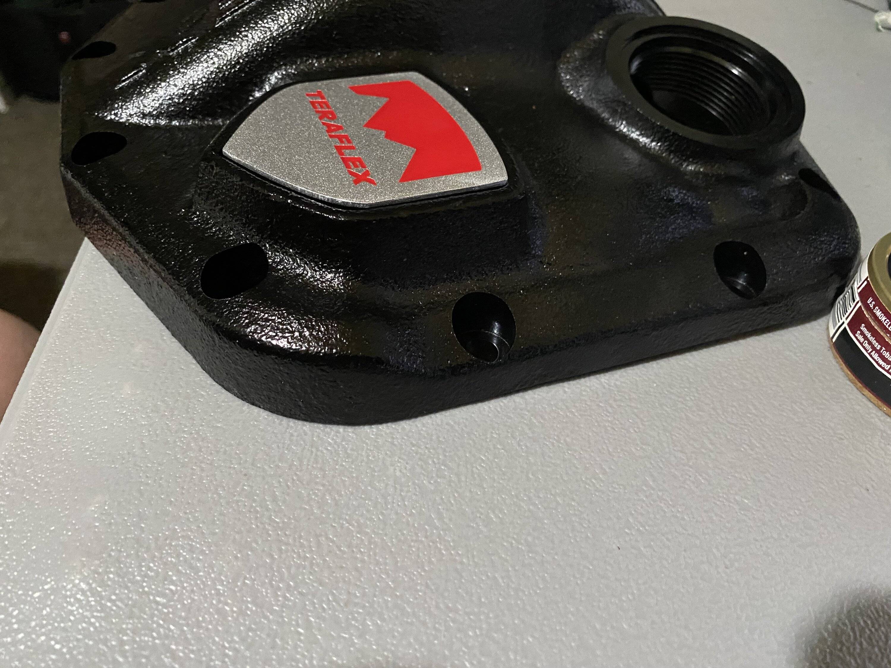

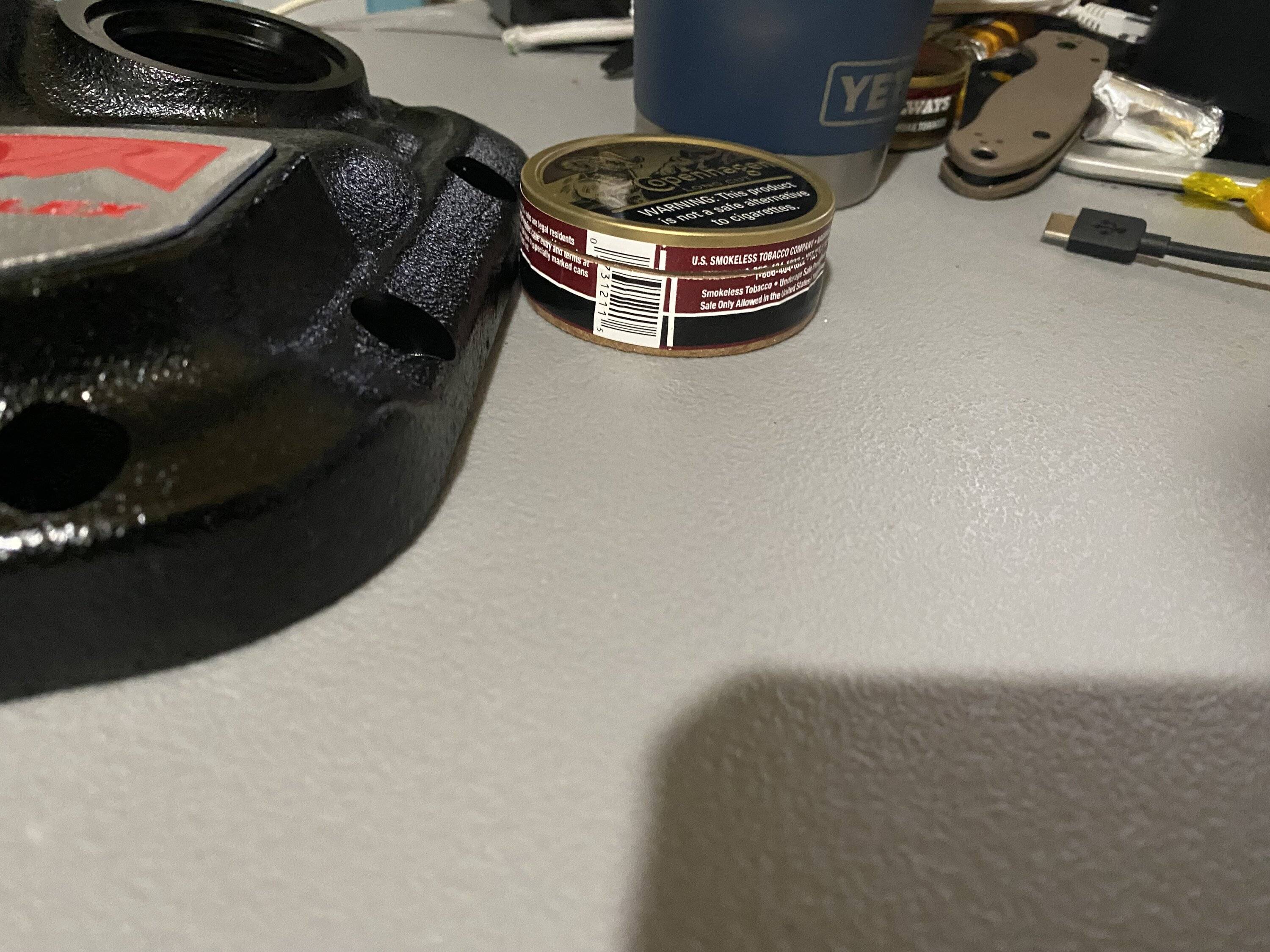

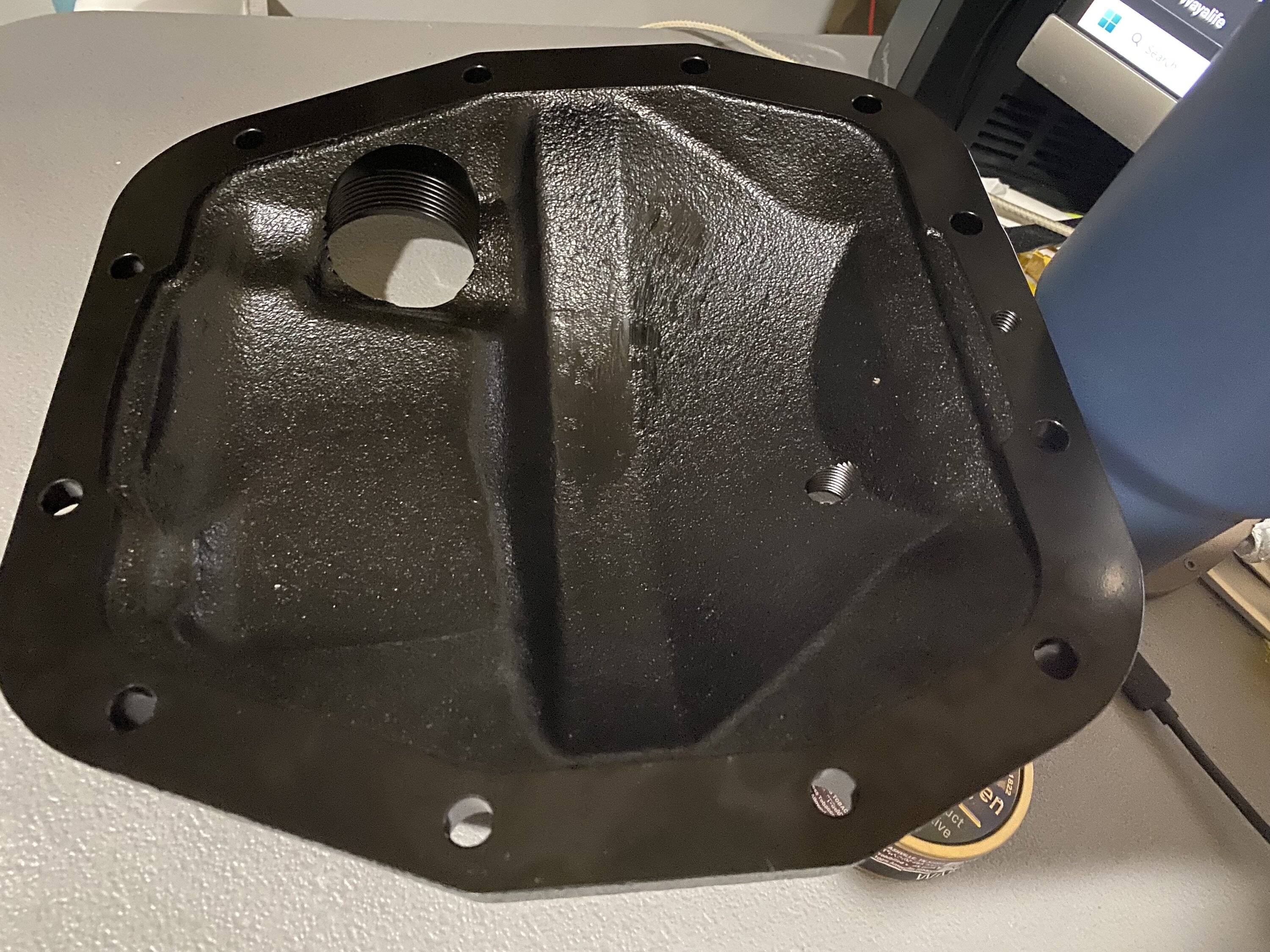

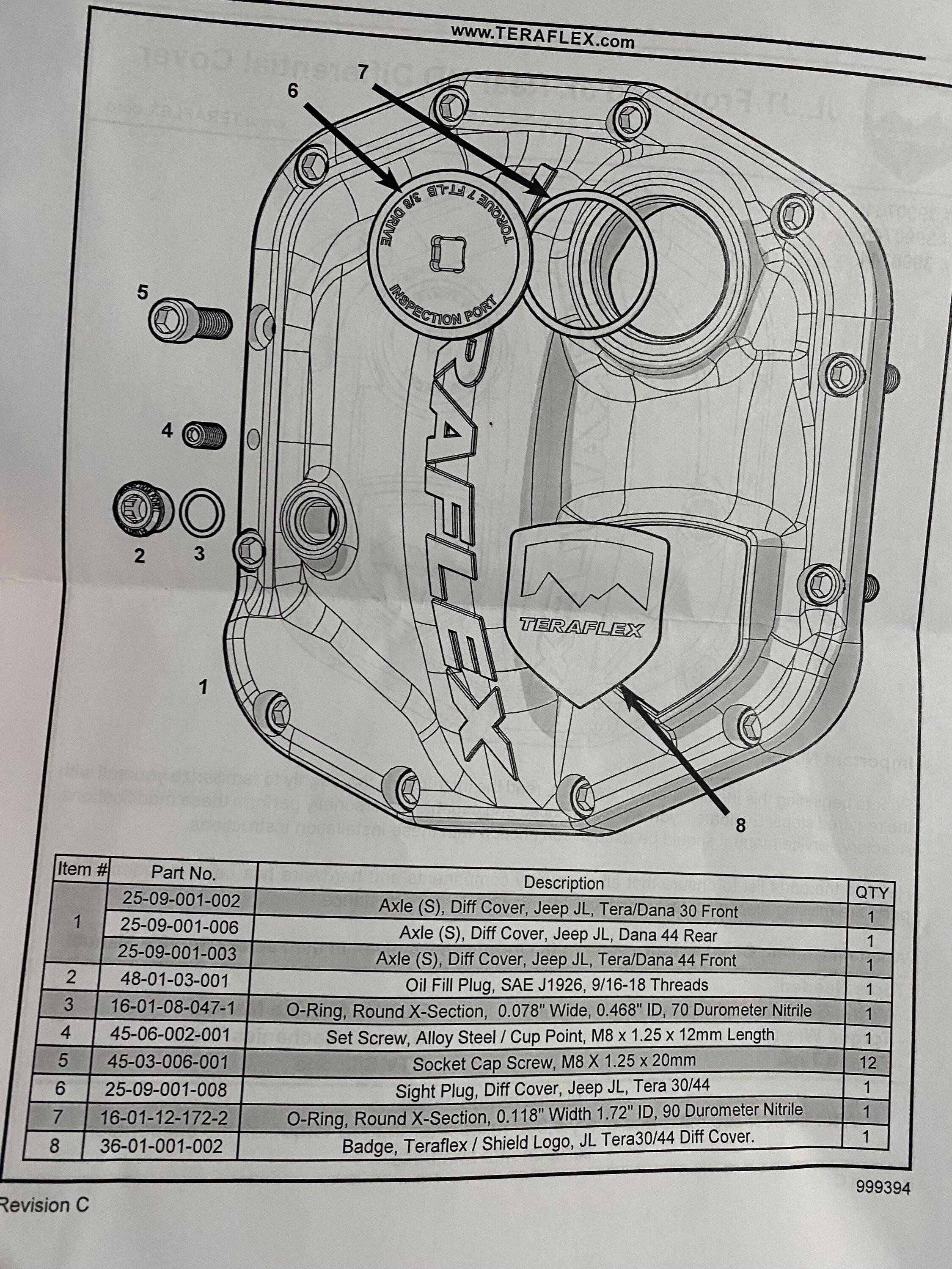

Well, front and rear covers were delivered this afternoon and a buddy of mine scored some Amsoil Severe Gear 75w-90 for me, so later this morning I'll go to his shop and do the install.
Initial observations:
DAMN! I only opened the front Teraflex cover and I must say, if I hit something that comes close to damaging this thing the axle housing will pretzel.
Previous posts commented on snapping cover bolts. This unit (#3990744 - JL / JT Tera 44 Front M210 (AdvanTec) HD Differential Cover Kit) comes with cap head bolts. The new instructions states the torque spec for the attachment bolds is 20ft-lbs.

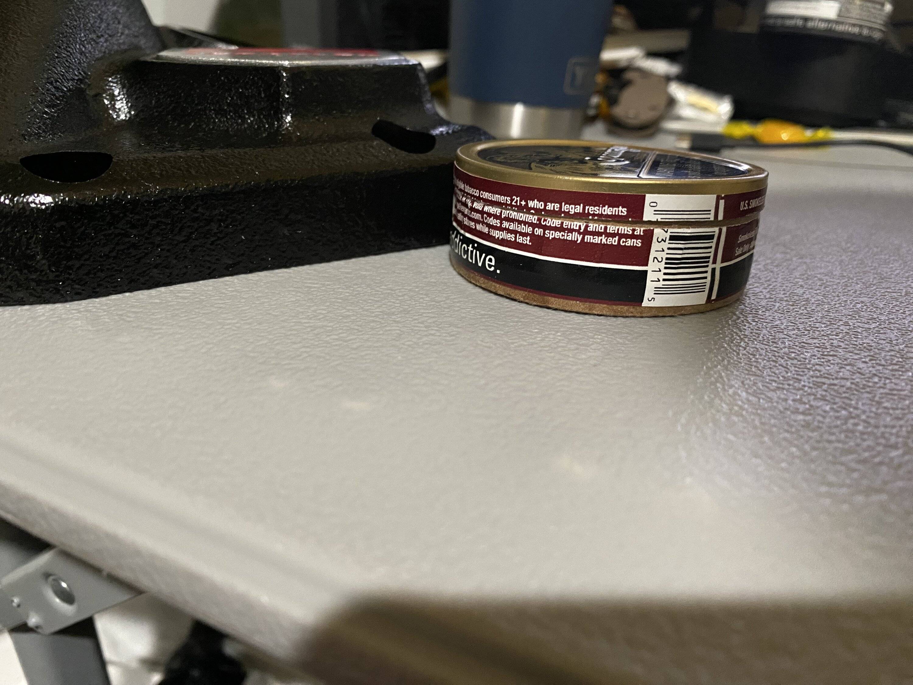

Parton the Snuff can reference, but below are some quick snapshots of the size of this puppy. The bottom lip is molded in such a fashion that there are no concerns of pealing it back when grinding over rocks.
The instructions seem to be very straight forward with one exception. The last photo shows a parts list and #4 is a set screw, which installs in the left center hole of the cover. Other than this, it's not explained...why or how. It's possible that there is a hole cast in the axle surface, but I won't now until I strip her down.
Maybe so when it's time to take off the cover, you can tighten the screw to force it to separate from the diff.
That is exactly what it is for. Works well also.

Below are links to the proper spec replacement o-rings for the inspection cover and oil fill level plug if you are wanting spares.
https://www.amazon.com/gp/product/B01FYYNL3O
https://www.amazon.com/gp/product/B01FYYGXIE
I would also suggest getting a couple cheap long (like 3"+) M8x1.25 threaded bolts from the hardware store and cut the heads off to make some alignment dowels for when you go to install it. Heavy as they are, juggling them one handed with RTV to try and get in place and to start a couple of cap screws to hold it is a bit of a pain if you do not want to smear your RTV everywhere.
