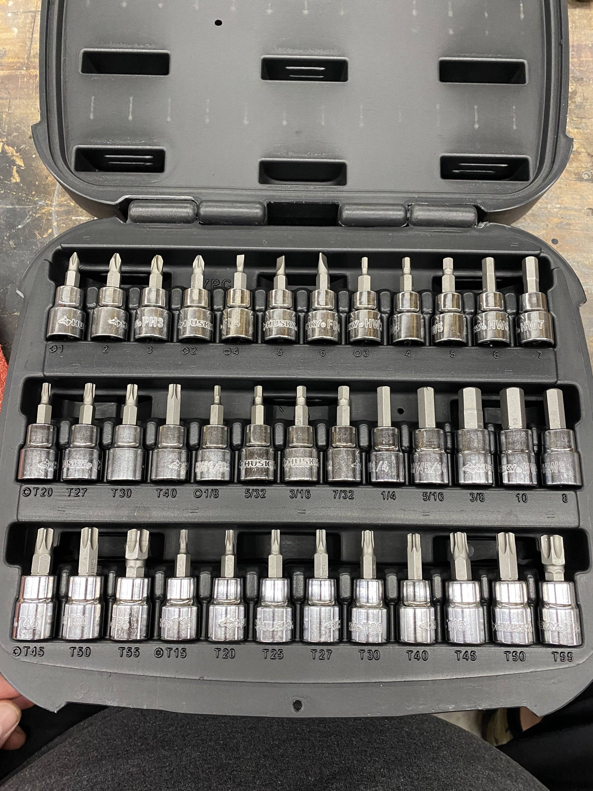

Last night I found out that I had SAE socketed hex heads. Yep, my metric sockets are in the tool chest that are off having fun with my buddy. Off to The Depot I went…Thanksgiving eve lucked out and they were still open @ 6:30pm. I took the opportunity to add to my road tools and I should be covered now. They were out of metric mini rail sets, but had individual sockets ay almost 4 dollars a piece. While not much in and of itself, my I saw this little set with 37 bits. My brain went to calculating, and this kit seemed like a bargain at 44-45 bucks instead of $144 plus the case, which will fit in my box quite nicely.

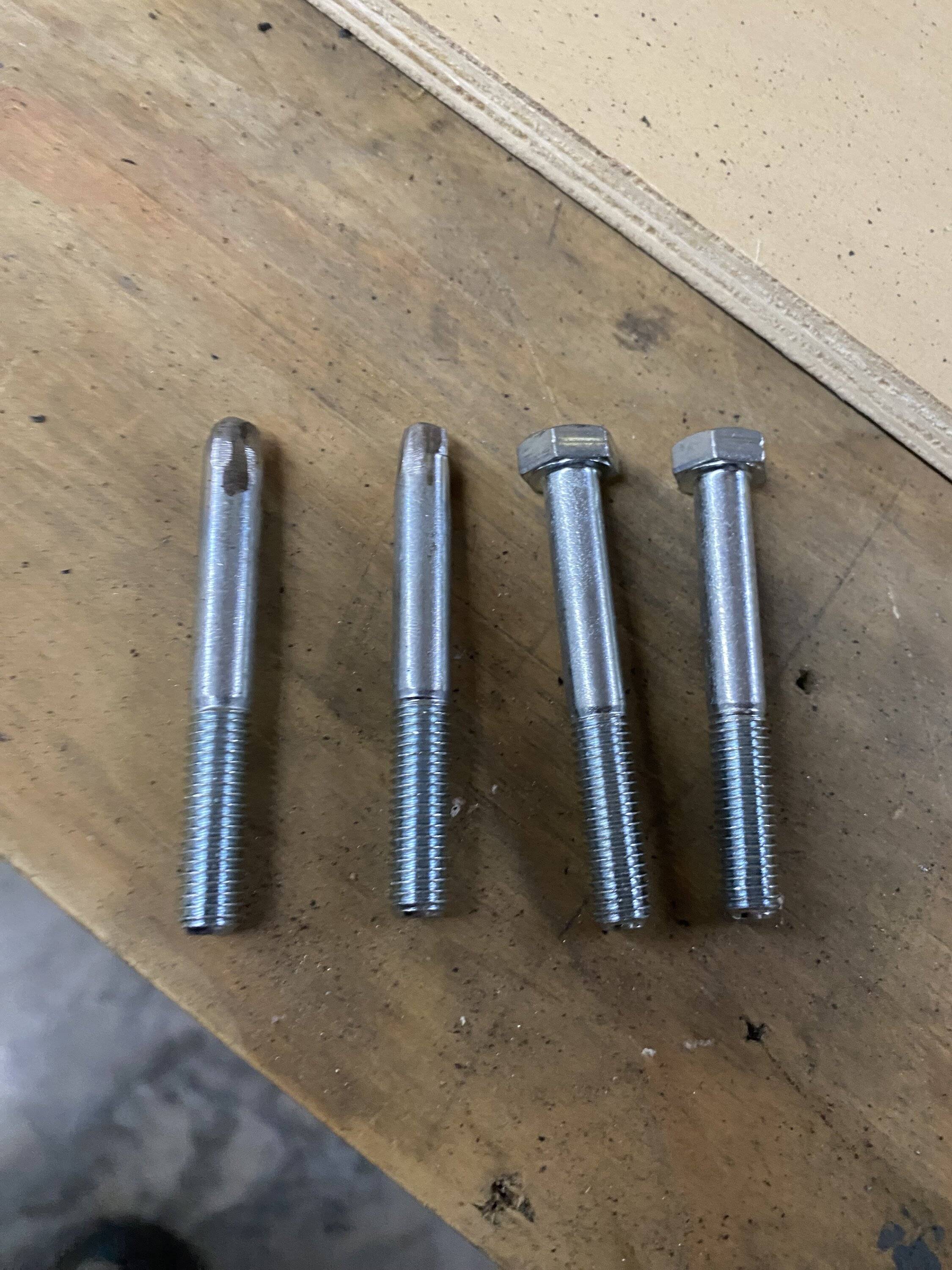

Not letting the inconvenience totally waste the time, I took the bolts @Hootbro recommended and ground down their heads. While they aren’t 3” long, they are 60mm, which were the longest Lowe’s had. I crawled under the rig and think they’ll be fine to use as alignment dowels.
