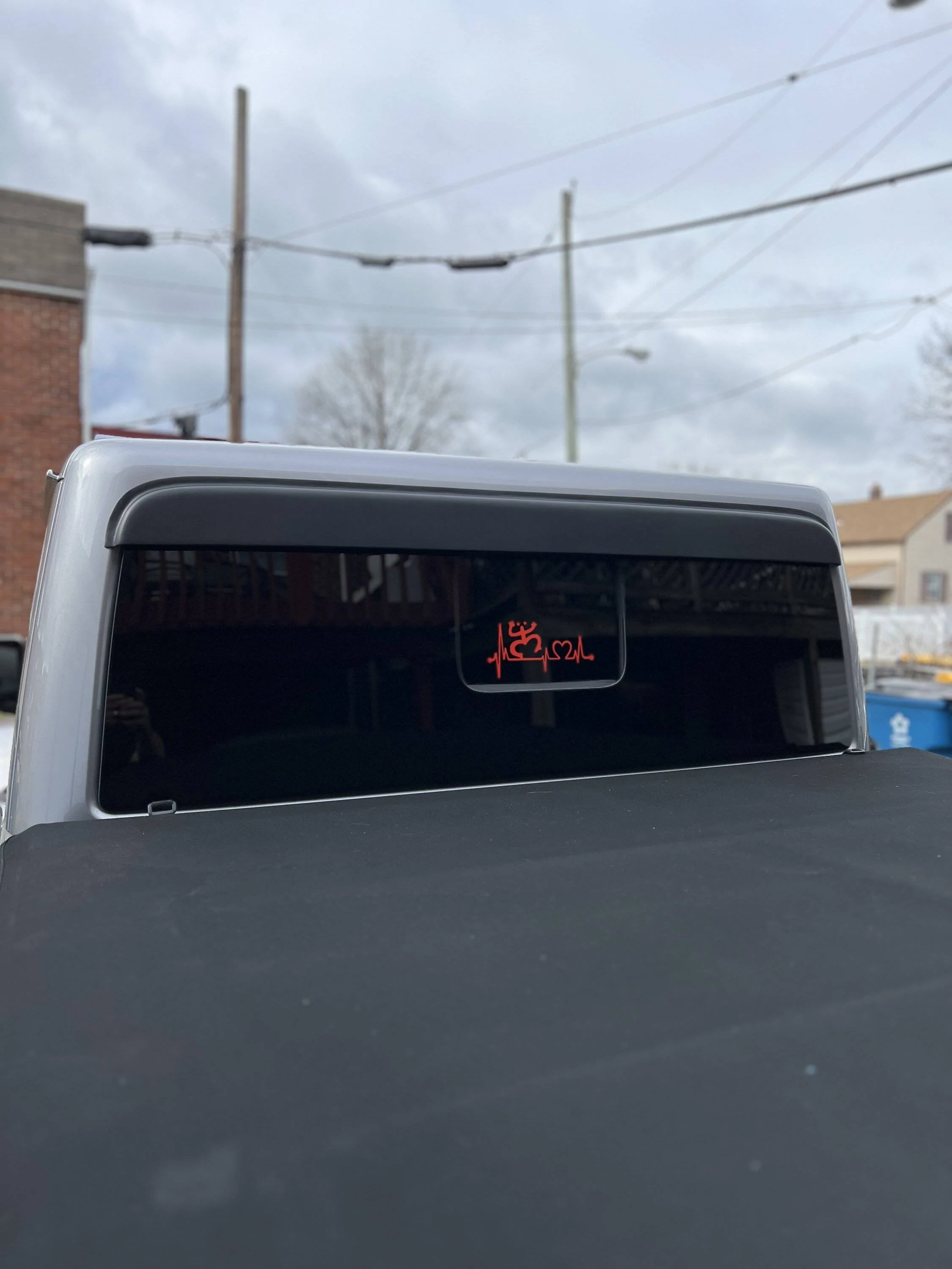

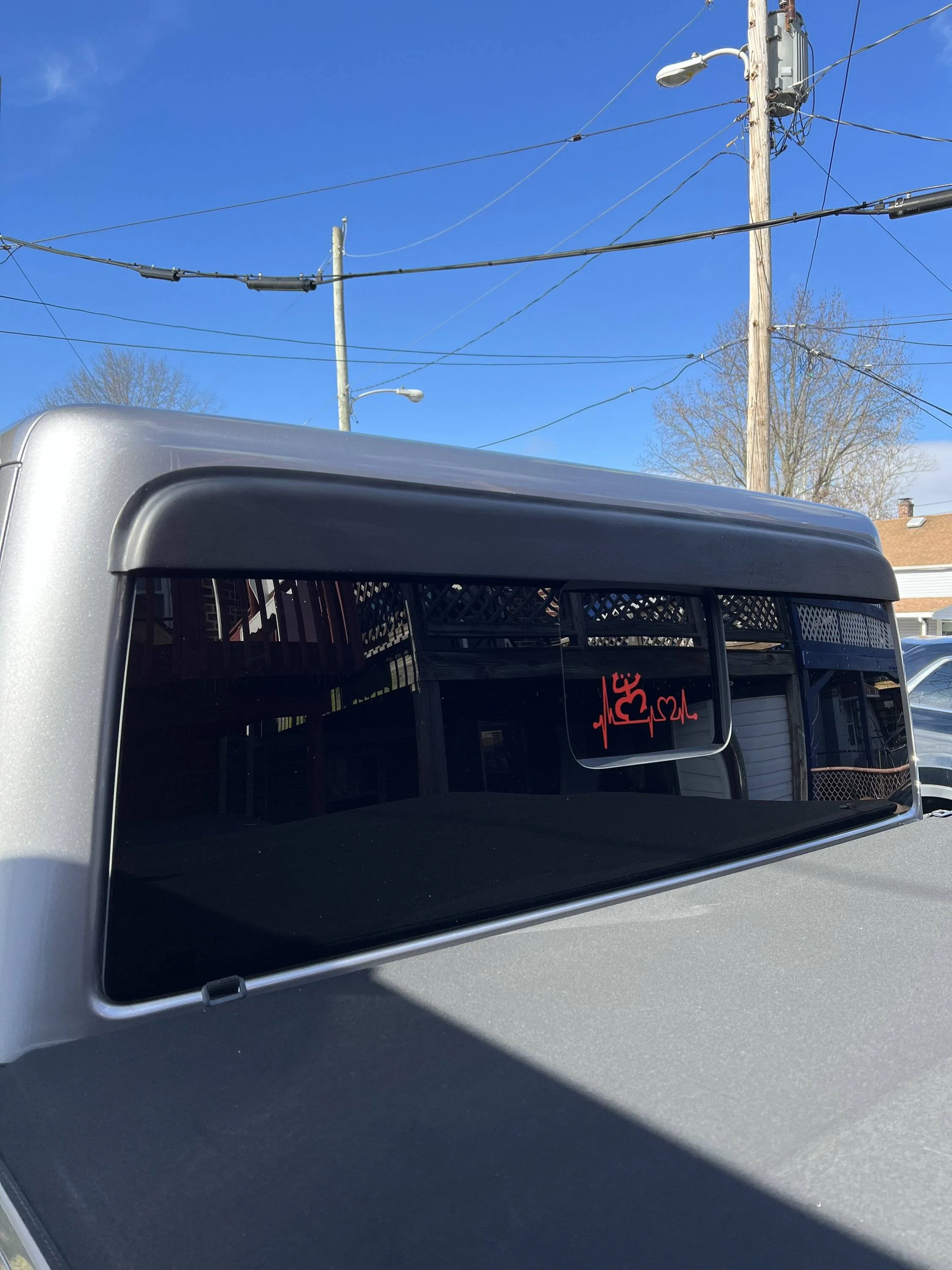

I'm new here in this forum, but that's how I was able to fix the leacking problem in my Gladiator. I had to make this custom made sun deflector and goodbye leaks.
Jeep Gladiator Rear Window Leak - Difficulty with Dealerships IMG_9025
Jeep Gladiator Rear Window Leak - Difficulty with Dealerships IMG_9027

By the way I do have more for sale!!!

Anyone get there's fixed after the 3 year 36k mile warranty. I have had my Jeep almost 5 years now with only 33k miles and just noticed the sloshing noise recently. Previously, I always assumed it was my kids water or gas tank or something. I spend the summer topless and car parked in garage so it's not exposed to rain too often. I wish I would have caught this sooner. Nice looking rain guard.
