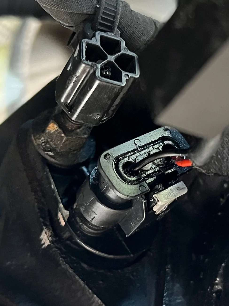

Ok so I was getting ready to do this part install ( 68400411AA ) and noticed there is something on the bolt I need to take off that is not on the bolt they show in the instructions on how to do this.
What is the thing attached to the bolt and why is on there and not on any of the pics on how to do this project ? Please let me know. Thanks to all who have been helping me with this.... I haven't done many Jeep repairs on my own and your help is very appreciated !
* Also I cleaned up the diff and really don't see any oil leaking out the past few days... If you remember the start of the post my mechanic told me my actuator connector (68400411AA) is the cause of the oil leak.

But there's nothing attached to it and it's coming off the bolt I need to remove. If you look above you will see someone posted pics of how to do the part replacement and in the pics it's just a regular bolt with nothing on it... no stud etc.

If the zip tie is not attached, just pull it up or untwist it off the stud. If it’s just a useless piece of nothing, once you take out the bolt, hack saw the threaded post off or just leave it there.
I have the 21 JTR and it looks like I have the same bolt as in the part replacement and do not have the threaded stud.
