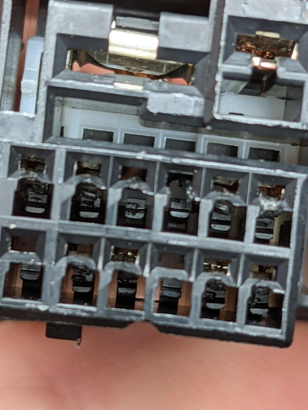

I have had my JT for a little over 30 days. I have owned Jeep Wranglers before in the past. Never had any issues with the wiring harness on the doors.
First time taking the doors off on my JT, I put them back on and had a number of issues. After reading this post, I checked the driver's side door connector. The male end had several slightly bent pins. The attached picture is the female end. It appears to be very flimsy.
Someone else mentioned that there shouldn't be any reason the connectors don't align. The tabs line up and the lever is pulled down to engage both ends. I believe this is a design flaw.

That is really chewed up compared to mine. I only had one bent pin, though.

It's a flaw in the connector. On my driver side, the white internal piece on the male side extends to protect the pins and ensure it all aligns going back in.
On my passenger, not so. The white piece does not extend, leaving the pins fully exposed and thus capable of misaligning when plugging it back in.
Clearly a design fault or, at the very least, a defective connector. The latter is a warranty item since connectors are not excluded.
