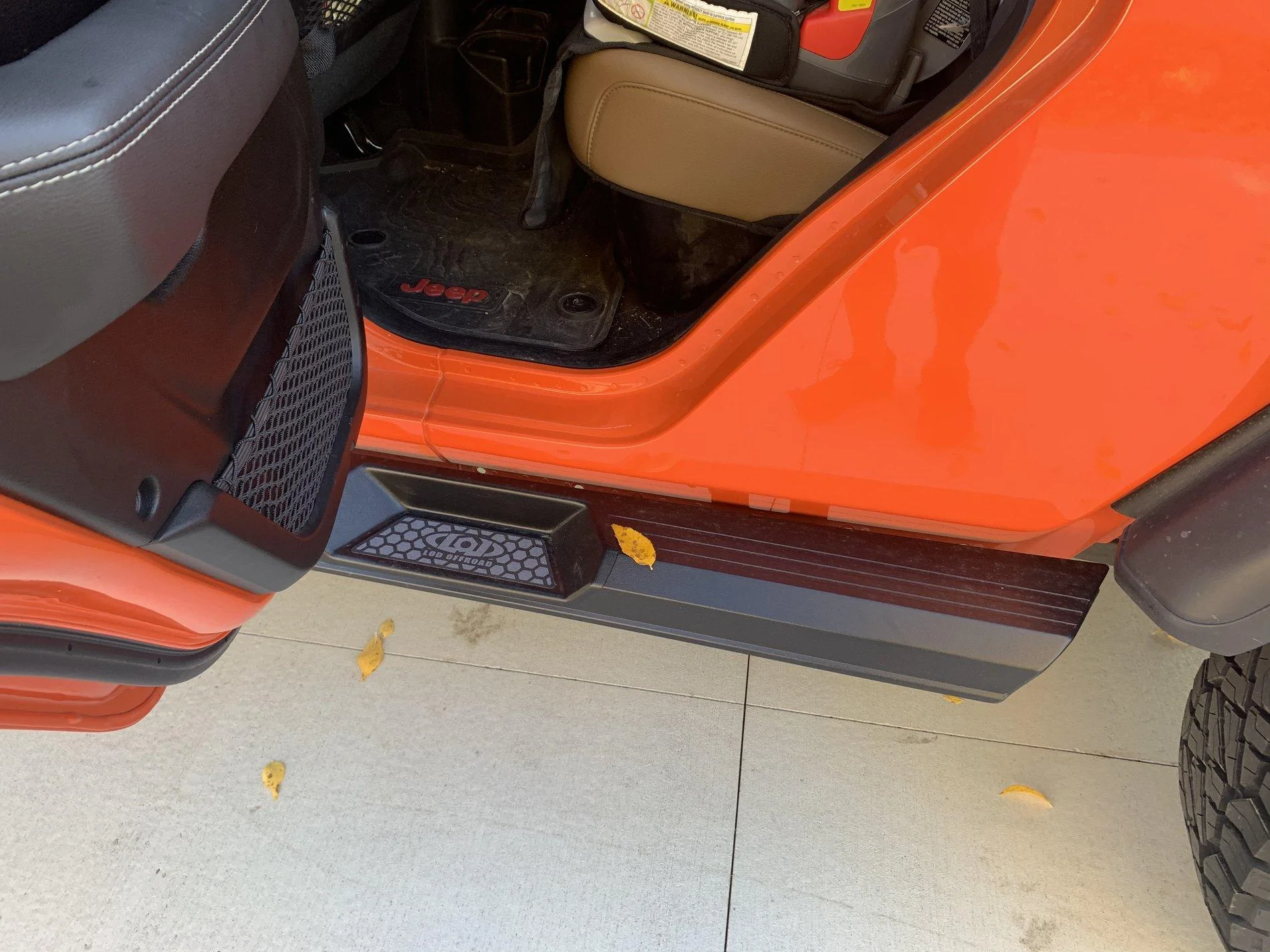

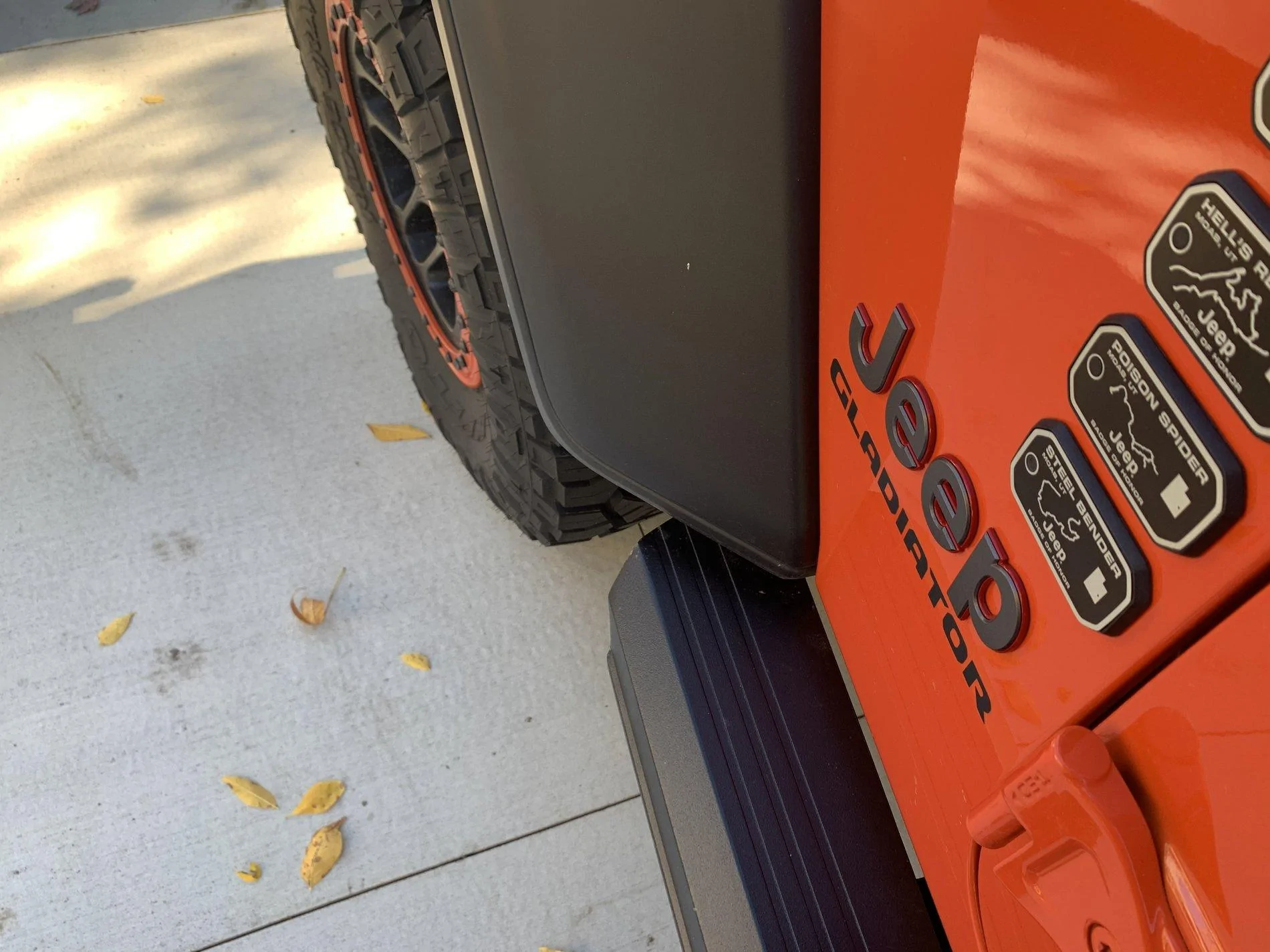

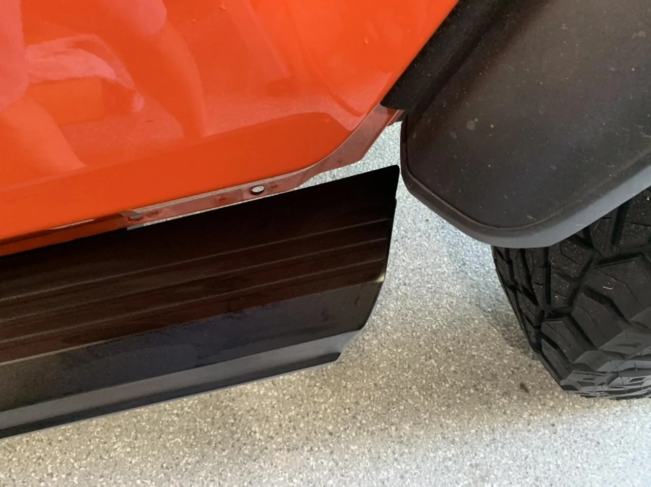

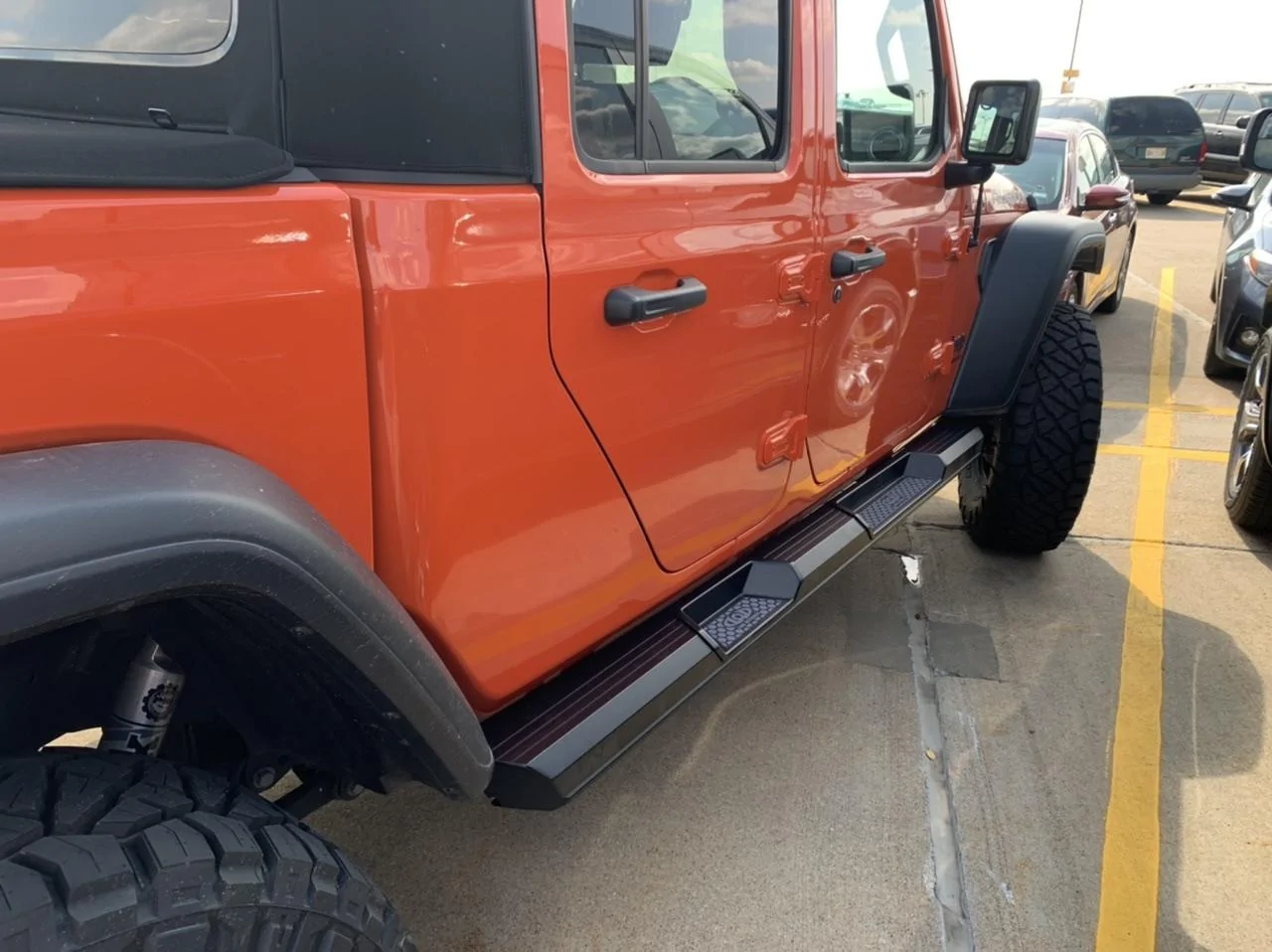

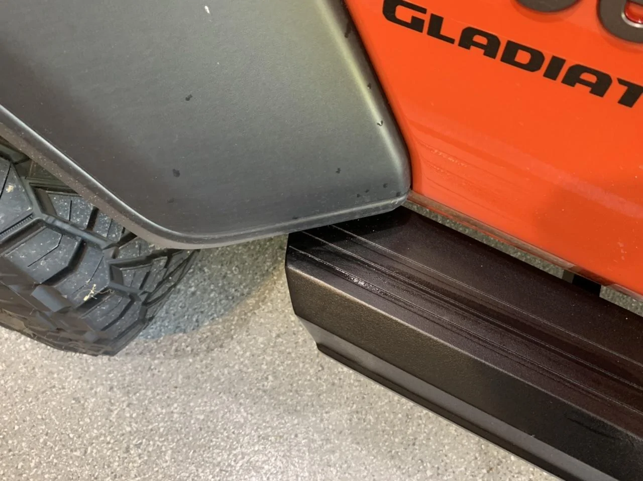

The day has come! I received my Armor Lite sliders last night and installed them this morning.
Overall I am very impressed with the engineering and build quality. I did scratch my head a few times with the instructions but I was able to figure everything out.
I’ll do a full review in a few days when I’ve had a chance to really test them out, but so far my only real criticism is the length. I wish they were about 3-4 inches longer in the front.
When the “step” cutouts are positioned for easy entry to the doors I have too much gap from the front fender flares to the slider. This will allow snow/dirt to kick up on the doors which is one of the main reasons I wanted this style slider.
The great thing about the design is the ability to position the steps where I want. So I slide through forward to reduce the gap, but then it makes rear entry a little tougher for my kids.
I think they will be fine and I’ll probably pick up the add on steps to help the kids a little more. Again I’ll plan a full review in a few days but I wanted to post right away for anybody sitting on the fence about these.
Truely excellent engineering and quality.

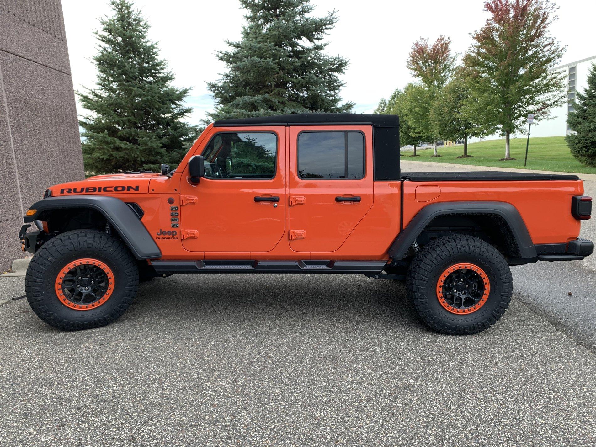

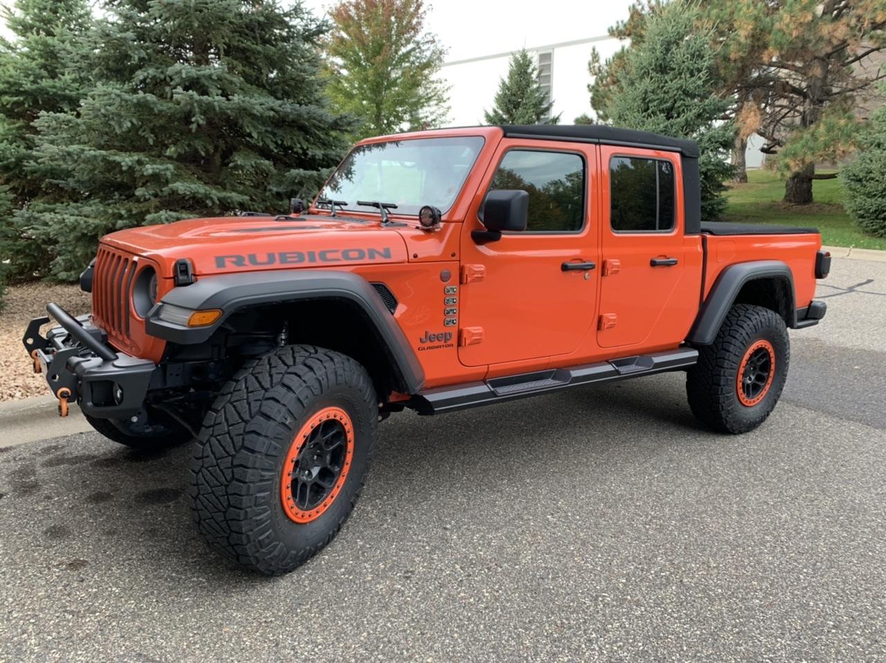

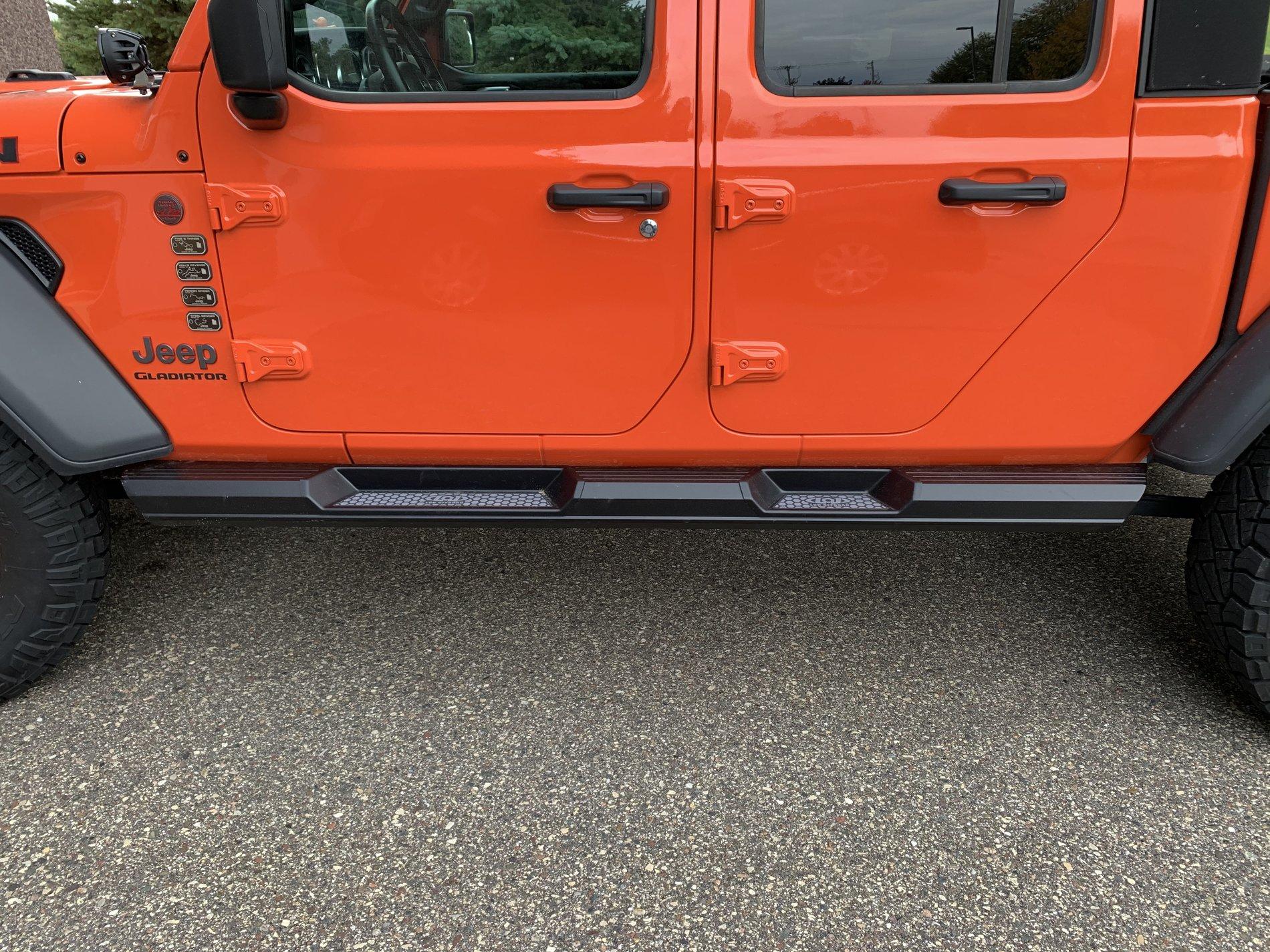

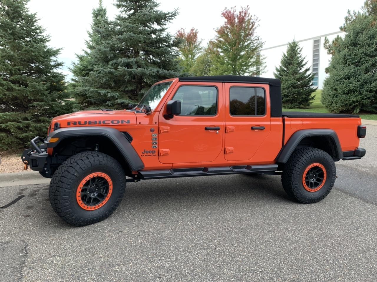

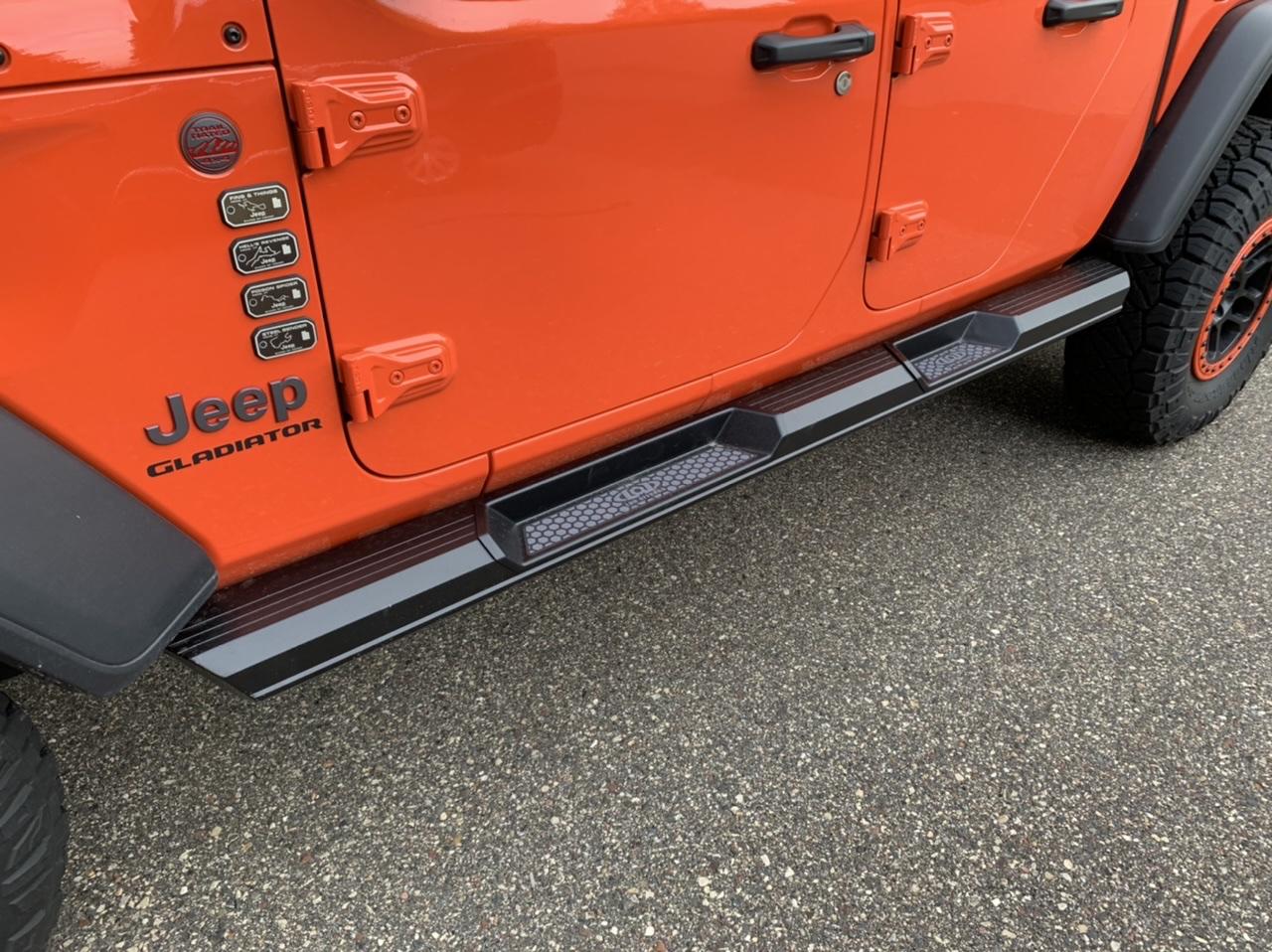

Sorry for the later then expected photos and feedback. I was hoping to get out in the fall colors for some real glamour shots but my job has been hectic the last few weeks.
Here are a few “better” photos.

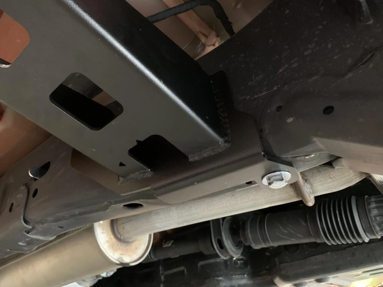

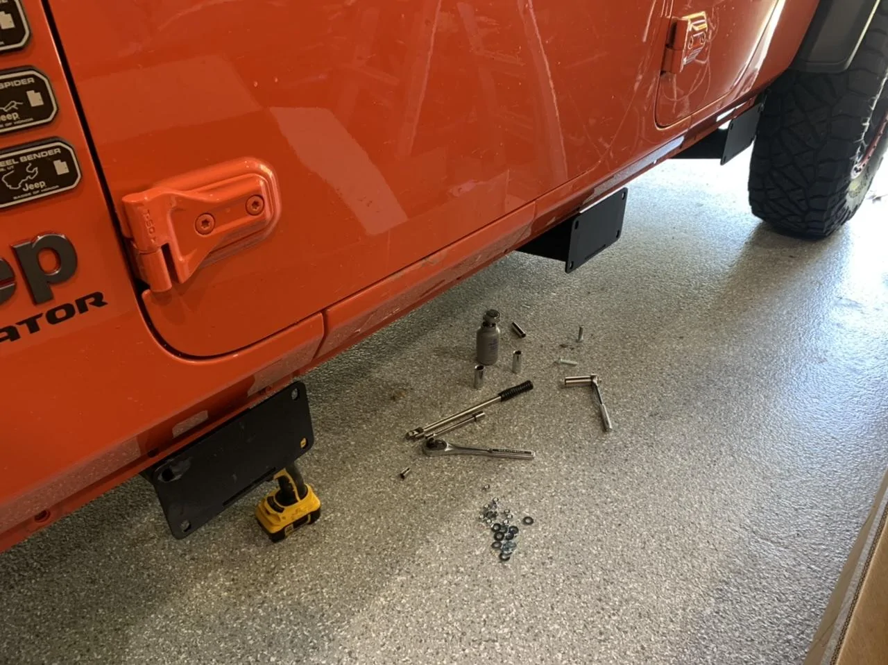

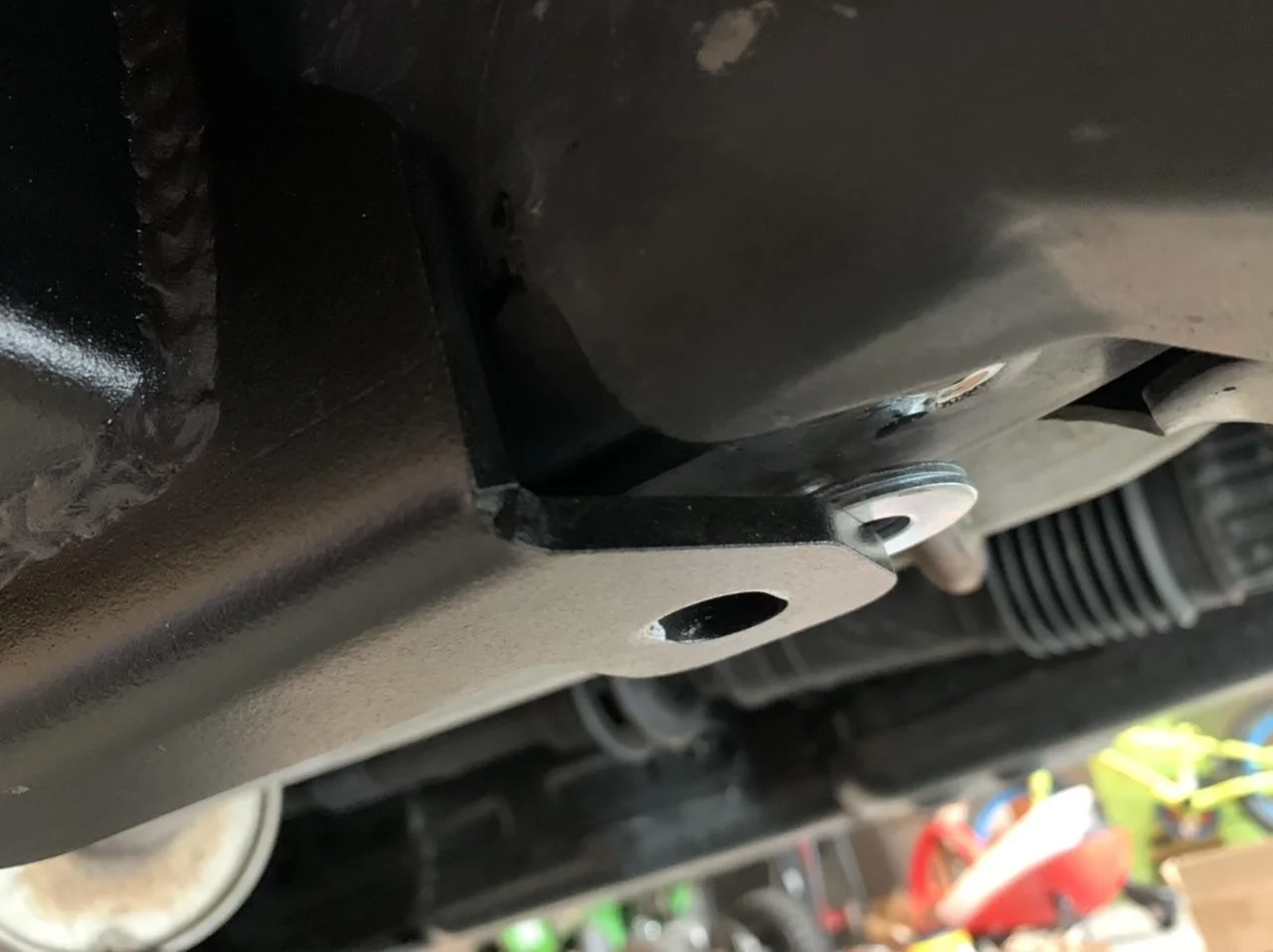

Installation feedback:
Overall the installation went smoothly.
Everything was well packaged and the “foam in place” packaging kept the brackets secure. I did have a slight bend to the tail end of the top aluminum skin on the rear of one slider, but it was easily straightened with a vise grip and rag to prevent scratching. I did not see damage to the box so I can only assume it happened prior to packing. It was very slight and was easily fixed.

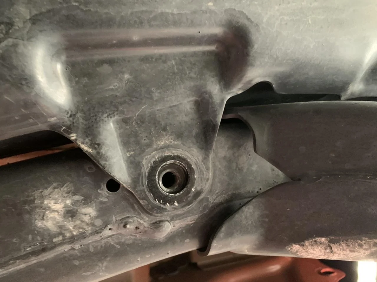

I noticed the directions must for a Sport model as my Rubicon already had weld nuts installed For the skids plates in a few places that the directions call for a weld nut bracket to be installed. Not a big deal and I would prefer to have the extra hardware and not need it. A simple call-out in the manual would fix that.

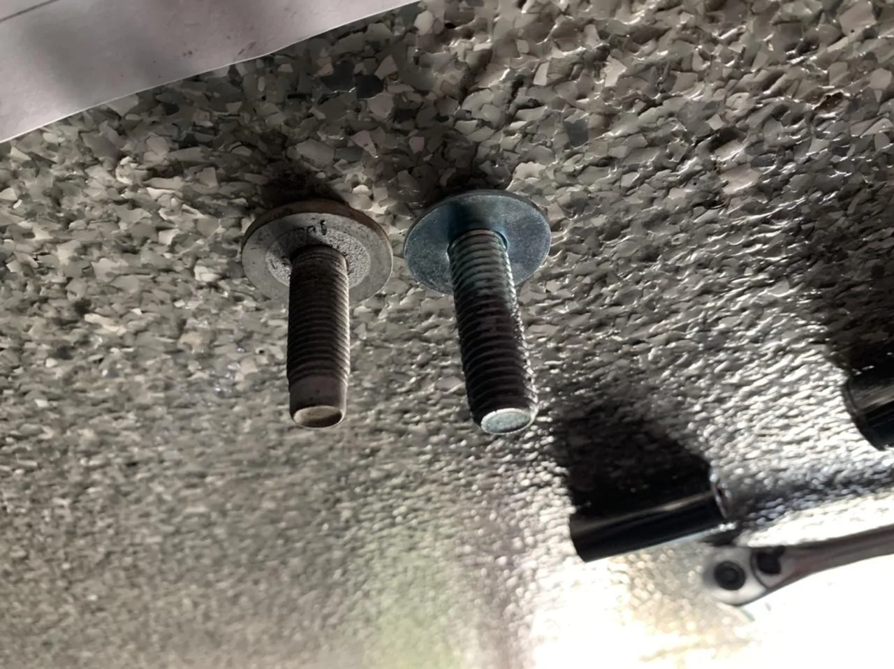

I also noticed the 1/2” bolts come in coarse and fine thread pitch. I believe these fine thread bolts were meant for the previously mentioned Rubicon skid plate weld nuts that are already installed. I almost installed the wrong thread pitch but caught it in time. Again no mention of this discrepancy in the manual but an easy fix.
I had a pile of hardware left over after the install which is good and bad. I definitely appreciate the foresight to include all of the spacers and washers for potential variables, but none of the spacers were needed in my installation. I think this speaks volumes to the level of initial quality in their product and understanding of their customer variations
Nit picky advice- I would have liked to see suggested torque specs for the hardware. Not critical for an average wrench turner, but still gives piece of mind and a sense of professionalism.
I’m holding off on a true review until I get some real use out of them, but my initial impressions are very positive and I would not hesitate to recommend them.
The versatility of the rail channel system LOD has designed, frame mounting, and use of aluminum are all positives that set these sliders apart from the other sliders on the market!

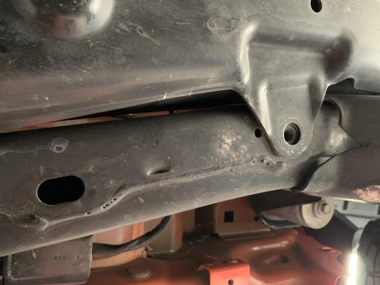

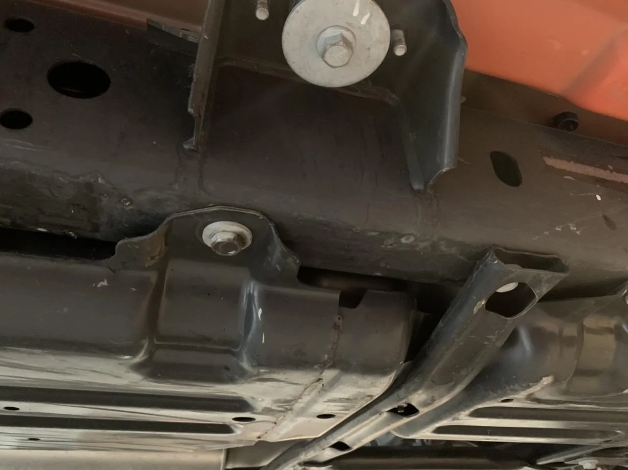

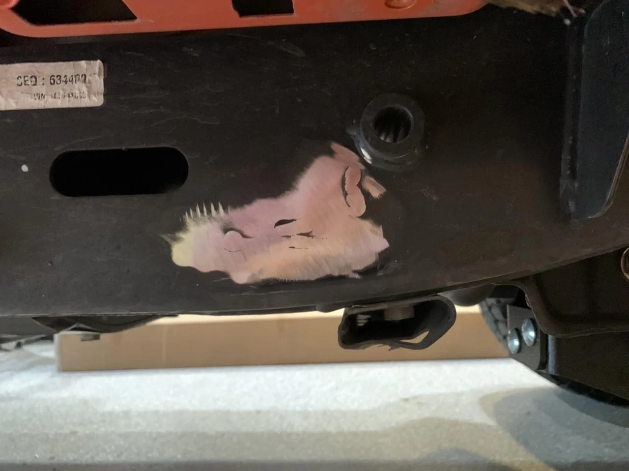

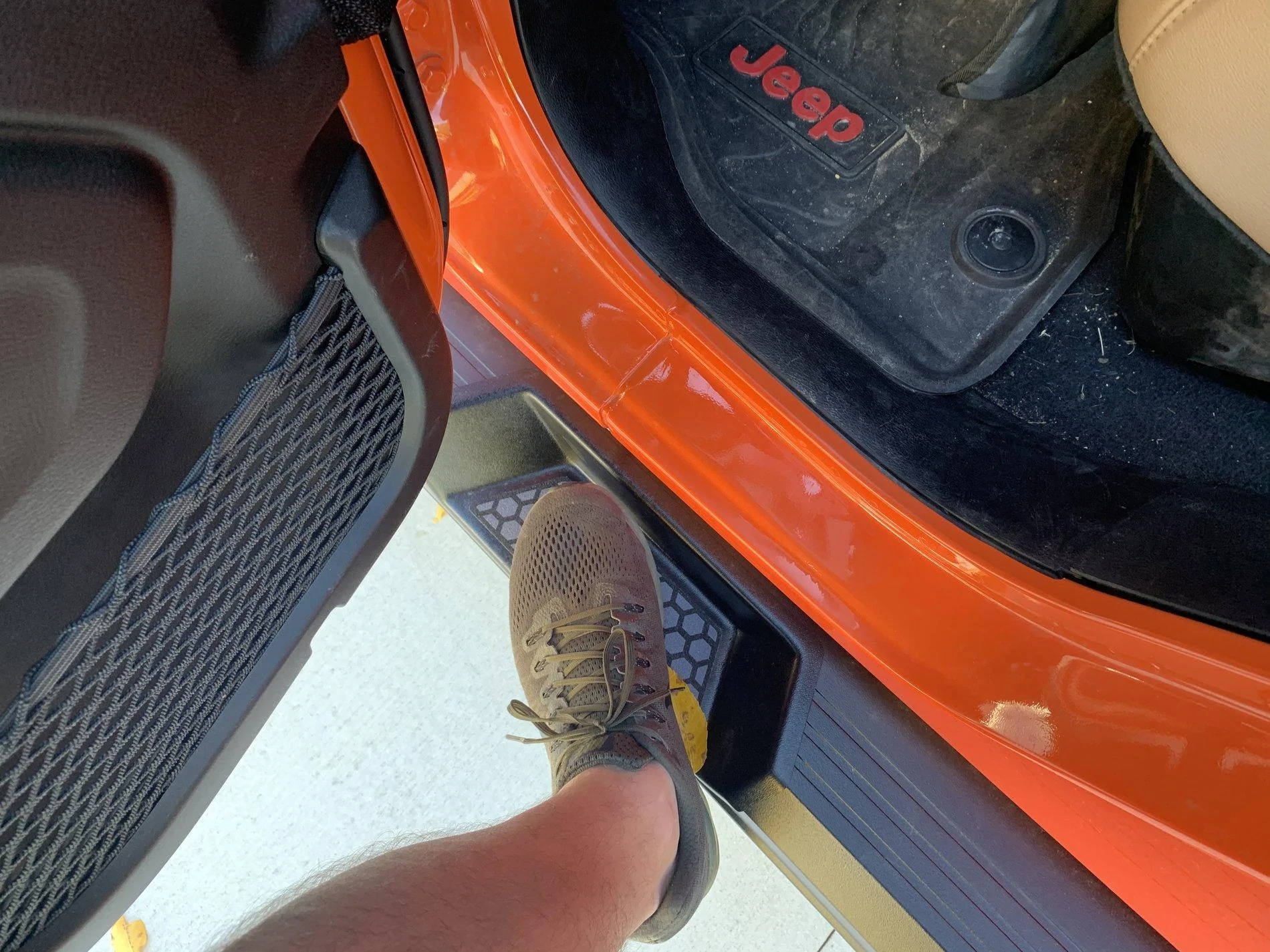

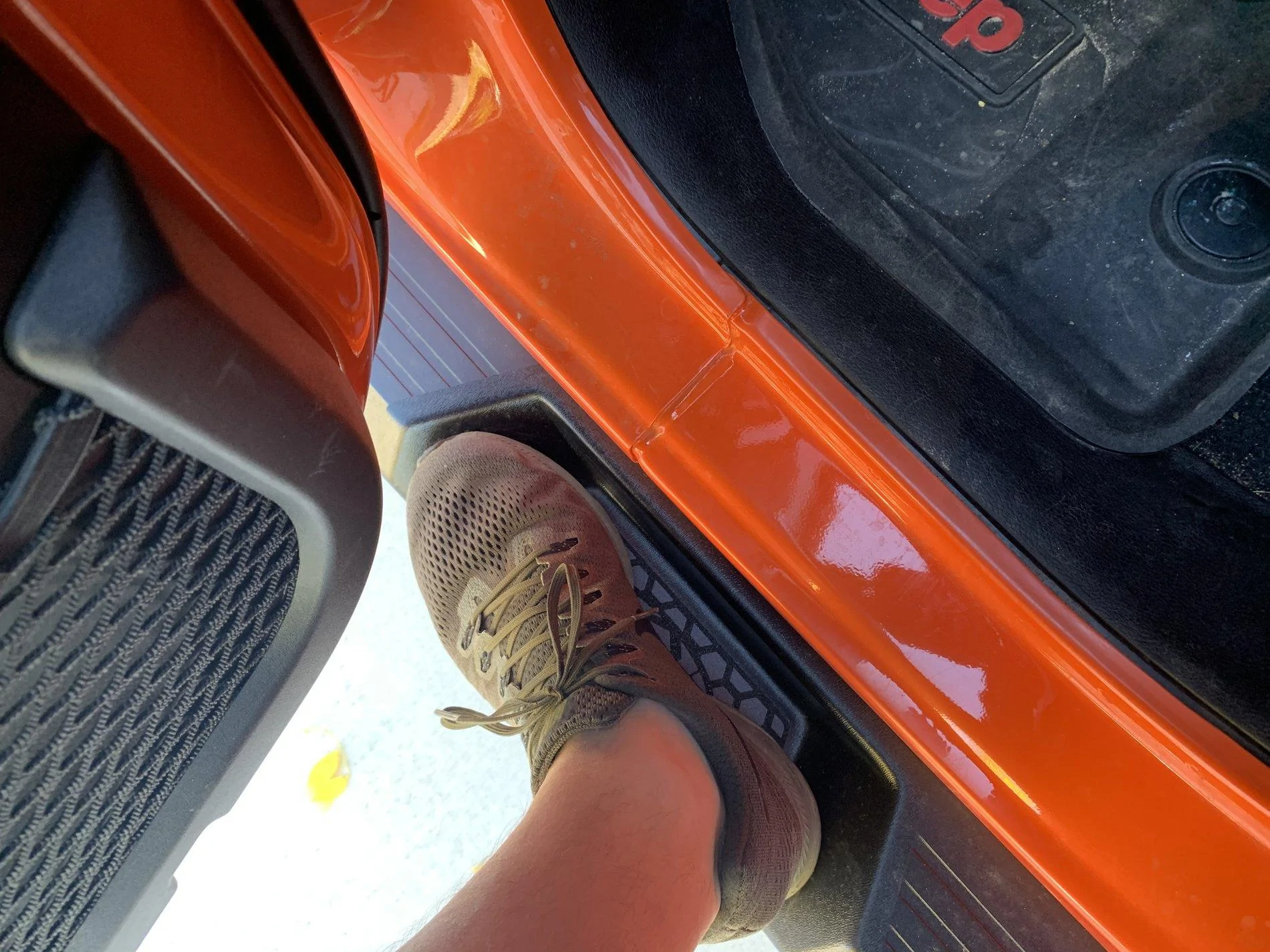

Why did you grind the frame? Does the back seat step fit a foot sideways? When I hop in a Jeep I usually have my left foot point toward the front not perpendicular to the Jeep if that makes sense. I really like the look

The frame “body alignment” tab on the passenger side needs to be cut off. This was well detailed in the directions and the only “cutting” that was needed. I hit it with 3 coats of flat black paint afterward which did slow down the install waiting for it to dry.

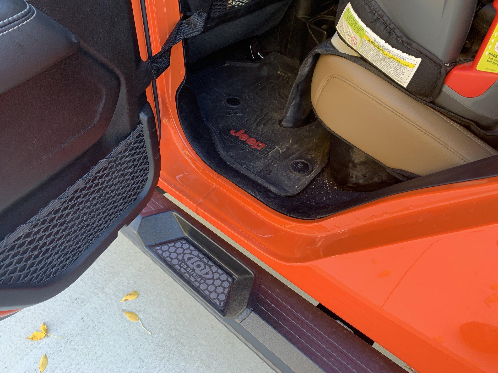

The back step is pretty small to place your foot parallel with the body. I would say it’s fine for kids or sub size 9 shoes to use that way. My shoes are size 10 so you might have trouble with large boots or size 12+
I tend to use them more at an angle so it hasn’t been an issue for me or my kids. The issue I have with the rear step is that it’s too far forward so it ends up being too close to the hinges of the door and make sit a little hard for the kids. This could be fixed with a wider rear step, which sounds like would take care of your concern. Or the whole slider can be shifted back for better placement of the step, but then it doesn’t give as much protection from tire debris in the front. To be clear this compromise can be chosen by the installer. The sliders have channels in the extrusion that allow you to chose where to place them.
I think the perfect solution would be if the rear step was about 2-3 inches longer and the whole slider was about 4” longer overall. That would have made them damn near perfect in my early evaluation.

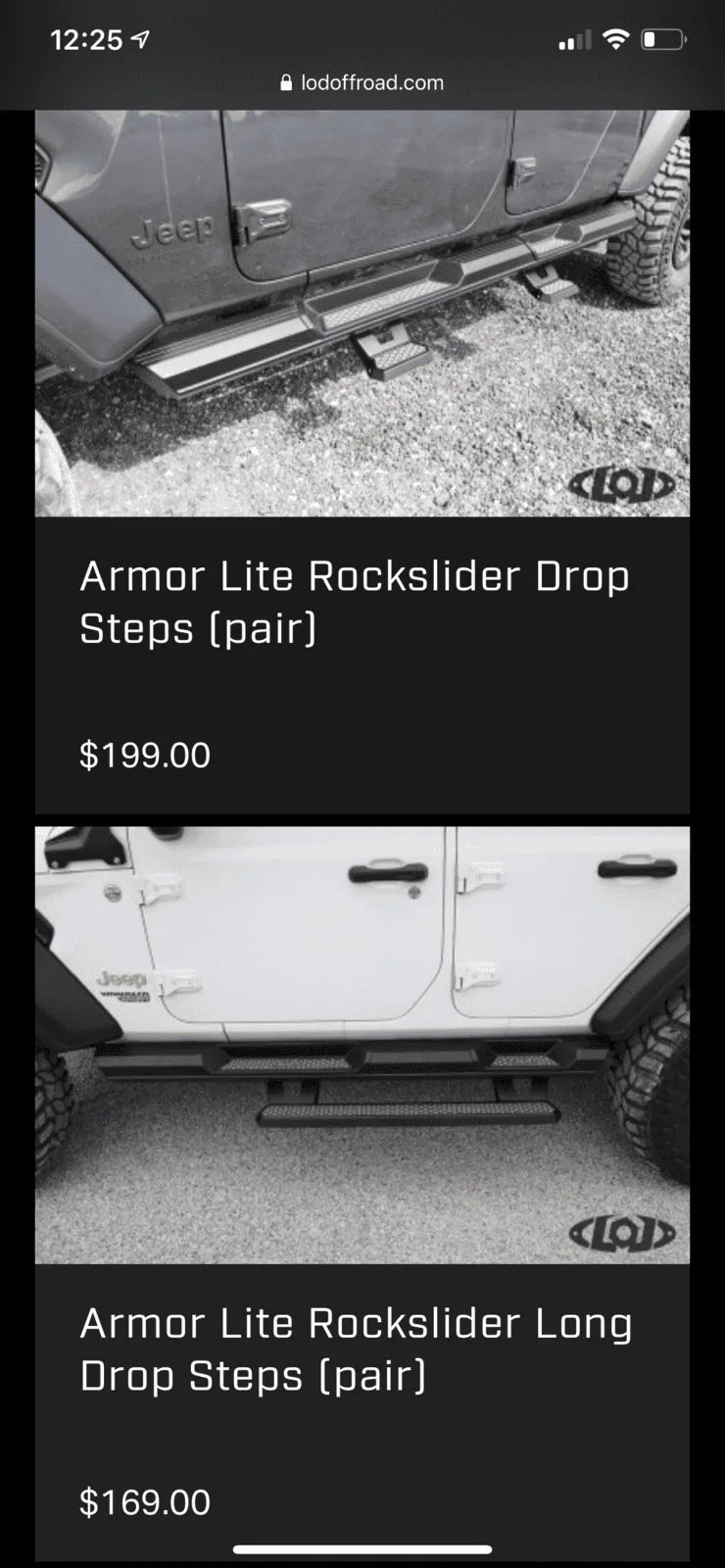

@Lod Offroad can you explain why the pair of 2 smaller drop steps costs more then a pair of the long steps? Seems backwards to me.
