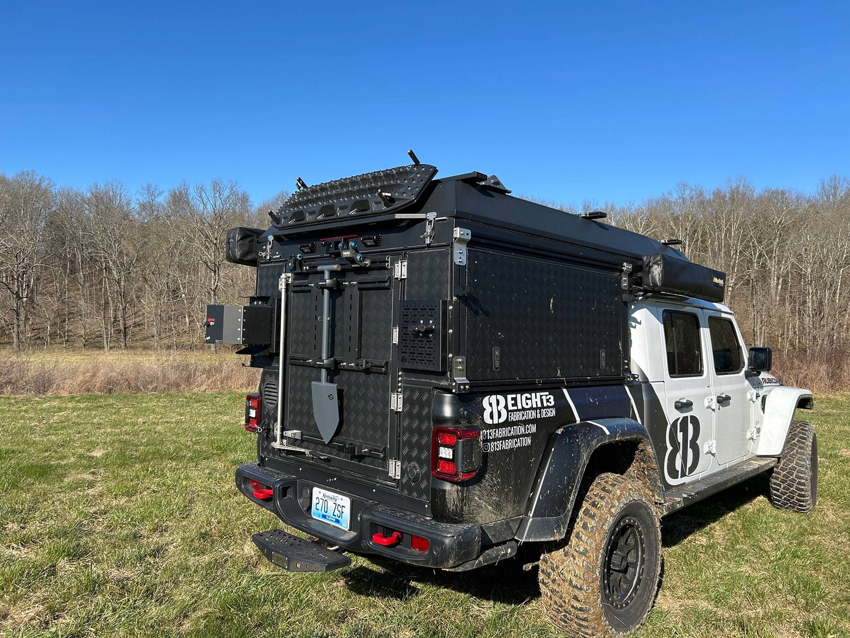

Going to be hard to make it fit. Once you add the Alu-Cab you will need to add stiffer springs. I think the majority of HD springs are going to be at least 2” lift. I have Dobison 2” springs in the rear and the top of the camper is over 8’ (without the Maxtrax mounted). I have the low mount for the load bars, the load bars add approx .75”

Going to be hard to make it fit. Once you add the Alu-Cab you will need to add stiffer springs. I think the majority of HD springs are going to be at least 2” lift. I have Dobison 2” springs in the rear and the top of the camper is over 8’.

I have BFG KM3s / 35". The Clayton may or may not have the springs you need, depends if they are rated for that much weight.

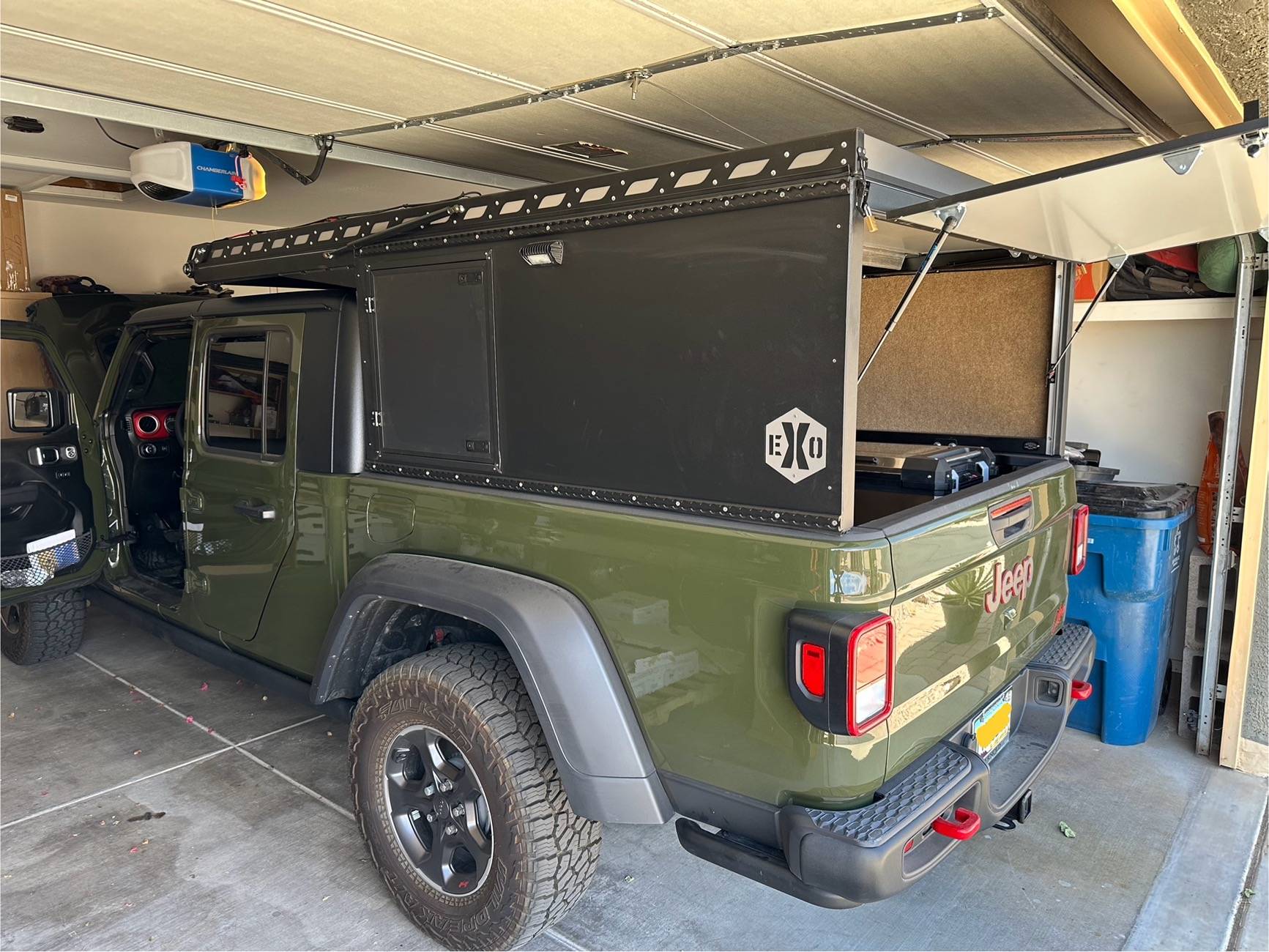

I have a stock(so far) ‘23 Rubicon with a Harker EXO camper cap and airlift 1000. It fits in a 7’ garage door with room to spare for 35’s and a 1-2 inch lift. Don’t forget squat in your calcs. I dropped 1” with the cap and about 300 lbs load.
