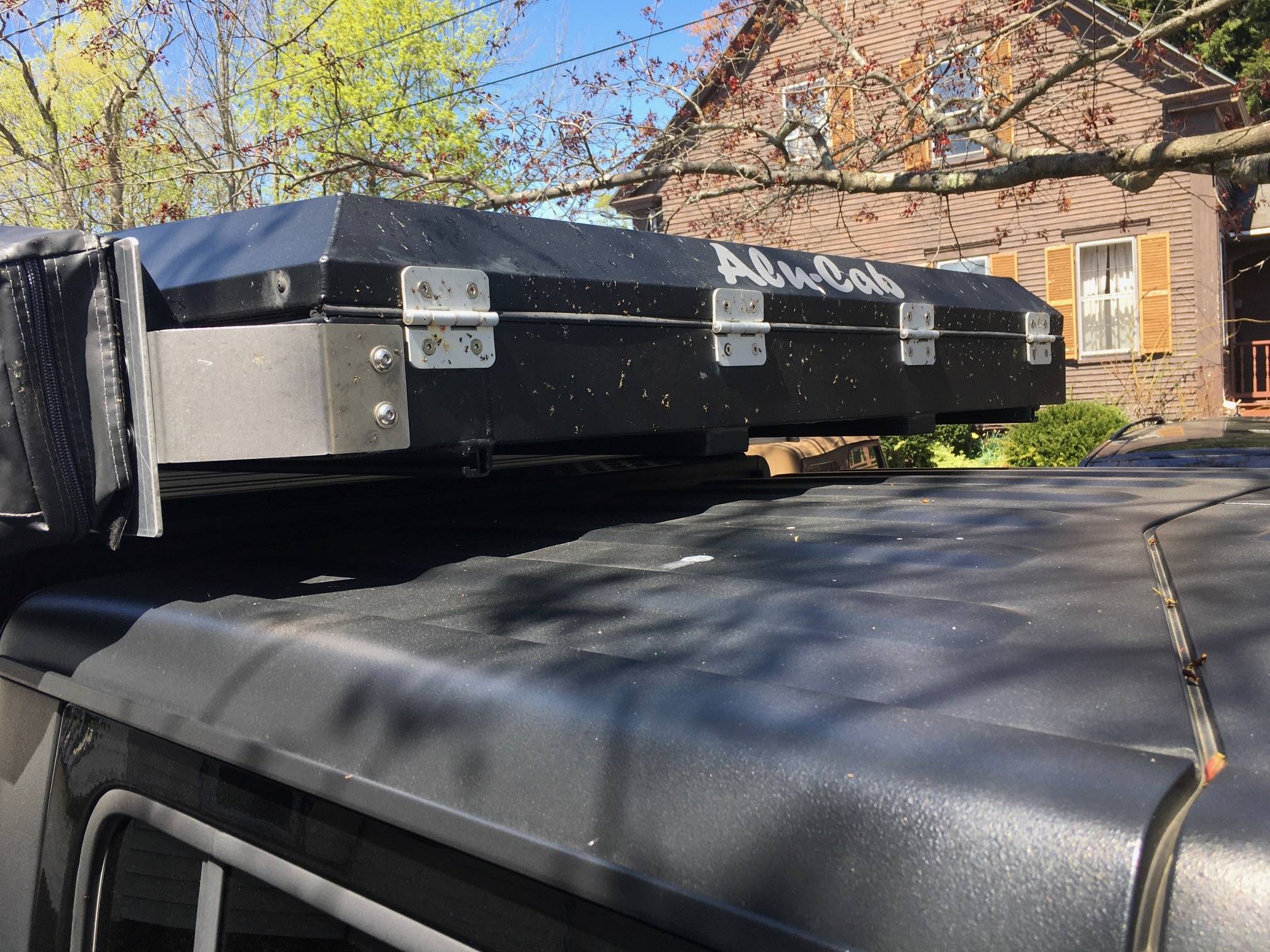

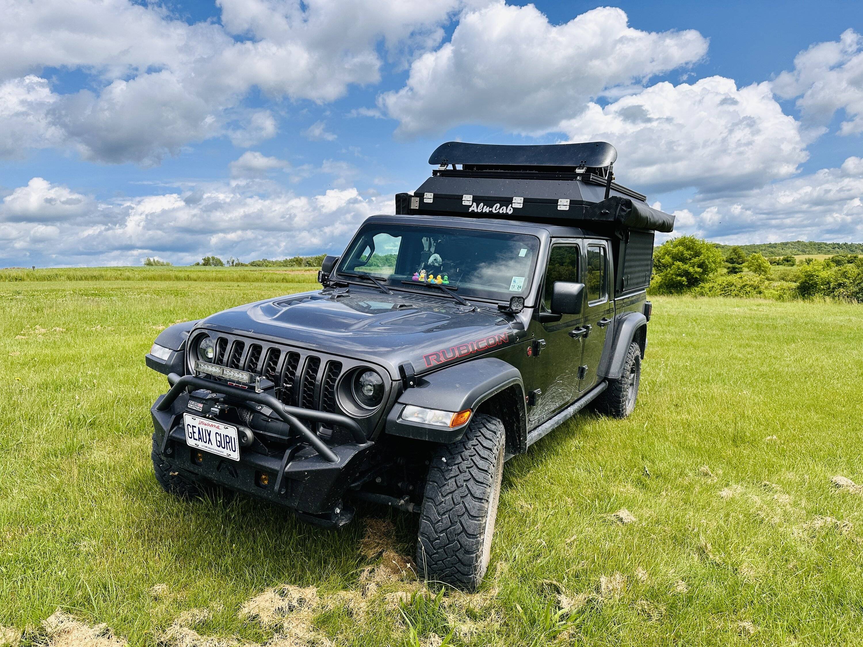

I've run my Alucab Cap and RTT with 270 awning for 3 years now and love it. The only drawback for me is the bit of a mpg hit I took at 75mph. At 55mph I can still get 19-20 mpg. The added frontal area really adds some drag at higher speeds and kills a lot of bugs. I make a regular 3 hour highway run and see around 16mpg at speed.
Figured it was worthwhile to see if I could make an improvement.
So this is what I was looking at.
Jeep Gladiator Alucab RTT Aero Mod IMG_5312

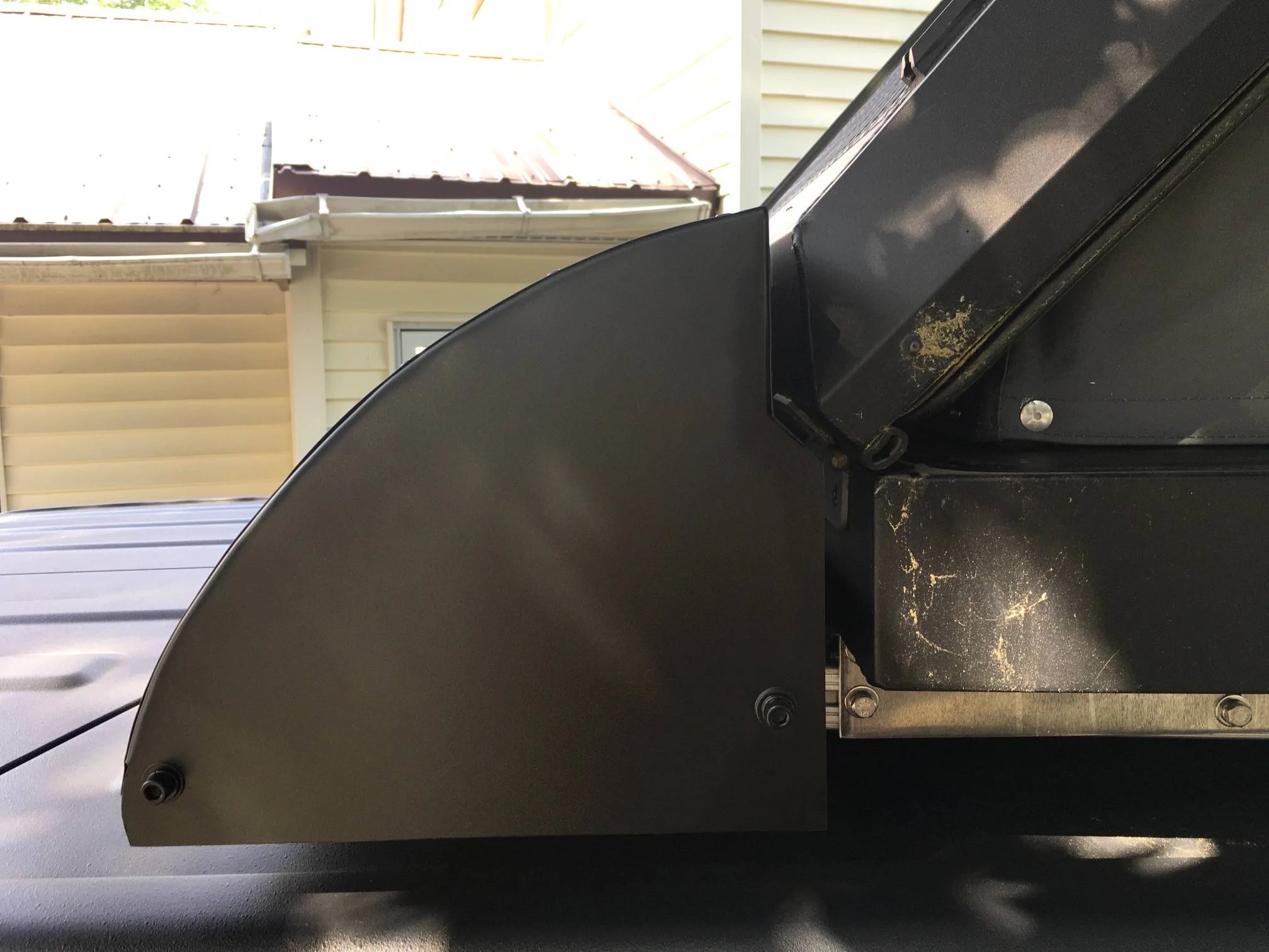

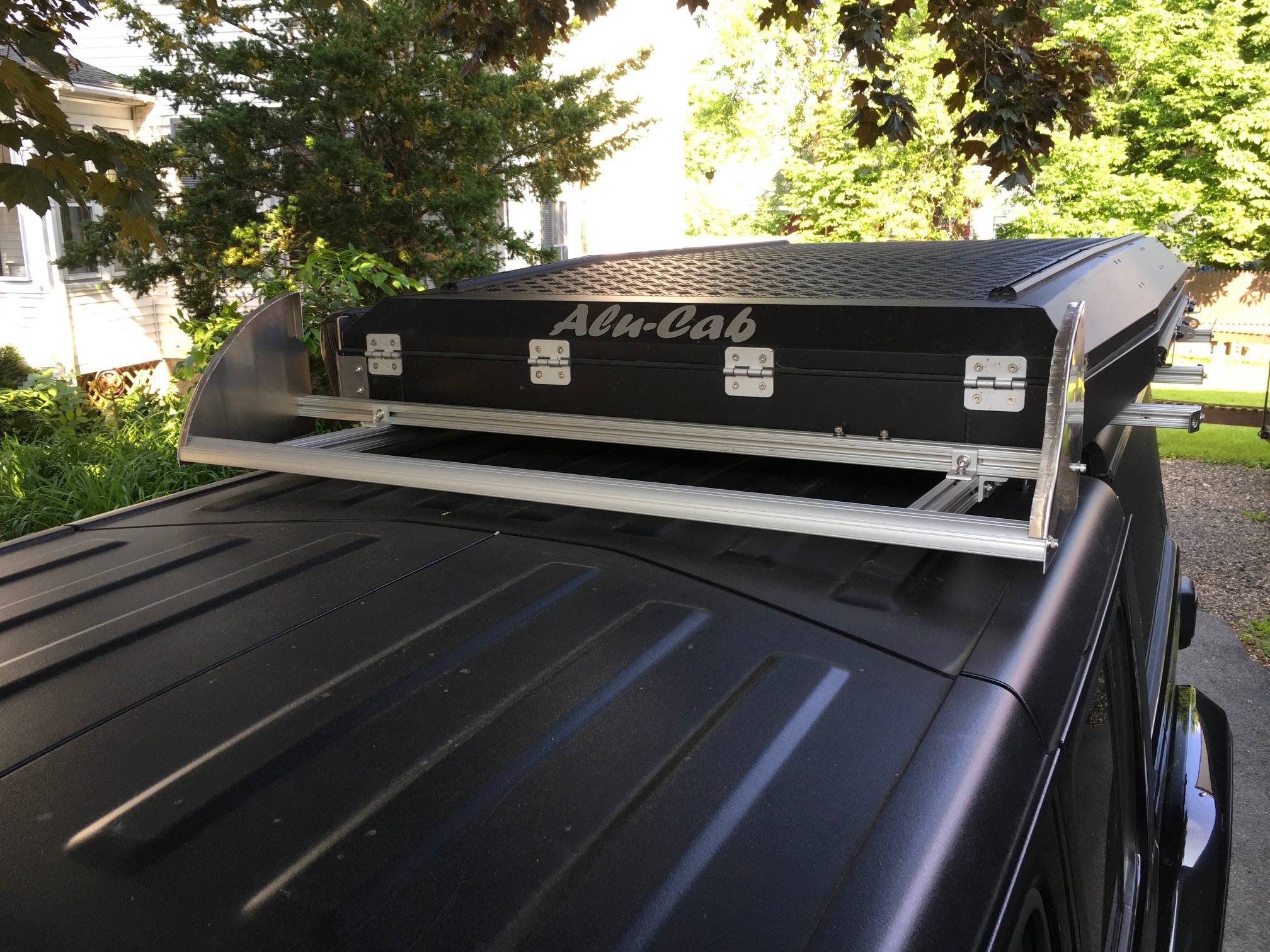

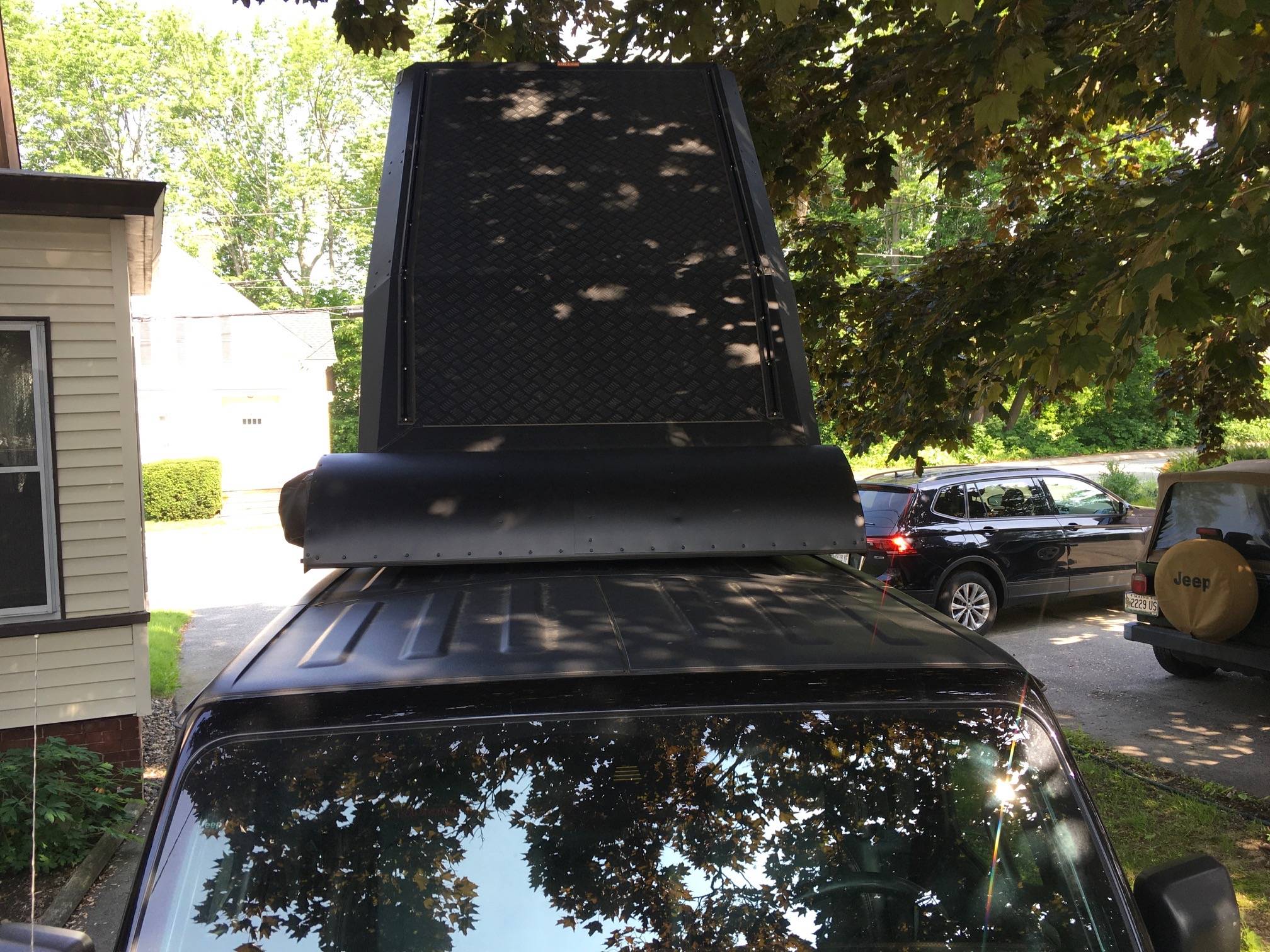

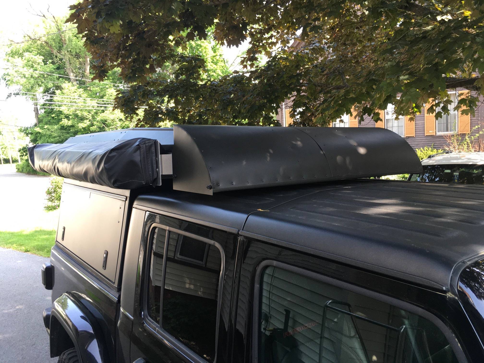

It took a few mockups to work things out. At first I considered using roof gutter racks to attach the air dam. Had some advantages but decided it was better to attach to the bottom T slots of the RTT itself. There is definitely chassis flex between bed and cab, and amplified by the cantilevering of the new frame. The cab roof is slightly domed and came to the conclusion that an 1-3/8” was enough center clearance to not slap the roof. Another consideration was trying not to blank out the roll bar antenna or interfere with the front roof panels. This gave the limits for the aero curve.

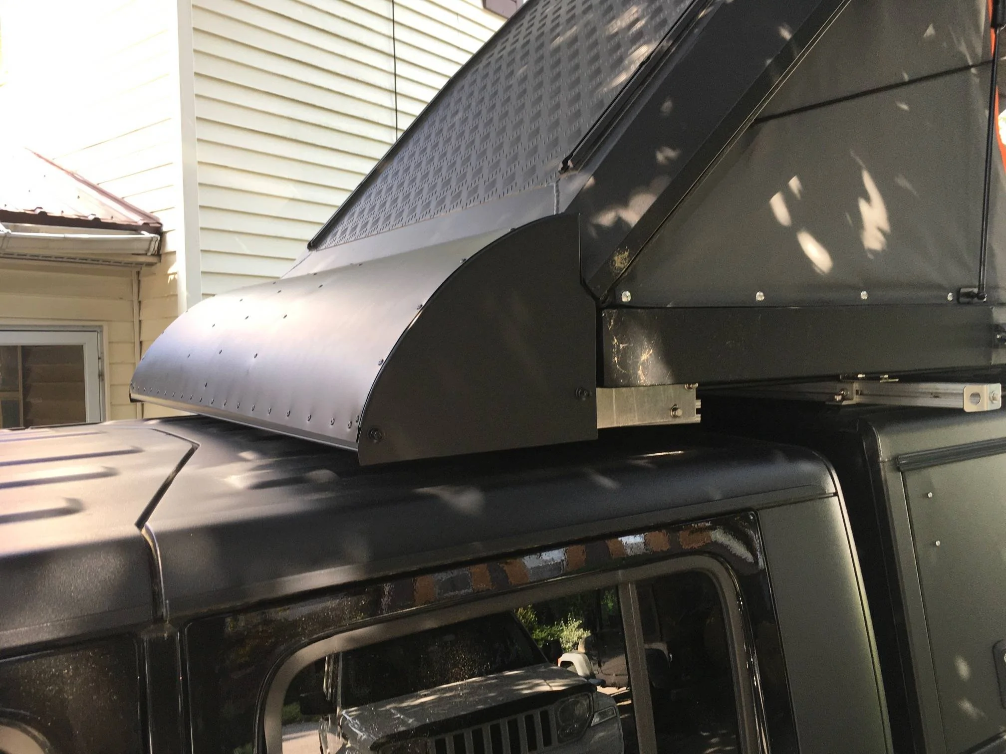

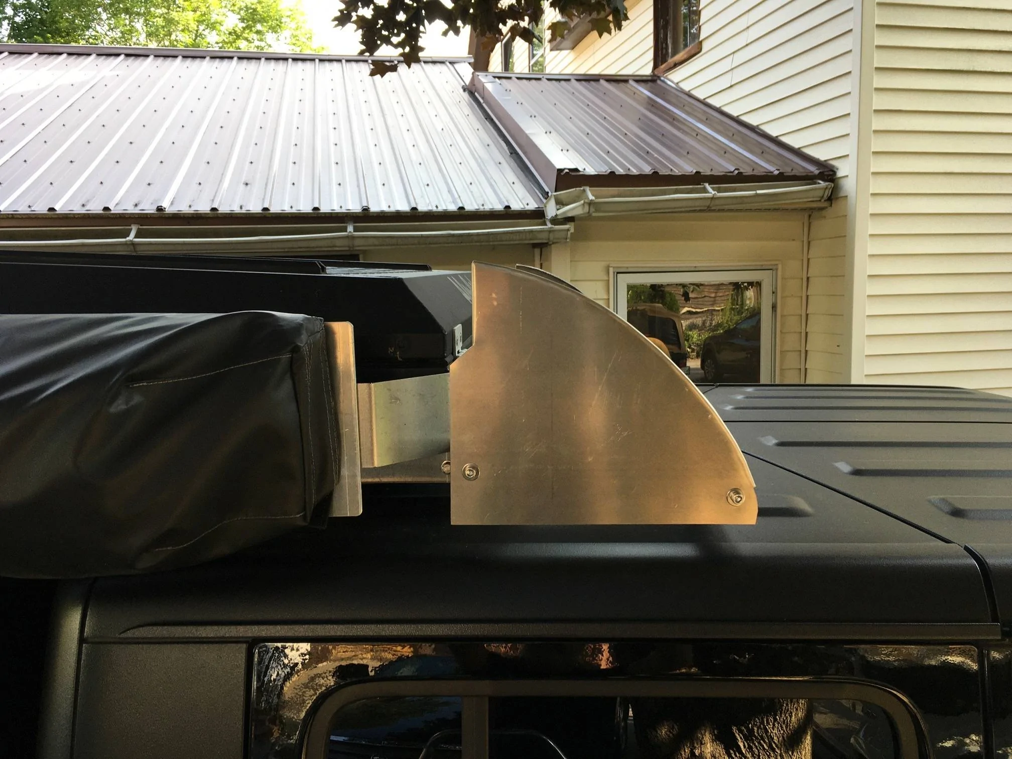

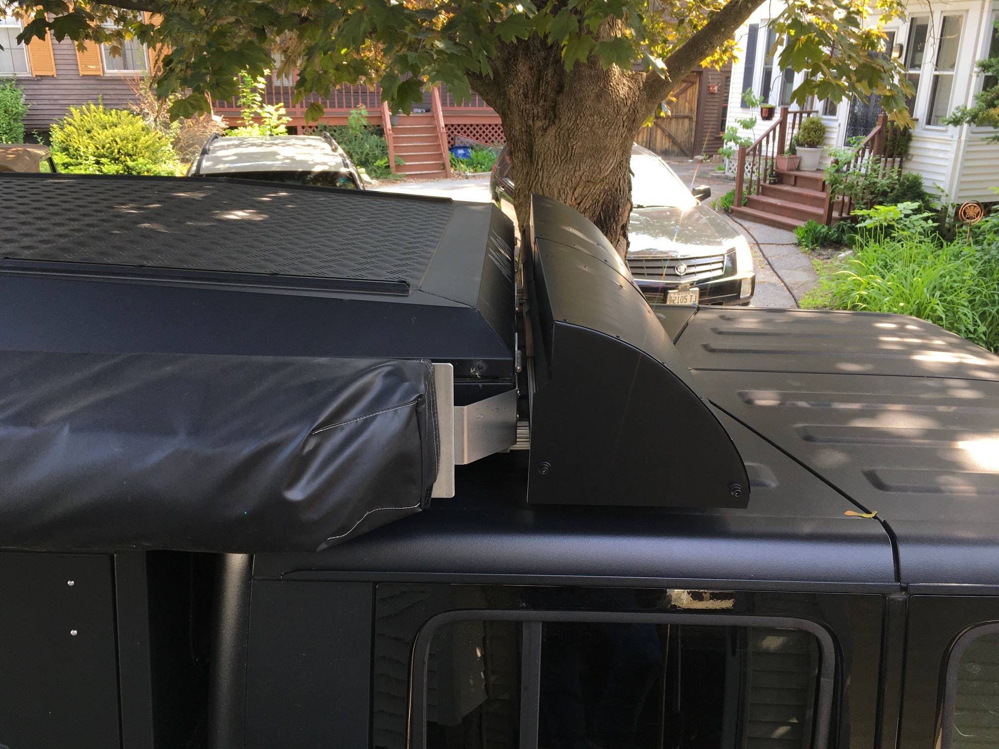

This is what I came up with.
Jeep Gladiator Alucab RTT Aero Mod IMG_5328
Jeep Gladiator Alucab RTT Aero Mod IMG_5330
Also have to account for the opening of the RTT, the roof lip comes forward into the notch of the fairing. Using 8020 for the frame work allows adjustments. The bottom and most of the back is open. All made from aluminum.
Couldn't include the awning in the air dam as it would impact opening the awning. I could ad a tip up filler to bring the top closer to the RTT when closed but being slightly taller it may not make much difference.

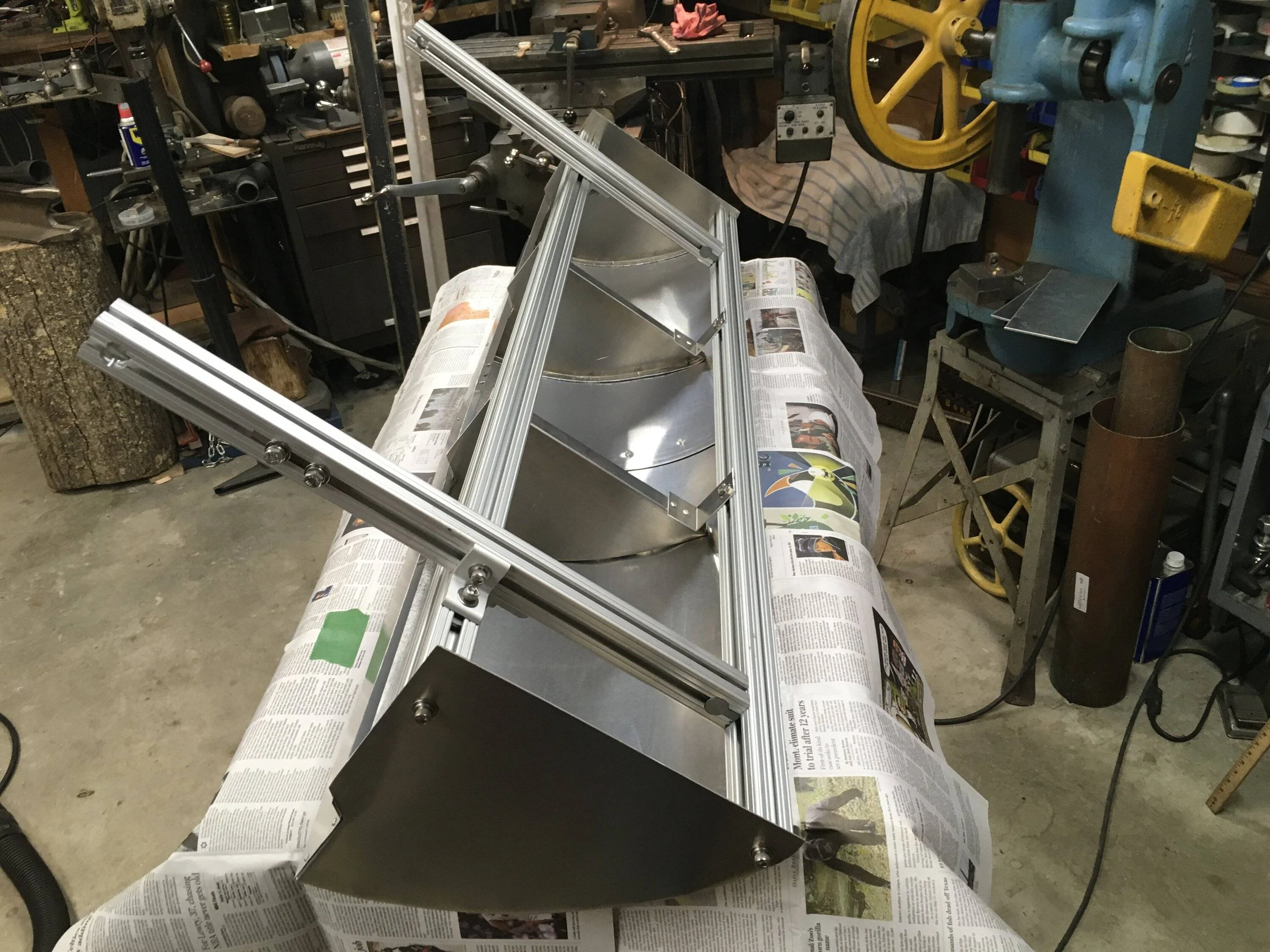

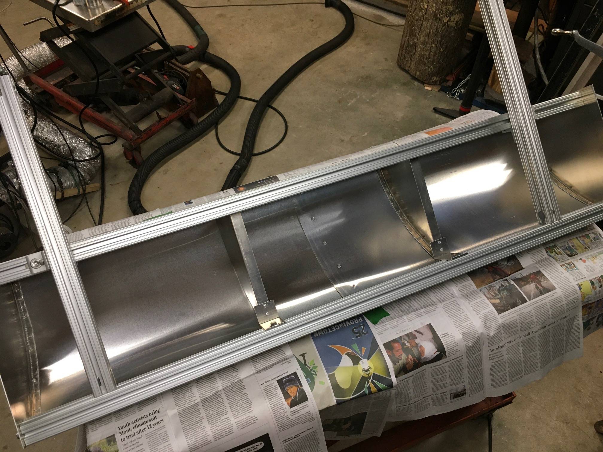

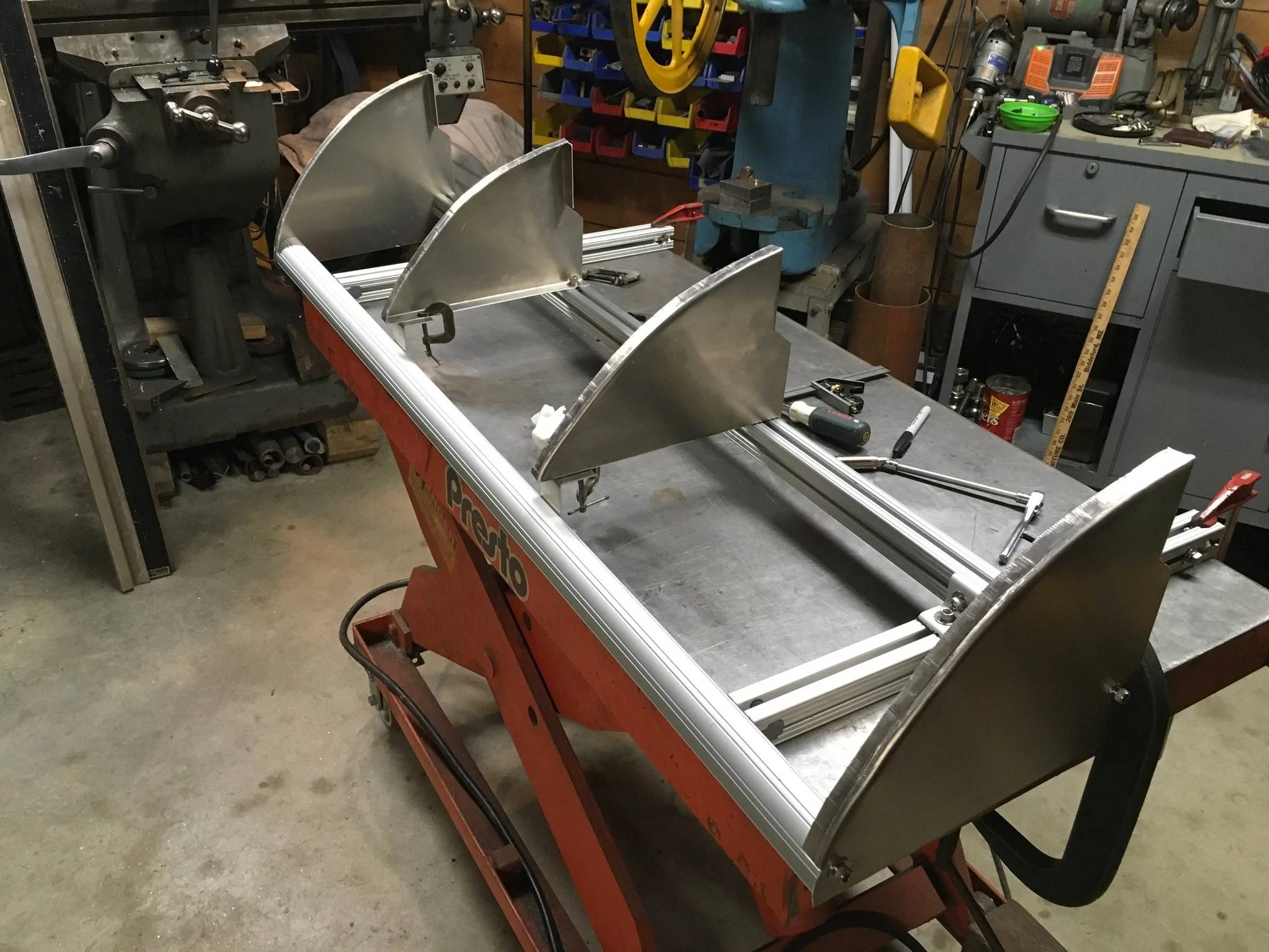

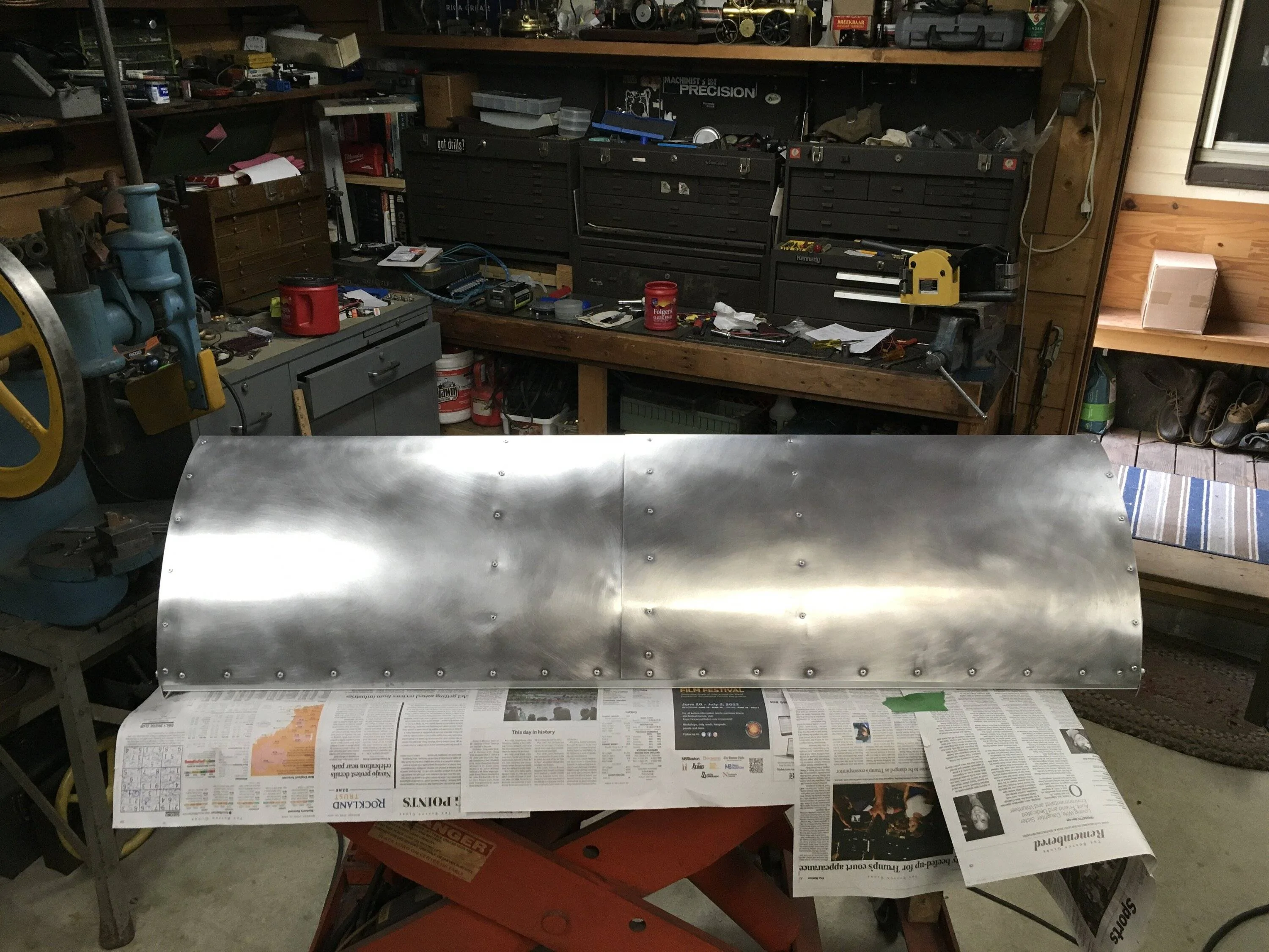

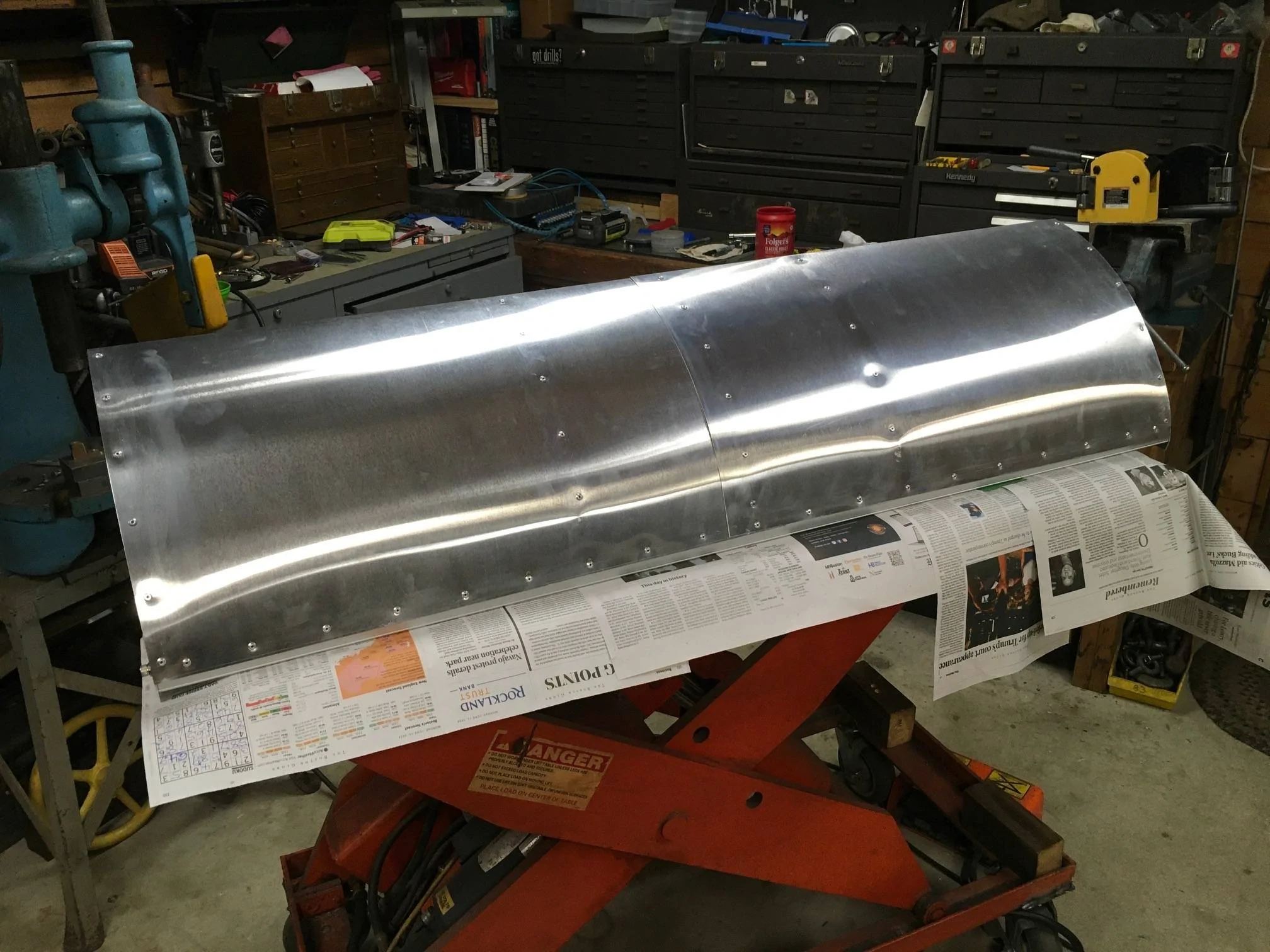

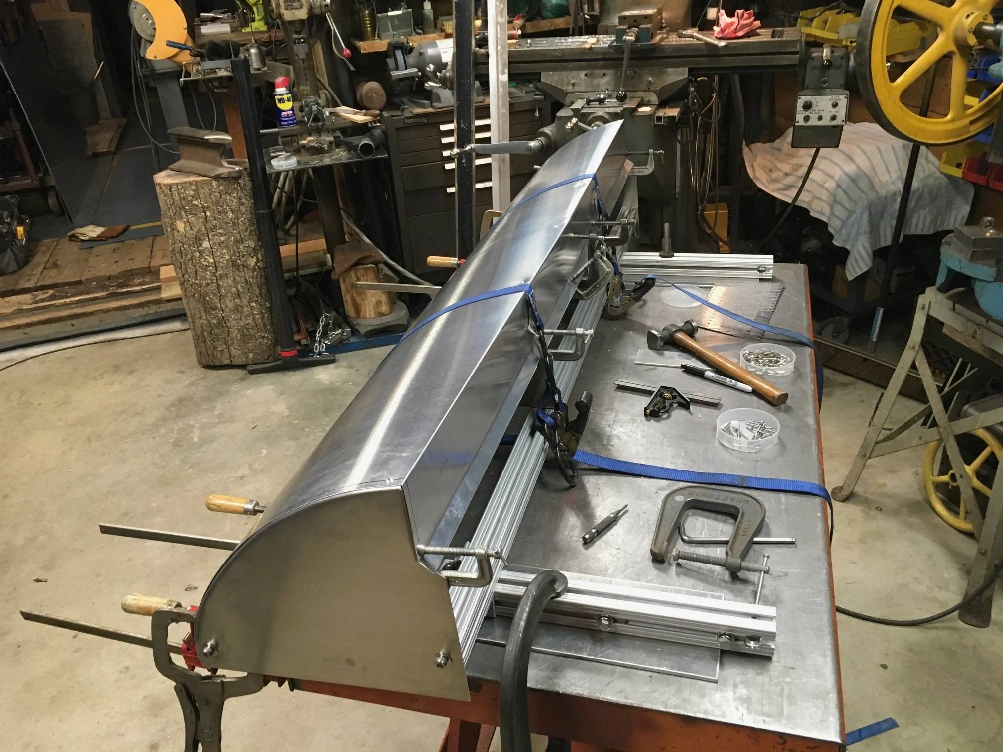

Here are some shots of the build up.
Jeep Gladiator Alucab RTT Aero Mod IMG_5335
Jeep Gladiator Alucab RTT Aero Mod IMG_5337
Jeep Gladiator Alucab RTT Aero Mod IMG_5342
Jeep Gladiator Alucab RTT Aero Mod IMG_5345
Rokon
Bob
Jun 18, 2019
483
707
Maine
Gladiator Rubicon

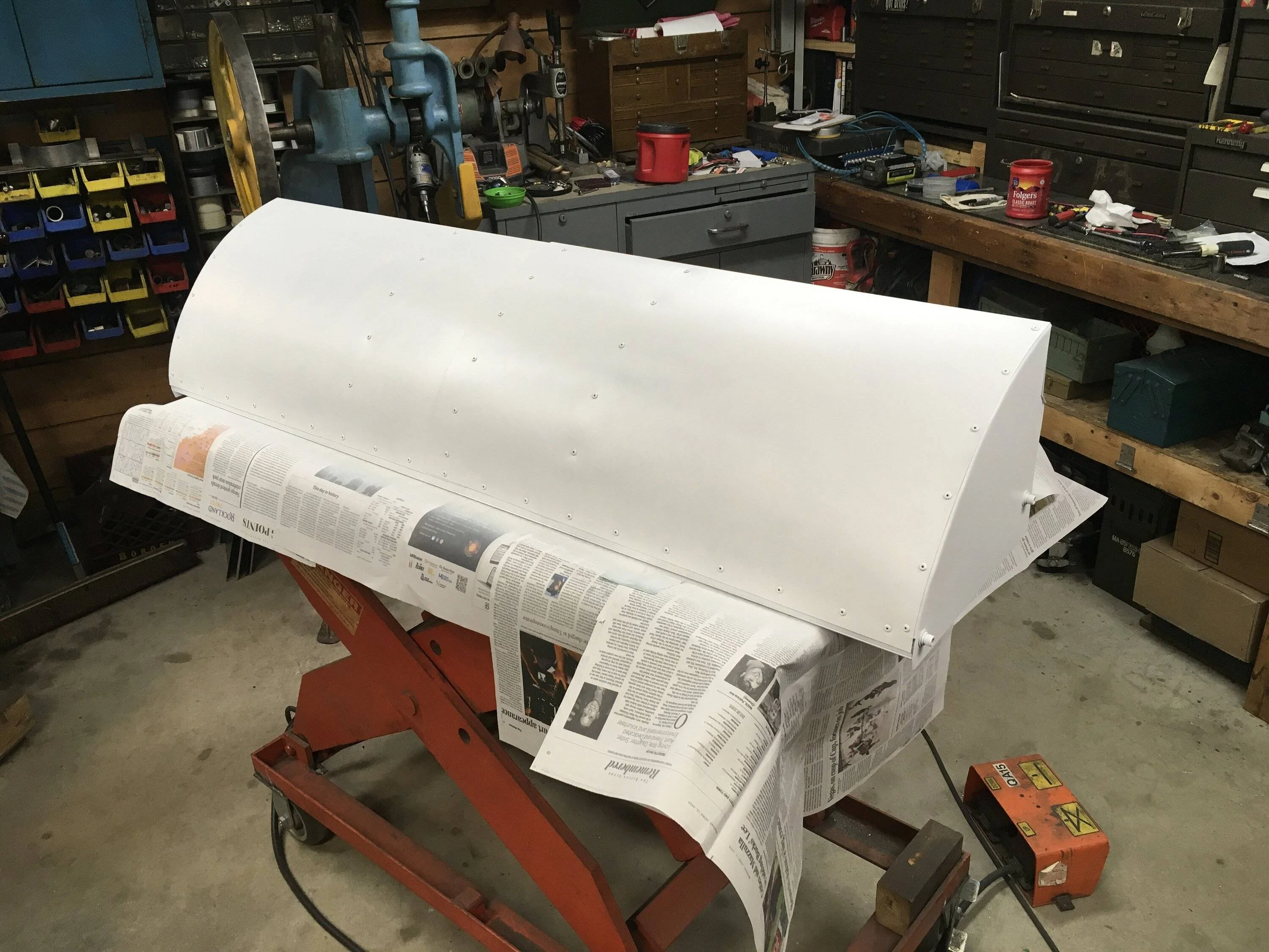

Scuffed up with Scotchbrite and degreased. Ready for etching primer.
Jeep Gladiator Alucab RTT Aero Mod IMG_5346
Jeep Gladiator Alucab RTT Aero Mod IMG_5347
Jeep Gladiator Alucab RTT Aero Mod IMG_5348

Just an update to this thread.
I'm seeing a 1.5 mpg gain at highway speeds of 75-78 mph. Still lots of bugs on the windshield but very few on the aero mod. Thats my wind tunnel test!
Pretty pleased with the results. Only downside is it does affect Sirius reception so I have to do an antenna relocation.
