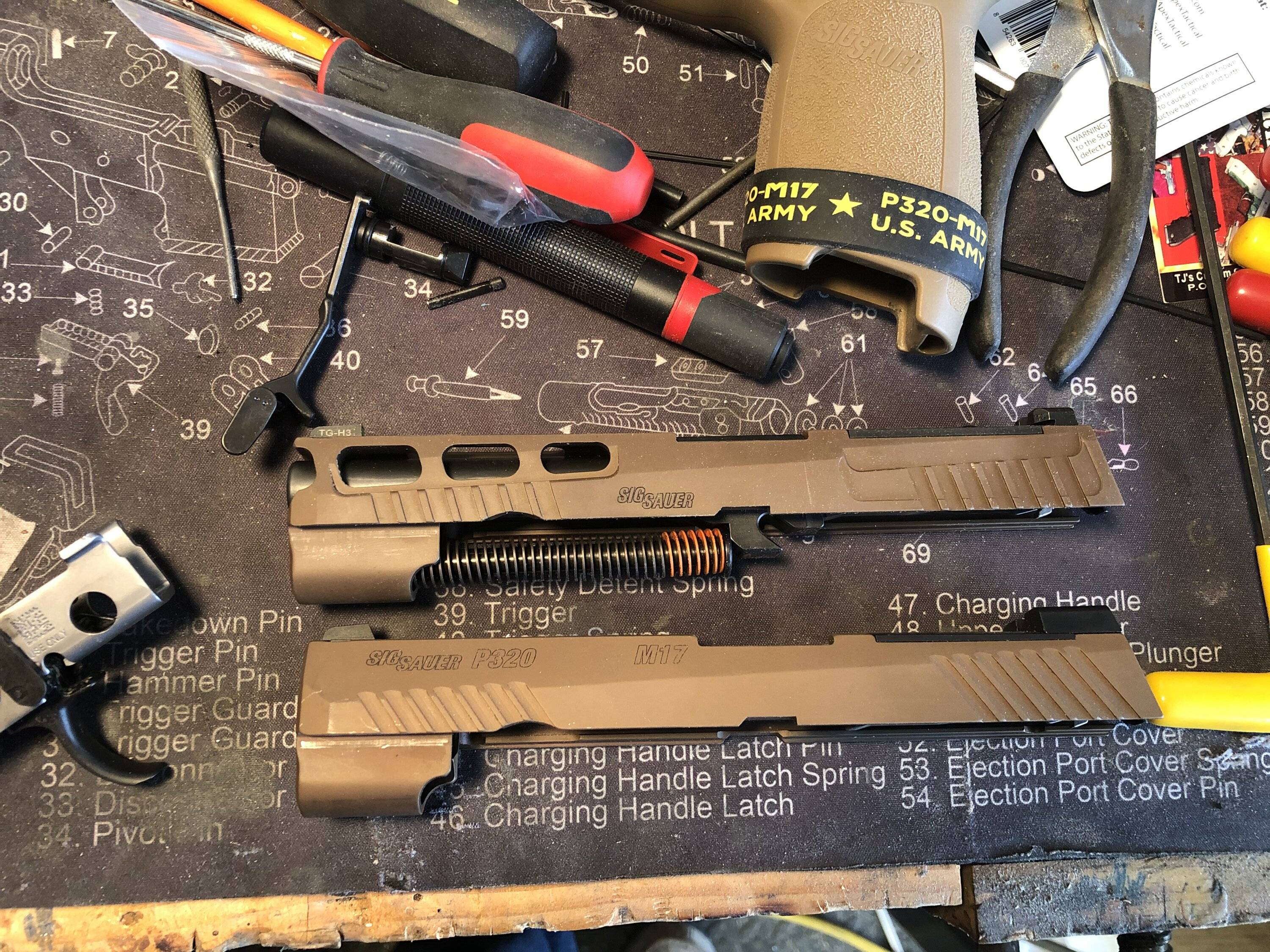

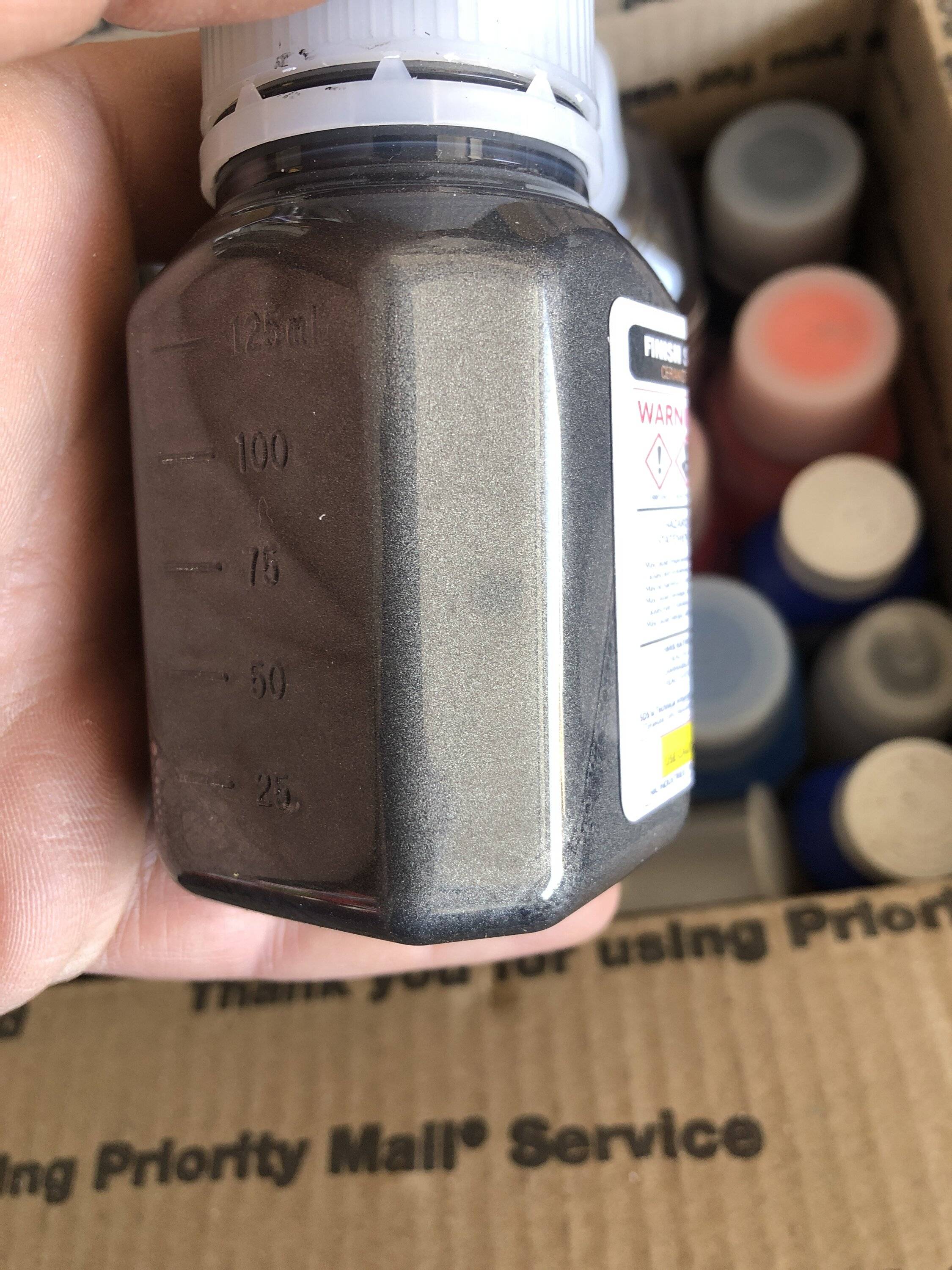

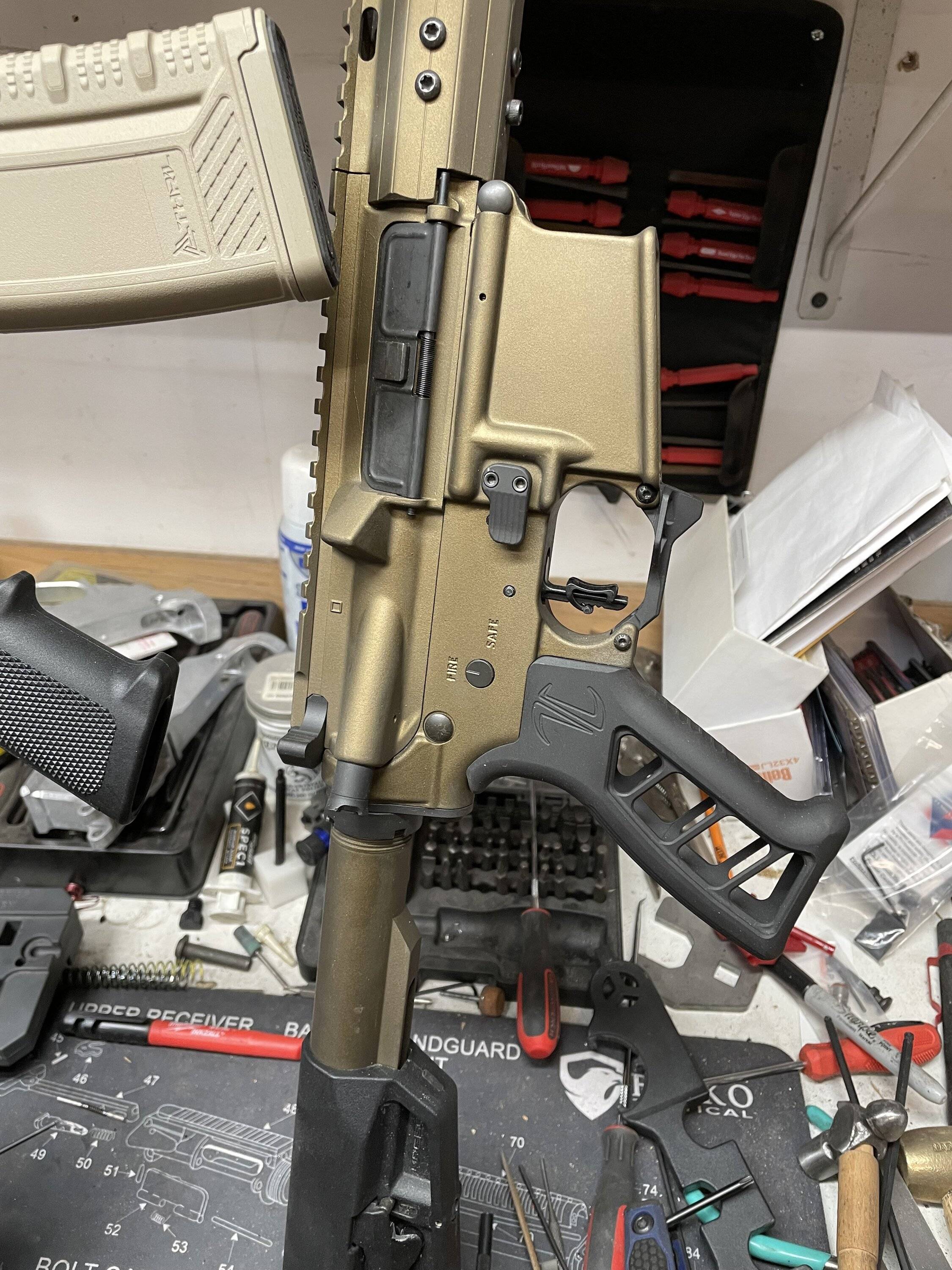

I do a lot of cerakote projects and have had great success with maintaining detail. The coating is well adhered with a little bit of blasting or bristle blasting. Cerakote cures at lower temperatures and less time heat soaking traditionally.
Do you have any pics?

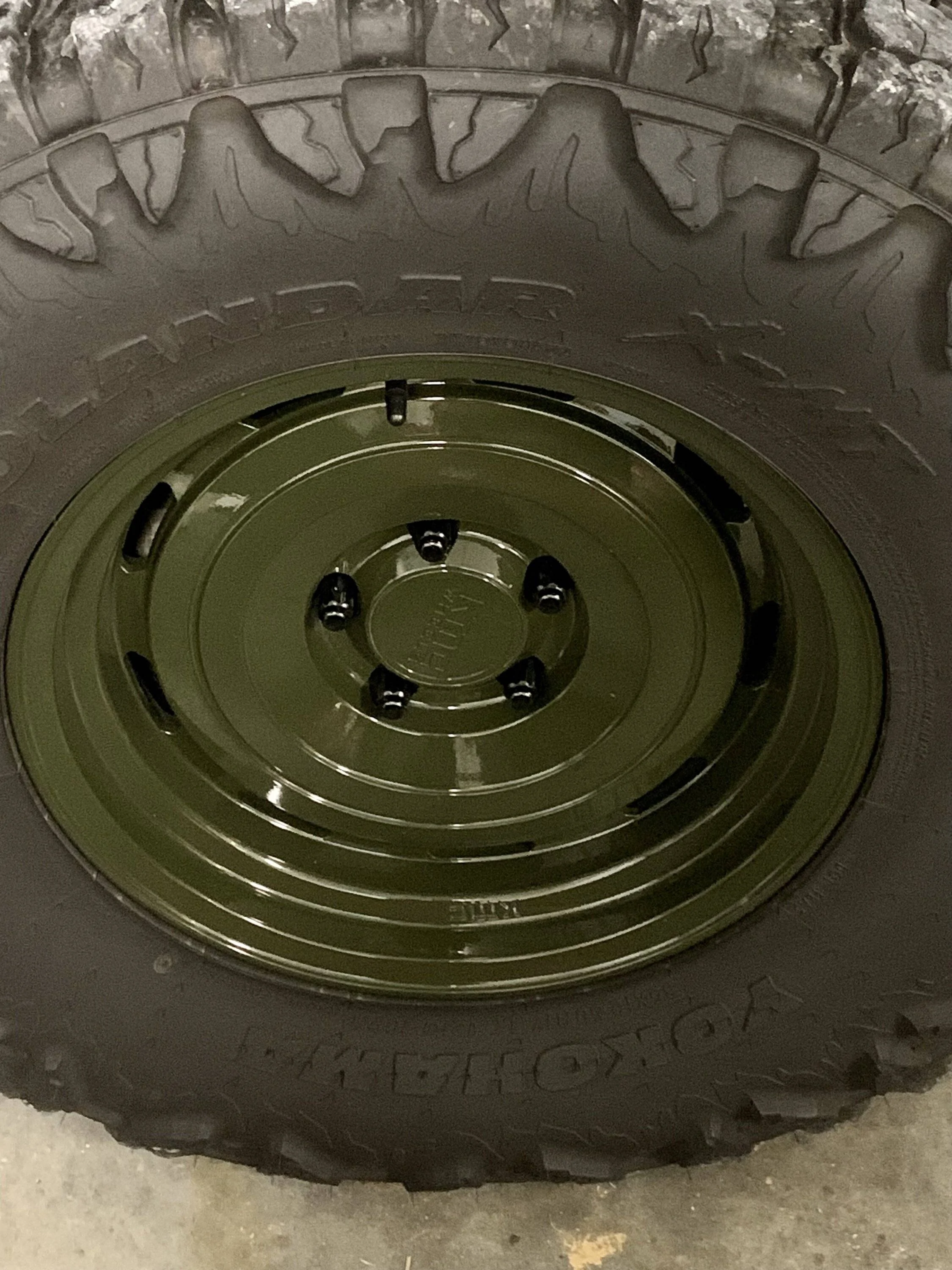

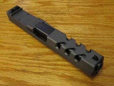

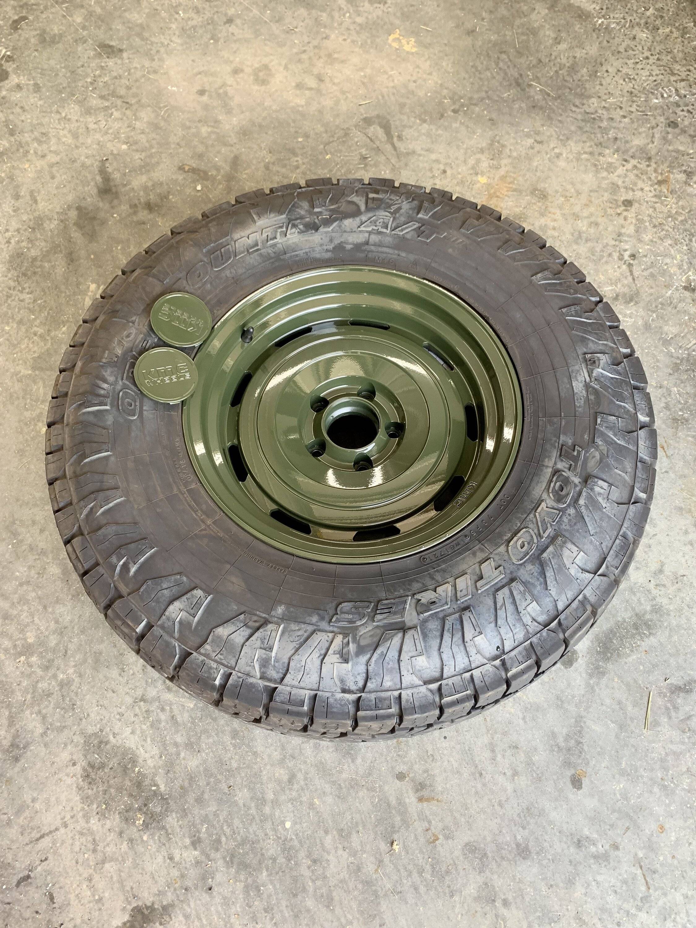

I hope none of these pics violate any rules as some include 2A items, but they reference different colors and finishes of cerakote. Unfortunately it’s what I have on my phone currently. Branson cerakote on the web has pretty good gallery

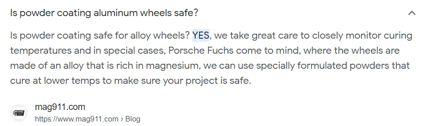

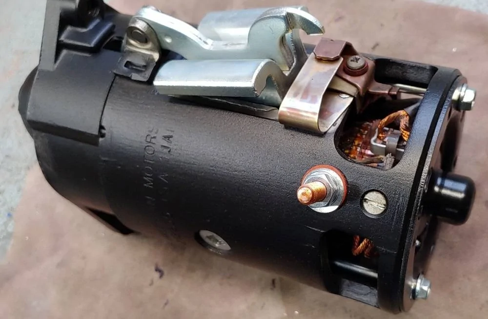

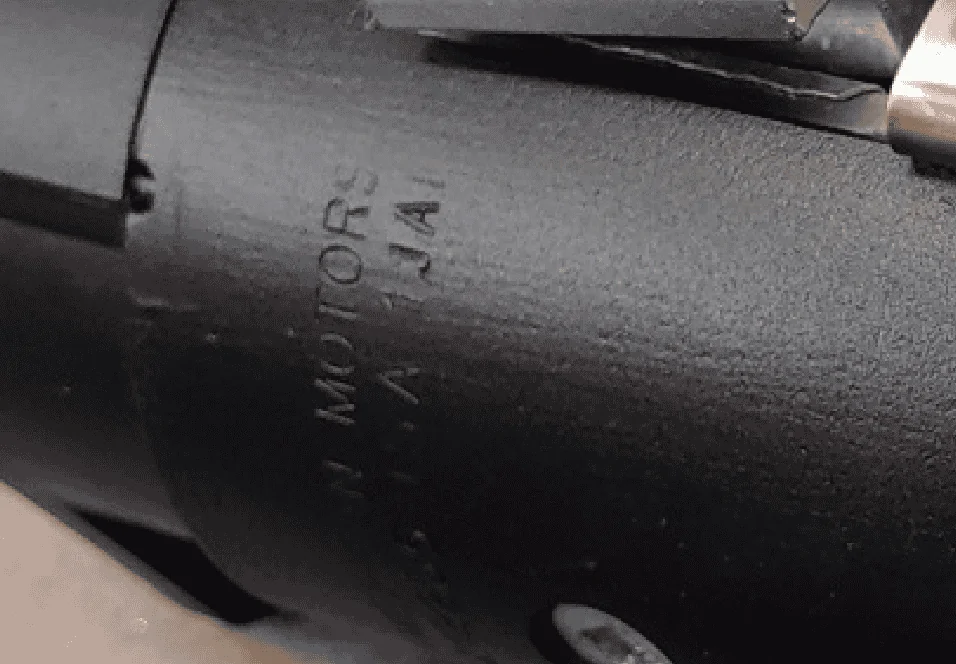

One thing you can do is ask a powder coater for references, how many forged wheels, how many cast wheels, have they done, and ask what temperature their powders require. There are low temp powders these days.
Also - any tough coating, powder maybe especially, but even PAINT, will take the edge off lettering and any raised or depressed features made into the wheels.
It's one reason when we prep cars for painting, we tape off the edges of panels and block in such a way to preserve the edges of fenders and other panels. It took me a full weekend to do my Eagle's hood priming and blocking so I could keep the nice crisp edges in place. So even paint that's got any body to it will do that, but yea, powder can, too, especially with the shoot to waste method which is the general rule.
(except for me - I'm OCD and don't like the waste LOL)
On the other hand, powder doesn't have to - but generally speaking they shoot to waste, meaning get it on thick until it doesn't stick any more.

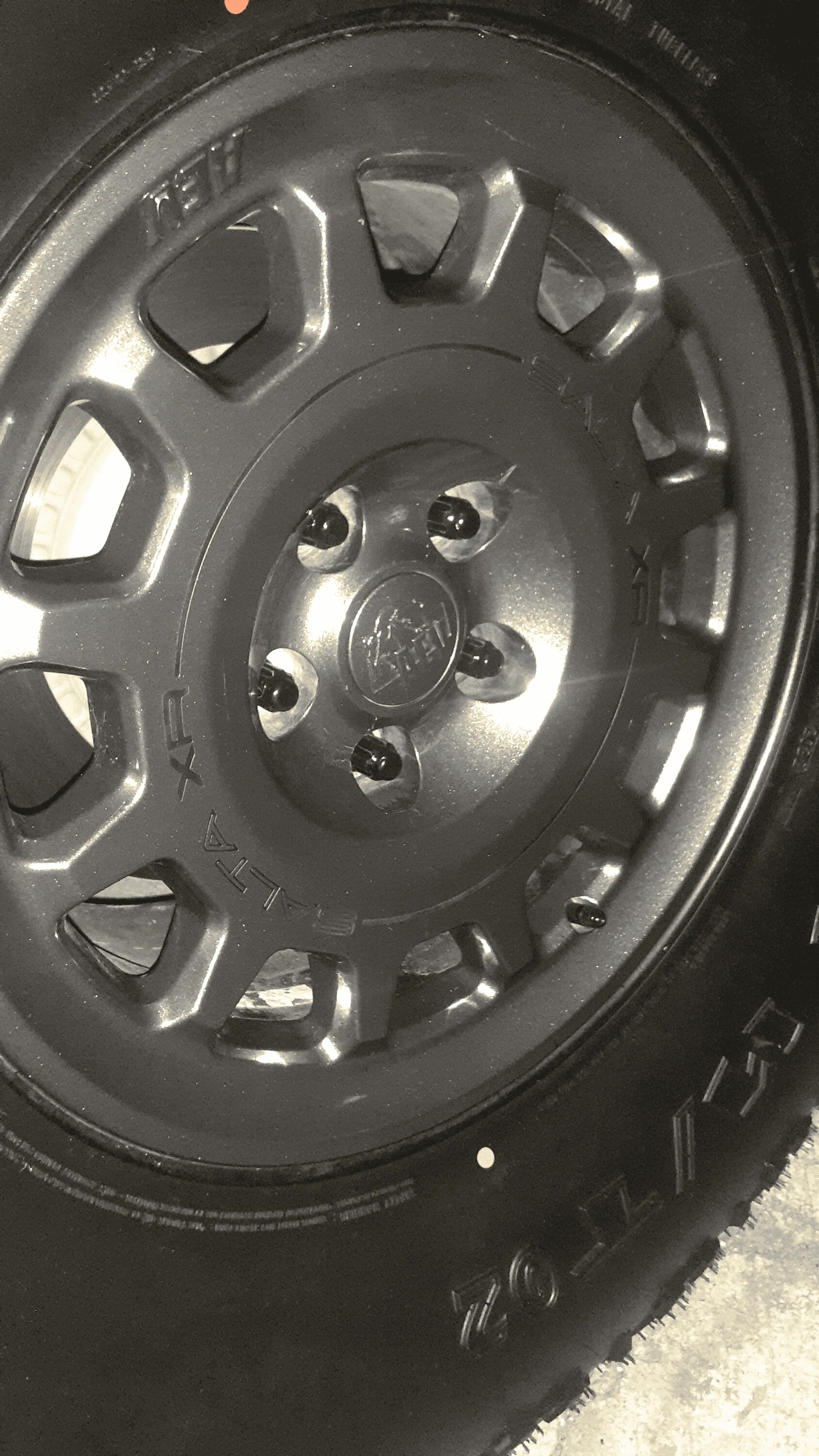

You can preserve features as in the starters I powder coated - the stampings and even the motor frame irregularities are still very apparent -

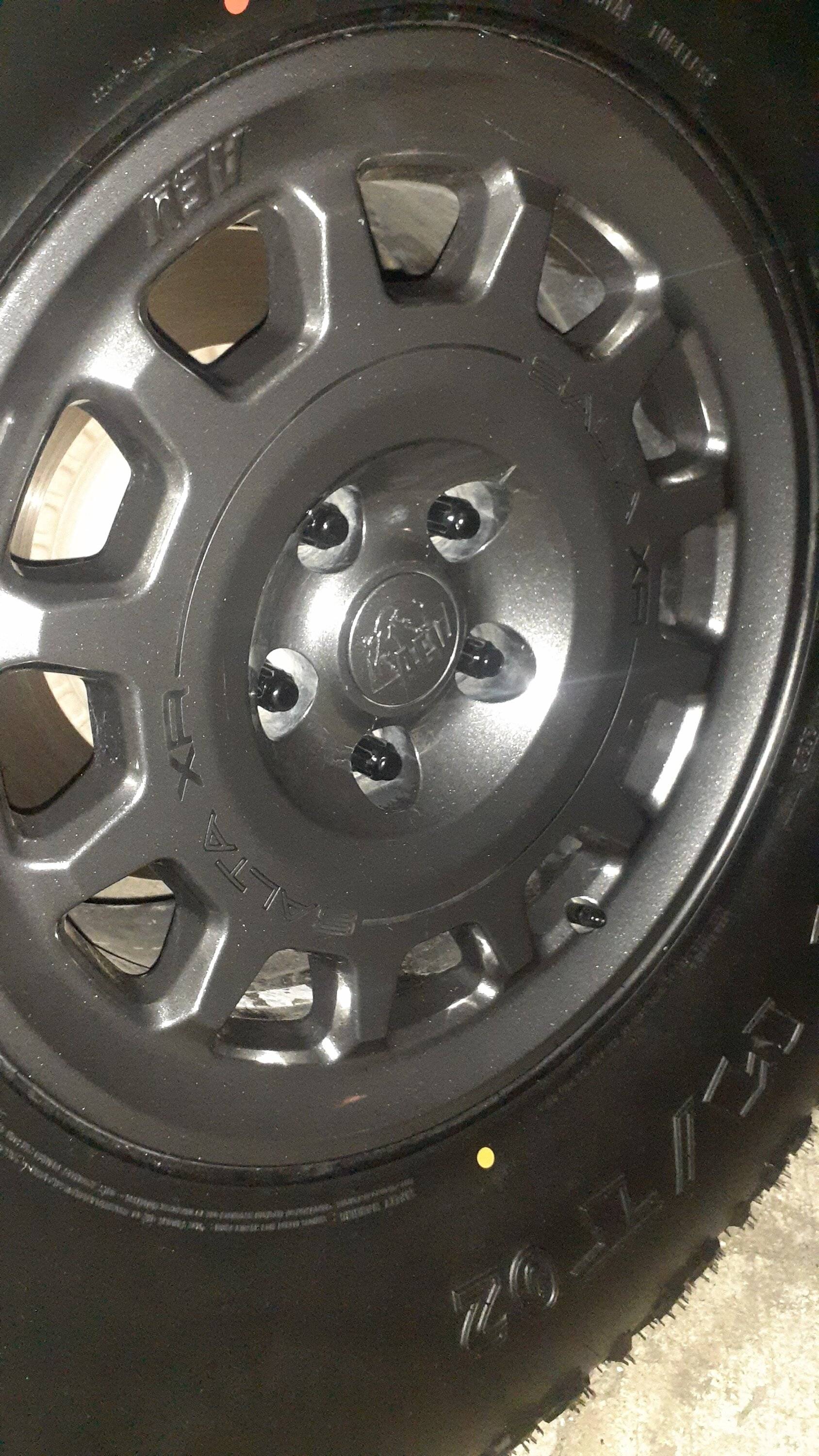

:LOL: Just wanted to say, those salsas are one of the best looking wheels out there today IMO. Tagged to see the end result……..hopefully ;)
personally I’d paint due to the potential for impacting the strength of the wheels but would most likely take away some of the detail of the etching.
