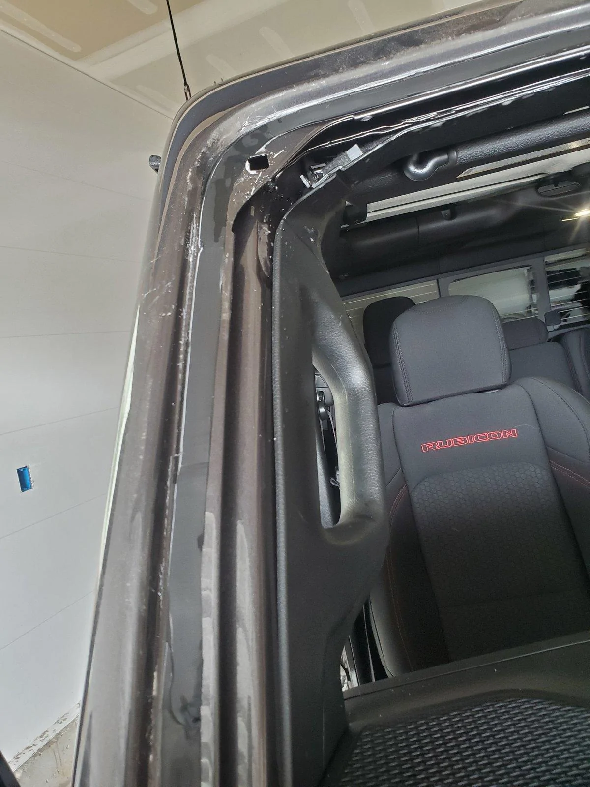

Looking for some opinions and options as to what to do next.
I did buy just the glass warranty from the dealership. So when the windshield cracked with 4097 miles on it I called the warranty company to get it replaced. Super easy to deal with, OEM glass, scheduled a company to come out to the house the next day!
Company was on time, but that is where the good part of this experience ends.

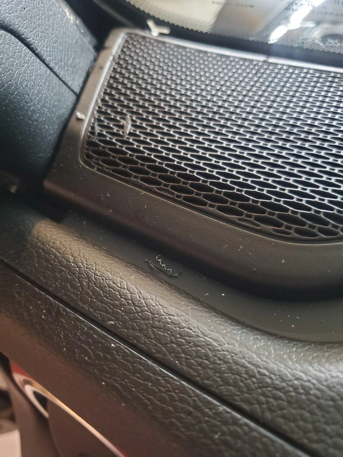

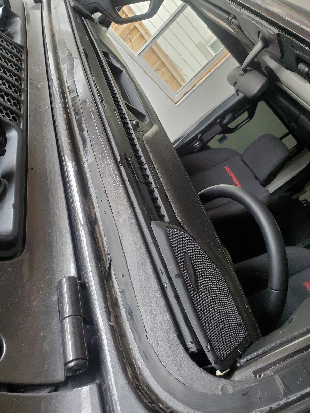

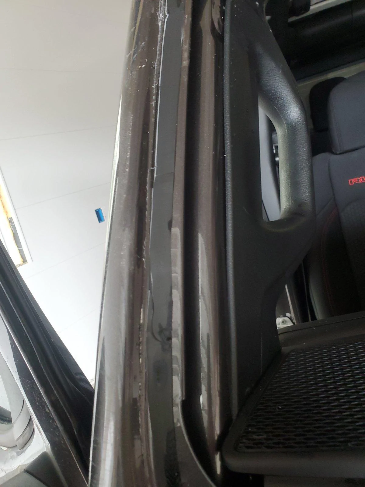

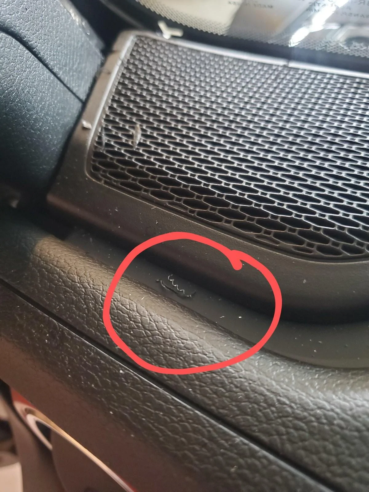

Moved the Jeep into the middle of the garage since it was cold outside and let him work inside. Went in the house while he was getting started to check on kiddo and grab some coffee when I heard the noise. I popped out to see how it was going when I saw him using a sawzall tool to cut out the windshield. When he got the glass out I looked to see if there were any scratches on the frame. My old XJ had rust issues around the windshield from damage caused during a windshield replacement. The frame was scratched and damaged from the tool all the way around, I don't think he left more than an inch untouched! They did "primer" the marks and installed the new glass. He came to clean the dash with blue Scott's shop towels and glass cleaner so I asked he not clean anything! I was afraid of damage from the metal and glass shavings all over the dash.
With the new glass in you can see only one small spot of primer showing. However I feel like they caused excessive damage to the frame in the removal of the glass and I am afraid it will have the same fate as the XJ, rust! The tech was a hack in general for an ocd like me, no protection for dash, seats or hood, laid tools and supplies on hood, stepping in and out of jambs with no protection.
I did file a complaint with the warranty company. I also had the shop manager come look at the truck and he is not willing to do anything since you can't see it, he did offer to stretch and glue the window seal to hide the primer. I declined as that is not the right fix. He called it a successful install since all the damage is hidden.
I think they should have the frame repainted for me. Is that unreasonable? Any glass people who can say what the best way to remove a JT windshield is? I do plan on getting an estimate to fix paint and have a couple glass places tell me how they would remove it. If a windshield replacement is this invasive every 5k miles I won't have a windshield frame by 50k!
Thank you in advance for any advice or bridge building materials so I can just get over it!

What a nightmare. Sorry.
I apply paint protection film for a living, and after I got my JT Rubicon, having heard how often windshield break on Jeeps, I applied Plexshield to mine, from bulk film. I've since done a couple of Porsche windshields for customers from precut and preformed material . A lot more expensive that way, but so much easier toward getting a perfect job done.
Anyway, this film puts a compete stop to pitting and chips, and will prevent most cracked glass from flying rocks. I'm sure most anyone could apply in a controlled dust free and humid environment because the jeep glass is totally flat.
Not looking to solicit business, but if you need help finding the material, I'm happy to help. Plenty of videos showing how to do it on YouTube. My cost to do the JT was about $30. To buy a precut piece, it's about $75. The stuff is like a Lexan screen protector for cell phone. Cutting it, or triming after you lay it down is a tricky. Don't want to scratch your glass if you're not familiar with cuiting film on painted surfaces.
It's a great alternative to having a visit from the gorilla with the sawsall and dealing with insurance. Plus if you have ACC, more complications.

On a positive note, the windshield frame is aluminum, so it won't rust.
Oxidize, probably, but not rust...
